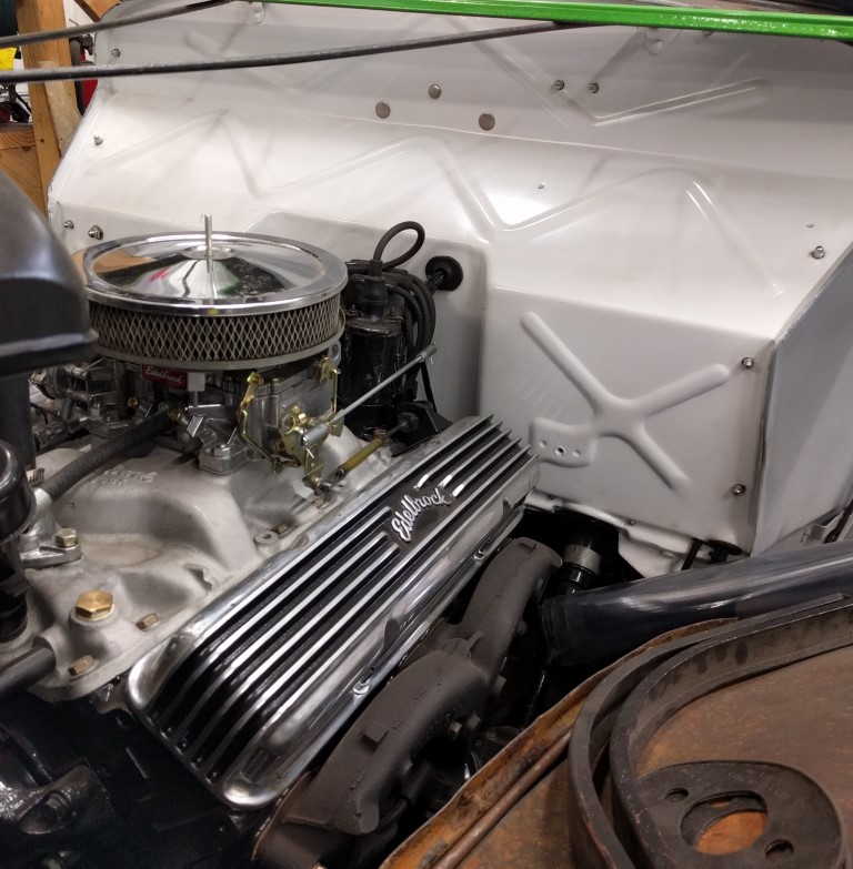

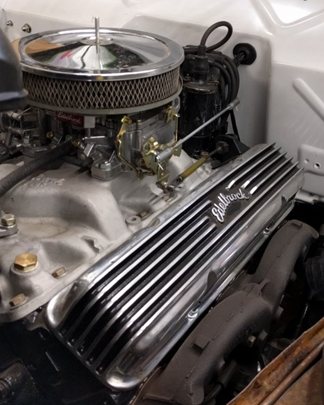

  7. I actually cleaned and spray painted my polished aftermarket valve covers red that I used on my '32 pickup, I let them dry for about a half hour and then took a rag wrapped around my finger and soaked it in lacquer thinner and gently wiped the raised ridge to expose the polished aluminum and that left the red in the recesses. HRP

    Since I didn't try and polish the valve covers I decided to do much like the valve covers on the pickup but this time I used a paint paddle and 220 sandpaper to achieve a polished look to the raise part. HRP
