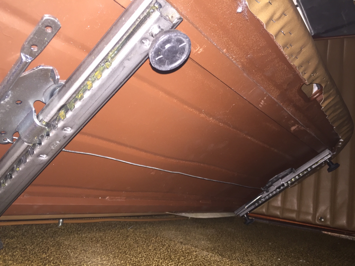

  29. zz29
    Joined: Sep 7, 2017
    Posts: 47
    zz29
    [​IMG][​IMG]
    I’ve been working on repairing the seat on a chopped 29 we have in our house now. See in the picture how unusual the seat base is. The seat is all foam and it was ripped and the plywood base was cracked and sagging. I made a new base that I thought was better, but when seating in the car, I realized it would be too high. I the. Realized that the ‘sagging’ in the original plywood base was actually that they steam bent the plywood to curve to clear the electric cables but then go as low as possible where your bum is. I don’t have a picture of the original base right now. So I guess just contributing another idea.
    GreaserJosh13 likes this.
