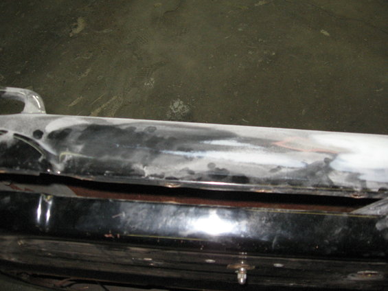

  22. WrenchKitten
    Joined: Jul 18, 2009
    Posts: 116
    WrenchKitten
    NEVER ever buy anything like this from LMC. Especially any of their weatherstrip crap.
    Ya'll are talking about using screws, but if I'm thinking of what he's talking about... it's the two fuzzys, one on each side that the window comes up and goes down through into the door. It's a short piece and it snaps in the door. I don't see how you could get anything in there to... screw, haha.
    Also known as anti-rattlers? I got my kit from Dennis Carpenter.... the only problem I had was with the round part and forming it around the door/glass.
    You do really have to use some pressure to get those clips snapped back in place... This was the "removal" part...looking down into the door.
    Oh and this is on my '66 F100.
    Both removed...

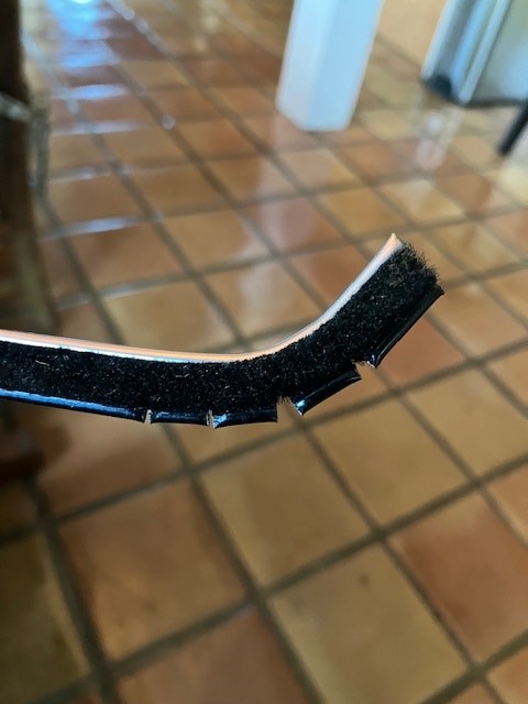

  23. woody sanderson
    Joined: Feb 27, 2023
    Posts: 36
    woody sanderson
    I think I'll get a set of small SS screws. The outside sweep attaches to the door and the inside sweep attaches to the removable inside molding. The outside sweep will be a little difficult to screw in but the inside sweep is wide open. The sweep material comes in 5 foot pieces from Rubber the Right way. After fitting the sweeps to the door each piece uses about 55 inches of material so there is a little waste. The corners are difficult to form but by putting little nips in the edge of the sweep I was able to form the corners real well. I've attached a photo of what this looks like. Thanks for your advice. And I'll get the screws tomorrow.
