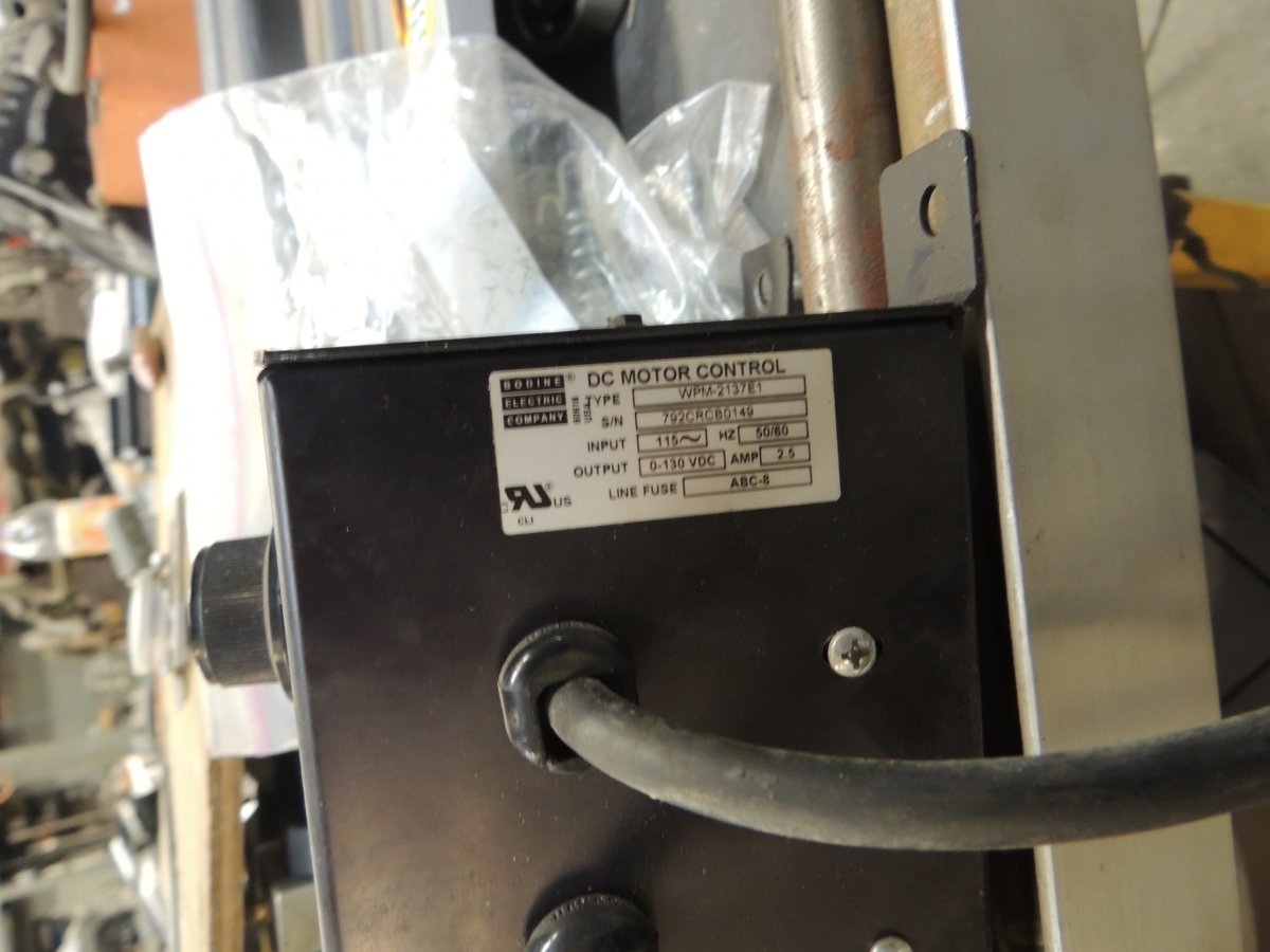

    OK, I asked this question because I had something other than a starter motor in mind but figured that a starter might be close enough to figure out what I wanted to know. Actually I'm building a deep throat bead roller and have some DC motors. I know one would work and it already has an industrial speed control, but I really want to save it for another project I have in mind....... I also have an AC gear motor that will work, but it will not have variable speed. It does however turn very slowly at 13 rpms. Last I have the two DC motors pictured below. Both are 130 volt. The smaller one has 1/17 hp. The larger one is 1/3 hp. Small is .48 amps large is 2.3 amps.
    The speed control came with the small motor but I hooked it up to the large motor and it worked fine with no load.
    The speed control says it has a 2.5 amp capacity. Would it be sufficient to operate the larger motor under load on a bead roller? I don't want to screw it up since it works great with the smaller motor. These DC motors seem to be rated for small HP and good Torq. Like the high torque starter motors they have some serious reduction gears. Notice that the small motor has 65 in lbs and the larger has only 72 in lbs.......hence my original question. Errr, make that lb ins :D

  24. Nope... Motor current spikes when starting any electric motor (unless you're using a electronic 'soft start' controller, and even those will only reduce the spike) anywhere from 300% to 1200%. So that controller will either let out its smoke or if it has a current-limiting circuit (to protect the controller) the motor won't start.

    The larger motor does run and speed is adjustable with the controller hooked up. Given the small difference between the capacity of the controller (2.5 amp) and the stated draw of the larger motor 2.3 amps, I kinda figured there wasn't enough safety factor to make it work.....but figured I would ask the experts.
    How can you tell if its a brushed motor? The control does work really good at varying the speed. Guess I'll have to look for a similar control with a larger capacity. Any suggestion on what amp capacity I need to work properly with the larger motor?
