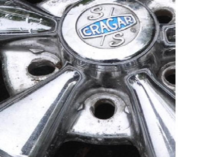

    I just bought a set of uni-lug Cragar SS's because they were really cheap (I paid 65 for a decent set of 4) and I also bought a set of lug nuts and washers (for near what I paid for the wheels) that I was assured would work with my 4.5" bolt pattern if I had genuine Cragars.
    When trying to put them on the car today they did not seem to want to fit. I got 3 on but the rest did not line up. So either the lug nuts and washers are not what they are supposed to be or the "Cragars" are not what they claim to be.
    So, what are identifying marks of a genuine set of Cragar SS's?
    On the inside of the spokes it says:
    CRAGAR IND
    3 399 930
    3 410 606
    A clue might be that these say made in Brazil on them, did cragar make wheels in Brazil?
    Any thoughts?

  6. You should be using either round offset washers, or oval offset washers (depending on the particular wheel), if your wheels are unilug. It looks as if you have conventional washers, from the picture.

    Can you take a close-up of the lug hole on the face side? That'll determine what style washers you need and help figure out why they aren't fitting.

  13. This is a blow up that I made of his wheel and it looks like they are not recessed

  14. Looking at the original Photobucket picture, it appears as if he has the later style unilugs with round washer holes, so he would need the round offset washers if I'm seeing things correctly. Moose, I believe his wheels are designed for a "standard" 4 3/4" pattern which uses the round centered washer; the "alternate" pattern is 4 1/2" which requires the round offset washer. Those wheels are basically the common GM pattern, modified by the factory to be unilug. In the older days, the unilugs were a separate wheel, or rather a separate machining operation of two processes.
    Older unilug Cragars used an oval offset recess & therefore an oval washer, which is still available from other sources.

    I have the 4-1/2" bolt pattern, do I need centered or off centered washers?
    I was able to get the wheel on without using the washers, however I did not tighten them down all the way.
    Here are some close up pictures for 'yall:
    The reason I was wondering if they were fake was I have read about them being "hecho en mexico" but never made in Brazil.

    The washers don't sit in a recess in these wheels, the shank lugnuts locate the wheels. They're to the inside of the holes on a 4 1/2" pattern, and to the outside on the 4 3/4" pattern. Just make sure you have the right length shank and use round washers. They can be tough to mount, as you need to get 3 lugs on before they will center themselves.

    Some old aluminum wheels have been torqued so many times that the metal starts to compress into the holes, making them undersized right under the washer. A carefull job with a file will make the lugs fit again.
    Blue
  25. blue 49 called it.Watch out for unilug wheels.These wheels are not hub centric.They use the lugnuts to center the wheel.if the alum around the lugs on the wheel is forming an ridge and making it difficult to install,filling the ridge could cause an off center wheel to hub.It will shake like a balance issue.You can buy centeric rings to fit your wheel and hub at any wheel outlet if needed.they are plastic.I ran into this myself.

    Abomb is right; the most important part is the length and diameter of the shank; it should just fit in the hole with little side to side movement. The correct slightly offset washers are the best, however a washer with a smaller diameter than what you currently have will work as well, as long as the washer covers the bolt hole fully.
    Cragar never had the recessed oval slots, that was ET, starting in 1965, (they trademarked "Uni-Lug") and it was really the best universal fit system out there. Ansen had totally different insert system as well for the Sprint II wheels. Originally Cragar's universal system was called "Vari-fit", it used a weird 5 hole ring that fit over the studs and into the back of the wheel, and then utilized offset washers for the 4.5 and 5 inch bolt pattern, and a round washer for 4.75. The rings broke easily.
