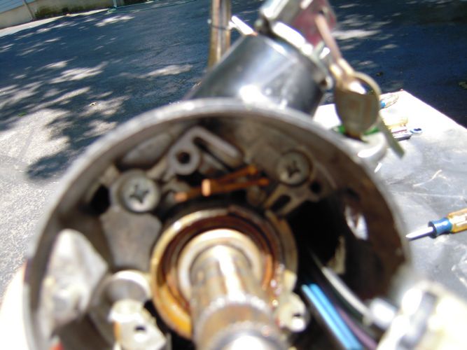

    I have a 1972 Buick Skylark tilt steering column. The key will move to the accessory position but will not move to the start/run position. My intention was to remove the keylock and take it to a locksmith for repair. I have not done this before but was told it was easy - just take the column apart, when the turn signal indicator assembly is removed, stick an icepick type object in the hole going to the lock and push on the spring loaded button and pull out the keylock. I have probed and poked just about every hole around or near the lock set and will nothing budges or moves.
    What am I overlooking?
    Thanks in advance

  7. Larry T
    Joined: Nov 24, 2004
    Posts: 7,660
    Larry T
    That's for dash mounted switches, for column mounted switches ABBoston has the plan.
    If you want to make sure if it's in the key & tumbler and not the switch (they are seperate on column setups), you can loosen up the switch (on top of the column, under the dash), remove the rod from the switch and check your key & tumbler again. If it still won't go turn to ign. it's in the k & t and if it does it's the switch. You get the idea.

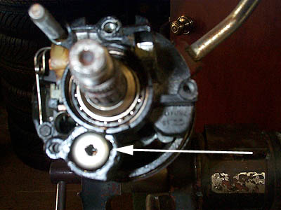

    You don't need to turn the lock cylinder anywhere. You simply need to depress the spring-loaded tab on the cylinder. As noted, the hole that you press through is often closed with a thin layer of casting flash that needs to be punched through. Don't go drilling anything. Don't go breaking anything. This link provides detailed step-by-step photos (just stop at the step where the lock cylinder comes out - you obviously don't need to go further unless you do have to tighten the tilt screws):
    http://buickperformance.com/tiltsteeringcolumnwobble.htm

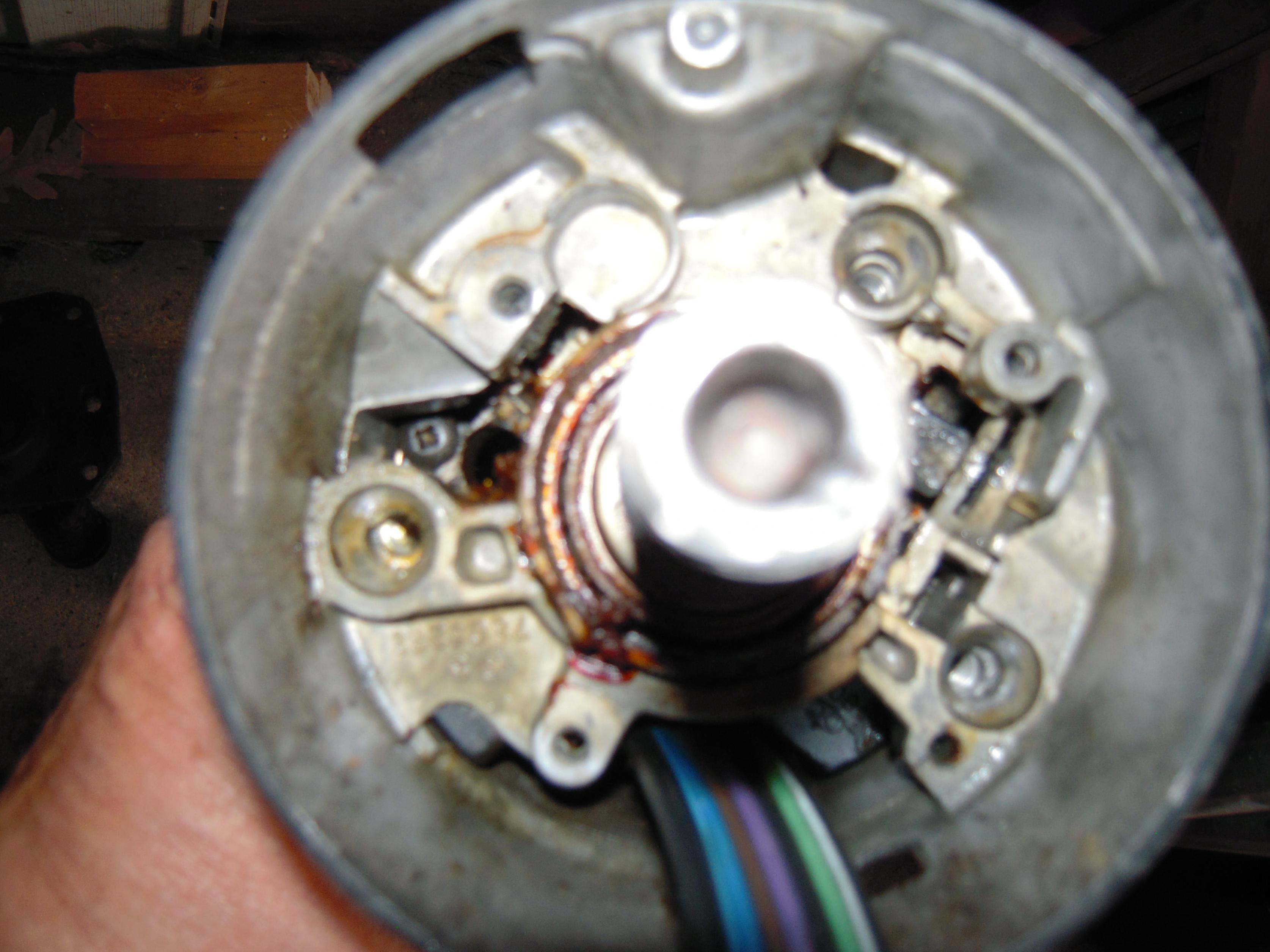

  18. FatFndr
    Joined: Jan 21, 2006
    Posts: 193
    FatFndr
    My saga continues.....I got back to my steering column using all the good advice I received here and now I'm stuck again. Before I get out my BFH and start beating this piece of frustration to death, perhaps I can find a gentler way to handle this. I have removed the key cylinder, turn signal contacts, 3 large philips screws and expected the steering column collar to be easily removable - it's not. It will move about 1/4-1/2" up but then stops when it hits an interference and I can't see what that would be. I have tried tapping gently then firmly with a dead blow hammer and it will not move after the 1/4-1/2" travel. The turn signal wiring loom moves freely up and down about 2-3 inches so I don't think that is a problem. I haven't removed nor loosened the ignition switch and rod (attached lower on the column) as I don't think that would interfere either.
    Any suggestions would be appreciated.
    Thanks

  22. FatFndr
    Posts: 193
    FatFndr
    I finally got the collar off the column and therein found what had been the culprit all this time. In the photo below, in the upper left side, there is a "stem" (pardon, I don't know its real name) and this "stem" was stuck in the collar and therefore not letting the key switch work nor was removal of the column initially possible. After wrestling the collar off and gently tapping the "stem" out I cleaned it up and took a rat tail file and gingerly filed the hole - just a smidge. I greased the assembly, put it all back together and it now works fine.
    Thanks to all that contributed. It helped me immensely in teaching me how to do another part of working on my own car and having the satisfaction of knowing I can do it again if need be.

  25. joe_padavano
    Joined: Jan 18, 2010
    Posts: 263
    joe_padavano
    The "stem" is the pin that locks the steering wheel. It's attached to the geared rack that the lock cylinder moves up and down the steering column, so yes, it will prevent the cylinder from turning if it's stuck. Glad you got it fixed.
