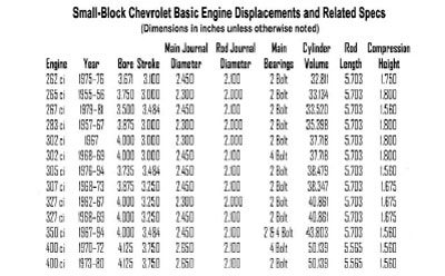

    Trawling through and getting your head around suffix codes. Or the tried and true bore and stroke method.

    As you can see, bore and stroke combination is an accurate method.

    Always way more fun to do it together. ;)
