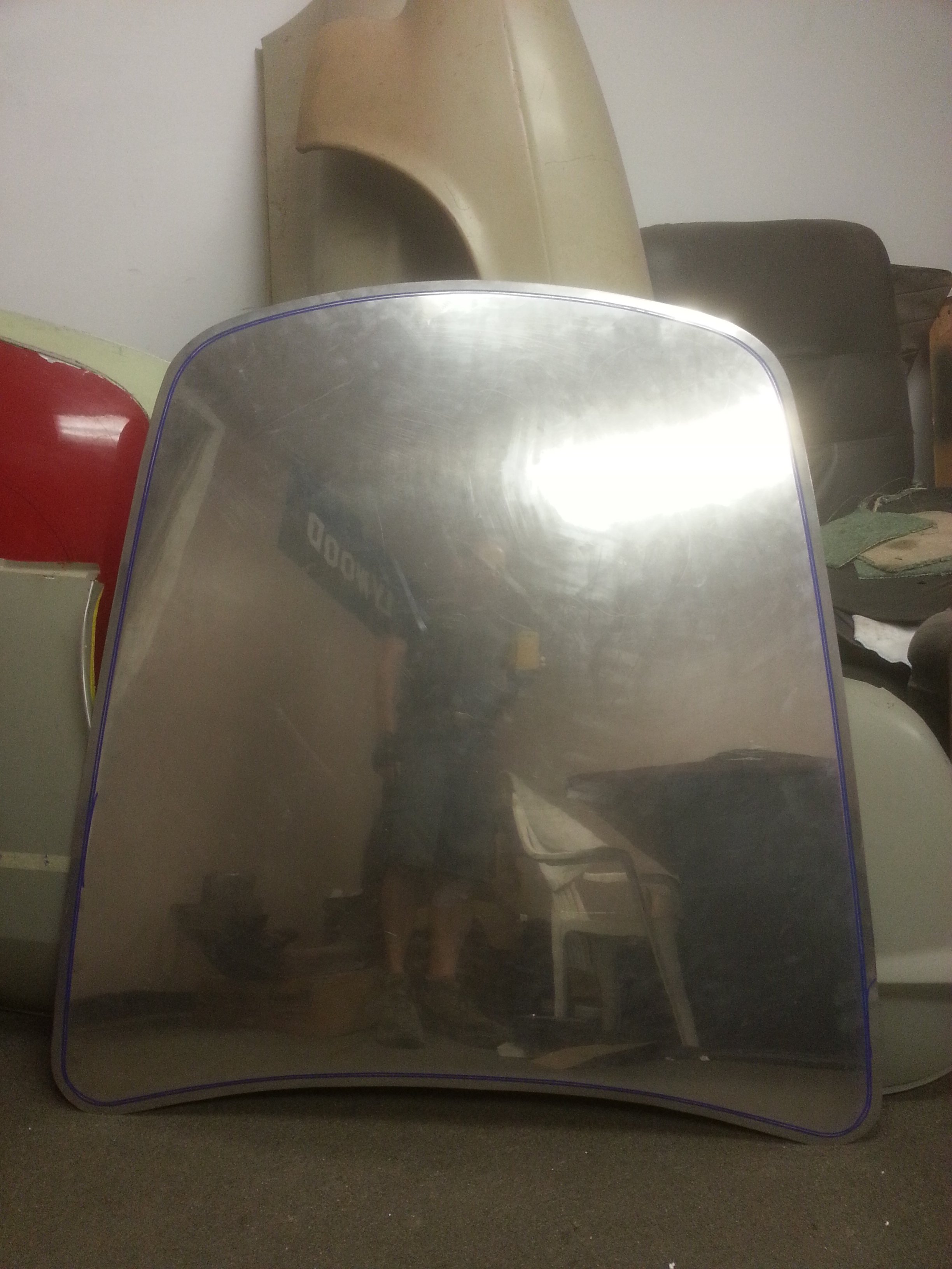

    I 'm in search of tips, techniques on engine-turning the inside of my aluminum hood. Currently just a sheet of formed aluminum, I'd like to engine turn the entire inside, then mate it to the inner reinforcement/frame. 20140618_114305.jpg 20140618_114305.jpg

    Well, most smaller items are done on a Bridgeport. I think on something that large a Styrofoam backer to hold the panel firmly mounted on some saw horses or the work bench t start with. laying out a grid pattern or using some sort of straight edge to locate yourself for each application of the abrasive. One goo thing is the hood inner structure will rake up any long line and help with any error you may create.

    I think you would have been better off to do the engine-turning before it got formed into shape. On a flat surface, the swirls are more uniform and much easier to get to. Also, engine-turning a sheet with square edges is better so you can maintain uniform spacing. After that, you can trim the edges and form the curved surfaces.

  7. Fatkoop is right but plan on a longer process to engine turn a completed bonnet.

  11. It can be done on a curved surface, but you're going to have to use a very small mandril. Small mandril is going to equal thousands of small turnings, and countless hours of applying those turnings. You're going to have to design some sort of cradle which can be indexed side to side and back to front. Engine turnings need to be very accurately spaced, or else you'll just end up with a mess. Best bet in your case would be to polish and clear coat the inside.

  13. How about getting a sheet of thin aluminium (0.3mm), do your engine swirlies on that, then the thin sheet can be attached (glued?) to your panel.The edges can be "hidden " by the moulding or beading which can be seen in the photos. The only problem is the thin aluminum may crease trying to get it to form to the curve of your panel.

    Looks like he just had a fixture line to follow. Straight line all the way to the cowl fairing. This would take a hell of a lot longer then a little hood. Screw it, all you have to do is try. Straight line, and a few of those Eastwood abrasive tips.....would be a great start.

  16. It needs to have some waviness in the line of swirls. If it is arrow straight and evenly spaced it looks "dead" - like the photo-etched stuff you can buy.
    A flexible straight edge and a sharpie will give you a straight line on the panel, then overlap the swirls by eye. As the previous poster says, give it a go. Try it with some scotchbrite glued to an old valve and put it in a cordless drill on a slow speed.

    Take something flexible, like a cheap wooden yardstick, to give you a straight edge to work with. The rest is going to have to be free hand. Some things there is no easy way.

    When we did Bugatti dash and firewalls we had a fixture. picture a yard stick with evenly spaced holes drilled down the center, then cut it in half. Thous half holes were the guide for the shank of the pad holder that was in a hand drill. Back then we used to cover the sheet in a special mix og heavy valce grinding compound and just grind away, remembering to shift the guide after every pass gave the proper look to things. Bob

    If I were you, I'd do these in a fairly large swirl as has been suggested, so it is a bit more like the cowl on the Spirit of St. Louis. It'll take far less time that way, and the larger turns will have a tendency to look less erratic if you get a little off course, too. I have used the 1 1/2" Scotchbrite rollock style pads in a rollock holder to do the same thing you are contemplating. Personally, I've done a bunch of turning on my drill press with a guide, so I would be very comfortable doing this free hand. I would suggest you practice for a bit, and do the same.
    If there ever is a "next time", turn the material first, then cover the whole deal with low tack masking tape and form away. Pull the tape when you are done...

    Lay out your pattern carefully, then use a VERY soft pencil (art supply store) for guidelines, then use electrical tape for a guide, then select whether you would like "softer" of "coarser" swirls and select the material to create your swirls, and go at it. Experiment on a scrap piece of aluminum with the same finish you are starting with, as it will truly affect your final product. I have done it this way for a lot of years. My Grandfather taught me this method, and it leaves enough "error" in the final product to make it look correct, but is precise enough to look like the craftsmanship that it is.

    Absolutely! I would however, as I said before do a layer of masking tape or even better the plastic wrap that comes on some pre-finished aluminums to protect things and allow me to lay out the pattern without marking the metal directly. Sharpies do wash off with a bit of lacquer thinner, but when there is a texture involved, I've had some want to stay down in the swirls.
    Actually, yes. The most common pattern that you see is each swirl overlapped by about 50%, with the next row overlapped 50% and advanced 50%. It takes FOREVER to do, especially when you are doing something small like a gauge panel and using a 1/2 Craytex stick, but it "fills in" the pattern the most. The Spirit's cowl is a much rougher free hand kinda deal that would cover a large surface like that a lot quicker. I'd say that it's over lapped by more like 1/3 or maybe even 25% per swirl, and the same on the next row. I looser pattern like that is far more forgiving on a compound curved surface visually.

    In hindsight, we should have turned, then formed the hood...
    Hood is for my '67 Volvo 1800s racecar/street car. Inner brace will cover quite a bit of it, so some mistakes may be "hidden".
