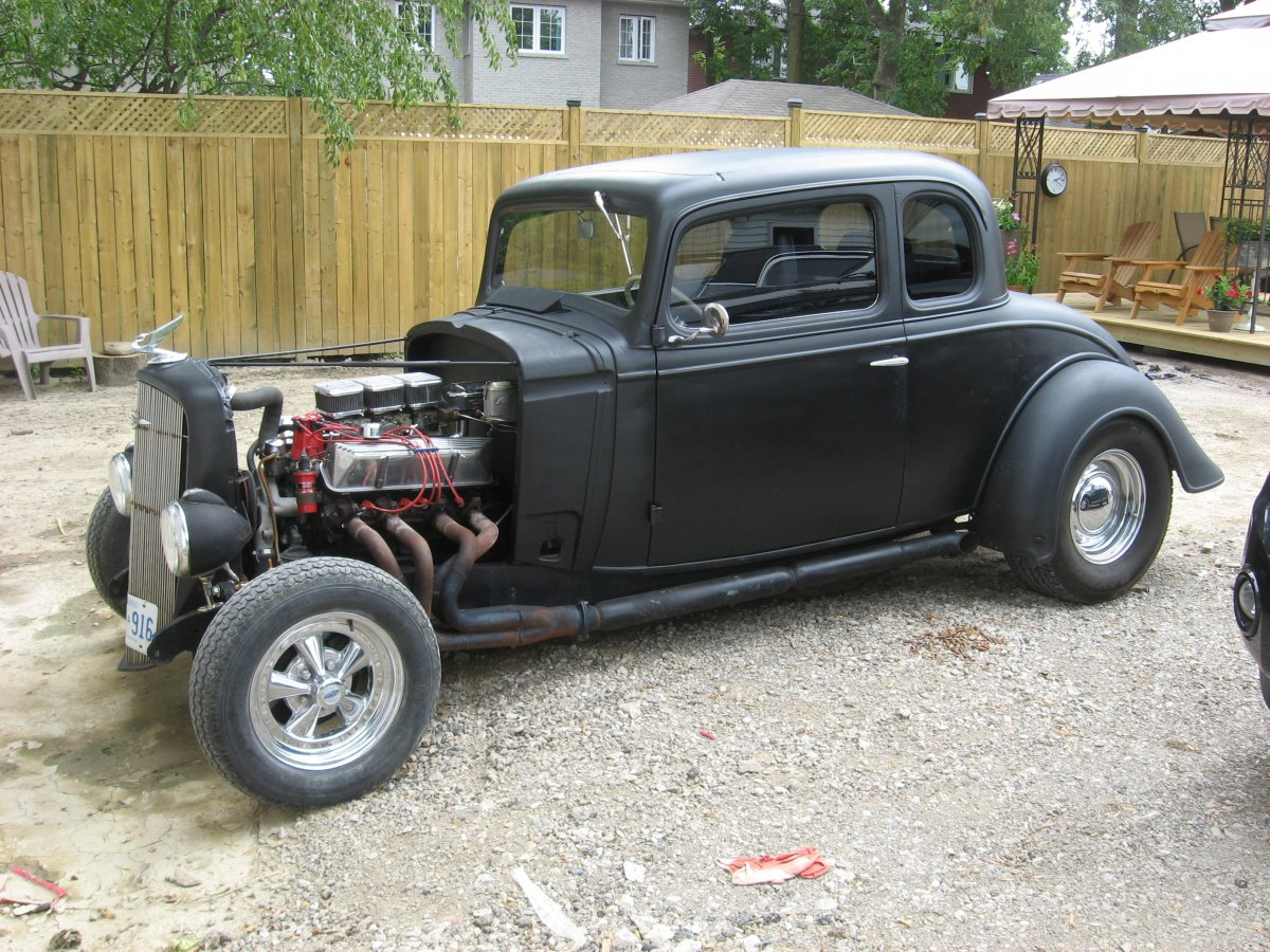

    Hamtown Al likes this.

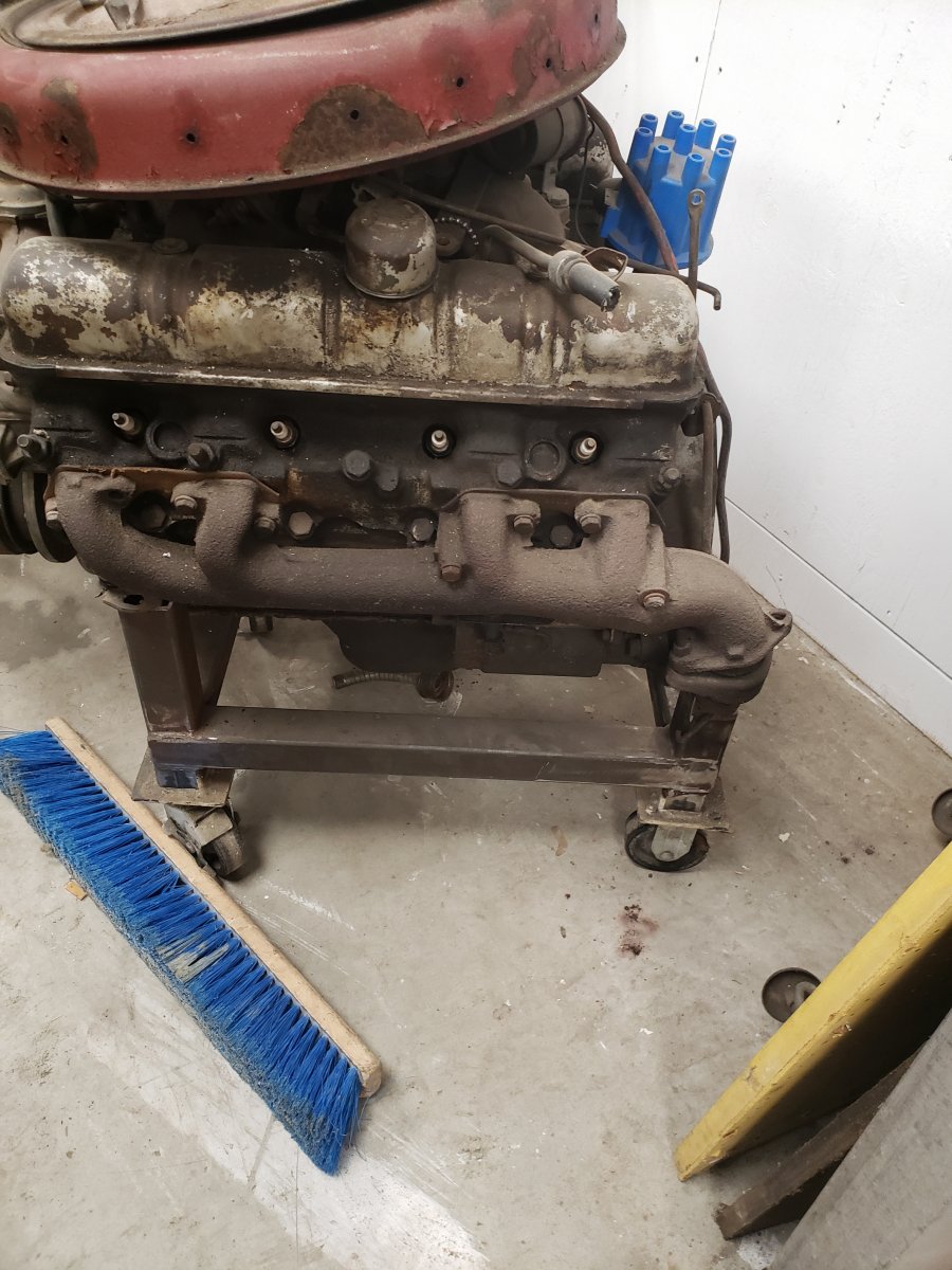

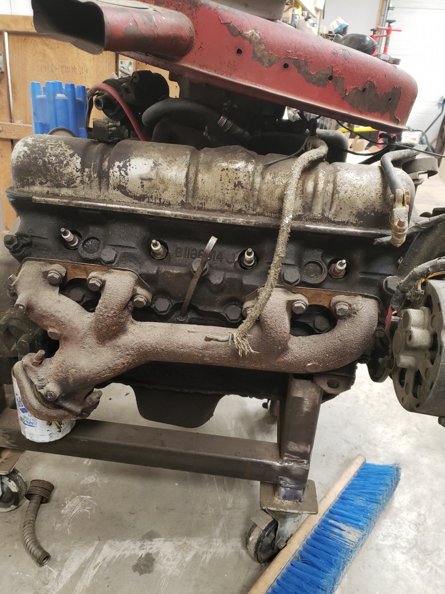

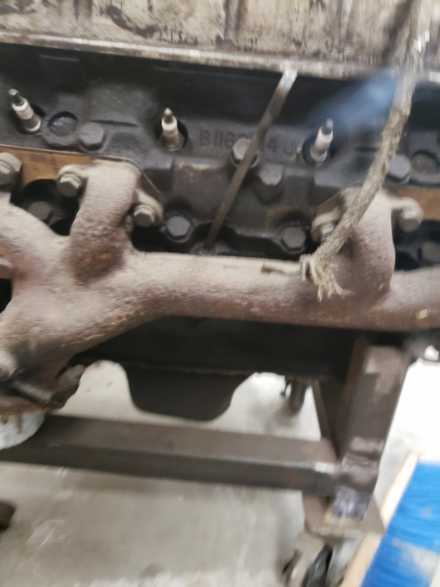

    These are the manifolds on the 63 , appear to be about 26 inches apart . Checked on the frame and have about 27 inches . Have center dump headers somewhere here as well . Moved a year ago and havent unpacked all my car stuff yet , busy renovating our home , close to done and preparing to get back out to the shop. 20210112_162406.jpg 20210112_161806.jpg 20210112_161755.jpg 20210112_161646.jpg 20210112_161633.jpg 20210112_162406.jpg 20210112_161806.jpg 20210112_161755.jpg 20210112_161646.jpg 20210112_161633.jpg

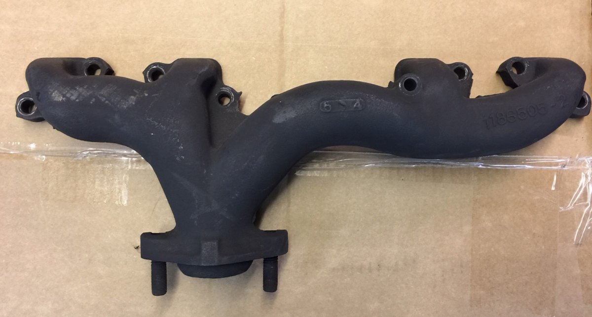

    This is the manifold I used on the driver's side. The guy at Centerville knows all things Buick and located this manifold for me. Go to him for help... you can email him this picture to make sure he knows what you want.
    I don't have a good picture of the passenger side manifold now but will try to get one for your reference.
    Heidts bought CE(Chassis Engineering) and still offers the engine saddle mount. They actually updated their Buick motor mounts specs based on my feedback with the first ones they made in house... one bolt was drilled slightly off from where it should be. I tweaked the mounts to work with a few files... and later went for ice cream!;):D:D
