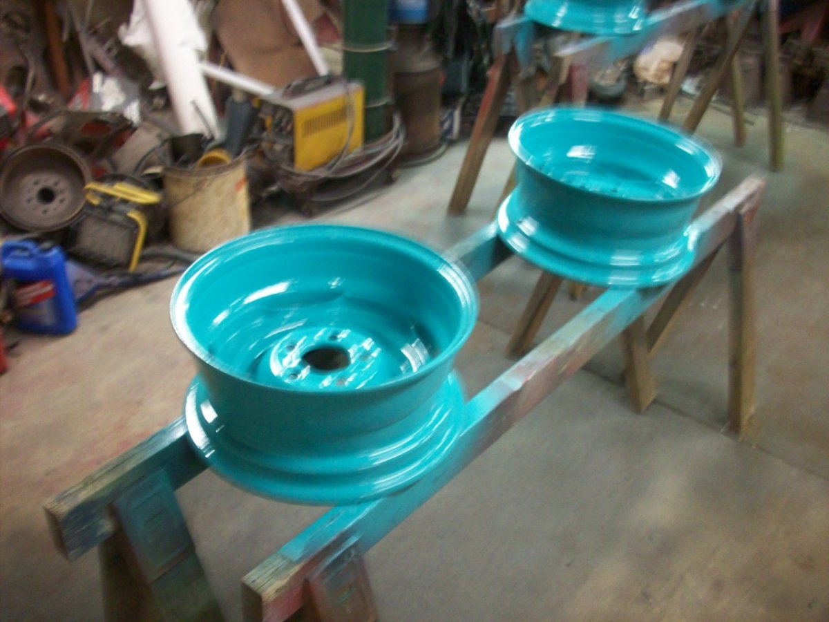

    I just had four rims sandblasted and after priming all the blemishes from when they were stamped showed up that was not seen with the factory paint,years ago I stripped all the paint from a mid 50s Olds aircleaner and after I repainted it I could see all the stress marks from when it was stamped so since there is no way the factories would spend hours getting each individual part to look smooth did they have a magic primer that filled all those imperfections and I would like to find some or find a way so it will not take me many hours to look good.

  17. junkyardjeff
    Joined: Jul 23, 2005
    Posts: 7,478
    junkyardjeff
    I said screw it and the rims are getting paint right now,will see how they look when I get some color on the fronts and need to get more beer while the paint dries.

  28. junkyardjeff
    Posts: 7,478
    junkyardjeff
    I might have been worrying for no reason since the paint filled most of the imperfections on the rims,the rattle can paint I used on that aircleaner did nothing to hide the blemishes but the single stage paint I used on the rims did a good job.

  30. junkyardjeff
    Posts: 7,478
    junkyardjeff
    They have about 5 coats of paint and most imperfections can not be see so good enough for me.
