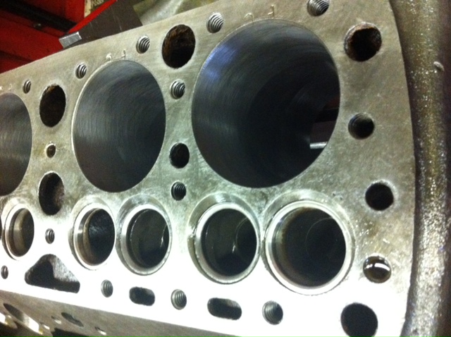

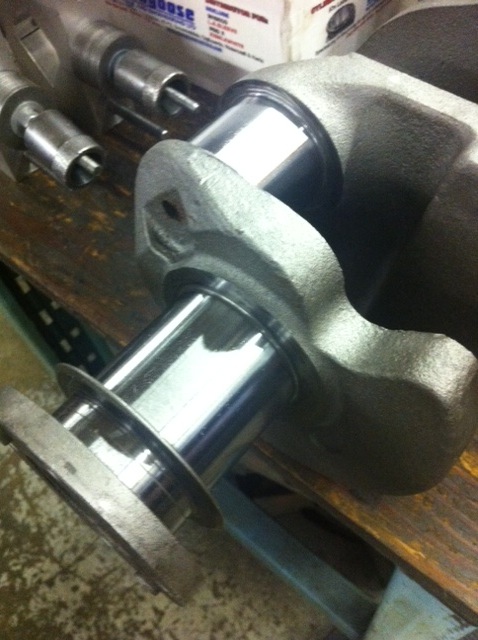

  21. I am just having all the standard machine work done on my 46-59A (C69A) over the past couple of weeks by Hi Performance Engines, Burnaby B.C. Canada including.
    Bore and fitting pistons
    Valve seats installed (8), seats Serdi ground
    Merc 4" stroke crank turned and polished (3/8 clean out Canadian crank)
    Rods, bushed and big ends re-sized (floating bearings because it's a FLATHEAD)
    flywheel lip turned off
    Balance
    Etc Etc...
    I started with a clean, complete and running $650, CL engine that had a couple stuck valves which led to pitted seats then a valve job then quickly into just doing it all.
    I have never rebuilt an engine so have no accurate benchmark for comparing costs, all the parts seemed affordable enough and easy to acquire but the rod bearings where spendy.
    I've purchased pistons (egge), main bearings (Israel) rod bearing (nos), rings (grant), new valves, guides, keepers etc, etc from Patricks in AZ. I went with cast pistons as the piston selection is limited at 0.020
    Isky 1007B camshaft ground by Pete in Wa, new Isky springs, N.O.S (in the orig box) Johnson lifters
    Two Stromberg 97's fully treated by Uncle Max on an old Thickstun PM-7 (Thank You)
    Stock crab distributor with POINTS gone over by Bubba (Thank You)
    39 Generator rebuilt and 12V conversion by Rusty at Speed O Meter/Alternator Service in CO (THANK YOU)
    Porter Mufflers (custom 16") and rare Ford Pilot factory exhaust manifolds that where complete JUNK when we started welding on them to fix 'em up.
    I CAN NOT WAIT to hear this engine run, hopefully in Sept sometime. I have been having a TON of fun with my flathead and it's not even in the car yet.
