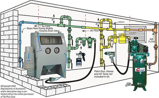

  19. 31Apickup
    Joined: Nov 8, 2005
    Posts: 1,917
    31Apickup
    You need to run about 14 feet of metal pipe to condense the water, then place your separator. I ran a line like the attachment (from TP Tools website) and oit worked wonders, no more water.
