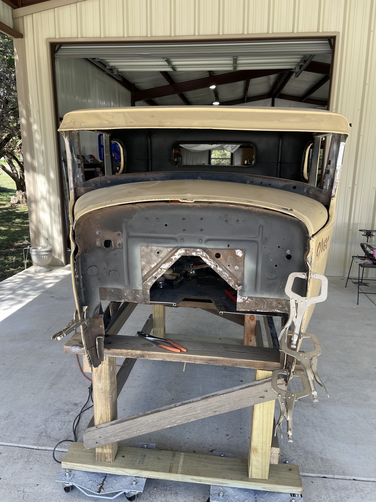

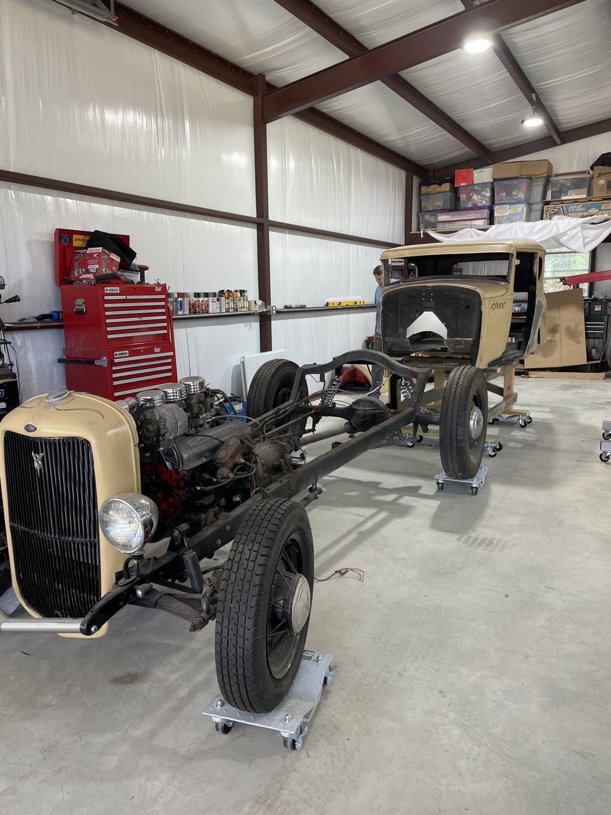

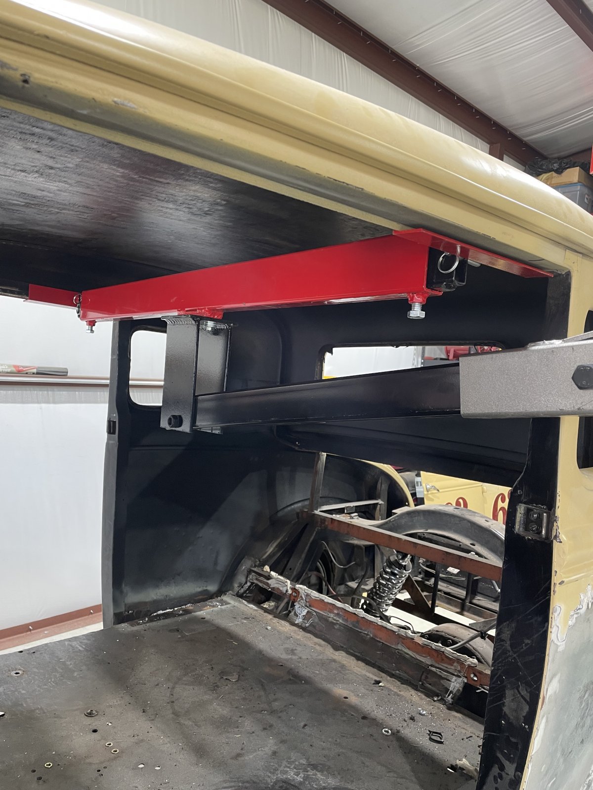

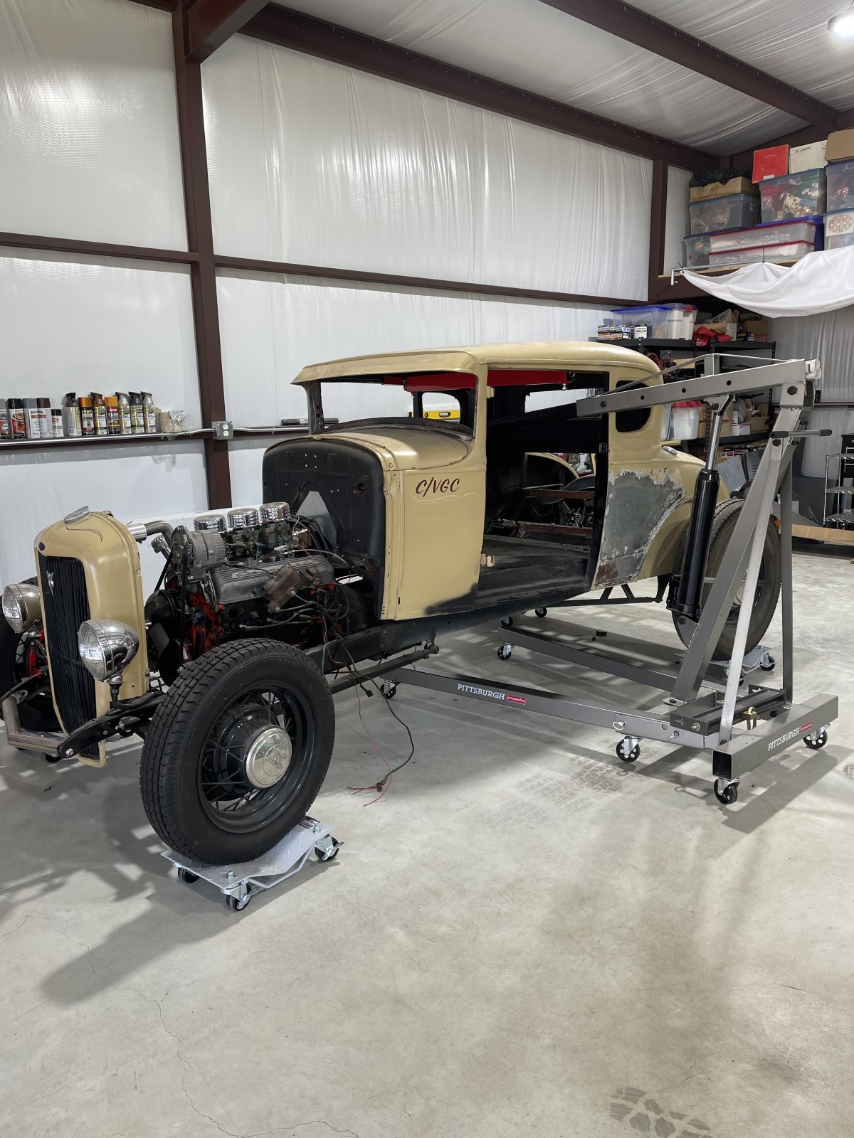

    Off to a good start today. Complete disassembly in 6.5 hours. Frame is out back ready for a new home. Shooting for a traditional 40’s style ride using tried and true recipe of 32 frame with the A body, as my frame has had too many mods over it’s life to suit me. Will keep the sbc to keep cost down . Would love a flathead or hemi but will spend my money on the rolling frame. Maybe later with the flatty??? 2908718D-E4DC-4EF5-BD89-6D46EBA0F695.jpeg D6DD8AE6-D100-4796-A8E9-8A137EDB4181.jpeg E43811C6-3E1A-4B91-AB3B-42478F8D8CB0.jpeg DCBC2A61-1457-4356-A08F-CD0384924DC8.jpeg 40F7B98E-D464-4F81-AE17-BC6B98425B81.jpeg B74FD7BF-896E-4DE5-B0D1-A81BECE47DFD.jpeg 92910FC0-12B0-4F5F-9127-63FA4AF6FA54.jpeg

  3. Roothawg
    Joined: Mar 14, 2001
    Posts: 24,601
    Roothawg
    Did y'all build the attachment for the cab removal? Kinda neat.

  5. Hotrod31A
    Joined: May 20, 2022
    Posts: 119
    Hotrod31A
    No, I took the easy way out and bought it off ebay. Saving all my energy for whats to come lol. It worked fantastic. My wife was the only help I had and she worked the hoist.
  6. Roothawg
    Posts: 24,601
    Roothawg
    I may have to build one now.

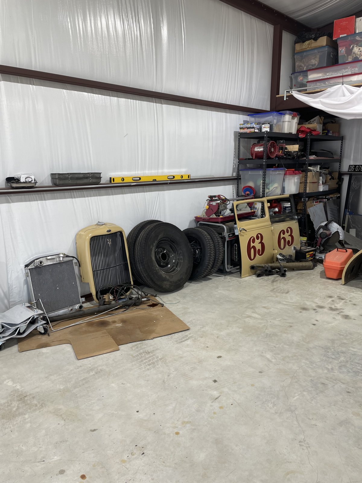

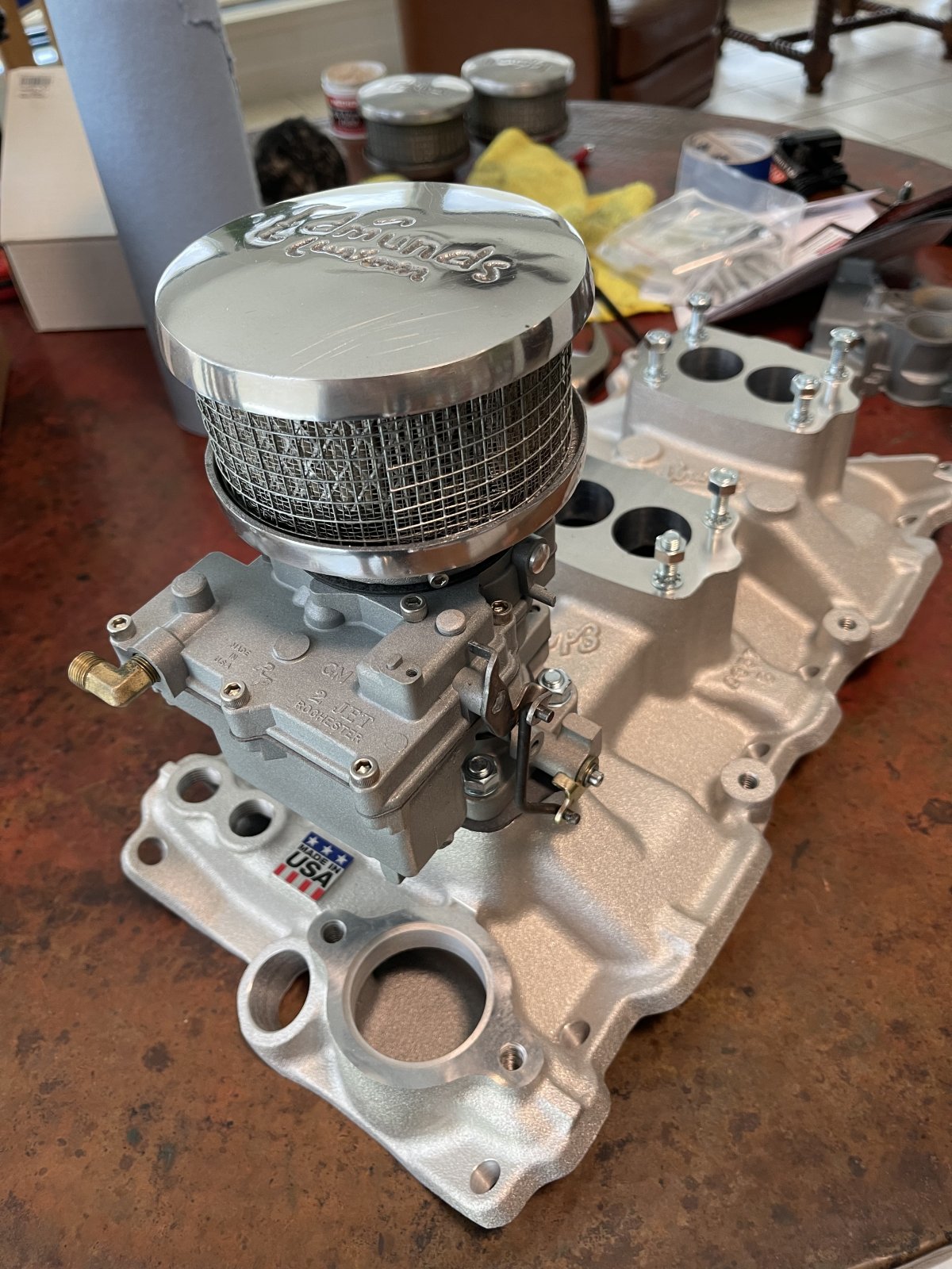

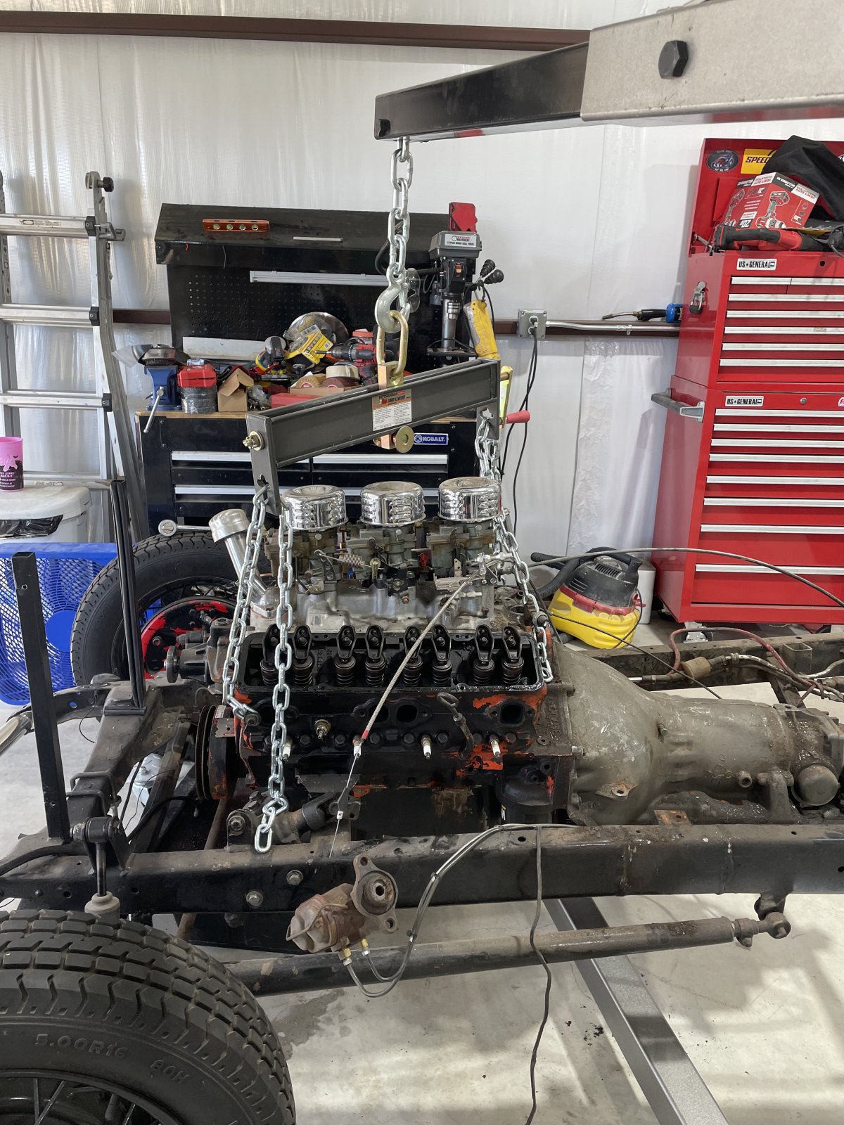

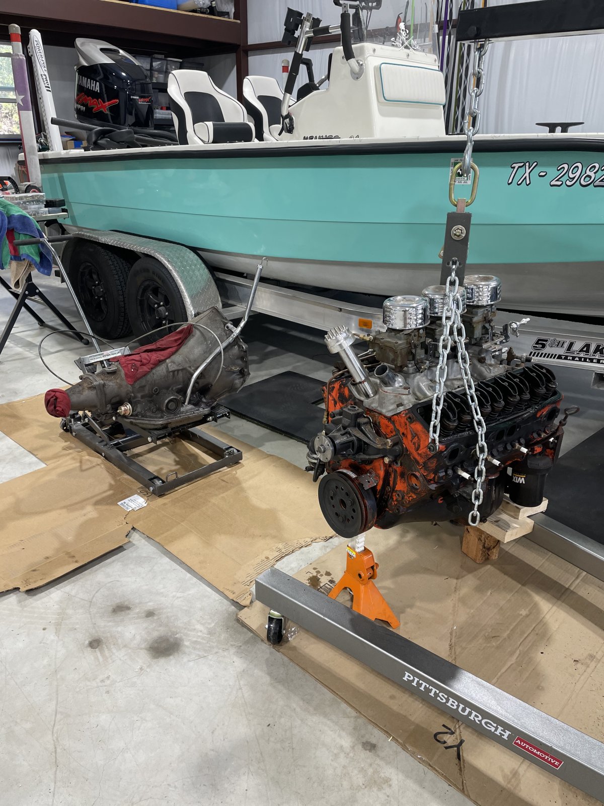

    Tired mouse torn down ready for the machine shop. My guy is ready to start and we’ll do a bench style break-in so I have to start the carb rebuilds now to be ready for him. Check the carbs , car has been sitting for about 14 months….Ethanol gas sucks!!
    More to come as it happens…. Fast rides y’all!

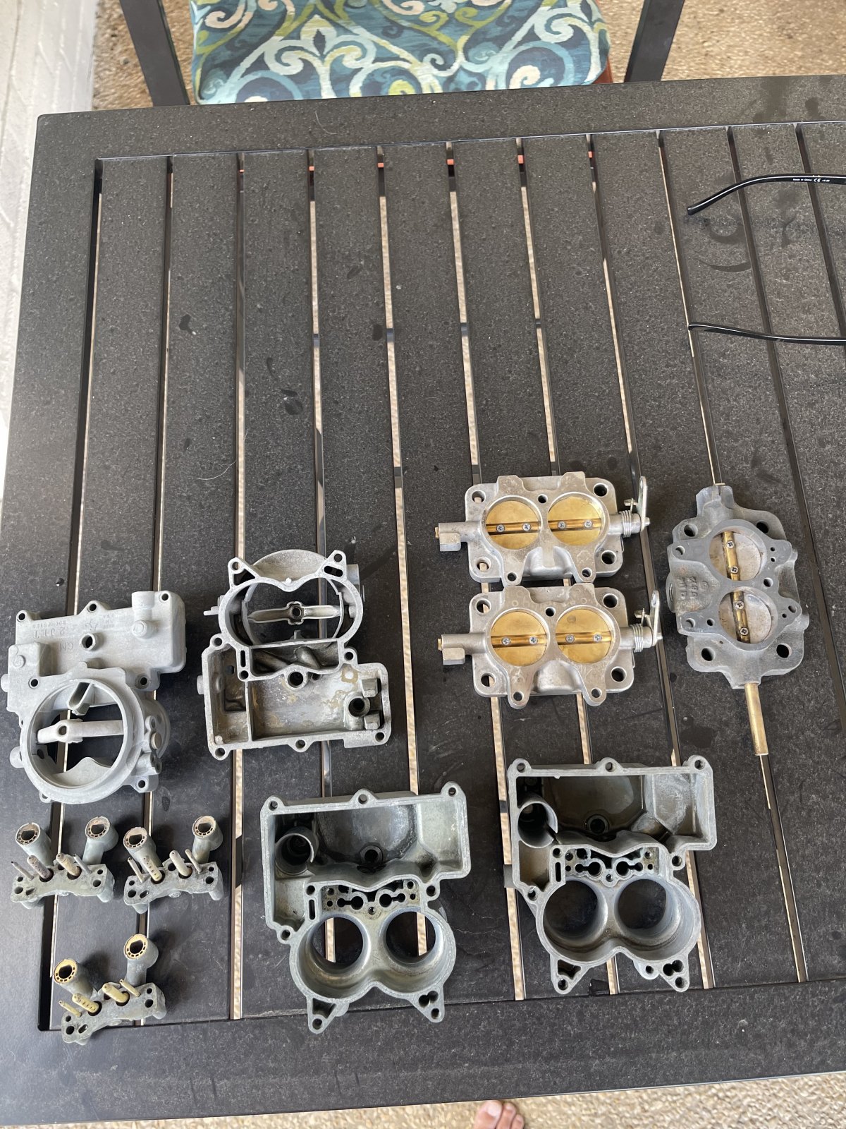

  11. Hotrod31A

  12. Hotrod31A
    Posts: 119
    Hotrod31A

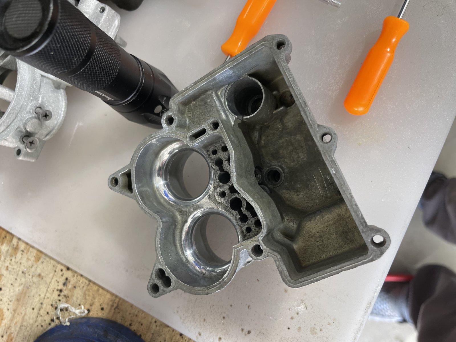

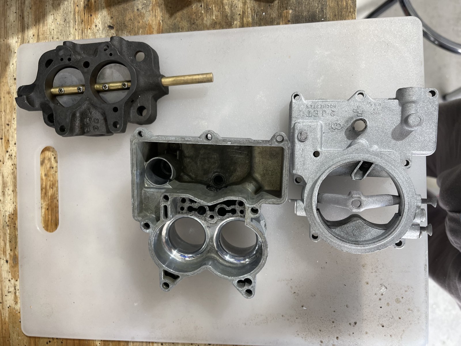

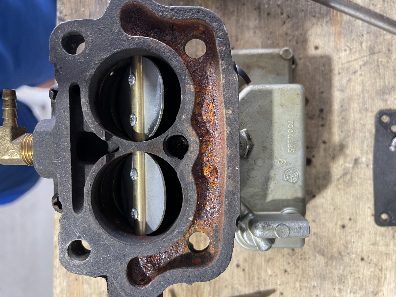

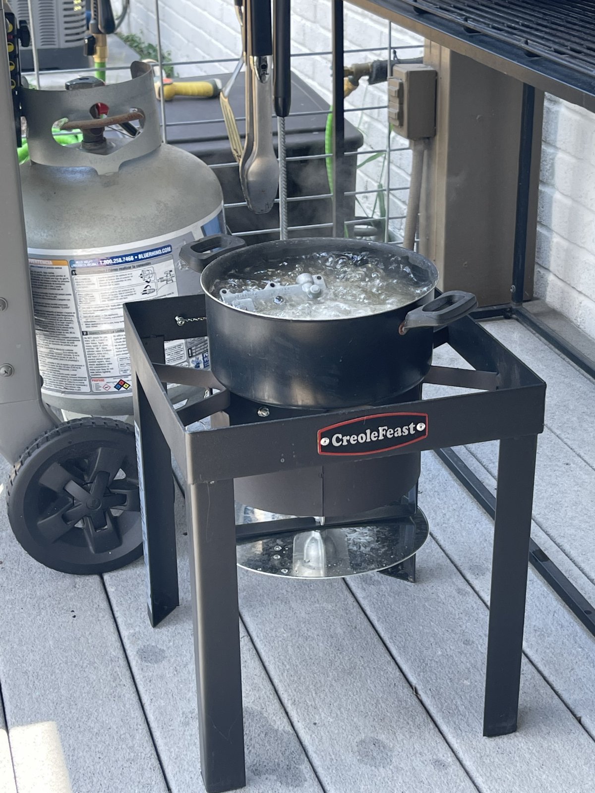

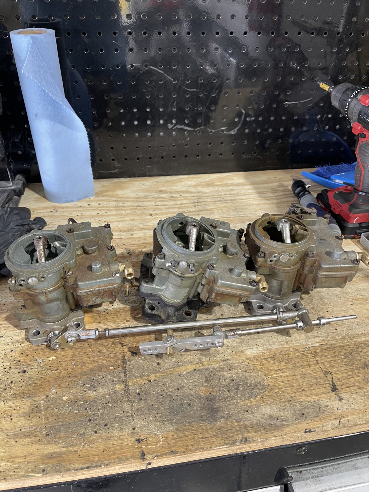

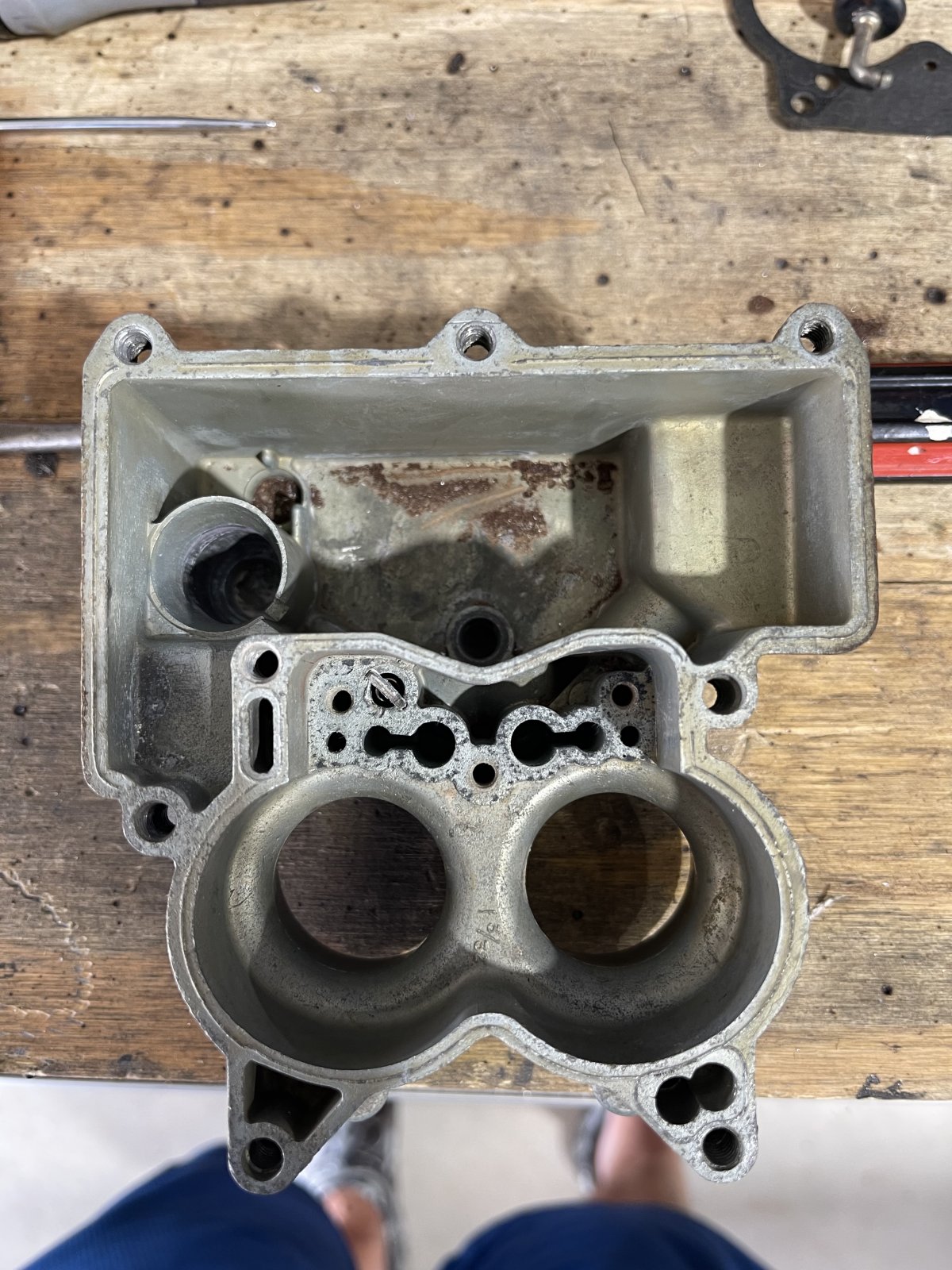

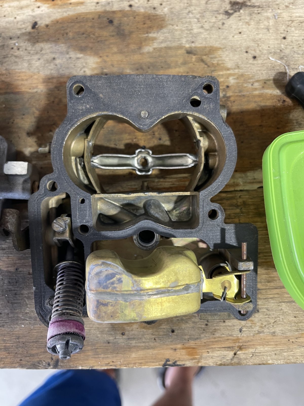

    Today’s work…media blasted carb bodies, chem dipped and boiled. Man they were cruddy! Polished the accelerator pump wells and venturies.
    Next up a paint choice to make and then reassembly when the kits arrive.
    Going to try vht gold as I can’t find a close original color for the 2gs. Plan to media blast the paint off the air horn before assembly, got in a rush and forgot the masking.
    Ditching the gold and going cerakote light tan , closest I can get. D727A823-F89D-41C8-B822-9E9CBEDE891A.jpeg

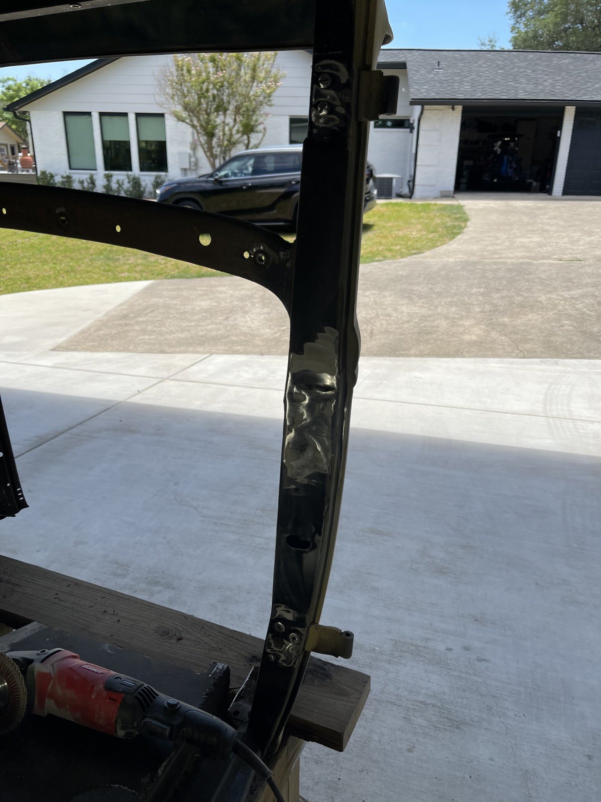

  13. Hotrod31A
    Posts: 119
    Hotrod31A
    Waiting on carb parts to finish the refurb, so I dove in on firewall removal and trimming back the channeled floors. Eventually once braced properly whole floor comes out for new subrails, etc.

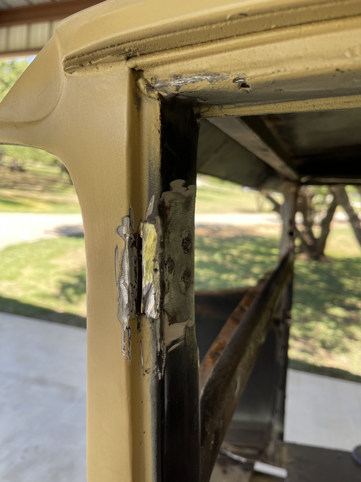

  14. Hotrod31A
    Posts: 119
    Hotrod31A

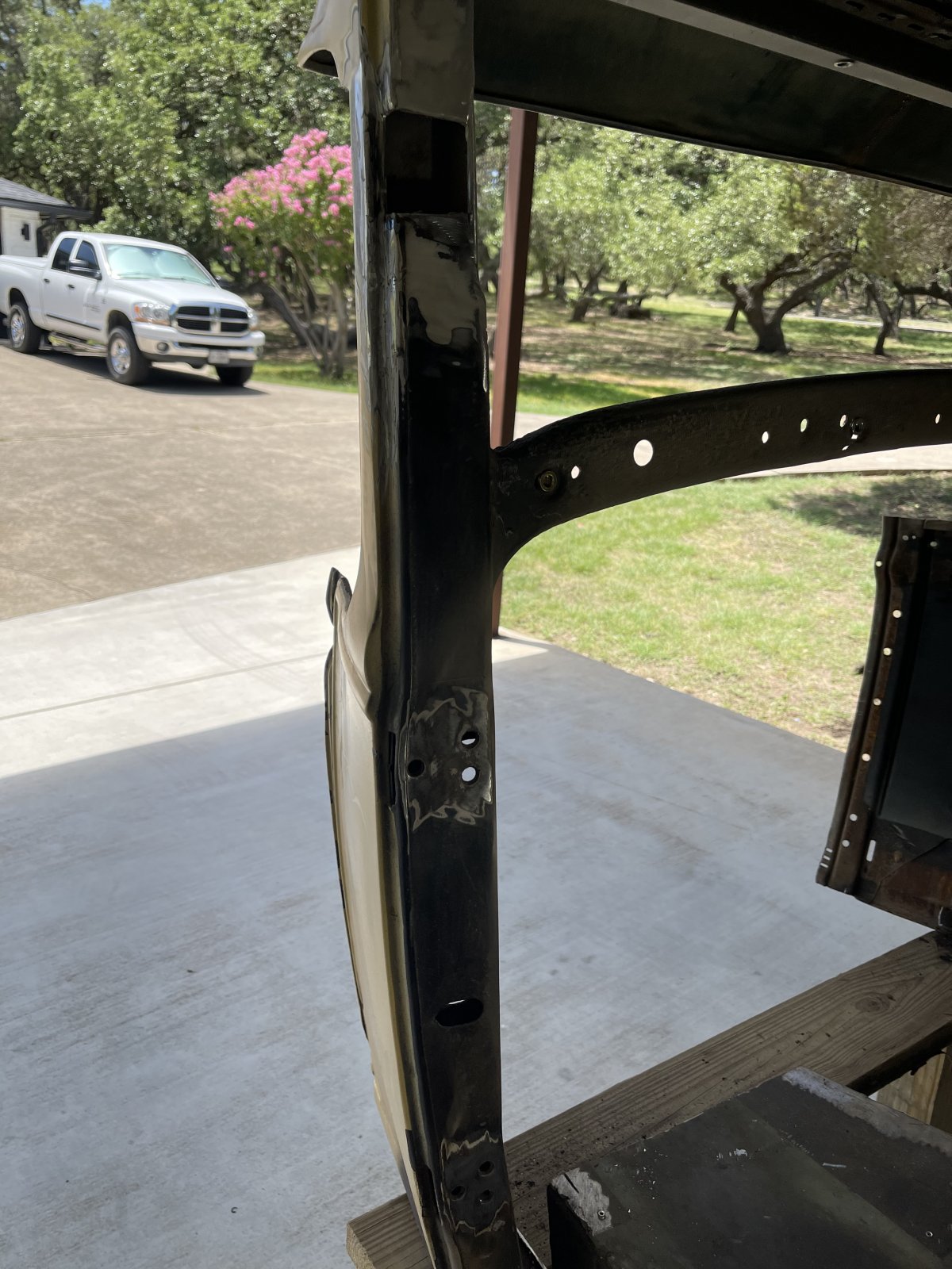

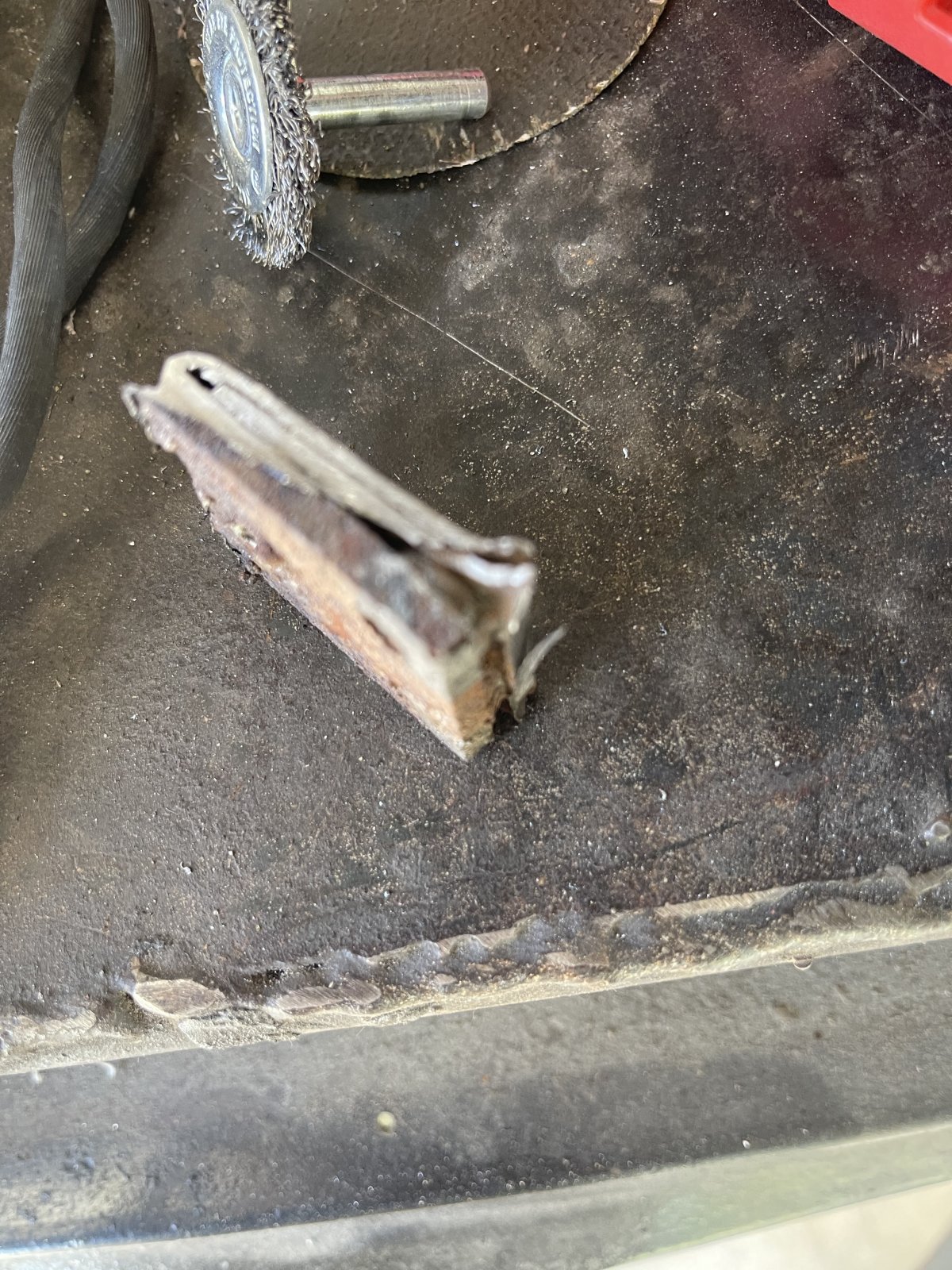

    Whomever welded the hinges on this old Bit$& I hope your nuts fall off lol. Haha what a pain in the @ss. It’s ok though I’ll fix it. Apparently someone thought bondo and gorilla weld was a good idea….. digging the mockup of the flipped firewall. Little work but beats hell out of $900 for a 32 firewall. 6C26DBAF-98CF-404D-870E-B0F2EAC8B07E.jpeg AD2FD638-BDE8-4C2C-B985-DF50531F18D5.jpeg 1CA845A8-ED8A-44FF-B8CE-B1CC46333489.jpeg 2CC283BB-8665-4968-96B0-FF49F699E8E8.jpeg A97746F2-D32C-495F-8D40-13BAA0CCFB96.jpeg A3BAC1E4-7101-4126-B03F-8D0D163A515A.jpeg FC590918-654E-4A16-B67D-C6211D28EB67.jpeg F063B4C5-5815-4399-AA2D-0A2A6CF19C88.jpeg 14F13CCC-E648-4290-8E82-6B61037C75EC.jpeg

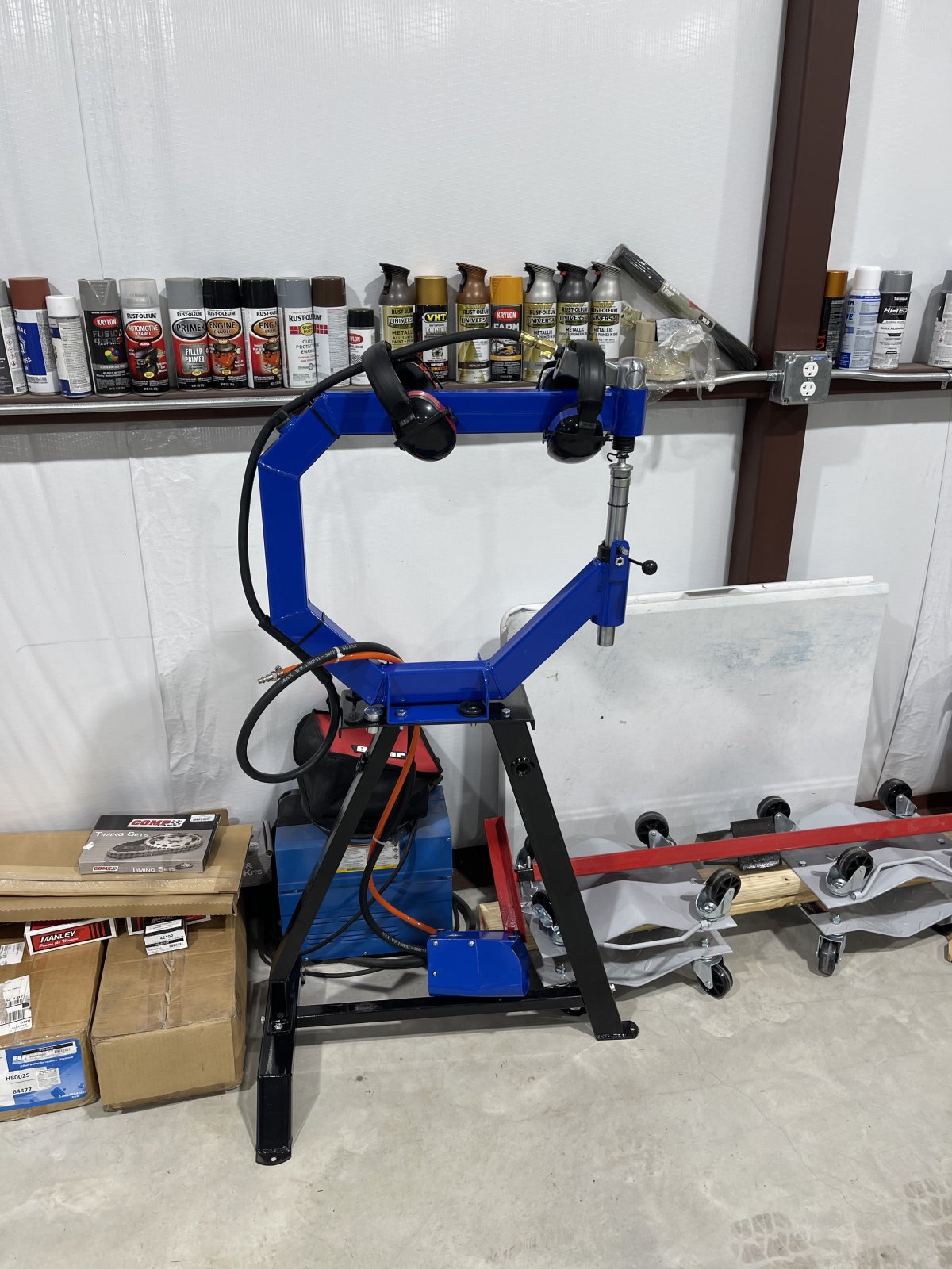

  15. Hotrod31A
    Posts: 119
    Hotrod31A
    Quick update .. one carb complete and waiting on parts. Seems All I have done is wait for parts.

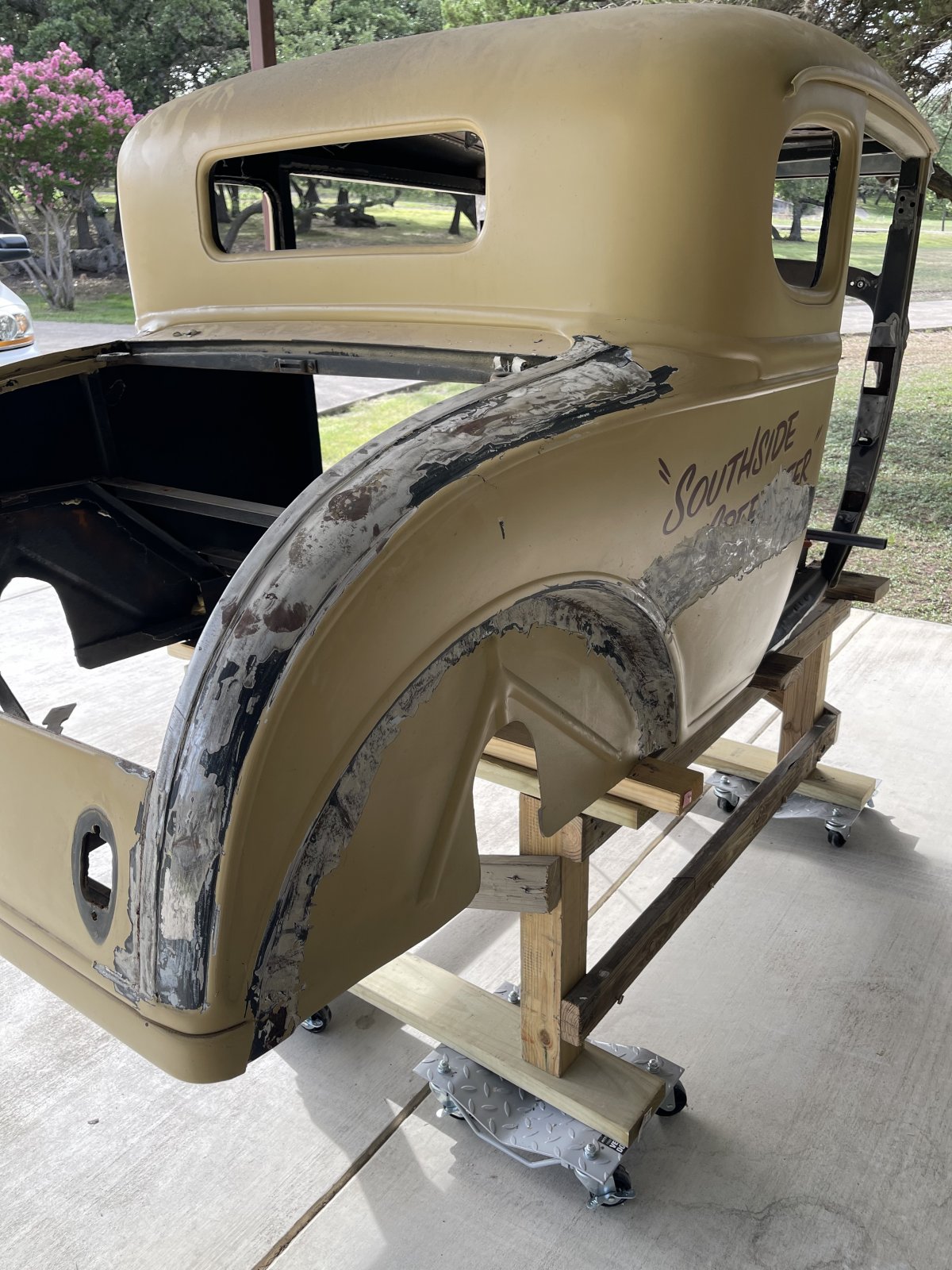

    Frame on order, engine off to the machine shop, new subrails and floors arrived at my shop. Spent Sunday afternoon scraping out the bondo from the repair areas. Good news body is pretty solid other than the drivers 1/4. Test fit one of the panels to get a feel for what I’m in for. Datumed up perfectly except for the wheelwell body line. Maybe a pie cut and shrinking will be the answer to get it lined up?
    Studying the subrail dimensions from a few old posts here in order to move forward. Trying to get a handle on how to brace and stabilize the body before the old floor cutting begins.
    Also a new tool showed up today to help with the 1/4 repair. Nothing like a new toy for the shop! 74764F5F-1F60-440A-8B33-07F69AB1BF28.jpeg C9DA8831-D61A-4111-96F9-2E4D99892F24.jpeg 7A251560-FB18-4CFA-88FA-552B24D2AFB7.jpeg B878398F-BA94-4937-83B5-9721B808D010.jpeg CD8EC54E-4C89-4960-B166-2D0E94FBA4B2.jpeg 47EBC42C-041B-40DD-BEBC-DC1B8774C4C9.jpeg

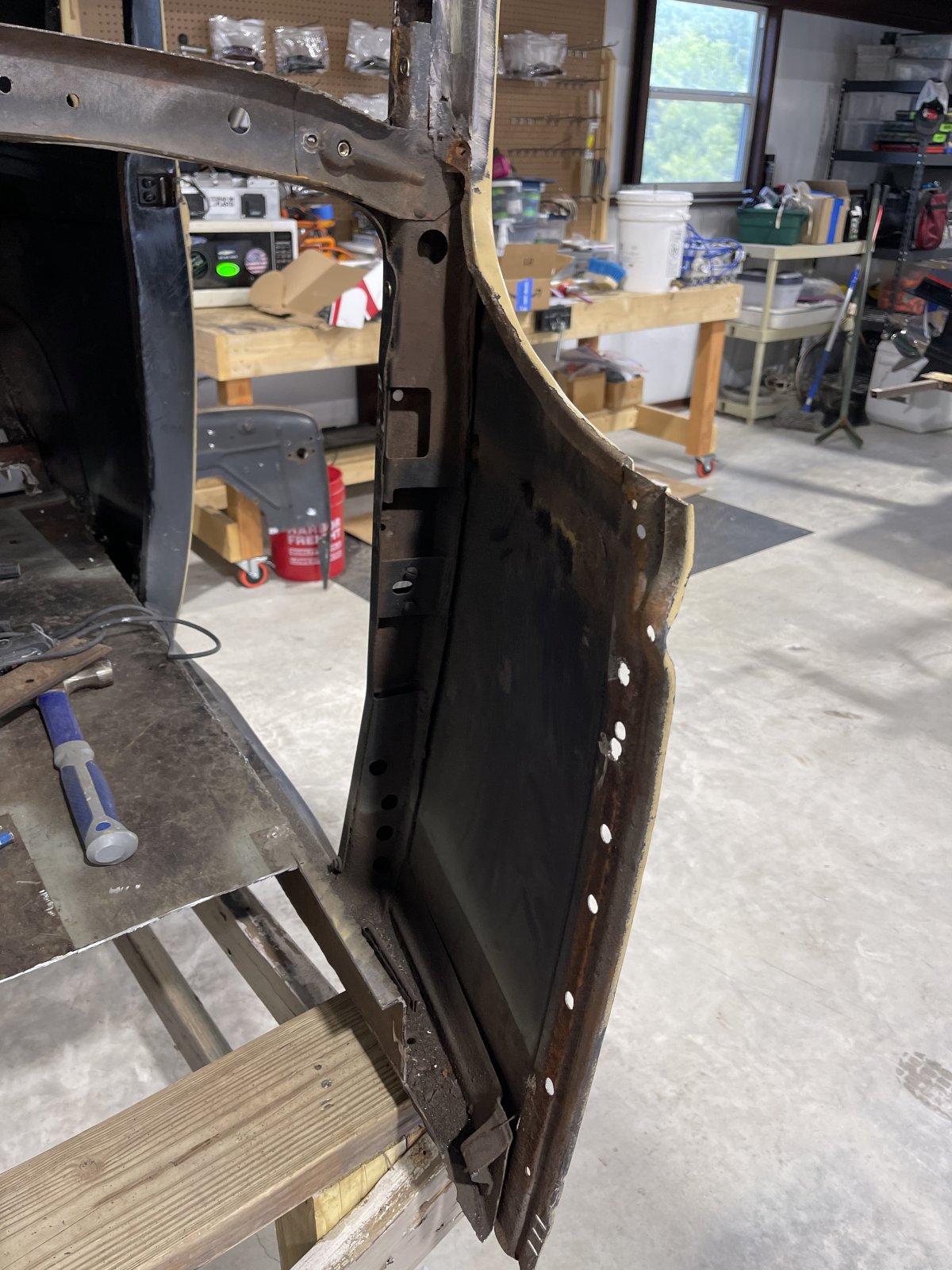

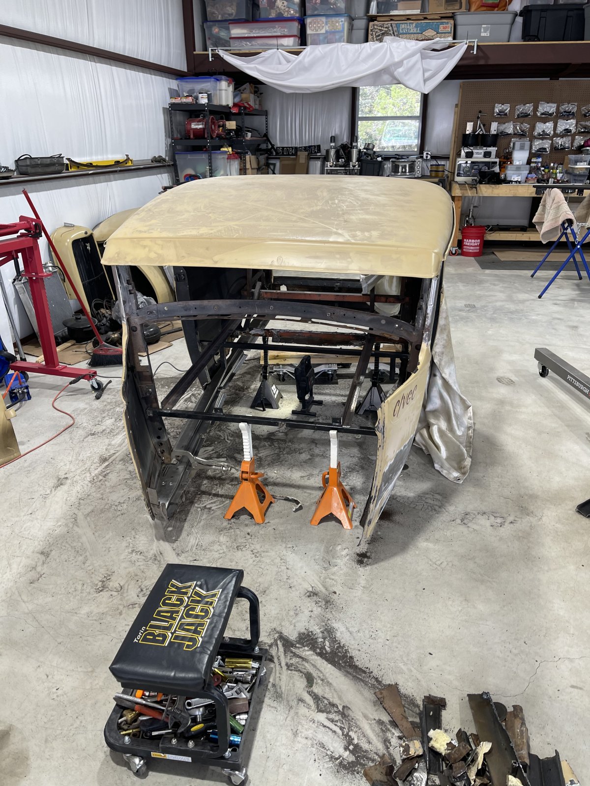

  16. Hotrod31A
    Posts: 119
    Hotrod31A

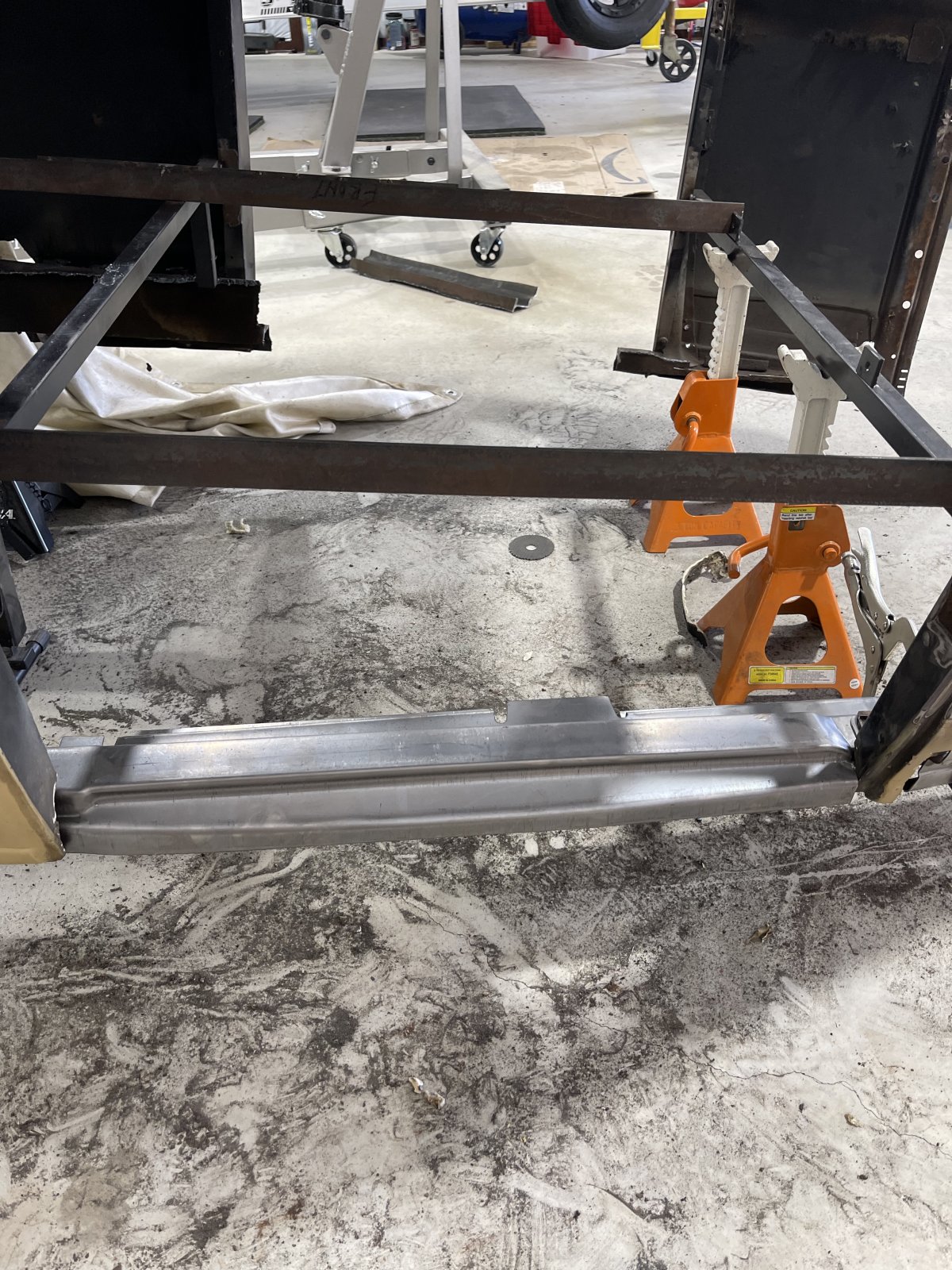

    Floor demo day.
    Old channeled floor disaster is cut and gone. Only original rails left to be removed. Old Girl is fighting me every step of the way.
    next up set the body on jackstands and start the surgery with the cutoff wheel on remaining subrails.
    9CD7B16C-A3C0-4E94-83A3-91B4106F1E2A.jpeg 5E09322C-F4E9-4C6F-A4F3-92C34331539E.jpeg

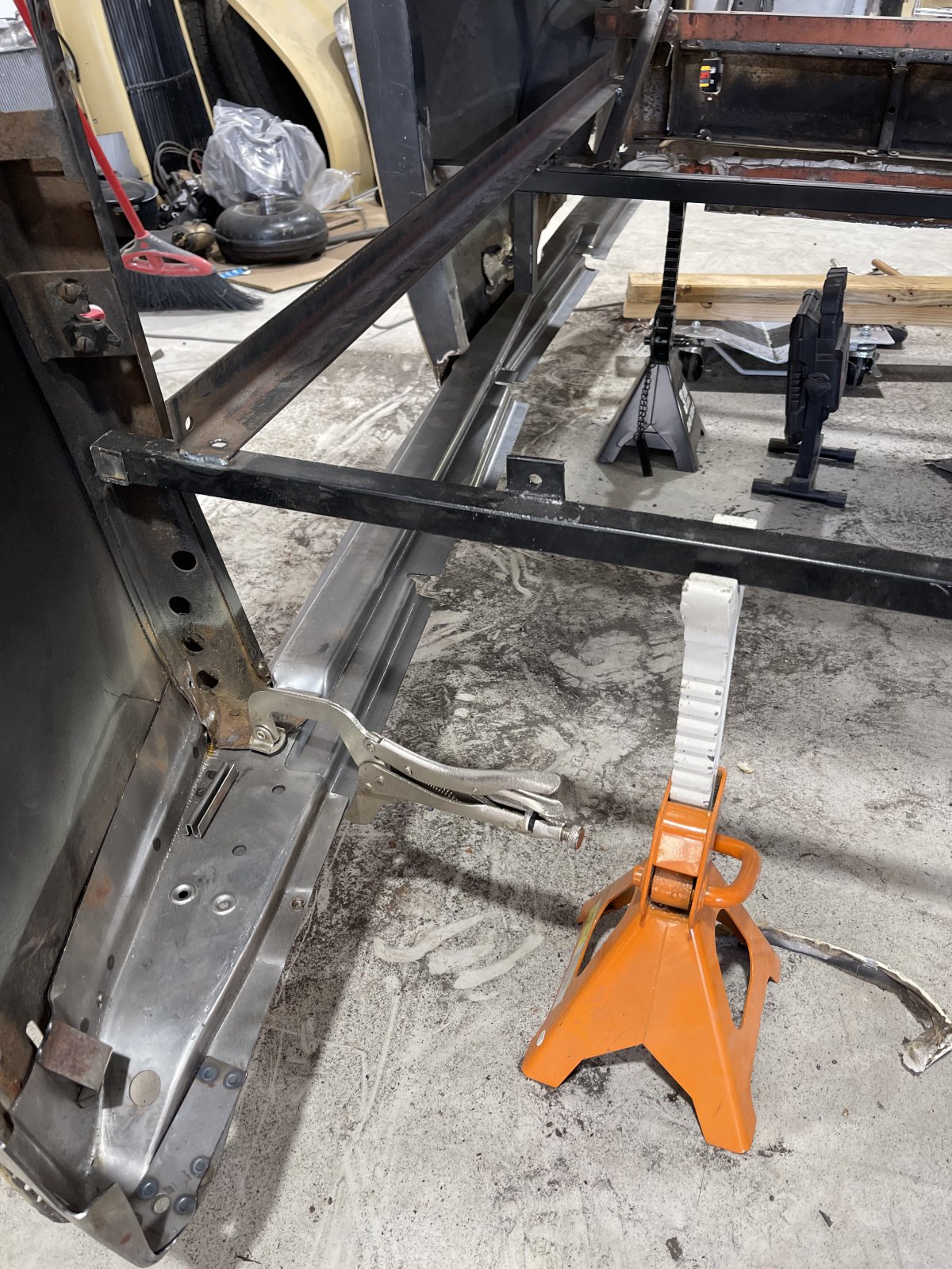

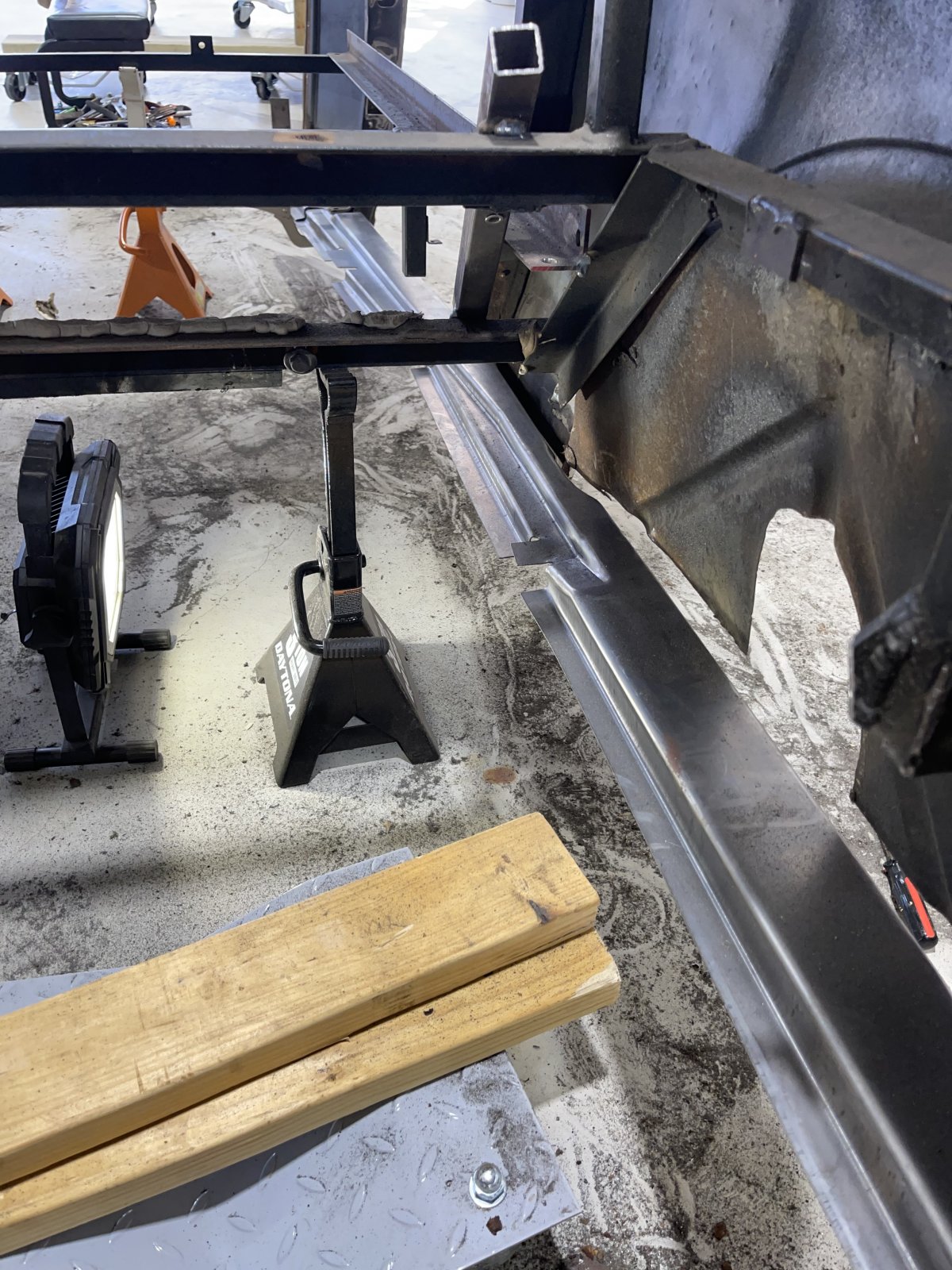

    First mockup on the passenger subrail and extension. Whew what a task. Plenty room for fit improvement, just wanted to see one clamped in after all afternoon grinding and cutting. Learned with this one , driver’s side should be a little easier.
    Will dry fit firewall and use it and rear crossmember as subrail datum points then tack or pop rivet rails for temporary fit and confirmation measure. Full spot weld after frame arrives and I confirm subrails to frame is good fit.

  20. -Brent-
    Joined: Nov 20, 2006
    Posts: 7,367
    -Brent-
    This is coming out really well!
    After seeing that body lift bracket, I went to eBay to search for it. Any tips what words I need to use to locate one? That thing looks like it could be my new best friend!

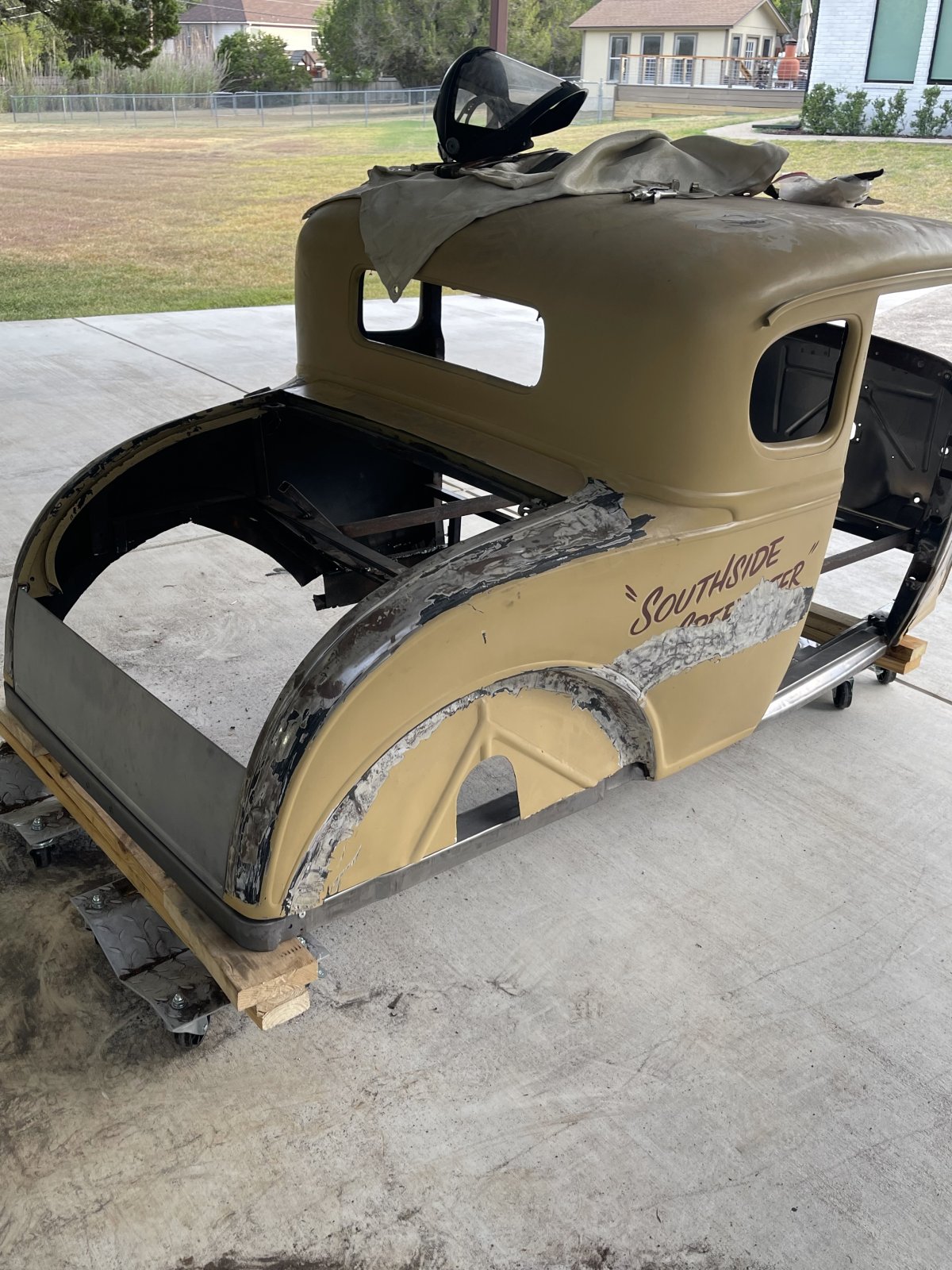

    Very cool project! A couple questions, do you know what color is currently on the car and how much of a haircut was done to it?

    Hotrod flatz Buckskin. Chop is a 4 1/2

  23. Hotrod31A
    Posts: 119
    Hotrod31A
    Look for champ bed and body lift.
    31chevymike and Stogy like this.
  24. Hotrod31A
    Posts: 119
    Hotrod31A
    Champ is brand name
  25. Hotrod31A
    Posts: 119
    Hotrod31A
    It works well but will need to balance / stabilize rear of your car. During the lift My car was a little tail heavy.

    The Buckskin Tan gives the car a vintage feel and I thought anything more than a 4” chop was too much. I like!

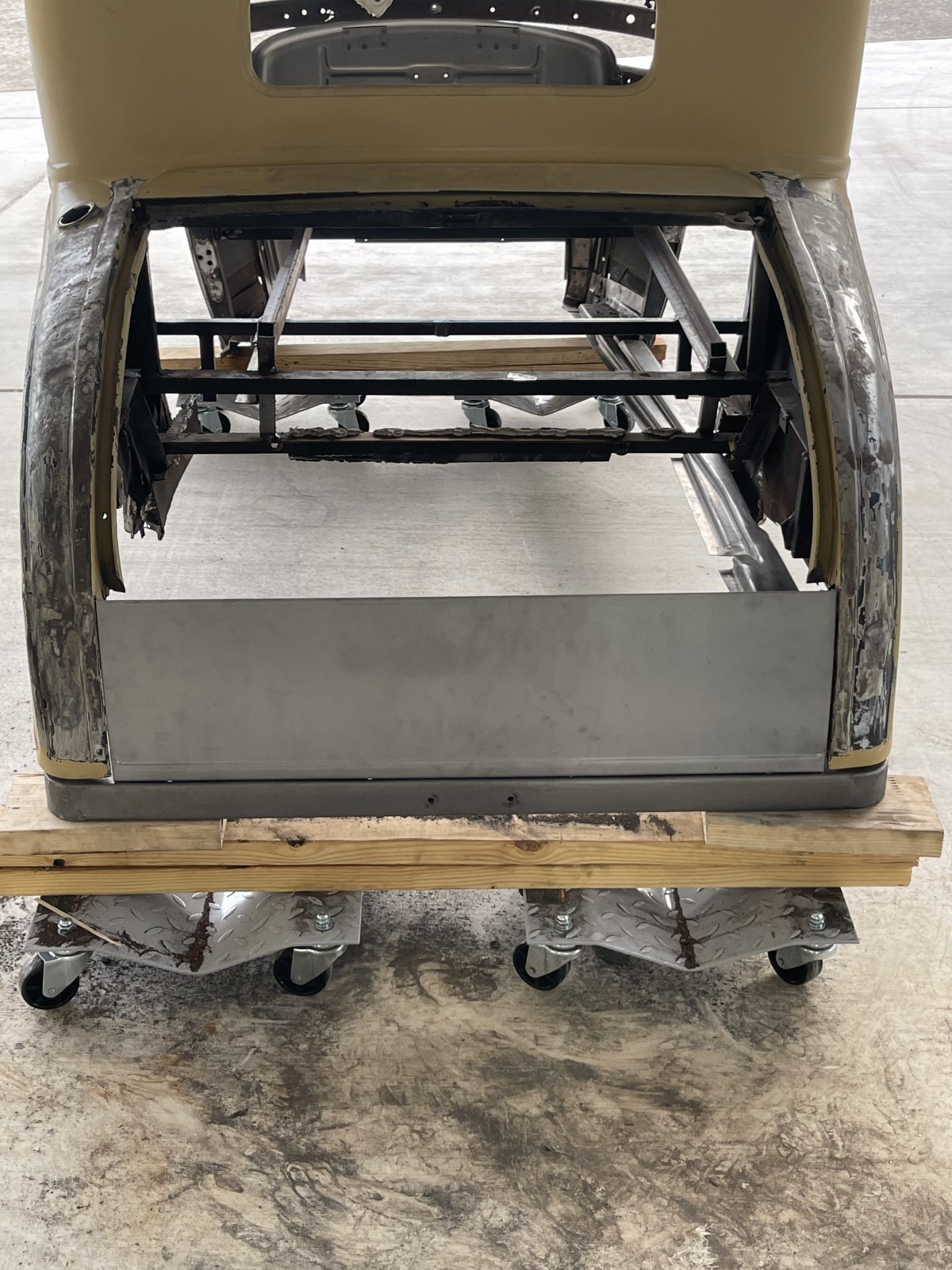

  28. Hotrod31A
    Posts: 119
    Hotrod31A
    Short day in this Texas heat wave. 115 in the ole hotrod garage.

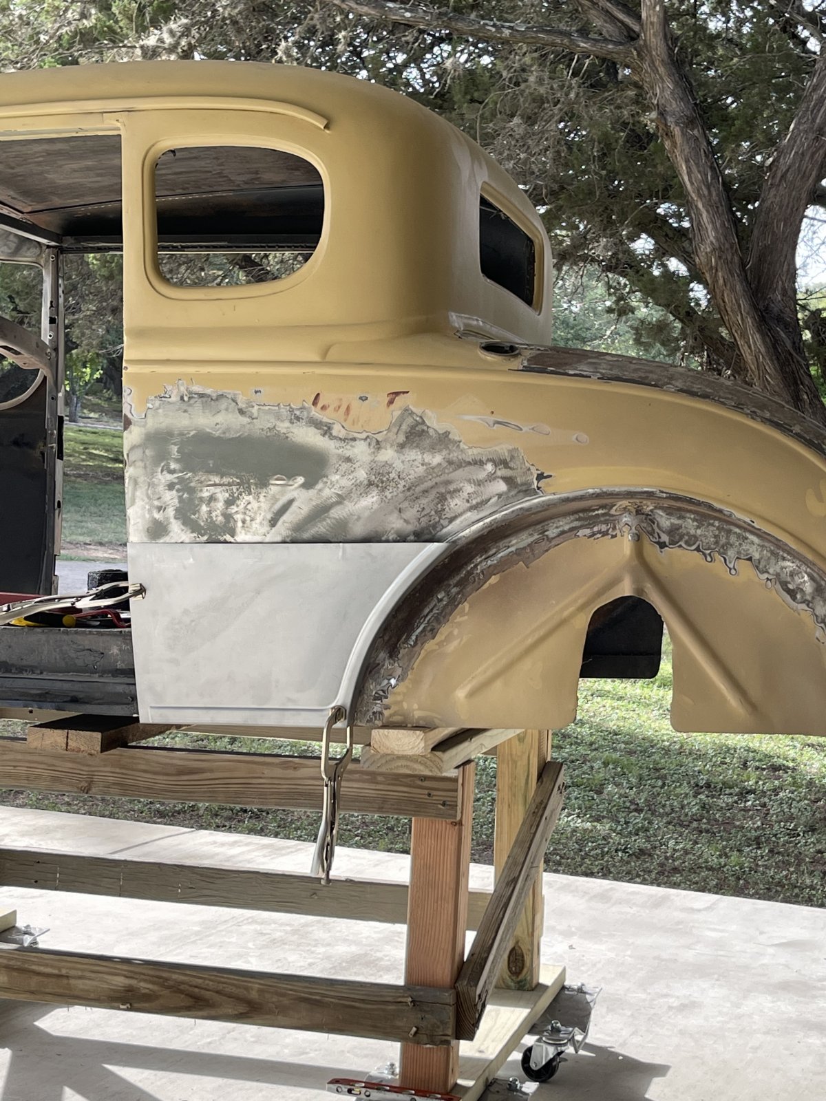

    Dry fit the lower panel and a new rear crossmember. A few pop rivets and screws and it’s good to go for a temporary fit up. Drivers side subrail is next.
    A little bead roller practice in my spare time practicing for the 1/4 panel work to come
