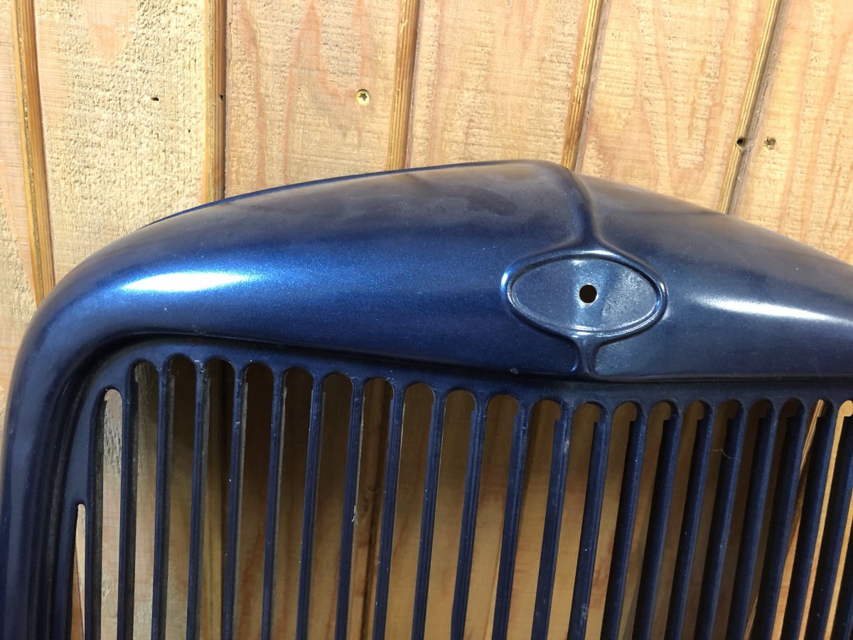

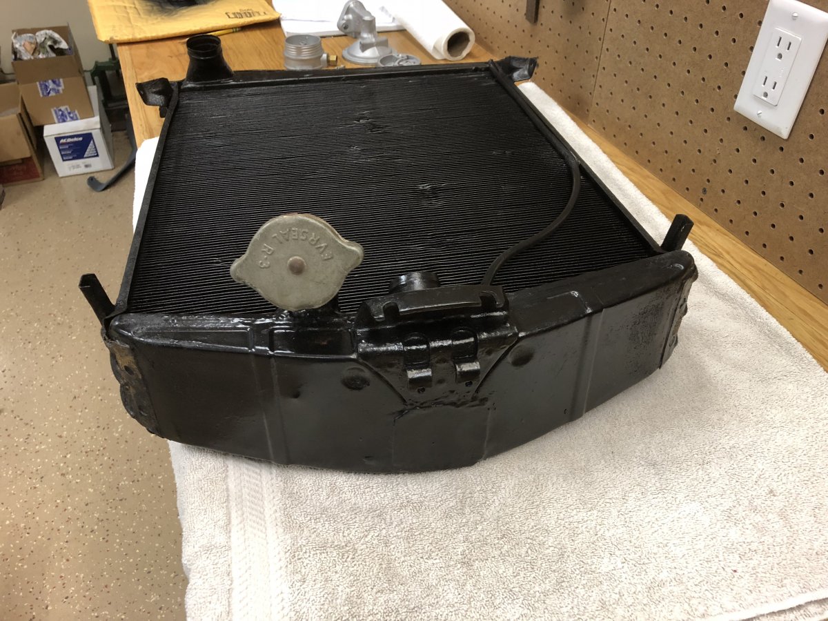

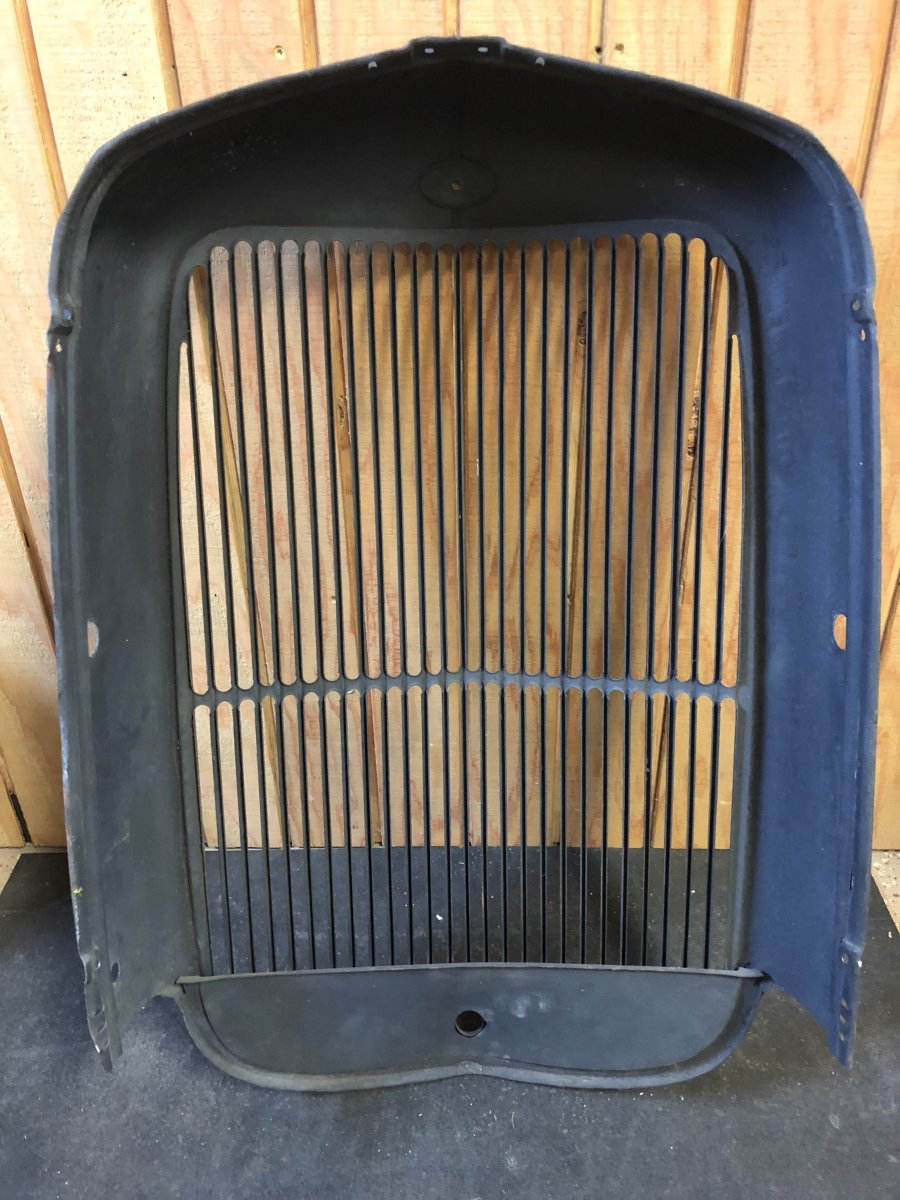

    From what i can have seen i think this grill is form a 1932 commercial truck or van.
    It fits the radiator and was in with the parts that came with the car. Some one did a nice job
    of welding the filler hole in the top of the grill. Can someone confirm what the grill and radiator are from? IMG_1560.jpeg IMG_0520.jpeg IMG_1559.jpeg
  4. 31Apickup
    Joined: Nov 8, 2005
    Posts: 3,379
    31Apickup
    Grill shell is commercial 32 ( pickup or truck), radiator looks like a modified original 32.

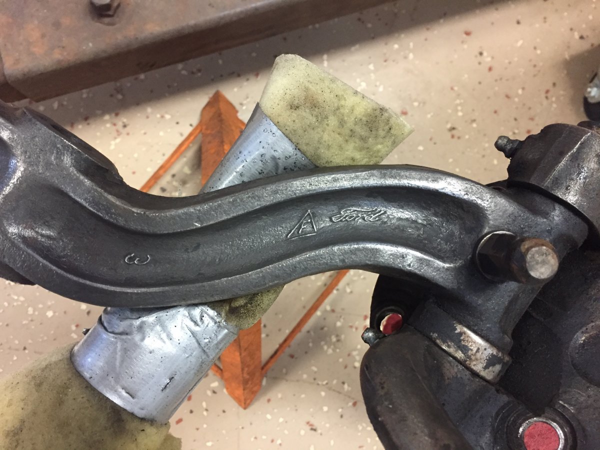

    Frank bought the dropped axel from a speed shop. How do i figure out how many inches the axel was dropped? Did they bend them different sizes? What do the stamping mean? #3 and the F in the triangle. Just like to know what this is. IMG_1952.jpg

    thanks for that info

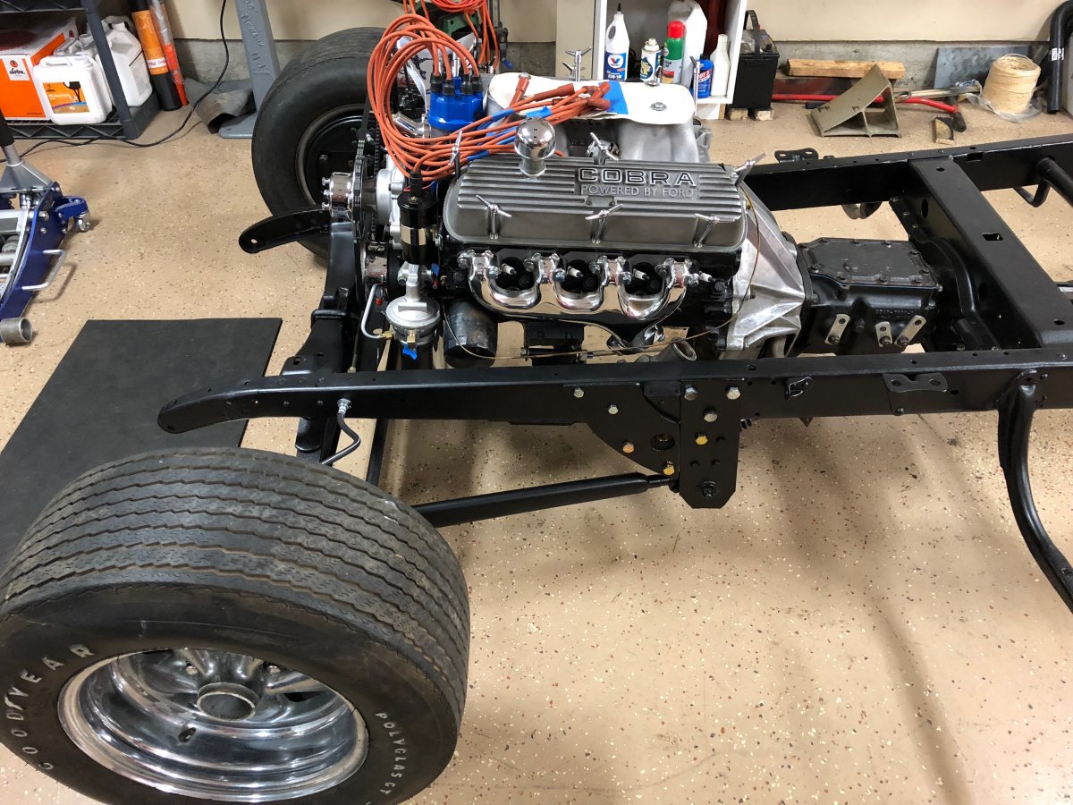

    Here is the set up that he built. If i were 17 and back 1954 I might roll the dice with this set up.
    The holes in the rear bumper bracket to hold the top shock bolt were made with a torch.
    He loved the torch , seems like the torch was his go tool. He made brackets and Gas welded them to the axel. Frank told me he became a certified gas welder. This car must have been his first go at it. The swing arms he cut off an old car in the junk yard . He could not remember what car they came from . It's only been about 65 years ago. And the shock bracket looks like some thing from and old impala. IMG_1933.jpg IMG_1936.jpg IMG_1981.jpg

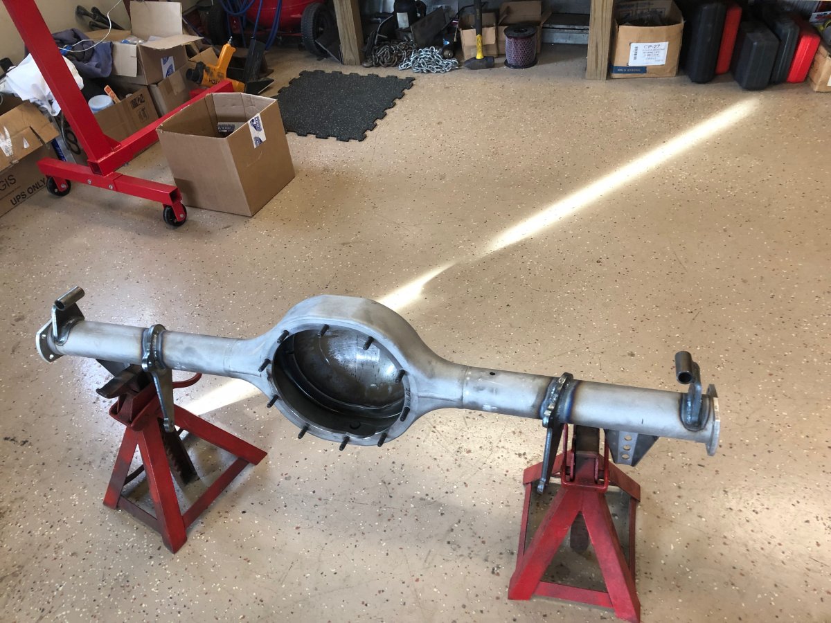

    Cutting the brackets off the axel was taking forever and i could not get the grinder inside the bracket to cut the inside weld so i went to the torch. After i torched them off i noticed the tubes were bent.
    I think that was from the heat but i am not sure if they were bent before . Also the axel is too long and the tires are too many inches away from the body of the car. I decided to get a new housing.
    I had Pete and Jakes make me a new set up they welded the spring mount and shock mount.
    I liked the look of the ladder bars so i now have ladder bars. IMG_2246.jpg IMG_2245.jpg IMG_2244.jpg

    Could that be a symbol of Forged...that's a pretty uniform drop it seems...I gonna guess 3"...

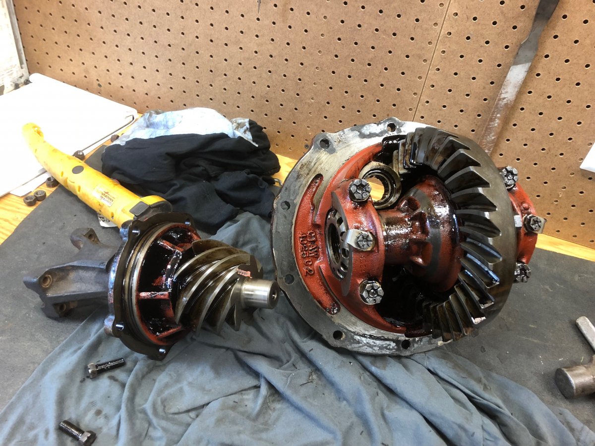

    I took the 9" ford rear apart and found an opened differential . After counting the teeth on the ring and pinion gear it has a 4.57 ratio. At first i though i would leave the 4.57 , but it might be too much for a beer getter. So i installed 3.89 set. I could always pop the old set back in if i need to.
    After watching a few videos ( many times) I installed new bearings, seals and the gear set.
    Also installed a Detroit Truetrac diff. IMG_0454.jpg IMG_2362.jpg IMG_0519.jpg IMG_0513.jpg IMG_2392.jpg
    The housing had a red paint so i cleaned it up and used the same color. and gears.
    Told the wife I need to buy a dial indicator so i can save some $ installing this my self. Ha Ha

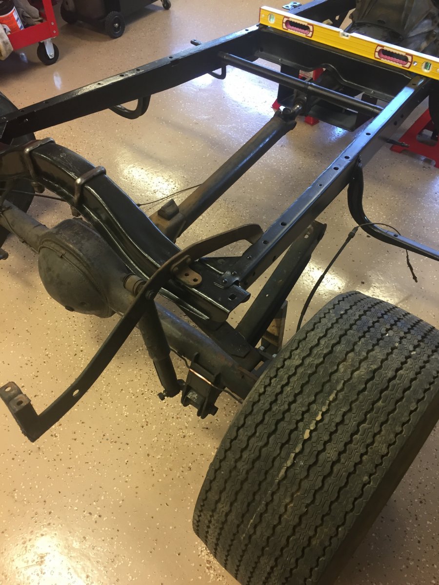

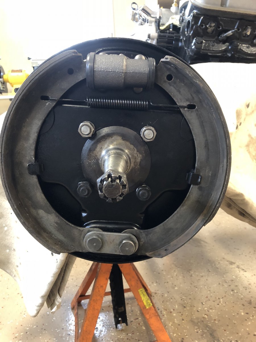

  17. ModelARon
    Joined: Jun 14, 2017
    Posts: 363
    ModelARon

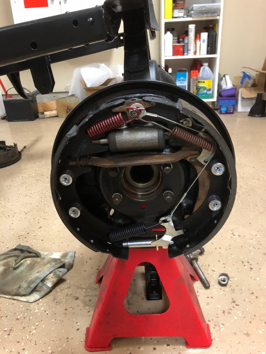

    Working on the rear brakes i had a problem with the spring mount . The brake cylinder was behind the spring mount. I had no clearance to attach the brake line. So i welded the holes on the plate. Drilled new holes and rotated the rear plate so i could screw in the brake line. I clamped a copper spoon behind the hole as i welded the holes. The best i could tell the brakes are from a 1961 Galaxie IMG_2559.jpg IMG_2558.jpg IMG_2557.jpg IMG_0504.jpg
  18. ModelARon
    Posts: 363
    ModelARon
    After installing the stock spring the car seemed too high. So i went with a reverse eye spring that will bring the rear down . Installed the ladder bars IMG_2071.jpg IMG_2964.jpg

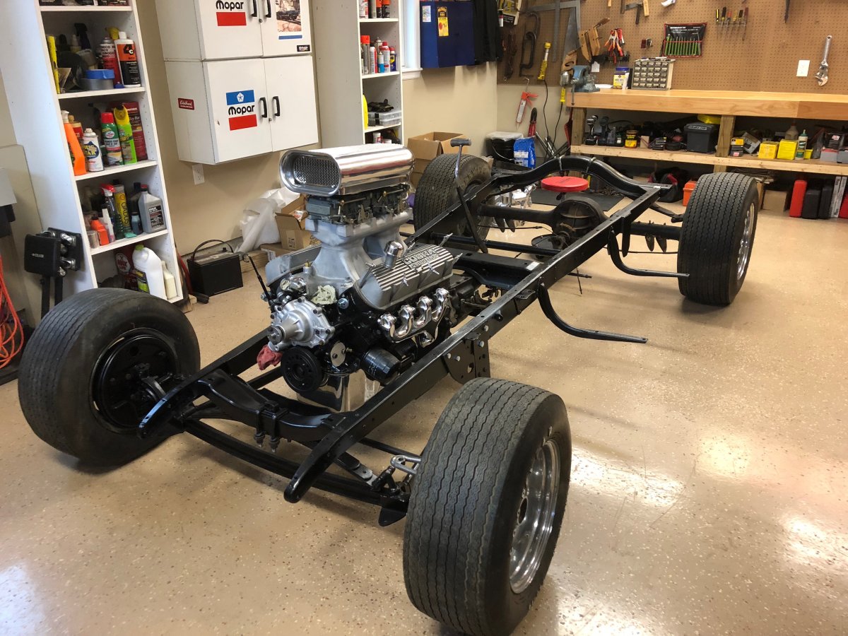

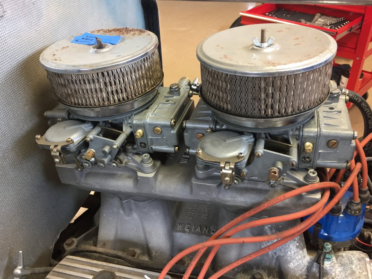

    The tunnel ram had some mice living on it and they made a mess that i could not clean off.
    I had that part bead blasted. The engine was clean inside so i installed new water pump, oil pump , gaskets . I rebuild the holly carbs , they are 4160 390 cfm . I though the Hilborn style scoop would fit this 60's hotrod IMG_1427.jpg IMG_1428.jpg IMG_1562.jpg IMG_1706.jpg

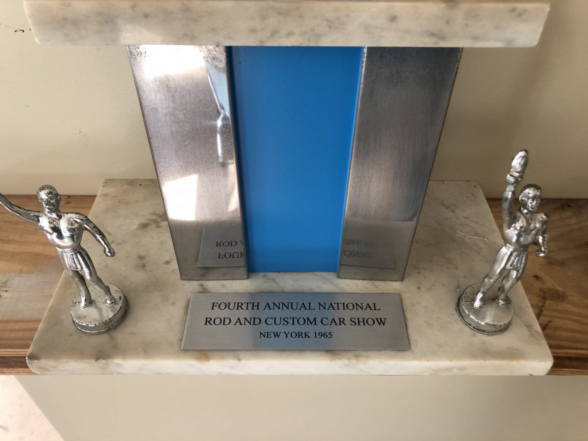

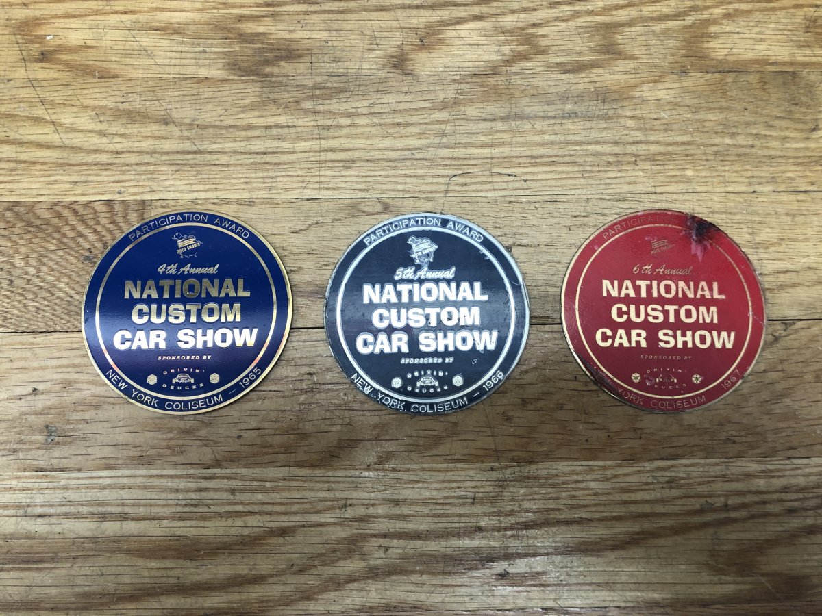

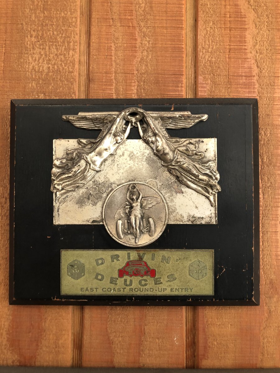

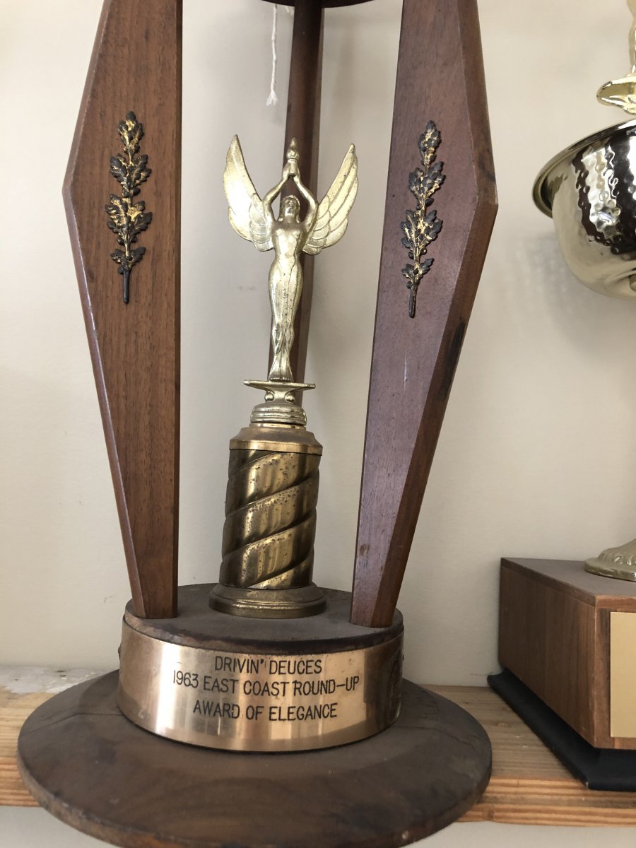

    Talking with Frank one day i asked him if he had any other items from the car.
    He told me he had some old trophies in his garage that he almost tossed in the garbage last year.
    IMG_3051.jpeg IMG_3050.jpeg IMG_0730.jpg IMG_3052.jpeg IMG_3053.jpeg He said he would give them to me but he would not ship them.
    I was surprised he kept these for so many years. So i drove up to New Hampshire one weekend to pick them up. I cleaned up the trophies . Two of the trophies are in the picture from 1965 at the show in the New York Colosseum . He won the blue trophy that year. Drivin Deuces was an old car club in North Jersery.

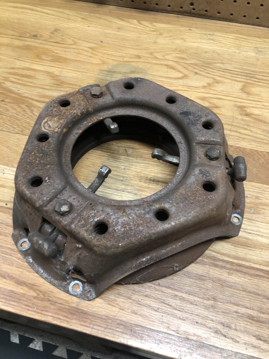

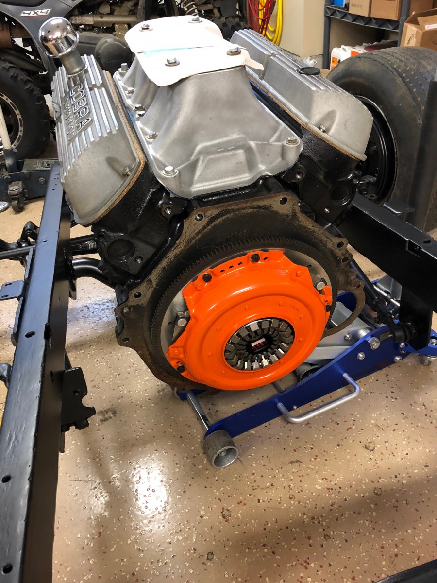

    I had the flywheel cleaned up. The old clutch look good but I wanted something better. I installed a Center Force Dual friction clutch. IMG_3073.jpeg IMG_0496.jpg

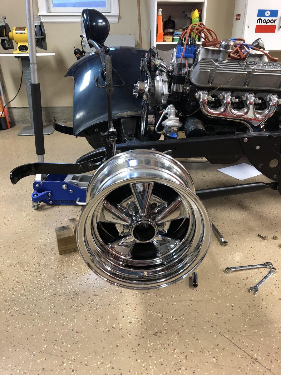

    The front brake cylinder must be real old, i have never seen one that was made by Lockhead.
    Checking the rims to make sure they fit. I am keeping the drum brakes look great. I am thinking about installing Lincoln style front brakes because i read they have better stopping power . IMG_2848.jpg IMG_0512.jpeg IMG_0680 2.jpeg IMG_0679 2.jpeg IMG_0411.jpg

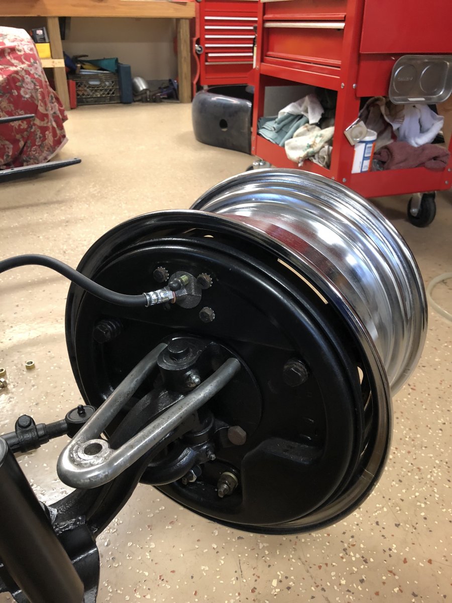

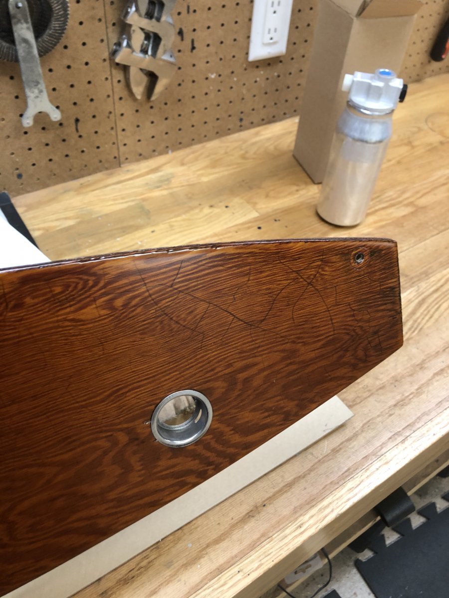

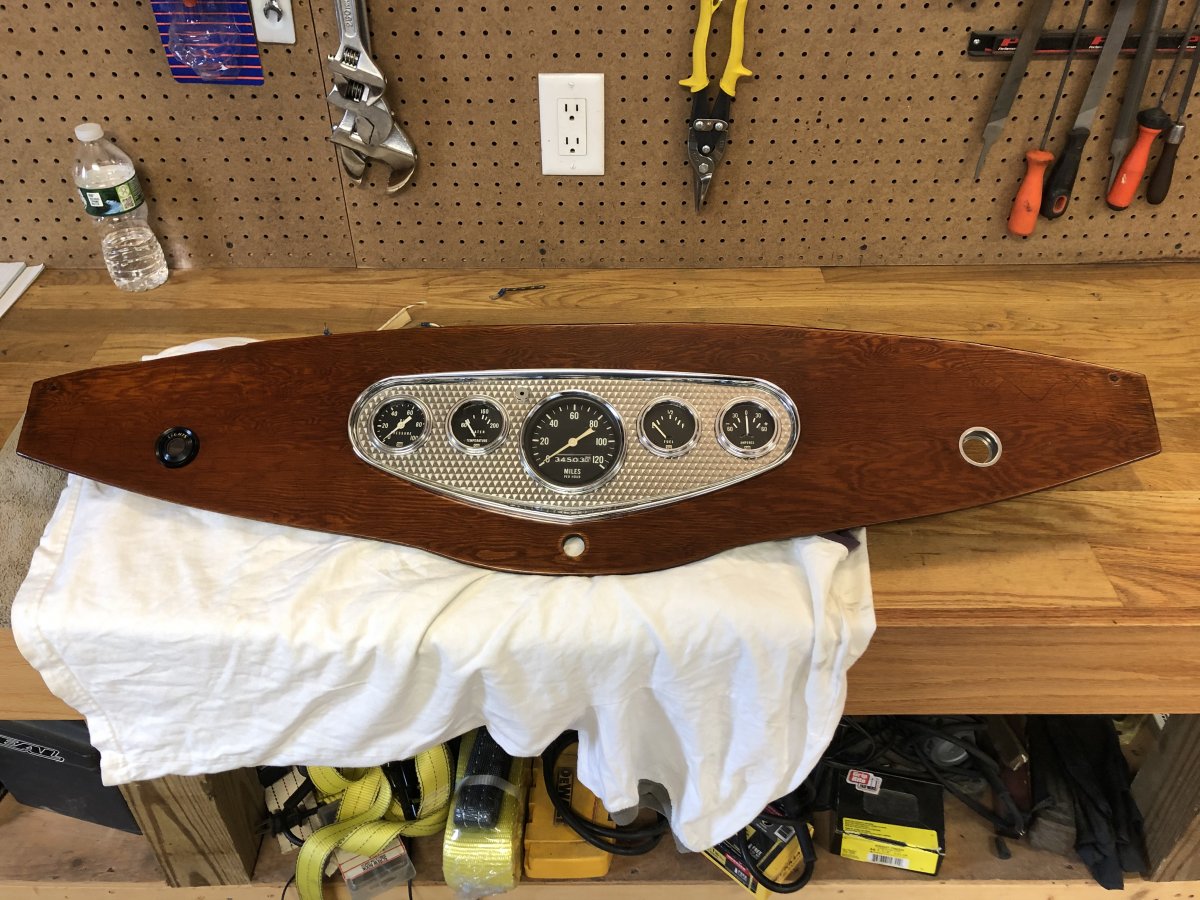

  30. ModelARon
    Posts: 363

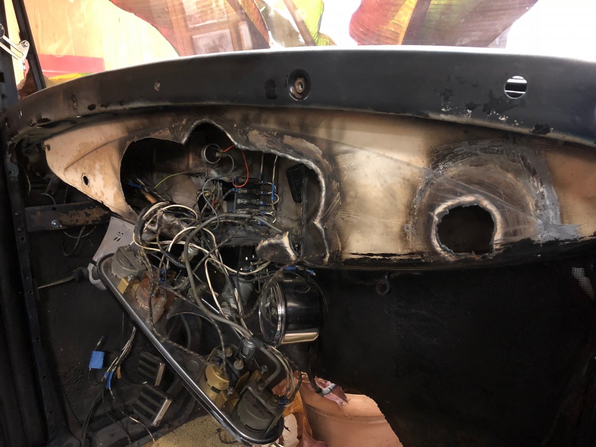

    ModelARon
    I cleaned up the dash and gauges. I didn't want to strip the wood and lose that patina and the cracks in the finish . I just gave it a coat of tung oil finish IMG_3083.jpeg IMG_0792.jpeg
