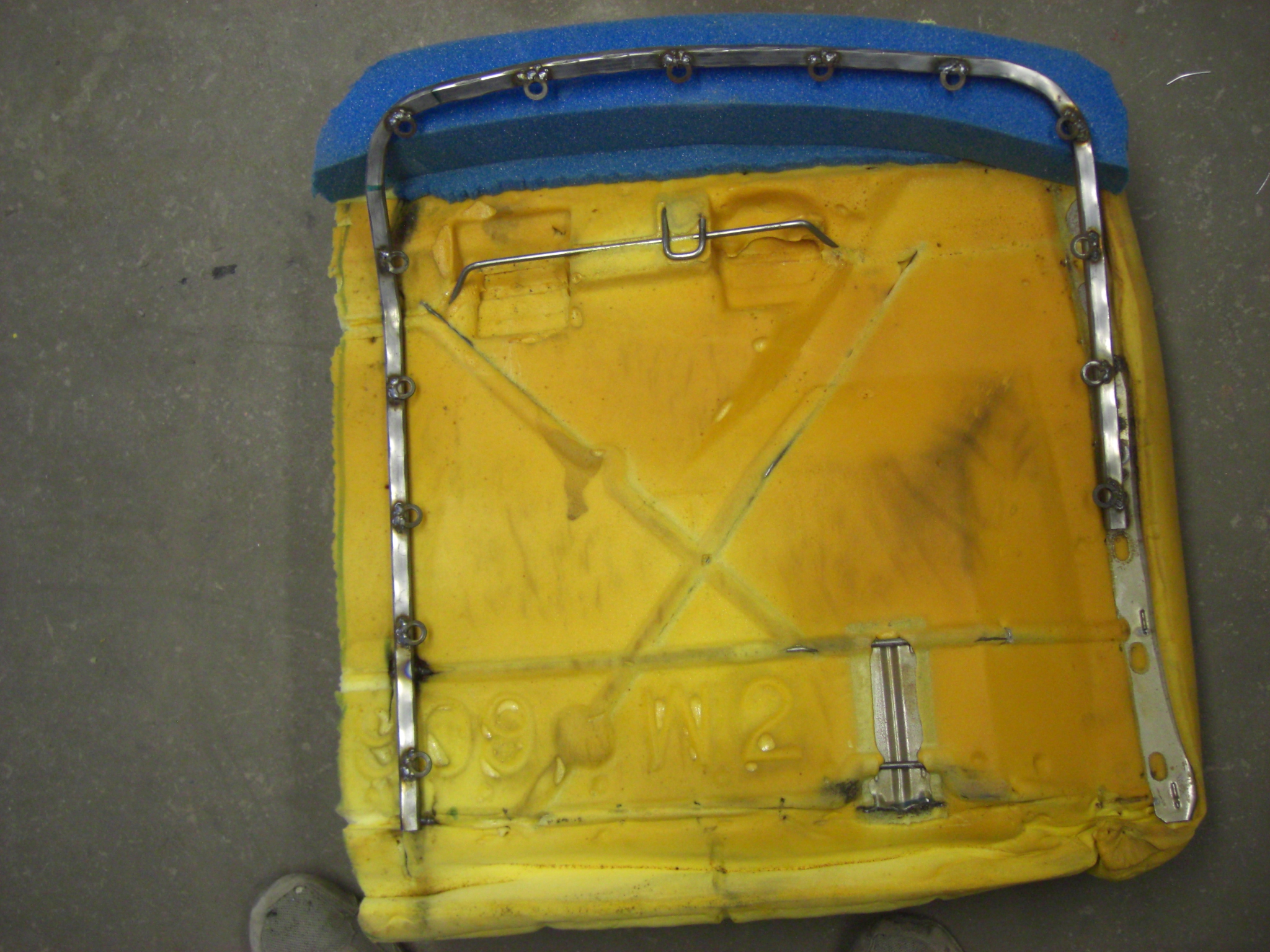

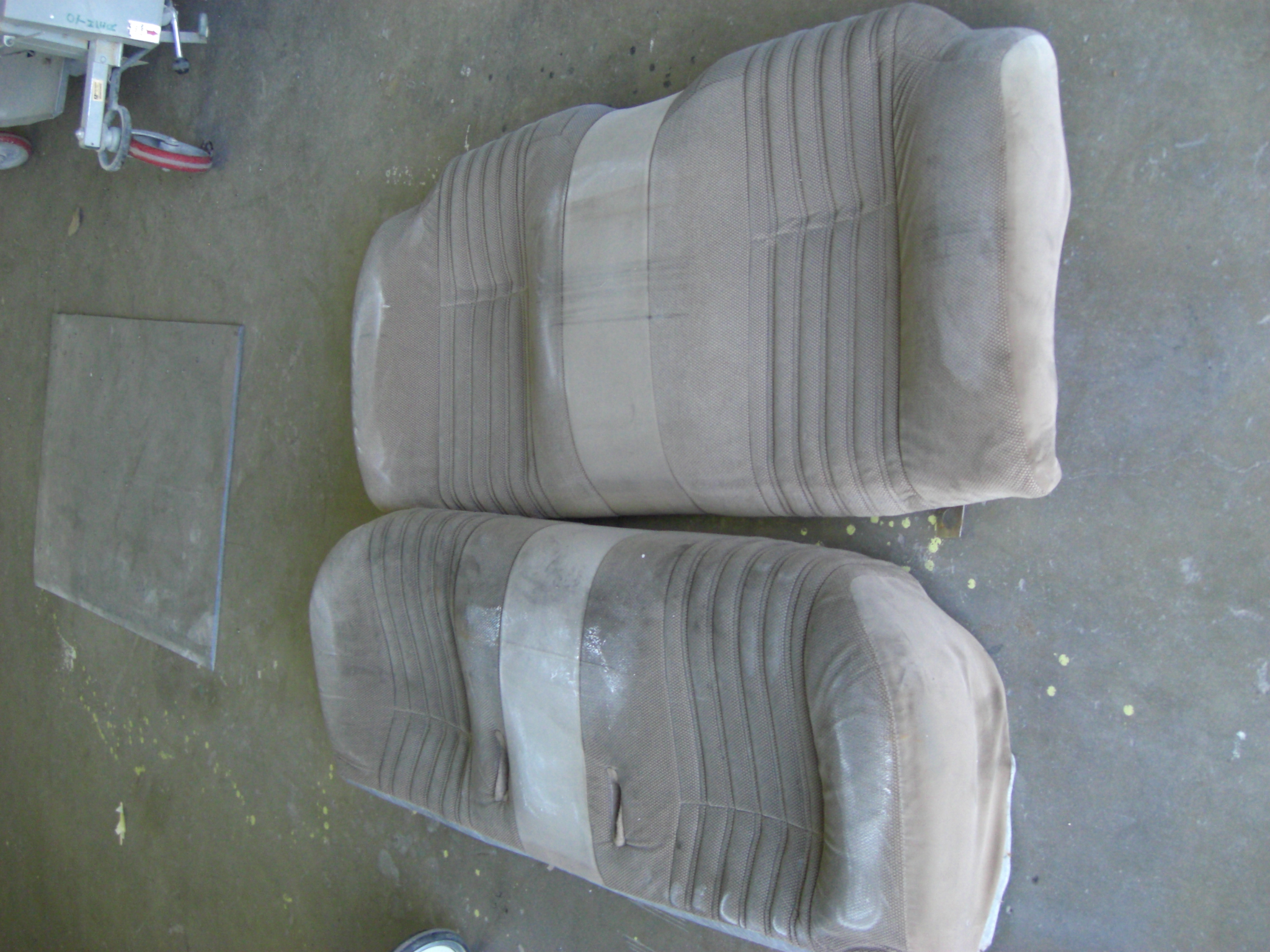

    The upholsterer did a great job. They look like real Corvette seats! We're going to trade for a little paint work on his wifes Yukon . The seats fit snug in the cavities. To adjust seating position I just stacked dense foam rubber behind the seat to get the right leg room. They are much softer and therefore more comfortable than stock ones . I also fabricated the all important roll bar. I welded some mandrel bends together and attached it to the original soft top frame mounting points. 175.JPG 176.JPG

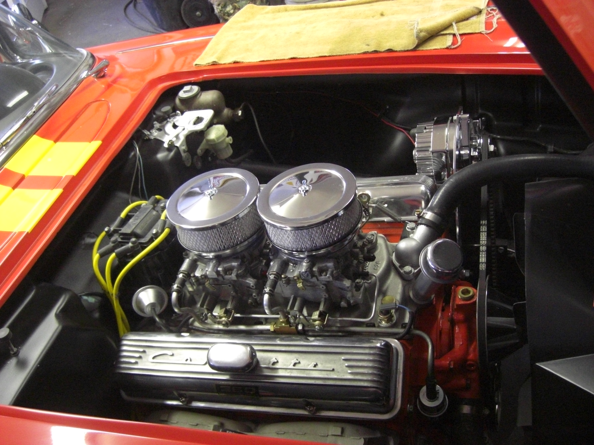

    Finished shot of the engine compartment, I used the hydraulic clutch set up from the Camaro the five speed came out of. Economical, simple ,smooth operating and easy to adapt to the Corvette fire wall. The master cylinder is there next to the brake cylinder. You can easily push the clutch in with your hand. 173.JPG
