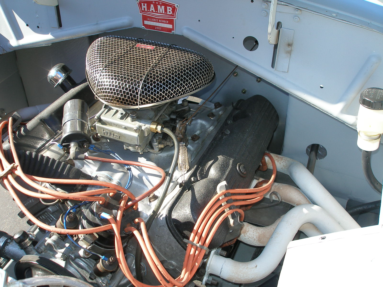

    This belongs to my friend, Dave. It runs like a scalded dog. Has a T5 tranny and narrowed chevy rear end. It's the only MG I'd like to own myself.

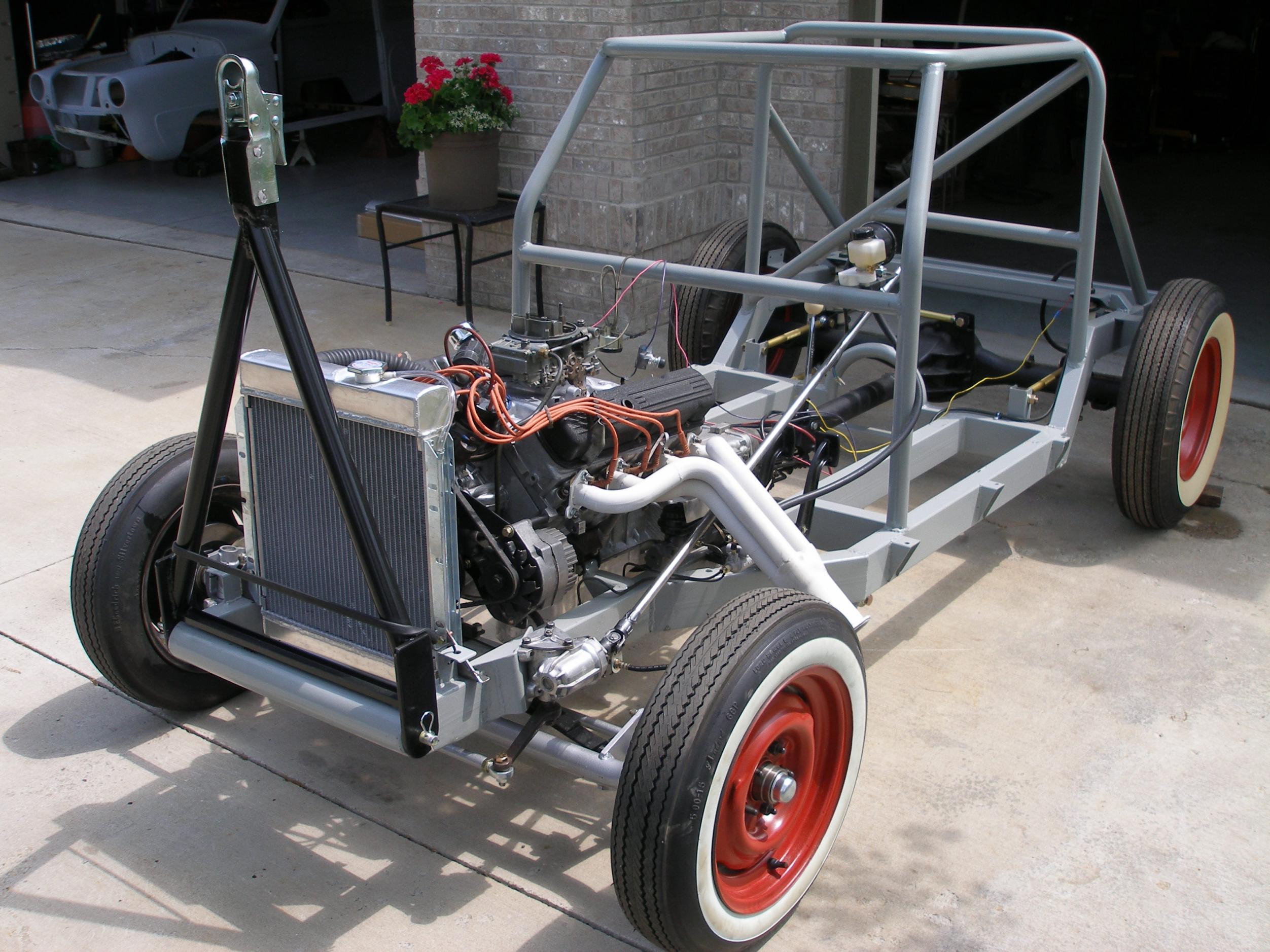

    I'm building a Model A coupe. I was going to rebuild an old 283 in the shop but it turned out to be a real boat anchor. Not much usable beyond the bare block. Then this 215 Buick V8 came up on a hot rod parts blog and I snapped it up.
    The guy bought all of the parts and did all of the machine work and had everything balanced 20 years ago and then it sat in pieces. He was building a kit car.
    I bought it for about half of what he had in it. It's a 1963 Buick 215. It has a Kenny Bell 3/4 street cam, 300 aluminum heads, Mallory NOS black cap dual point, Melling HOP oil pump, 300 short water pump, stock four barrel manifold, (for now I plan to run a little square bore Qjet) I added Rover cast iron four-into-two headers. It will be backed up by a T5 five speed stick and 3:33 Jag rear end. Stock it puts out 200 HP. Might get a few more horses with the cam and headers.
