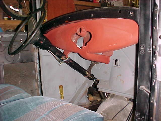

    I'm putting together a 29' A PU and am using a 40's era ford coloum shift, shortened, with a bearing and sleeve that matches the output shaft and the appropriate joints and shafts to get it to the steering box, limeworks makes some nice simple coloums though. Good luck with the venture!!

    I am going to use a 2" column from a 65-67 chevy school bus , fitted to a 58 corvette steering wheel. Cheap, and it looks like a vette column. Even a aluminum rod from a 6 cylinder 292 with a bearing fits well as a column drop.

  11. I used the entire steering column, shaft and box from the donor tempest that I got the motor and transaxle from. I cut it up and made a bearing to support the shaft.
