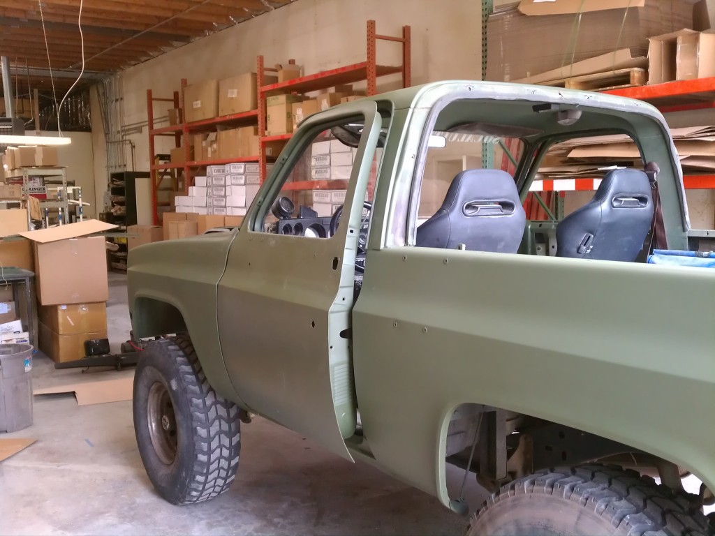

    This stuff is harder to use than candy. No 2000 grit sanding, no clear coat, no buffing, this sounds like easy to use back yard painting. IT"S NOT!! It is a battle between streaks (like you get with a spray can) and orange peel. Put the stuff on wet enough to not streak and you get orange peel and sags. Back the flow down to get a smooth, even coat and you get streaks in the LRV. This paint may work well for small projects but it is a nightmare for a whole car! I have painted my truck 3 times, used 2 gal.s of paint, (this does NOT include the bed) at 2 different paint booths and am very unhappy with the results.
    If you want a flat look just put down a smooth coat of base, wish I had.
    For anyone wanting to use this paint, I would suggest painting a 4X8 piece of sheet metal as a test before committing to a whole project.

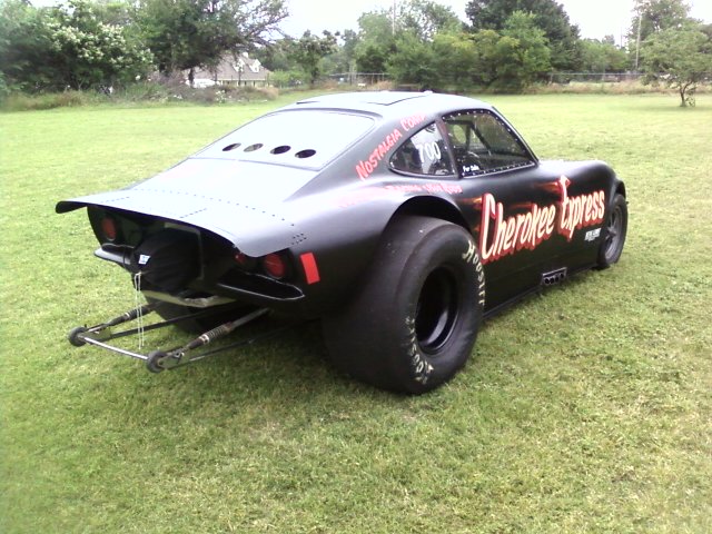

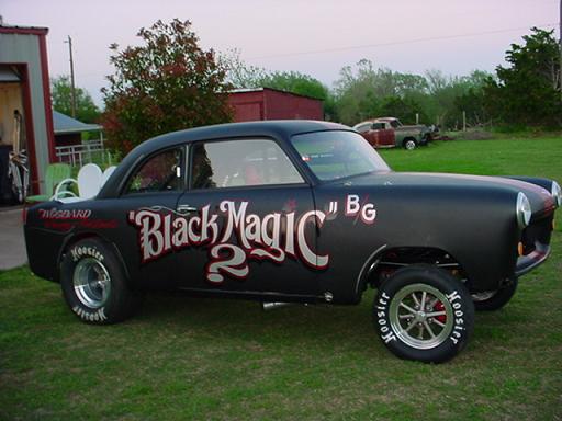

    this is acrylic enamel reduced 1 qt flatter to 2 quarts paint, 10 percent laquer thinner and shoot it . lays down great dries super fast and is the right semi gloss i wanted... and cheap ..... i did my 55 chevy black magic with jd blitz black and it was super easy to do, i repainted half of the car about three yrs later from an accident and it was easy to match etc.

    Seafoam green metalic. Had a problem with the metalic streaking too

    Your Opel GT is awesome!!!! Brings back memories of the "good old days" of drag racing for me!!!!! Would love to see it run!!!! It truly is an example of the cars we ran back when drag racing was fun for "everyone"!!!!
