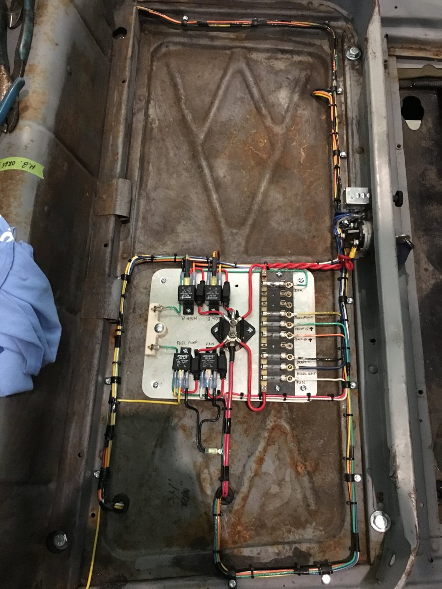

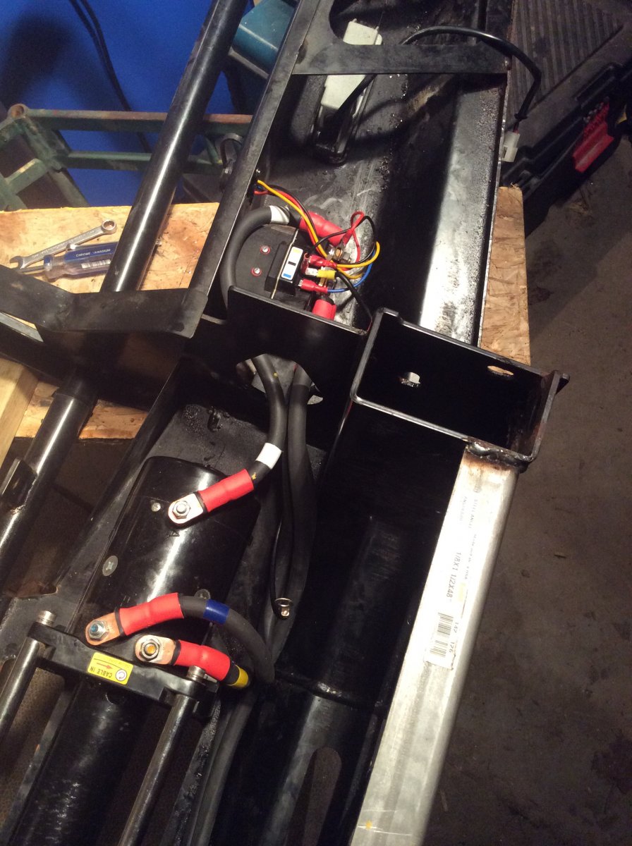

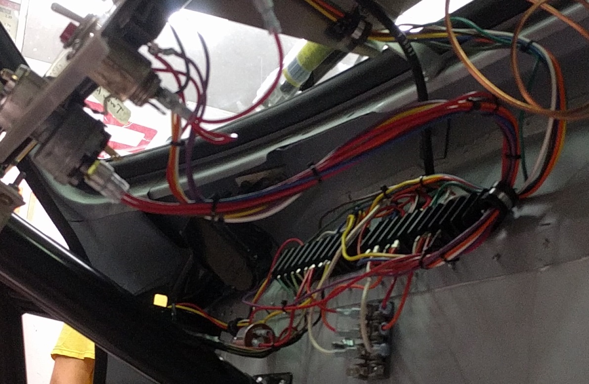

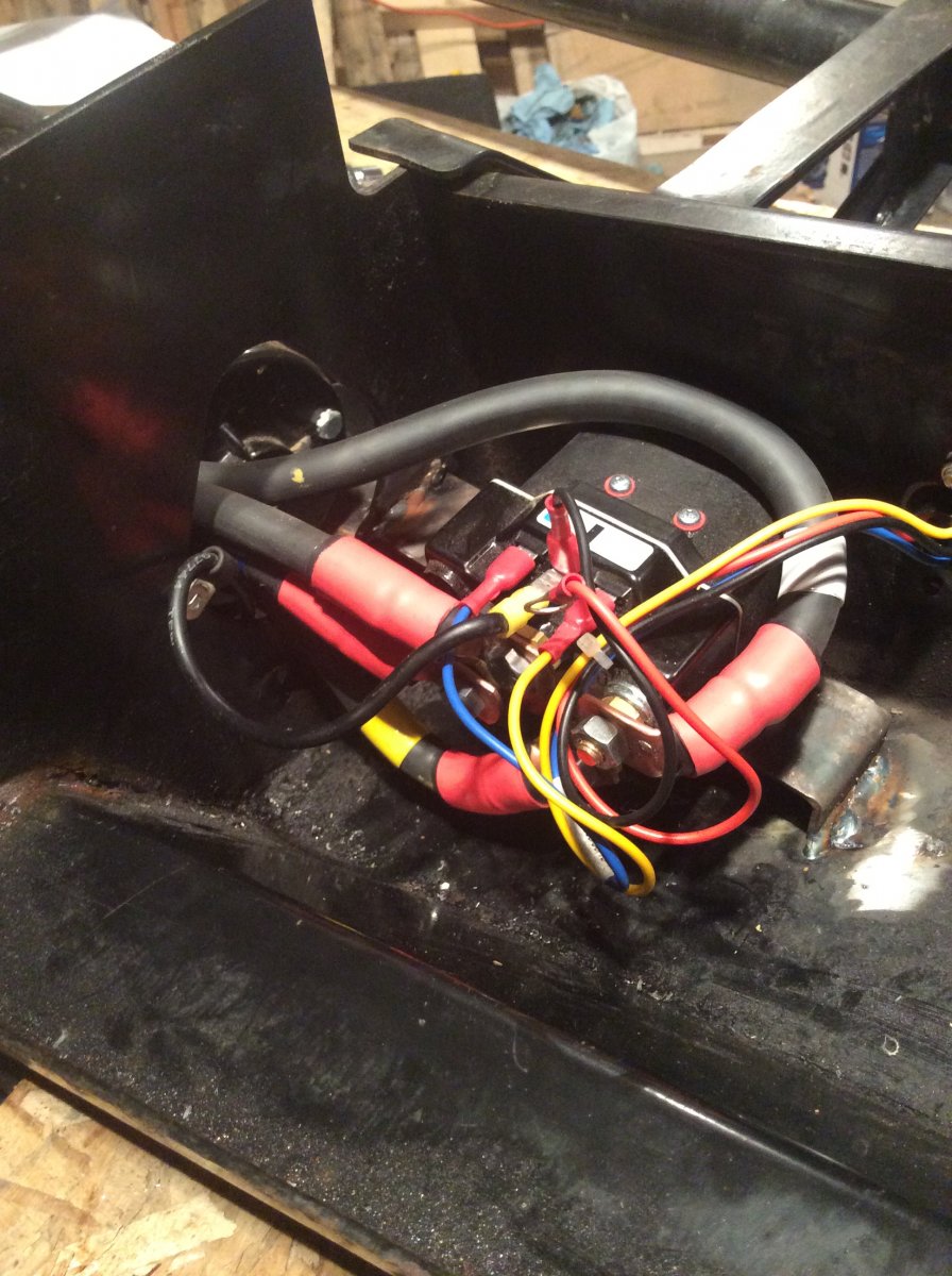

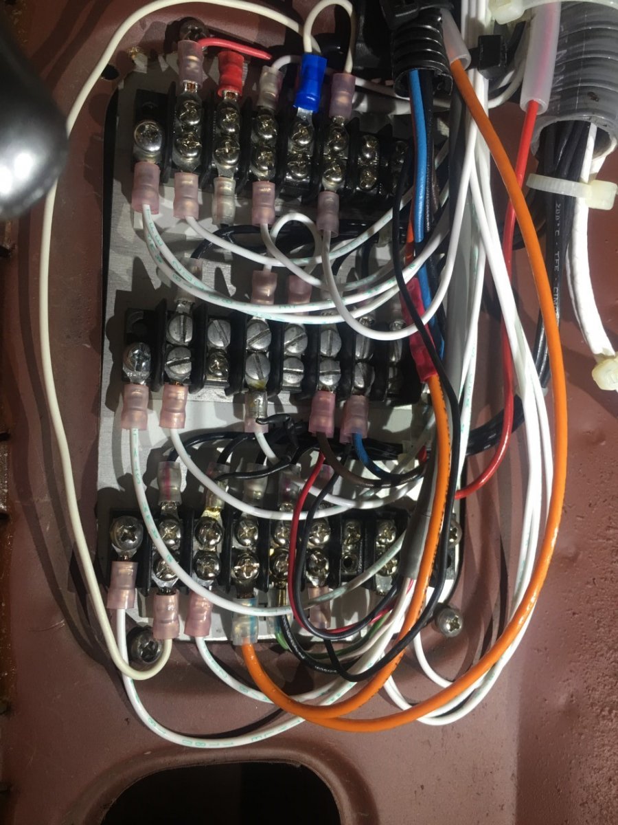

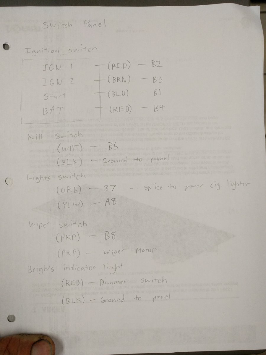

    some wiring we did last year on the Barracuda. It's a street/strip car, more emphasis on strip, so things are easy to work on, not hidden away.
    IMG_20180905_222917.jpg IMG_20180905_222902.jpg IMG_20180905_222848.jpg IMG_20180905_222828.jpg wiring2.jpg wiring.jpg

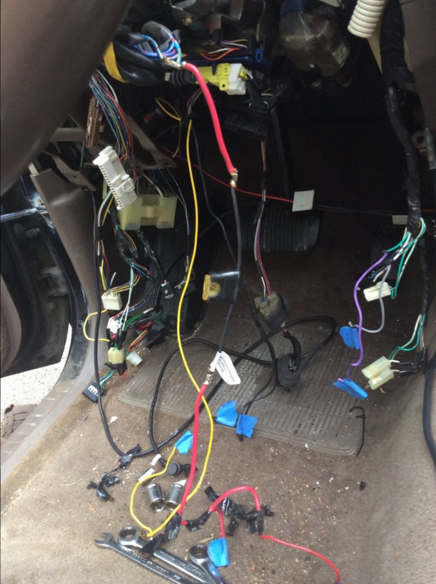

    A few from stuff I did on my truck. I have more but can't seem to find them, but I'm sure you get the idea. I kinda like doing wiring. One also when I had to rip my dash out. That was fun..

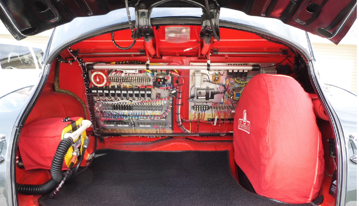

    Here's my 1948 Plymouth. Main electrical panels in the trunk, and small panels with terminal strips mounted behind the kick panels. Also created a "Wire Run List" that shows the origin, wire size, wire color, routing, and destination of the conductors, and schematics of the various circuits. It looks more complex than it really is, but the layout is relatively easy to access. There is also a removable plexiglas panel that acts as a protective cover. trunk elec..png driver's side.jpg trunk elec..png

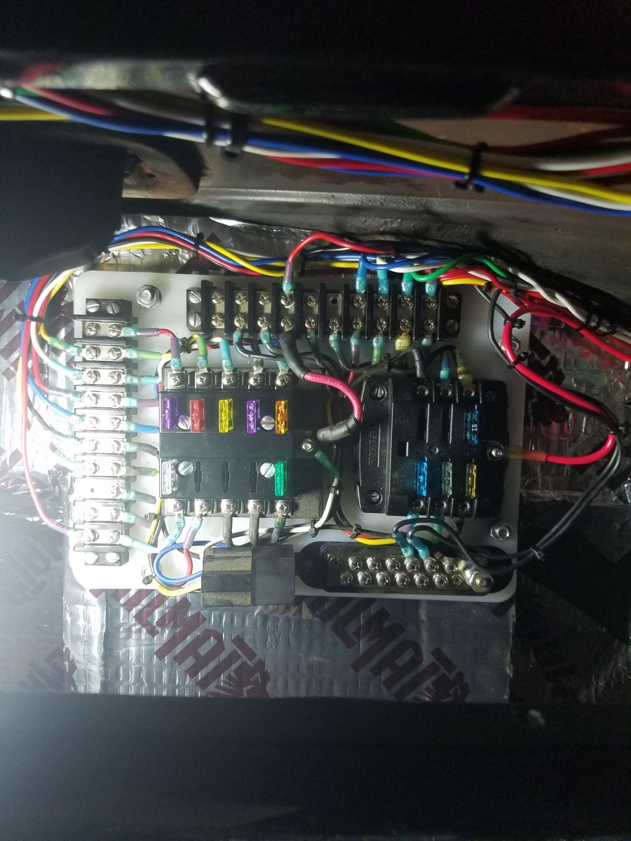

  17. Here is the fuse block I made with 30 bucks worth of boat fuse panels and terminal blocks all mounted to a cutting board I got at the dollar store. I built it for my 39, wired it up over the summer and has worked flawlessly. 20190726_213536.jpg 20190724_214841.jpg 20190726_230945.jpg

    Wiring is all about making good connections, the first system that looks like NASA is impressive, but has poor crimps! Leading to trouble! Nailhead Jason’s system gets my vote, for simplicity and better crimps/ connections. Just my experiences.... which are considerable.

    GeezersP15 you win. Amazing. I have wired a lot of cars, and I have wired from scratch. I have always tried to do my best. None of mine looked like what you have done.

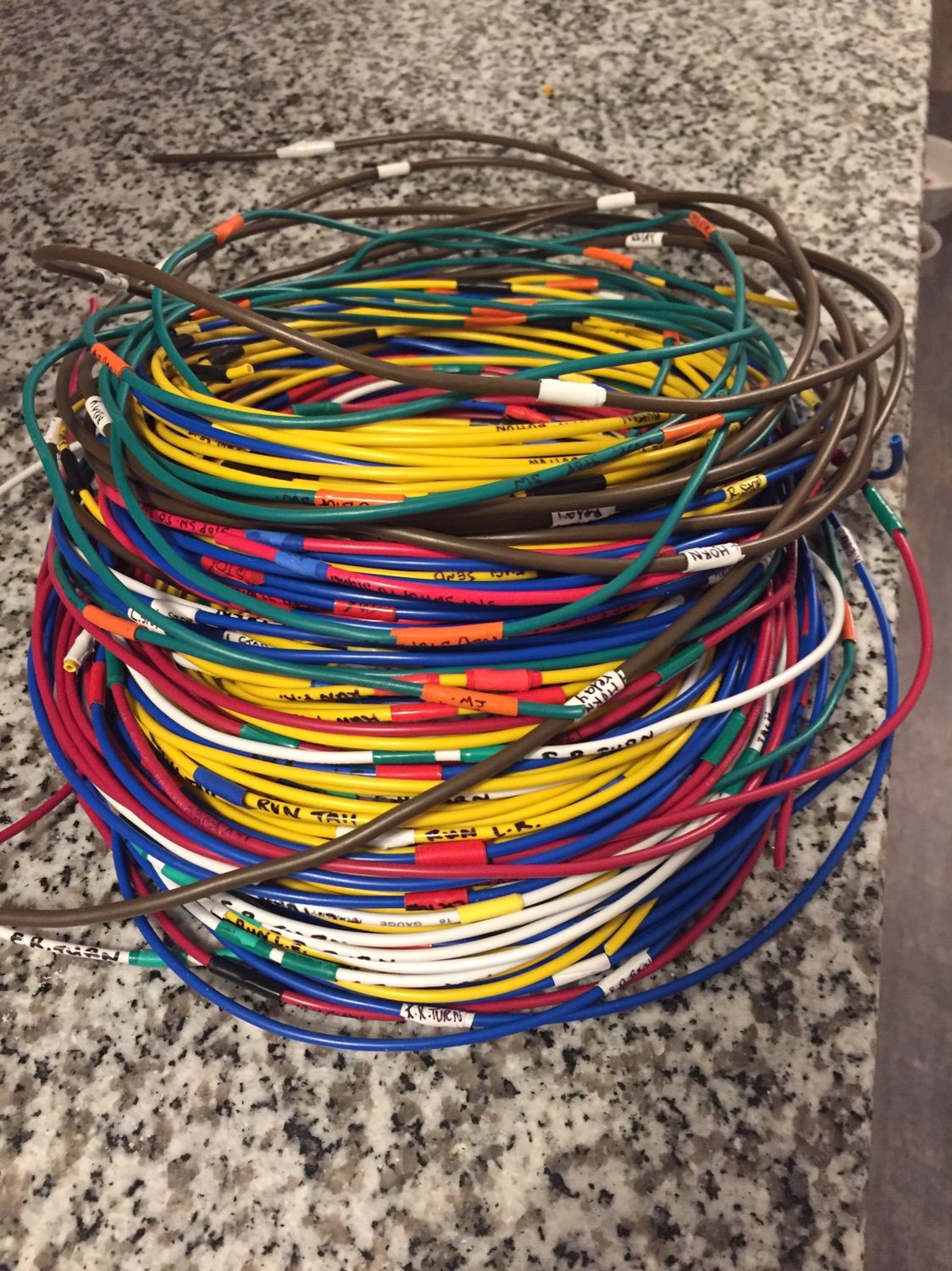

    WOW!! There is some really good looking stuff on here you guys are awesome. I have lots to learn.
    Here’s our first one from scratch! just getting started measuring and marking. Maybe a little over kill but I’m in no hurry. My wife likes helping so I’m all in haha Cloth wrap after we’re done! ...
