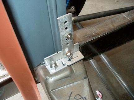

  7. Big puller - brake drums & other stuff.

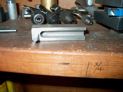

  10. Home-made lathe tool block complete with external adjuster gadget - gadget next photo.
  11. Adjuster gadget for home-made lathe tool block.

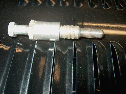

    Flat bottom of 1/4-20 bolt sits at height tool bit should be at.
    Bit gets installed and adjusted with block off lathe.
  12. Here's why the adjuster gadget to the home-made tool block works.
    The tool bits are supported top and bottom with 1/4-20 cup point allen set screws.
    They're adjusted to bring tool bit to the proper height.

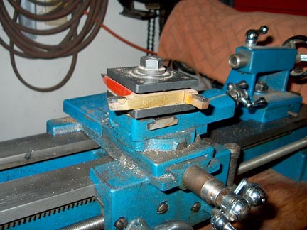

    (6 x 18")
    Note the upper allen set screws are below top level of block.
    That allows a flat bottomed adjuster block to be used for tool bit height adjustment.
    The groove on the adjuster for the other lathe is required cuz the allen set screws sit above the top surface.

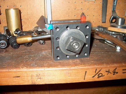

    Here's a pic of the lathe tool bit adjusting block set up as it would be used.
    Makes things a little clearer I hope.

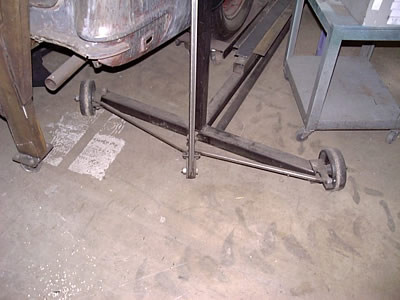

    Here is a frame rotissery I built. Both ends are the same and have steering.......
