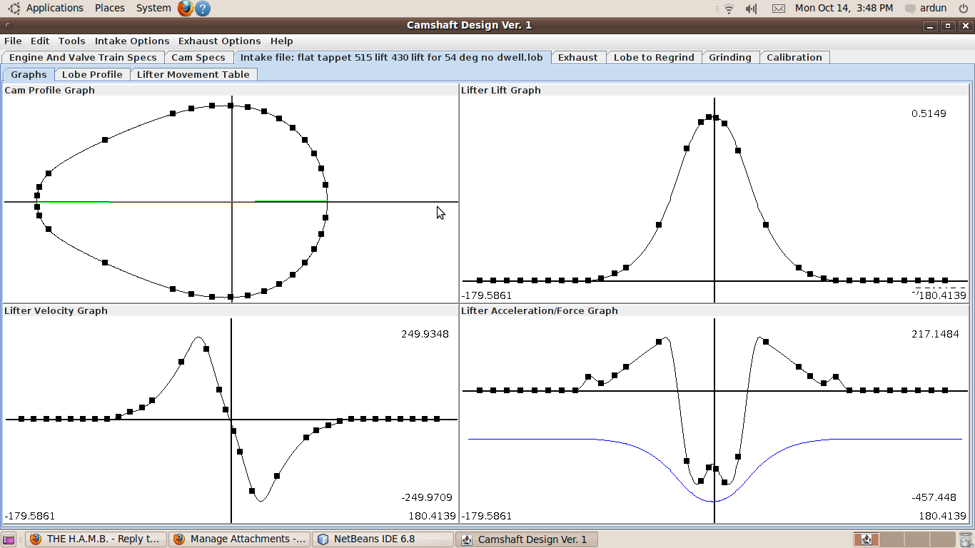

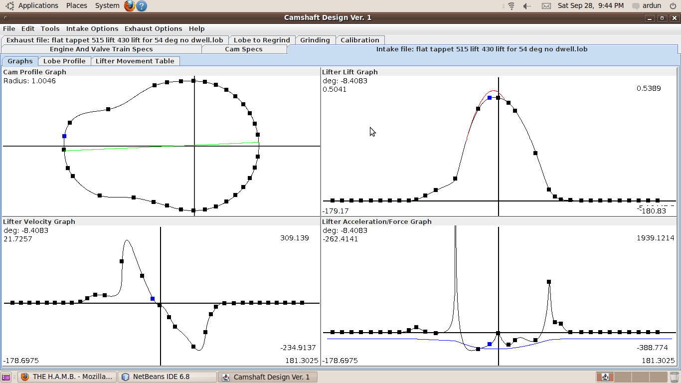

    To illustrate I've attached a couple of files. The first, ballistic 6500 rpm, is a cam lobe that is designed to throw the vlv open. On the Lifter lift graph, the black line is the motion the lifter would have if the spring keeps the lifter on the cam. The red line is the motion that the lifter actually goes through. The lifter leaves the cam because the spring is not strong enough to keep the lifter on the cam for this particular combination of mass, spring and RPM. At 6500 RPM, the cam lobe is designed to "catch" the lifter as it lands on the cam.
    All looks well, the lifter will gently land on the cam lobe. The lift of the vlv has been increased from a low RPM lift of .504" to a dynamic, high RPM lift of .611"
    However, as the second file shows, when the RPM is slowed to 5700 RPM, the lifter slams into the top of the cam lobe. This will quickly end the life of the vlv train and cam.
    This is a simple model using a simple spring and no damping. Perhaps a variable rate spring (one that is designed to progressively cause coils to contact each other therefore changing the spring rate as it is compressed) or a specialized damping system could be used.
    Although not illustrated here, instead of using this idea to get higher lift, the same concept can be used to change the duration drastically by having the vlv close at some point after the lobe event. But, as Ned Ludd points out, the problem then becomes how to get the lifter and vlv to gently close as the lifter lands on the base circle...specialized hydraulic lifters maybe?
    With today's computers and the vast improvement in dynamic modeling over the past 20 years, it may be worth re-investigating.

    I have been playing with your program. I find that it is a great visual tool for watching the affects to the graphs as the shape of the profile is changed. When it comes time to actually make the cam profile, a lift table in 1-degree increments showing the lifter height, will be necessary. I do not see this table in a form that shows that. The radius of curvature and pressure angle are also important pieces of data that I did not see. I am looking at this from a point of view that a proper and reliable cam profile can be made with the program. You are well on your way to achieving that.

    The beginnings of a lift table is there. Click on either the "Intake" or "Exhaust" tab. Within those tabs are three more tabs, "Graphs", which is the default tab, "Lobe Profile", and "Lifter Movement Table". I believe what your asking for is on the "Lifter Movement Table". Note: The data displayed is the raw data the computer uses, because the mathematical model I used (specifically, two 7th order spline functions with x and y coordinates in the Cartesian graph of the cam lobe profile, as functions of the Cartesian degrees in the cam lobe profile, were 0 degrees is set to be the lobe centerline) is a linear representation of a round object, the computer calculates all points from 3/4 of a turn before lobe centerline to 3/4 turn after lobe centerline, therefore providing a 1/2 turn, or 180 degrees, overlap at the "center" of the base circle. This was necessary to produce a smooth cam lobe where the cam goes from +180 degrees to -180 degrees (in math terms, at the first branch cut for a circular object, where we go from 2 Pi radians back to zero) So from a practical stand point only look at the lifter movement table from -180 to +180 degrees.

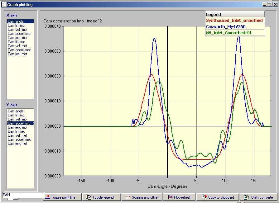

    It is my understanding that Radius of curvature is a useful tool to not exceed the allowable surface stress. So instead of displaying the radius of curvature, I was thinking about having the computer complete the calculation and display the surface stress directly. What do you think? Is there another reason to calculate / display the radius of curvature that I am missing?

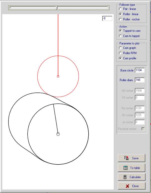

    The minimum negative radius is important to know on a roller tappet profile. The nose radius is important on a flat tappet profile. Obviously, the stress in these areas will be high when these values are too small, but I would prefer to know what the actual number is. Also the pressure angle number.
