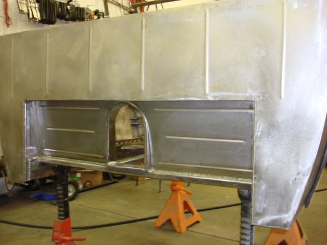

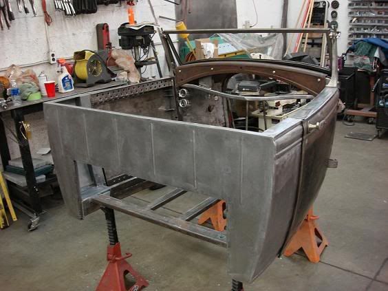

    Yup,and there are some threads already out there on this. I've been putzing with this on and off for a couple years.

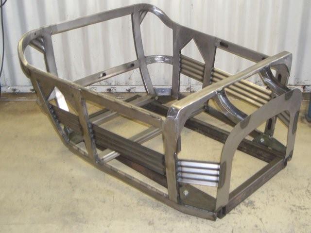

    Sorry for the delayed response but here are a couple pics of my hand fabricated cars and bodies.
    This roadster was built some years ago and I posted it up here on the HAMB back in 2006.
    You might also be interested in taking a look at this free e-book http://www.hotrodders.com/scratch-built/Cover which I just wrote. It documents the step by step fabrication of the body on my sedan delivery shown below. Might give you and idea or two to think about in relation to your own plans.

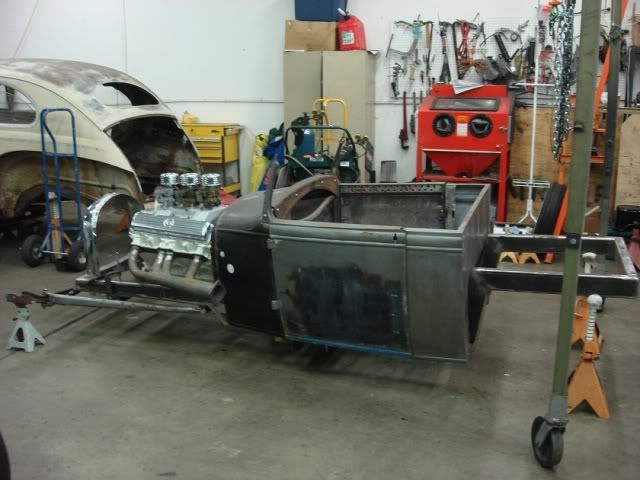

    heres one i'm building, havent gotten too far with it yet but my next step is to build the floor structure.

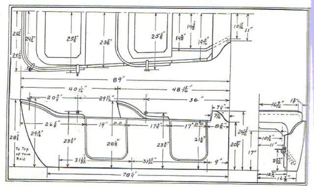

    i found these prints for a tbuket and a touring.. dunno what year they suppose to be from.. but if i build my body from scratch will give me something to work with. figure may help someone out there too. no clue who did the metal frame but i like it... and the red fire truck.. how cool is that thing.. i like the C cabs.. seems you could use plywood for the sides on one of them.. and would give lots of leg room. but i sorta want the convert.. so many cool ideas one could go with.. apparently that fire truck won a high end trophy back in the day.. no way could that win today.. sad. anyhow, the name was wrong good reason google was no help. i take no credit for the pictures found them over period of time.

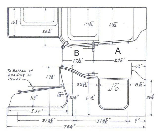

  20. You may want to use the 26-27 T as a pattern to build from, a lot more room. There are dimensions out there, I'll try to find them.
    http://www.jalopyjournal.com/forum/showthread.php?t=438877&highlight=dimensions
