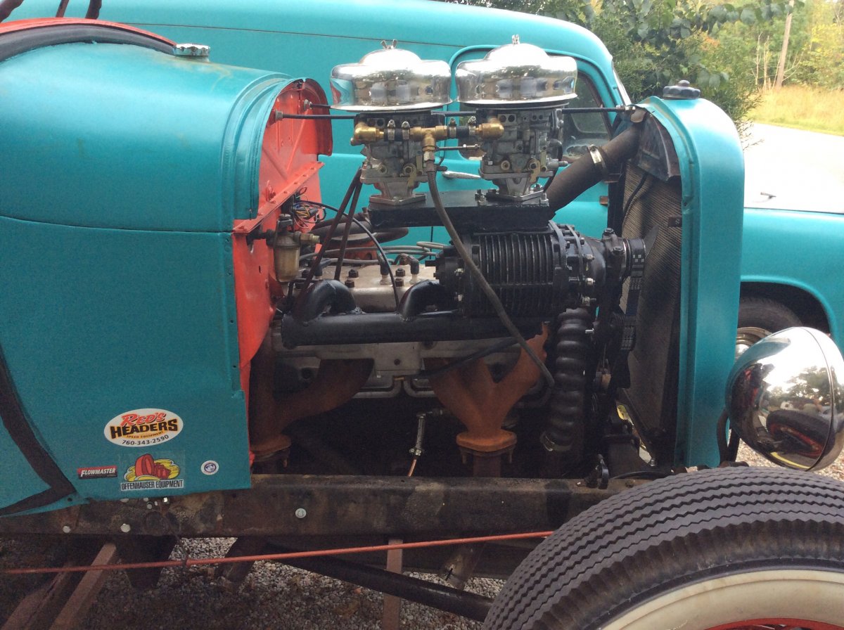

    image.jpg My Roadster with mopar 218, Isky cam, headers and a Scott blower. Runs great
    chessterd5 and kidcampbell71 like this.
