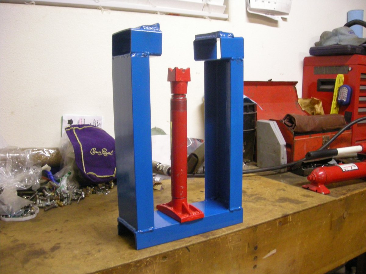

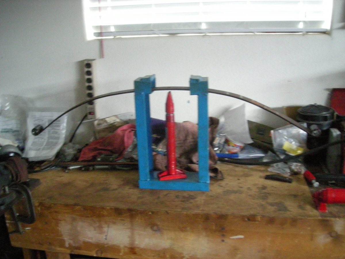

  2. I wanted to reverse the rear spring on my roadster however my 20 ton press was 1,000 miles away & didn't know of anyone in the area to do it for me so I made this benchtop press from 6"channel & a couple of piece of rectangle tubing. I use my porta-power but could also use a bottle jack if I had one here. Have 6 in the other shop so am not investing in another. Anyway it worked & now I have a small press for little jobs. The spring turned out great & thanks to all the guys on here for tips & idea DSCN5055.JPG DSCN5083.JPG s.

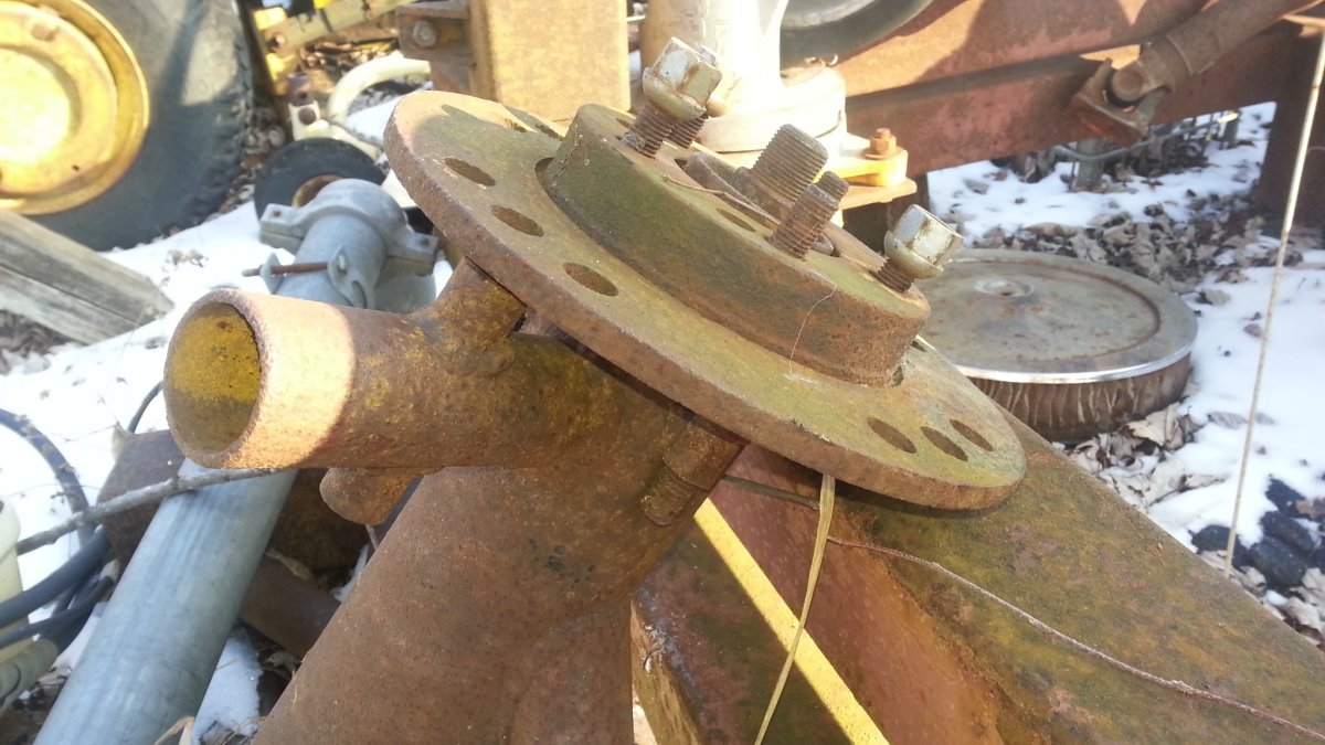

    I used front wheel drive car hubs for my rotisserie.
    redzula likes this.

    Get one off the back of a front wheel drive then you wont have to have a center bolt to hold the hub together.
    You can see on mine I used some front hubs but I had some axles to cut off to hold it.

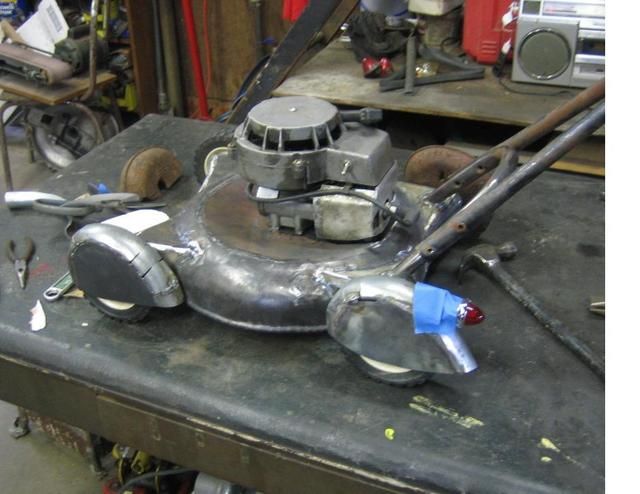

    Im building a mini art deco style mower with full fenders and all. Its lookin real good sofar

    Thanks guys im thinking a green close to this. but that could change. I didnt plan on putting fenders on it either so that changed the whole look
