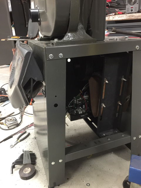

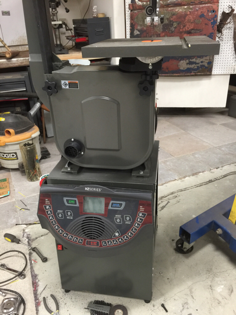

  10. Treadmills are a great source for motors and repowering. Most of the time they are free. I did my bandsaw and it works great and next will be my drill press.
    The great thing about the DC motors is they make nearly full torque at very low RPM. Where as an AC motor with the power dialed down to slow it will have virtually no torque.

  12. That's ok, wait till you need the band saw for a hemi deuce task. :)
    There are other controls that have a more industrial and appropriate appearance for sure. But this works flawlessly and was just about free.
    I got lucky on the controls and was able to cut them down to fit the width.
    When I run the saw, I use the manual training mode and the drivetrain thinks is on a jog in the treadmill. Everything plugs in and there was ZERO wiring.
    I needed to make an intermediate mounting plate for the motor. That required some fussy measuring and a drill. The shaft got the smallest pulley I could find with a slight ream job. Flat spotted the shaft for the set screw. The ribbed pulley threads on and has a dab of lock tight just for good measure.
    This thing is flat out awesome.Since the blade guides are fully adjustable It will run any width size blade between 1/4 and 1-1/4 With Nearly infinite blade speeds. The treadmill had 95 speeds- 0.5 to 10.0 in 0.1 increments. Steel cuts best at 1.2 to 1.8 depending on blade pitch and material thickness. wood cuts best at 3.0 to 3.5. At 5.0 its scary fast blade speed so there's 1/2 of the Rpms not usable. It might benefit from a jack shaft but I don't see it getting any better.
    I need to do this for my drill press. Now It has spindle speed adjusting by moving belts around. The slowest is 280 rpm and that's just way to fast for a 2" or up hole saw. Bigger the hole saw the faster the tooth speed is. So it really needs converted too. Problem is, like you I'm too busy working on my hemi truck coupe thing to do it:)

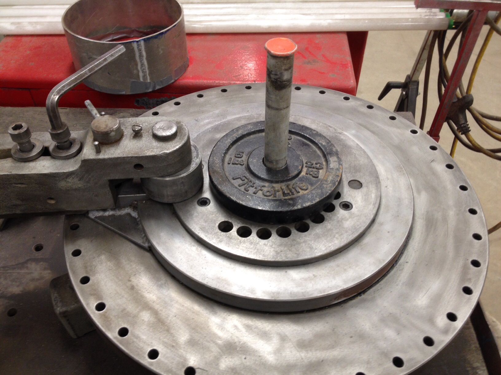

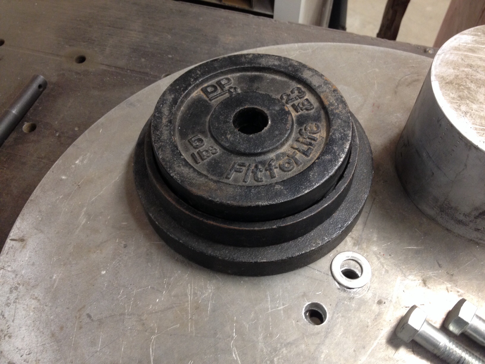

    image.jpg image.jpg Many years ago a friend gave me a no3 Di-Acro bender, it didn't really have much tooling with it so I almost never use it. Yesterday I decided to clean it up too make a list of parts I needed. I started making pins and posts etc. I kinda got side tracked and was putting some stuff in one of my tool boxes where I saw a stack of metal lifting weights of different diameters ! Ok so what do I need to adapt them to my bender? NOTHING !!! They have a 1" hole in the center, so I had a WELL DA moment

    Find the weights with a rounded edge. Weld/bolt a big washer on each side so it overlaps the weight. This will bend square tubing really well. The round edge will indent the tubing so it won't kink.
