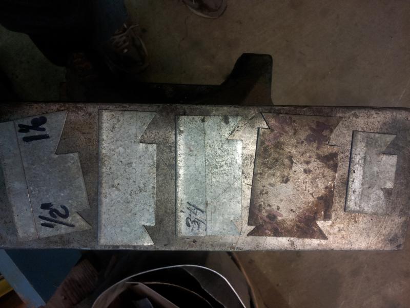

    The wtf comment rang a bell, I had for years had a 1/4" lip turner for starting the edge of a pc of metal to run thru the edge former on the Lockformer pittsburgh machine. Then that wtf moment spending time turning a flange on the inside of a panel using a pliers. I made up the smaller one, then could not remember where it was... made the bigger one, then drilled hole and hang it on the wall well sometimes.
    Make your cuts accurate, what I mean by that the is a bend allowance! depending on you flange 1/4 or 1/2 make you cuts accordingly. The different angles make it easier to start a flange, sometimes I start with one finish with 90 degree slot.
    these are so easy to make! scratchers for laying out edge lines two little cuts with the snips! I fold the edge on some, they do wear out but last a long time and they don't cost anything! A real metal man would not be caught dead with a store bought made in Idontgivastan edgers!
  30. I know a few LIVING metal guys who have store bought ones.:D
