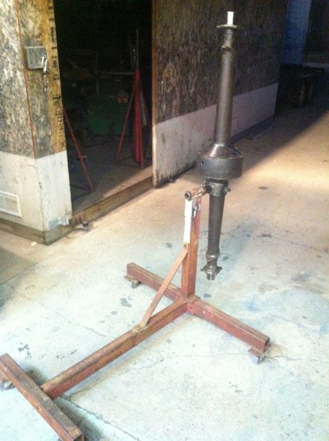

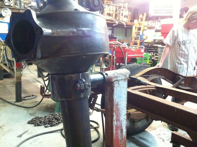

  19. Banjo rear end holder for my engine stand
  20. Is it pretty stable? I would have guessed it would need a counter weight on the other end of the stand. Going to need to make one like it.
  21. Hot Rods Ta Hell
    Joined: Apr 20, 2008
    Posts: 4,152
    Hot Rods Ta Hell
    For more stability, how about spinning it around 180 so the housing is over the stand like an engine would be.
  22. butch27
    Joined: Dec 10, 2004
    Posts: 2,836
    butch27
    Great idea but it looks too heavy on one side. Weld counter weights?

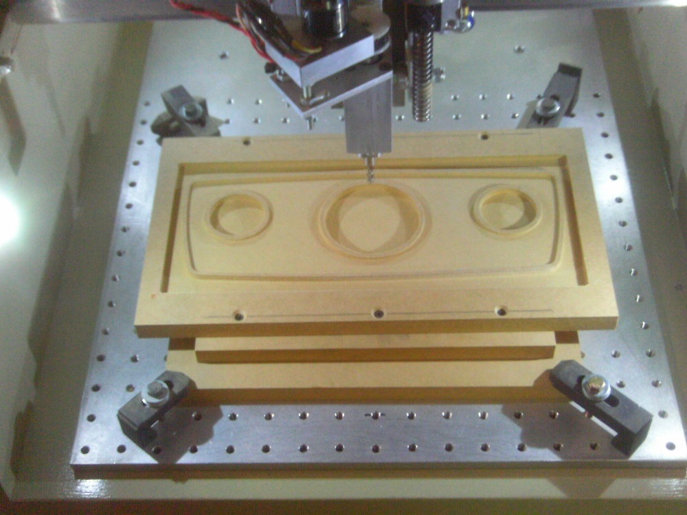

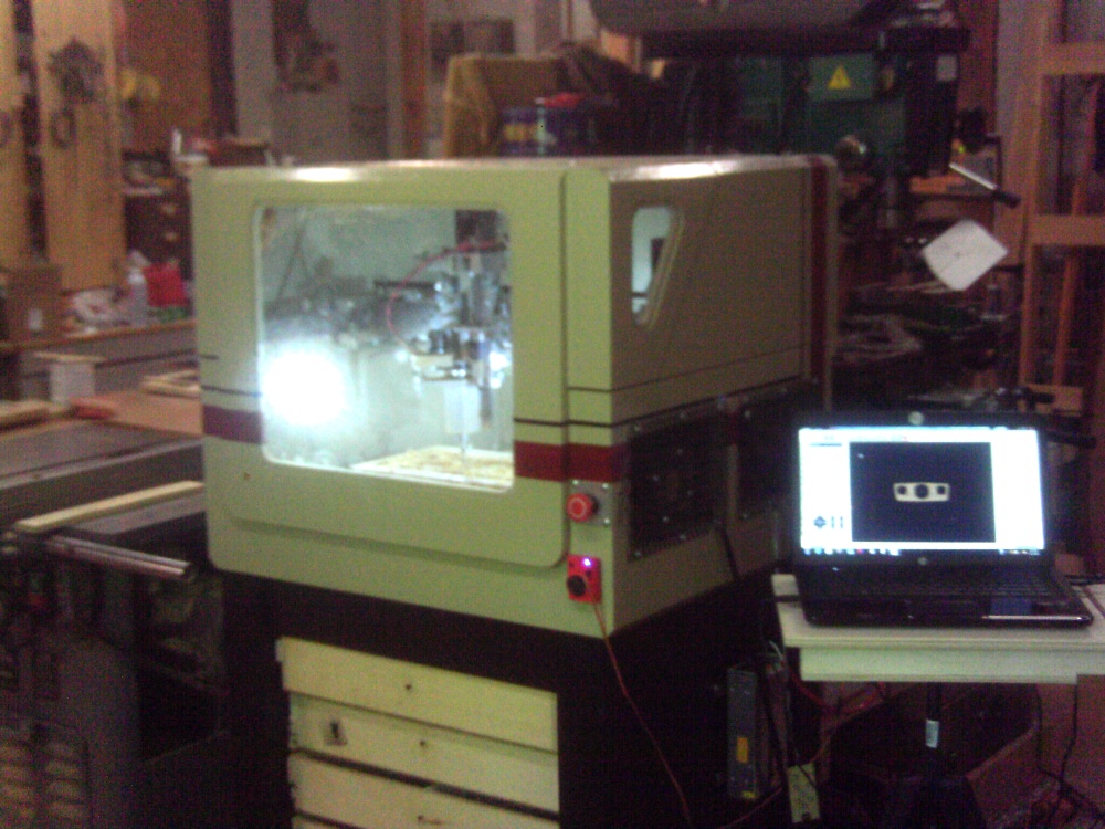

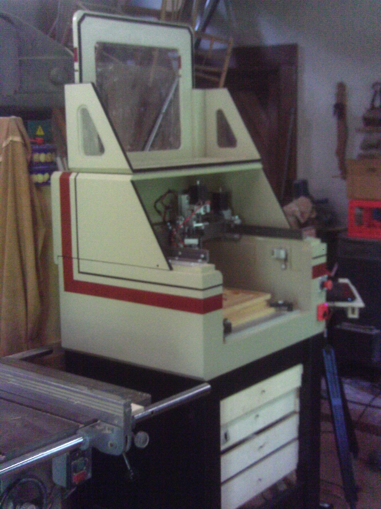

    Here’s my contribution. Scratch built CNC I just compleated. I made it mainly so I could produce patterns faster for my aluminum casting, then also to do some machining on the aluminum castings. Plus there are just so many other things to make on it like pc boards, engraving, and such. I am still debugging it but below is also a photo of a dash pattern for casting that I just did this afternoon.

    You made a CNC machine!? More details on that (even though its so far over my head) BADASS
  25. You made a CNC machine!? More details on that (even though its so far over my head) BADASS
    x2
  26. Smokey
    Joined: Aug 23, 2001
    Posts: 56
    Smokey
    This was something that had been wanting to make for myself for quite awhile and finally got one made. My main interest has been to aid me in my aluminum casting for patterns and such. This machine is based on a diy cnc called Momus cnc. I adapted it to my wants and needs with a few improvements as far as the vs spindle, good led lighting, tapped table, and a few mods to make it more rigid overall. It has a working area of about 16” x 16” x 5”. I also made the motion control board and motor driver boards from scratch. Just got it up and running about a week ago so as I said earlier, still working out the bugs. The mechanics are pretty straight forward but the electronics and software are where all the gremlins seem to hide. (at least for me) I had already started on on my second machine before this one was done. It is more of micro mill for doing just pcbs and engraving. Hope this gives you some of the details you were looking for and thanks for your guy’s interest.
