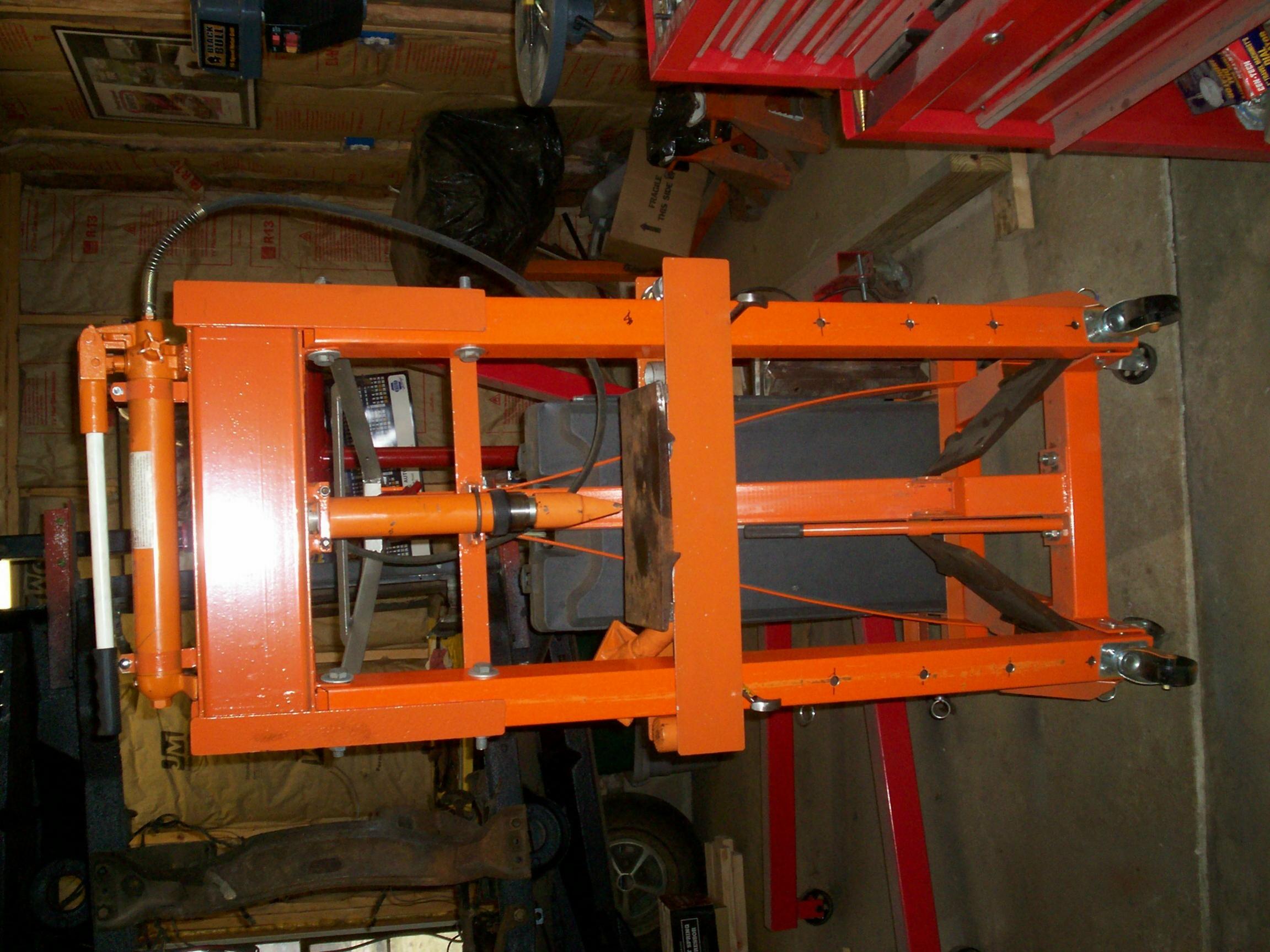

    heres my new shop press. I built it several weeks ago when we were snowed in by 18 inches of the blowing white stuff. used a cheep 1 ton harbour "freight" cherry picker for the basis. I flipped the legs upside down giving me 2 mount holes on each leg, built the upper crossmember and lower press bed from some 4x6 I beam that I was able to requisition:rolleyes: from a local scrap pile. the rest was scrap angle iron I had cluttering up the garage. this was built to utilize my 10 ton porto power that had been doing nothing but collecting dust. it was mounted with a couple of old used muffler clamps, a piece of pipe welded to the upper I beam locates the ram and a couple conduit clamps mount the pump on top of the upper beam. I drilled a series of holes evenly spaced down the legs to give height adjustability and used 2 $3.00 H.F. round pry bars for the support pins. I tried to use the original bolts and pins everywhere to hold it all togther. the only extra fastners were the 4 bolts holding the upper beam to the legs. even with all that I can still pull off all the press gear and use the picker as a picker so its a double duty tool. I even made a small tray at the back to store the picker beam and ram plus the porto power box so its all self contained. the only cash I have into it are the rattle cans of orange paint, the conduit clamps and 2 pry bars. I already had the c.p. and all else. cant believe how much I use it already rather than beating everything to death with a BFH!

    Friggin' ingenious.

    Fixed it for you, now we don't have to turn our heads sideways :)

    thanks blue one, Im almost computer iliterate. I saw it as a personal victory just to figure out how to post the pic

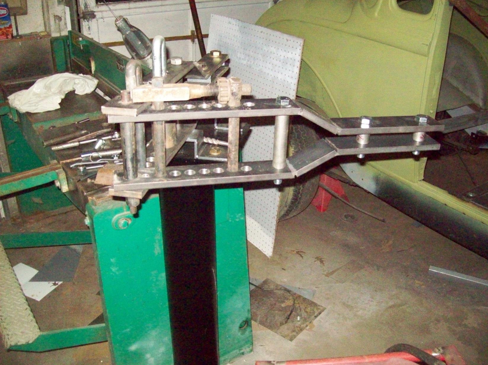

    Almost got my home made hossfeld bender done got a stand made and bolted to the floor and got it into a working machine and did a few practice bends to see how it works. Still got a little bit of welding to do on the swing arm the only way i could bend the 1/2 steel was to put it in the band saw and cut half way through then i could bend it on the work bench. Bent some 1/2 rebar and 3/16 steel strap and some 1/4 rod.
