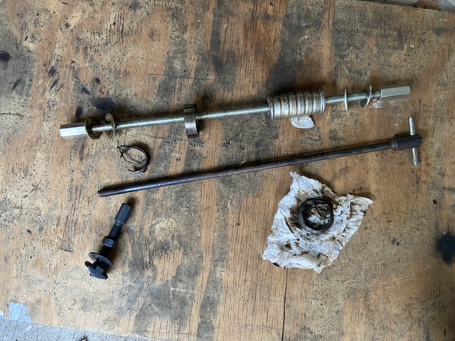

    Cheap Axle bearing remover:
    24” 5/8-11 threaded rod
    2 - 5/8-11 nuts
    2 large washers
    2 larger washers
    1 Borrowed slide hammer
    This is for use with an axle that the carrier has been removed.
    1) Remove the seal from the axle
    2) The outside end of the tool needs to be loaded
    3) Push an end of the threaded rod into the axle, add the washers and thread on the nut
    4) Pull the tool against the bearing and use as a slide hammer

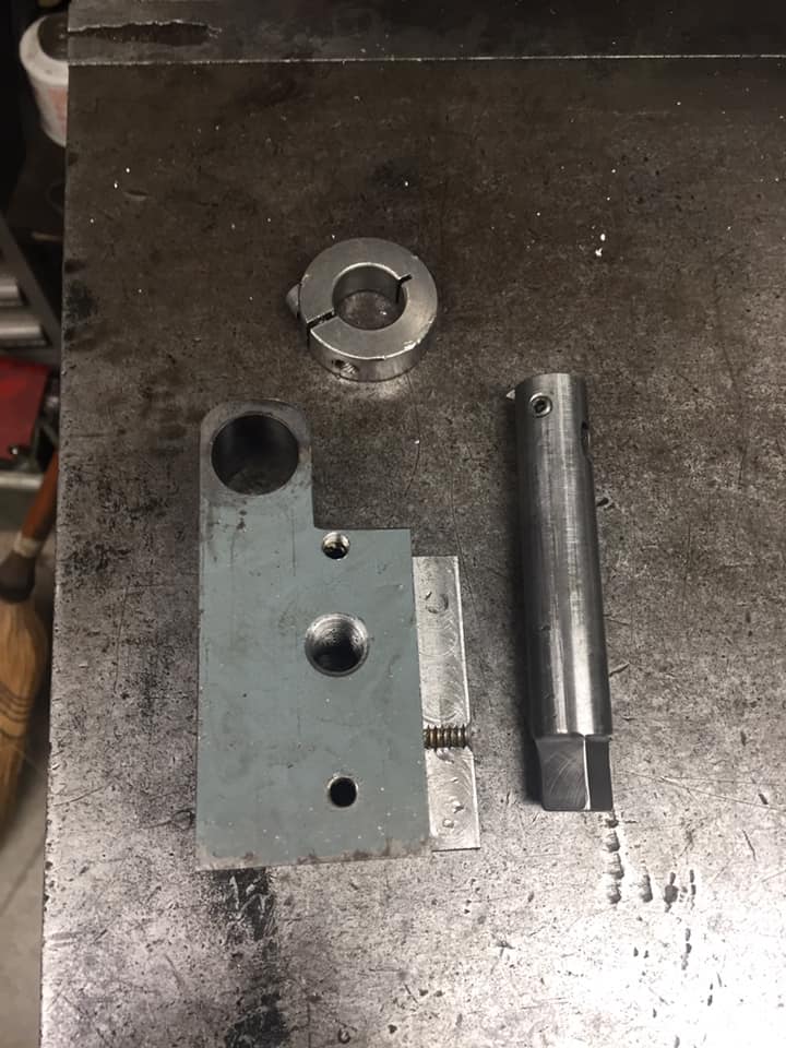

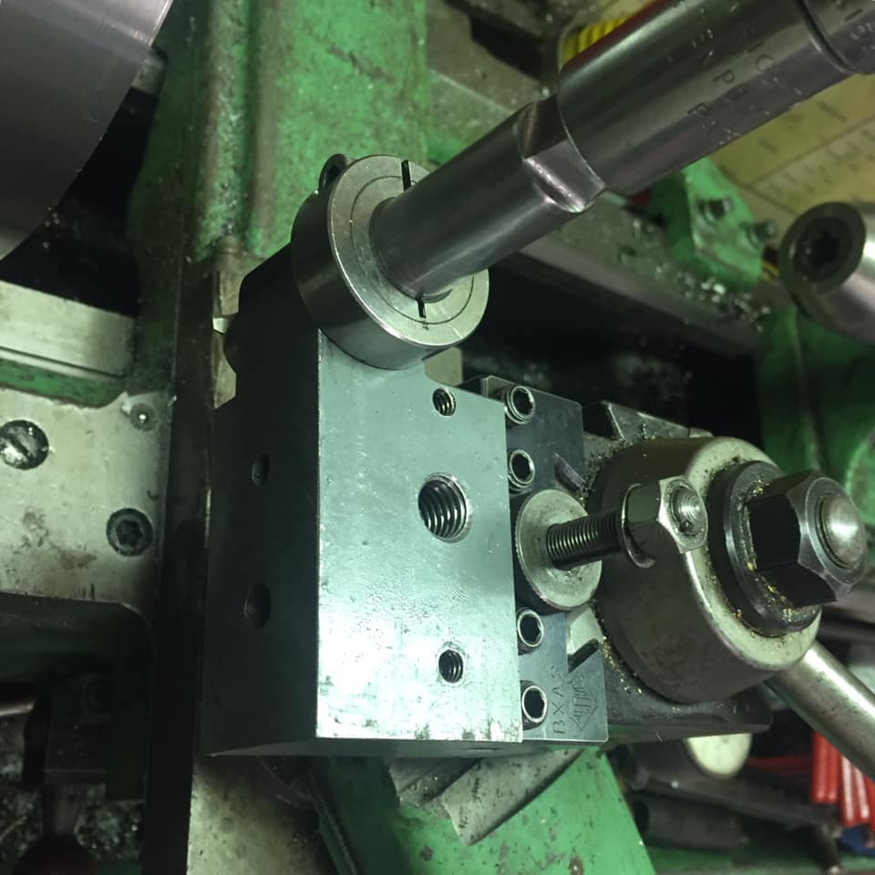

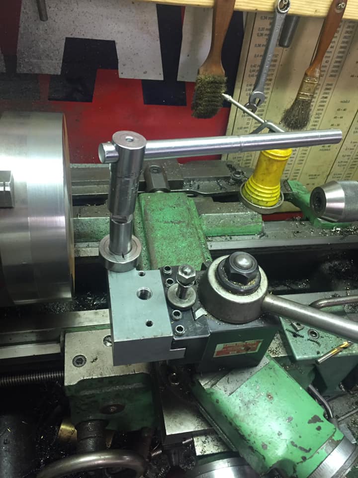

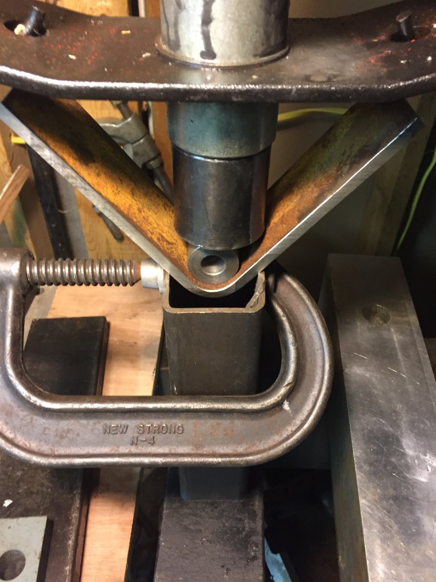

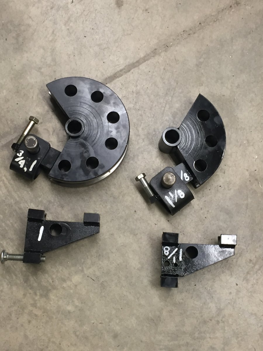

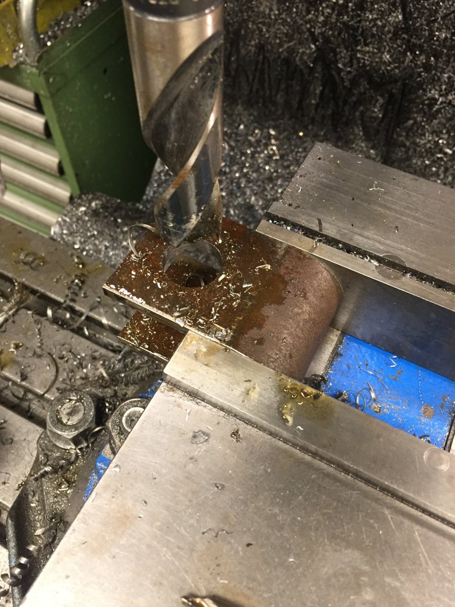

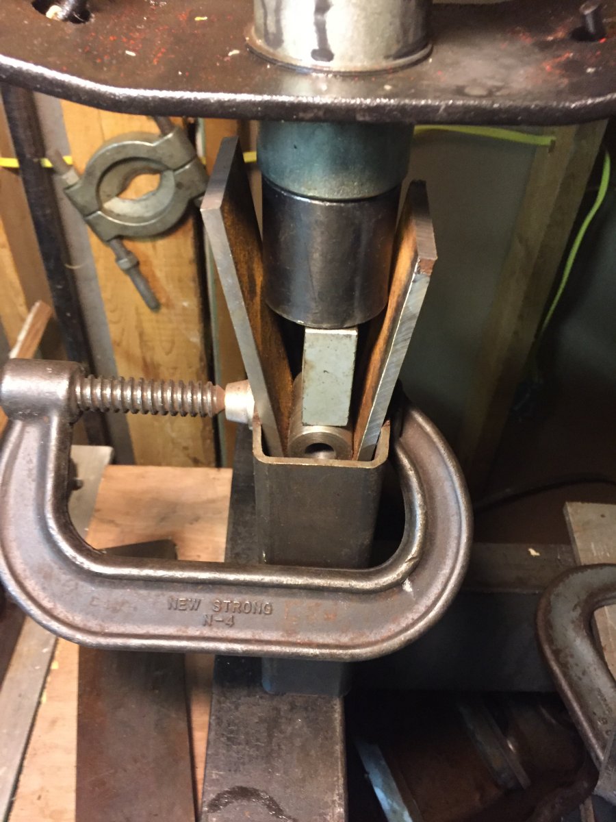

    Years ago I bought a tubing bender, being on a budget I only bought a few dies. Over time I have needed more but not enough to justify BUYING them...so what's a fella to do??? Well if you're a Cheap Bastage like me - you make 'em. It goes like this: I "needed" a 1" die...which after all said and done left me with some extra pieces which I then modified into an 1-1/8" die...waste not want not. Yes it is interrupted by having to make a tool for the lathe to cut the radius...for the FIRST die. The second die...well you'll need to see the pics to see how I opened that up. I hope you enjoy.
    bend1.jpg bend2.jpg Every good project starts with a chunk of scrap steel. bend3.jpg I made this so I could more easily cut a radius - crude but effective bend4.jpg Radius cutter bolts onto a regular tool holder bend5.jpg bend6.jpg bend7.jpg bend8.jpg radius cutter - slow going but works great bend9.jpg bend10.jpg Looking good bend11.jpg If you drop these just right you can get them to break right where you want them! bend12.jpg Chips! bend13.jpg Done! bend14.jpg Scrap aint always pretty
    bend15.jpg Wipers (made a couple extra)
    bend16.jpg 1" Die set COMPLETE! But WAIT! There's MORE! Remember that extra chunk we had left over? We gotta do SOMETHING with that RIGHT! Let's see I don't have a 1-1/8" die in my set... thing is I don't have a face plate big enough on my lathe to open this slot up from 1" to 1-1/8" hmmmmmnnn have Bridgeport Will Travel!
    bend17.jpg That's bolted pretty good.
    bend18.jpg I did find a 1-1/8" endmill - this should make things easy. bend19.jpg Endmill worked like a dream!
    bend20.jpg Finish is pretty good too.
    bend21.jpg 1-1/8" die is done - off to the wiper die!
    bend22.jpg The piece of scrap that just keeps on giving!
    bend23.jpg Remember those "extra" squares we made - yep they came in handy! Touched them with the endmill and viola good to go
    bend24.jpg Pair of wiper dies in all their glory. bendheart.jpg Here's a birthday present I made for the wife from some more scrap - and if the WIFE'S happy - there's always more time to work on the cars!!!

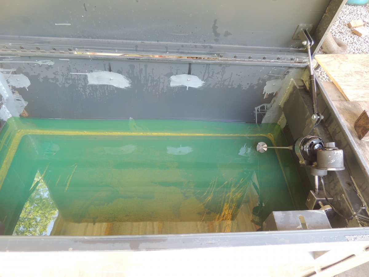

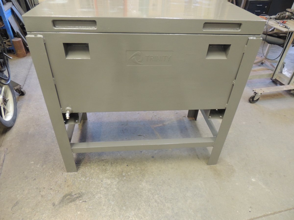

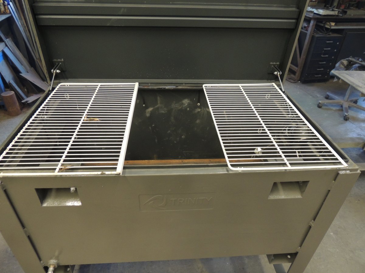

    I built a parts washer with a barrel. I put a thick plastic bag in it. I added about 8 inches of water at the bottom. The dirt falls in the water and does not mix with the mineral spirits in mine. The pump is above in the mineral spirits.

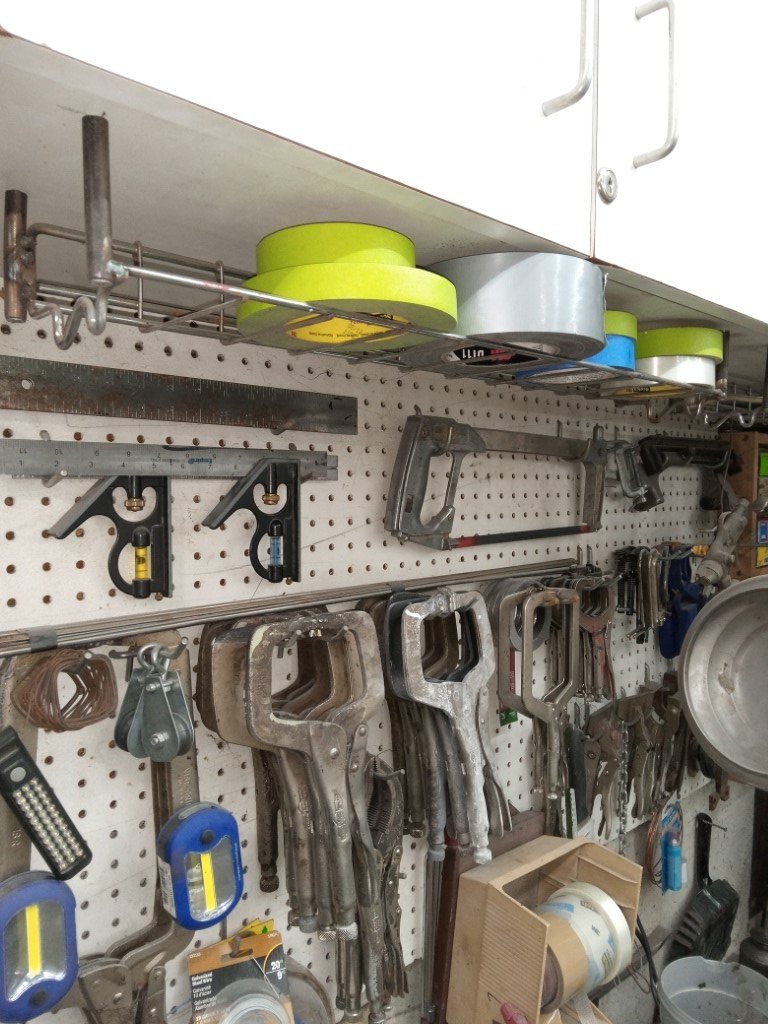

  10. Maybe not exactly a work tool; but I never had a good place to keep tape rolls convenient and in good shape. Grabbed a couple racks out of a junk stove. Cut the depth down, welded on some pieces of 1/8" pipe and screwed then to the bottom of one of my cabinets. Worked out good. Took the other rack and made it deeper for sleeves of sandpaper.

  11. Mart
    Posts: 4,902
    Mart
    Nice rack. Nyuk nyuk.
    Great job with the scrap too, in the tube bender dies.

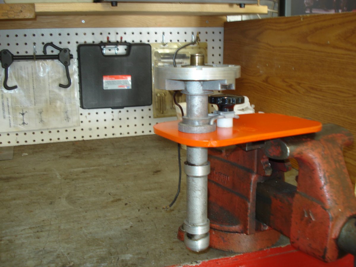

    A very simple holder but better than clamping a distributor in a vise.

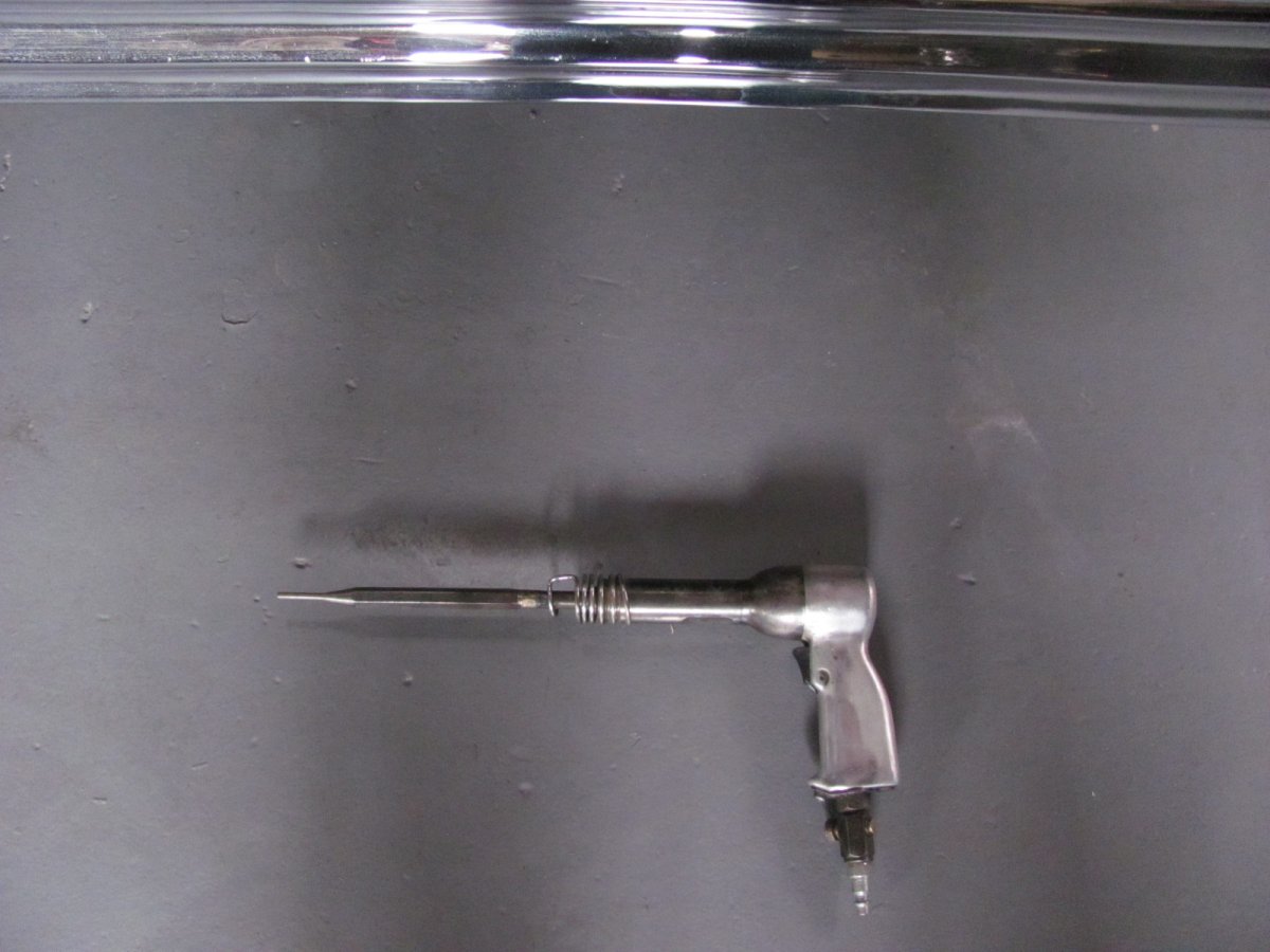

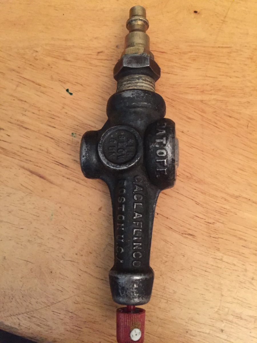

    Ever have your aerosol nozzle plug up? Does it drive you NUTS like it does me? Here’s my solution: just so happens this old air gun has the perfect sized opening. A little burst of air while you hold the nozzle in place works near every time. Stubborn ones I soak in thinner then try it again. WARNING: If you have a tendency to Lick Glass, Trip over your own feet, Own but do not wear Safety Glasses THEN this tip is NOT for you! Move along as this is definitely NOT OSHA approved. Do not try this without proper training and PPE (Safety Glasses)!!!!!

  17. Sporty45
    Joined: Jun 1, 2015
    Posts: 1,185
    Sporty45
    Damn, you just solved a problem for me! I just got a points distributor that I need to disassemble to clean and inspect. I was planning on just clamping in the vise between 2 pieces of wood, wasn't real happy with that but your solution is much better. :cool:
    Oilguy and loudbang like this.
  18. 64 DODGE 440
    Joined: Sep 2, 2006
    Posts: 4,422
    64 DODGE 440
    from so cal
    Screw OSHA, that looks like it's definitely approved in my shop. I probably have 5 or 6 non-approved air nozzles already, but that's a great idea. I think I'll just custom drill one to fit and dedicate it to the rattle can shelf.

    They usually clog when I'm in midspray on something. I just grab an aerosol can of carb cleaner and insert the little red tube in the bottom of the nozzle. Instantly cleans it..............
  21. I have been blowing the spray nozzles out for approximately thirty years, using the air duster. It works like a charm.
    Bob
    Boneyard51 and loudbang like this.
  22. Those air hammers are really handy for all sorts of odd jobs. I had to remove some concrete in my garage, in an area too tight for my electric jack hammer. I used the air hammer, and although it took a little longer, it did a beautiful job.
    Bob
    VANDENPLAS and loudbang like this.
