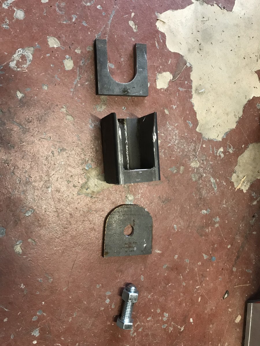

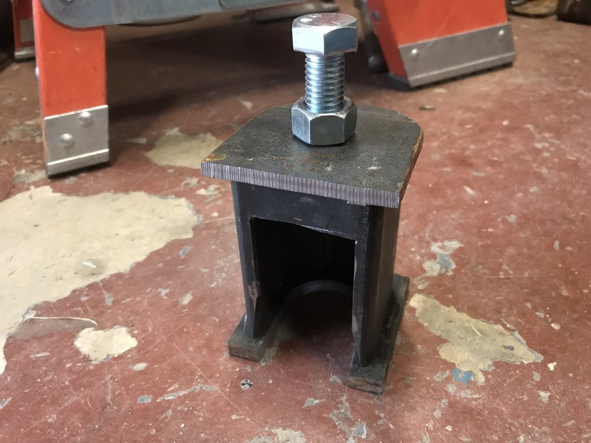

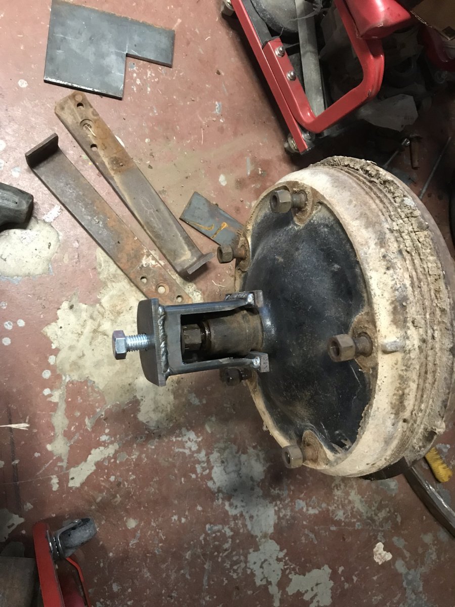

    I have pix on my computer of a dozen or more hub pullers. a couple are factory made and the rest home made. Yours looks as effective as any of them.
    I'll add here: yours and two others are "two piece". The rest slide on from the side (of the puller). One of these other two uses muffler clamps to hold it together and the other one uses a piece of tubing just large enough to slide down over the puller to keep the two halves together.

    Looks like it should work. Put some load on it and then give the center bolt a good sharp whack with a mallet.

    well it did work but by the time I got thru , it looked Frankenstein-ish . the gold looking y shaped part where the big 5/8 fine threaded bolt that actually pushes , bent at-least an eight if an inch, the two side bolts kept causing it to get out of center so I had to weld some tubular bushings at the outer edge to keep those two bolts in line . Next time I will copy yours.

    When it comes to tightening rear hub pullers I say if it doesn't feel like something is going to break, the hub wasn't tight enough.

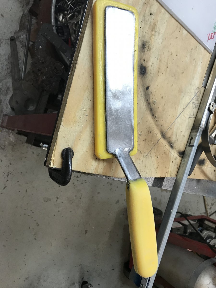

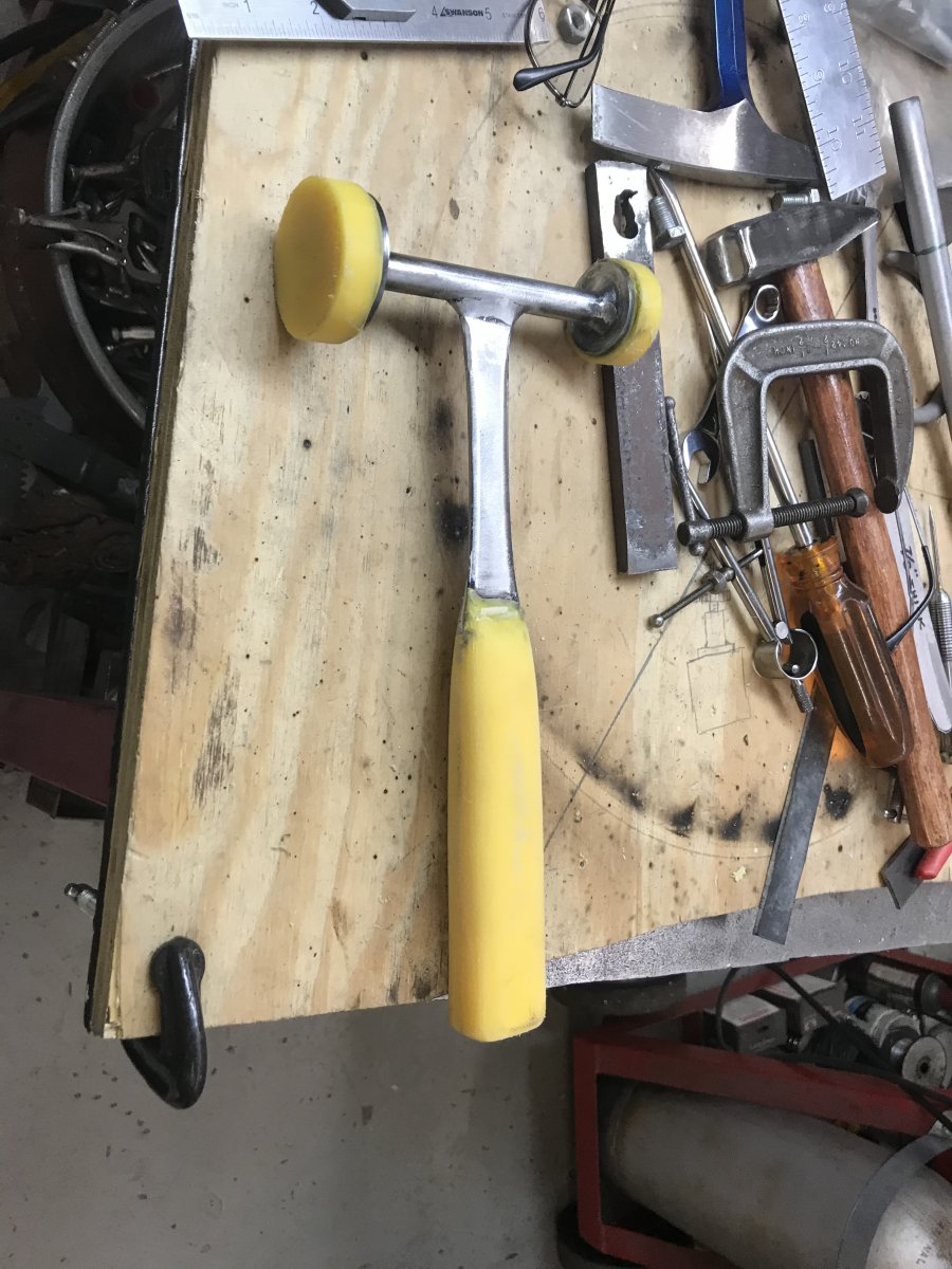

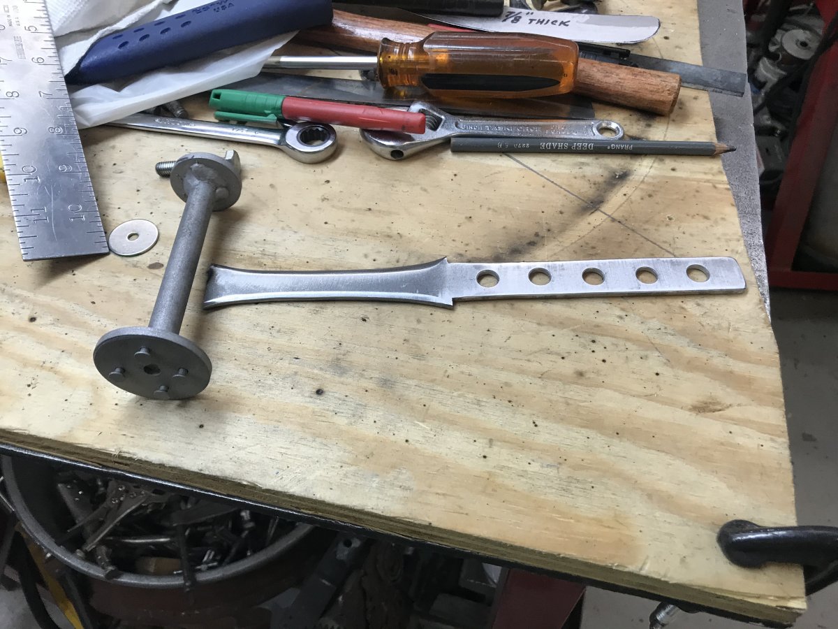

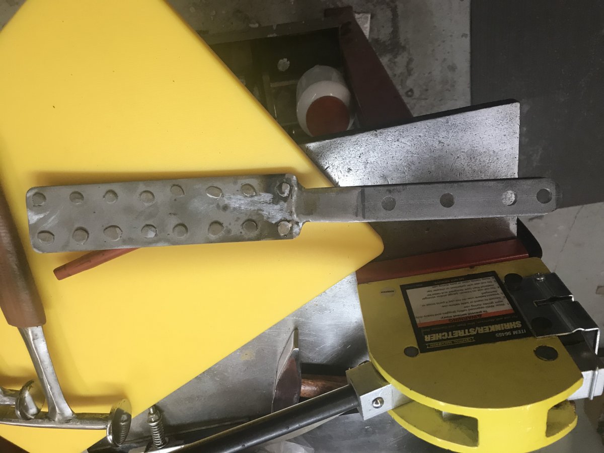

    EBC8CCDE-1703-444D-B2EA-47208B596F37.jpeg 87111ACD-CB14-47A2-A436-70910EB40CA2.jpeg 87111ACD-CB14-47A2-A436-70910EB40CA2.jpeg I just finished making a slapper and a hammer using a $15 cutting board.

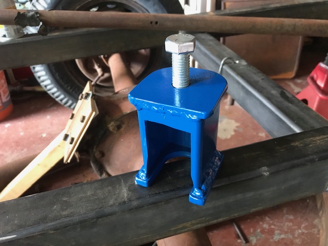

  21. here is an oil pump pick up tool I made out of an old chevy fuel pump push rod and a 5/8 inch steel rod collar clamp. works great and only cost 6 bucks.

    Mike you big tease...
    Please elaborate on how you attached the cutting board to the steel? It almost looks like you melted the material for these and recast them in place, but I can't tell.

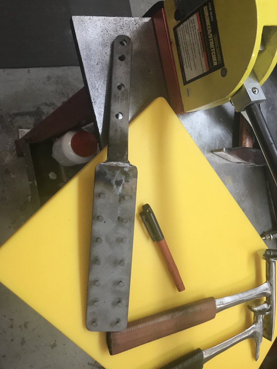

    Ok here is how to attach HDPE or other plastic to steel. I have only worked with HDPE cutting board 1/2” thick. I have some carpet tack strip nails used to attach the strips to concrete floors. These nails are 1/8”in diameter and about 5/8” long. In order to attach the nail to the steel I drilled a 1/8” hole insert the nail till the top of the head is about 3/16” above the steel surface then weld the nail stick out to the steel. The best way is to grind the nails flush and tig weld all flat. Looks better. Now the fun part. Heat the steel up till it turns blue about 520 degrees F. Carefully place the steel on to the hdpe that is on the bench. The hdpe will melt as the nail heads touch the hdpe. Press the two together till the steel touches the Hdpe. It will melt to a liquid as the nails displace the hdpe. This is very hot use gloves to do this. Alignment is the trick here practice placing the two together. If the steel looks ok t will go into the hdpe too far you can put water on the steel to cool it all down and stop the melting caution the plastic stays very warm a long time. Thermal conductivity is low. Now that describes the flat steel.
    the handle starts out as a piece of 1” x 3/16” flat bar. The part that is to receive the hdpe handle is cut narrow to about 5/8” to 3/4”. 3/8” holes are drilled about 1” apart along this length. 2 pieces of hdpe are cut oversized. Pick a nice handle you like and trace the shape. Cut oversized 3/8”. Place one piece on the bench good idea to place long finishing nails 2 per side to hold the piece in place put the nails outsid of the piece not through the piece. Now heat th steel to blue. Position the hot steel on to the piece on the bench then place the second half on top to make a pile. Then press pretty hard the pile together the hdpe will melt and come out petween the pieces welding the hdpe as it moves out clamp will make it easier. Belt sanders and draw filing will be needed to shape the final shape. In order to final smooth the hdpe use a heat gun on high to melt the surface just a little to smooth the surface.
    Hope this helps let me know how you did.

    Does the HDPE stretch metal on dolly, or is it enough cushion to just move it? What is the primary benefit over steel?
    I have never even considered making body dollies or hammers this way, but it seems like a way to manipulate/control stretch over using a steel tool. Maybe everybody but me already knows about this trick.:)

    HDPE is too soft to smash steel so it can’t stretch by smashing. I use it to smooth lumps using a dolly on the opposite side. As another little trick I use smooth river rocks as dollies. They come in infinite shapes and sizes. One will be just right for the job. The HDPE will not mark aluminum or steel
