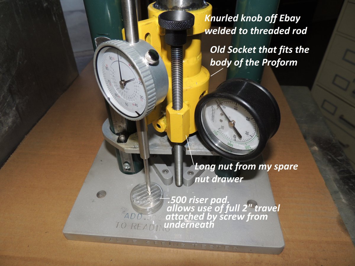

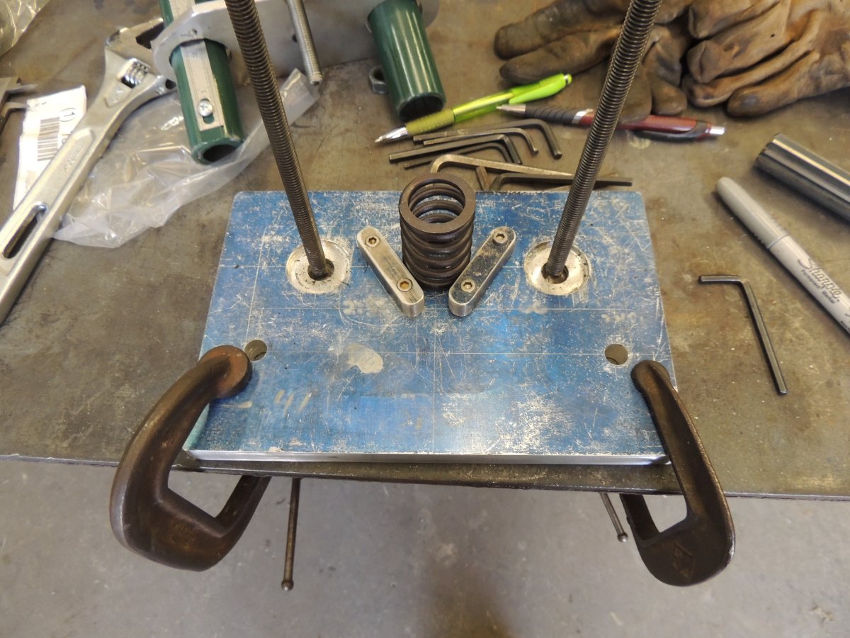

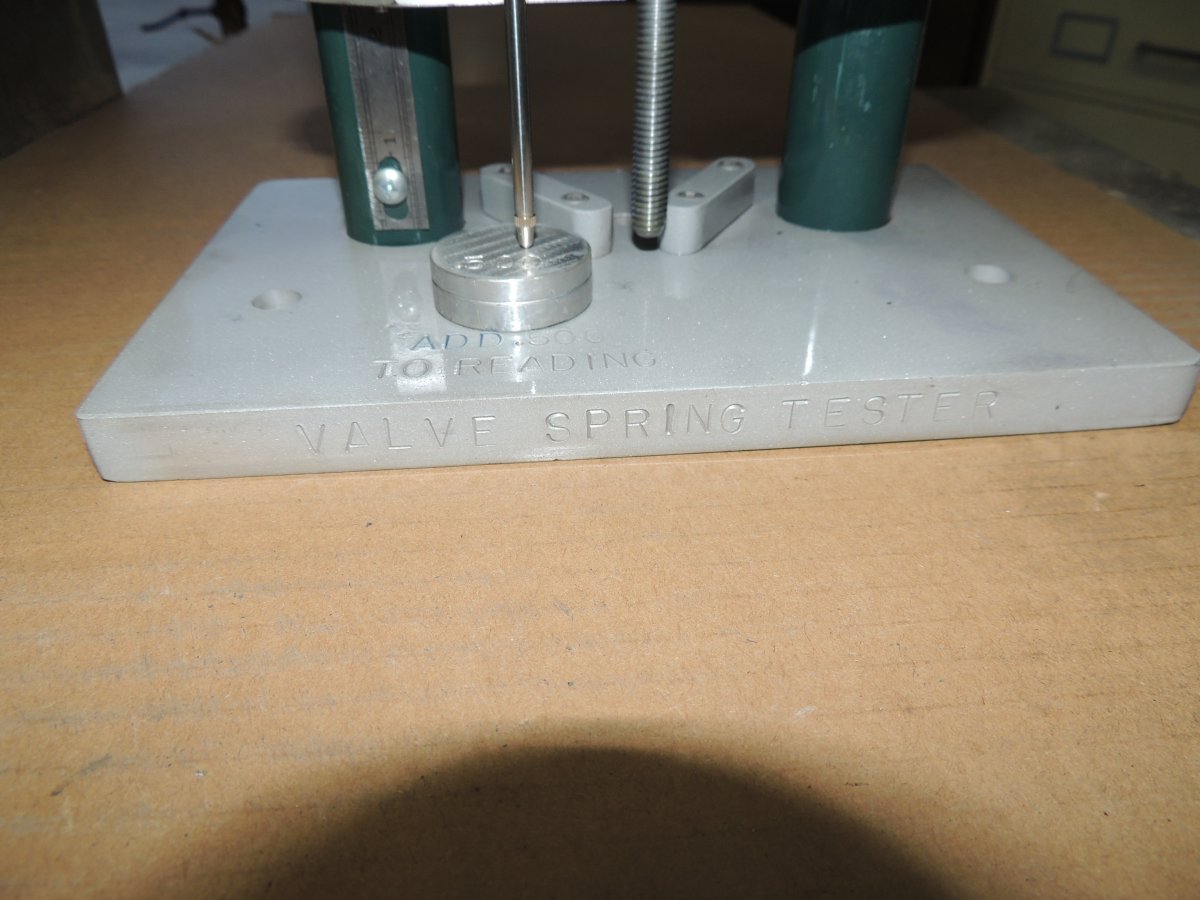

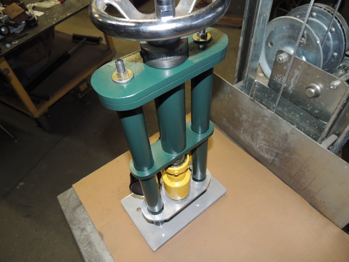

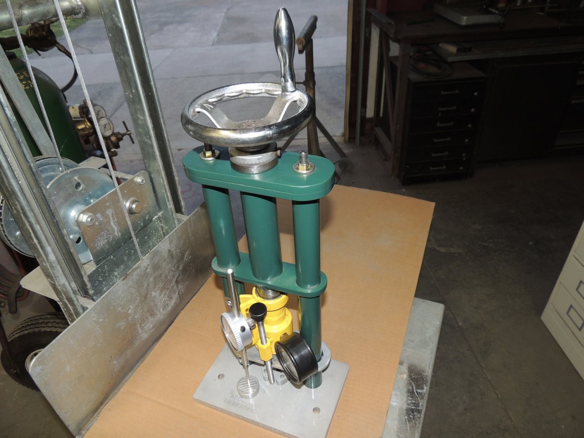

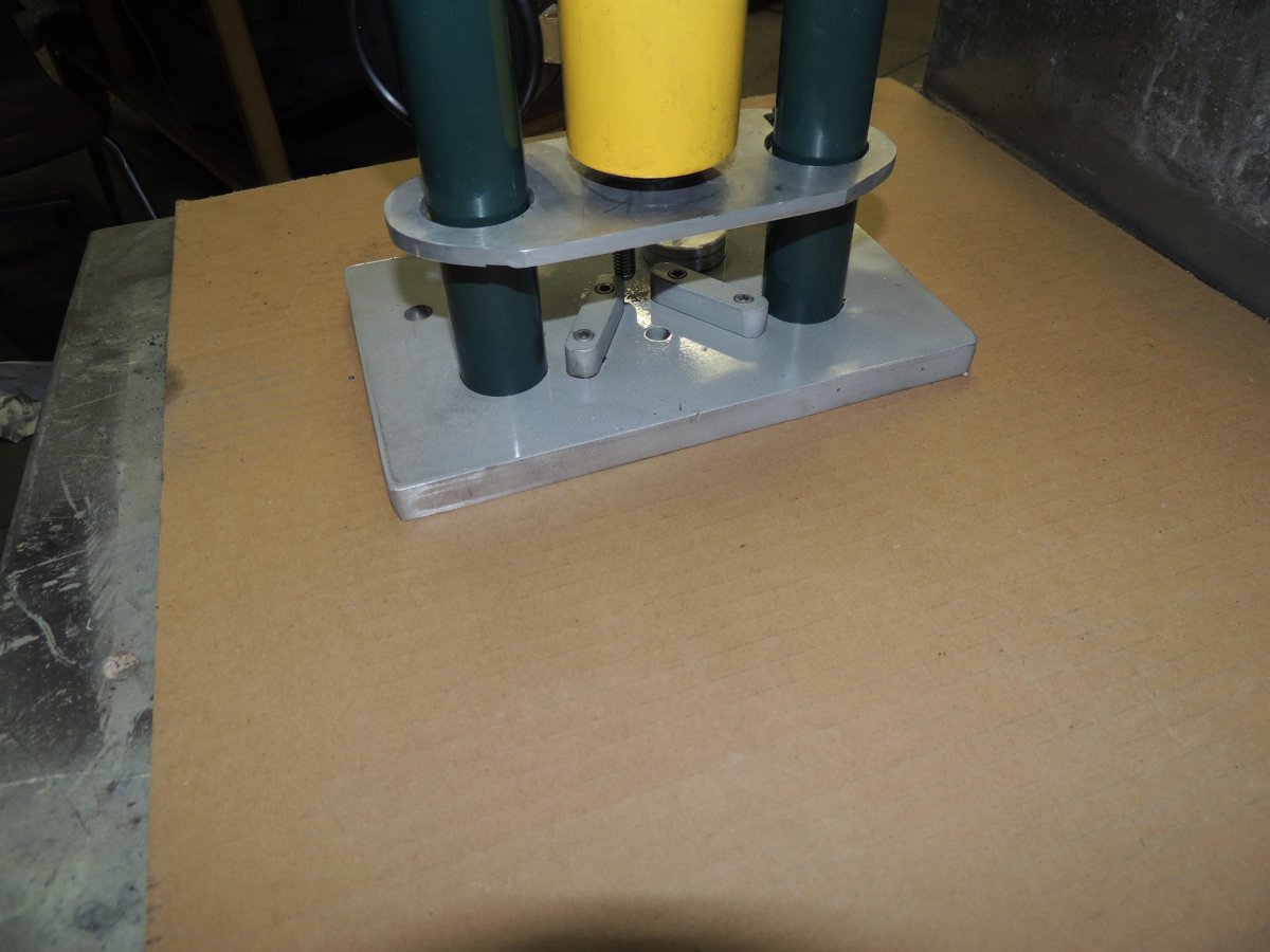

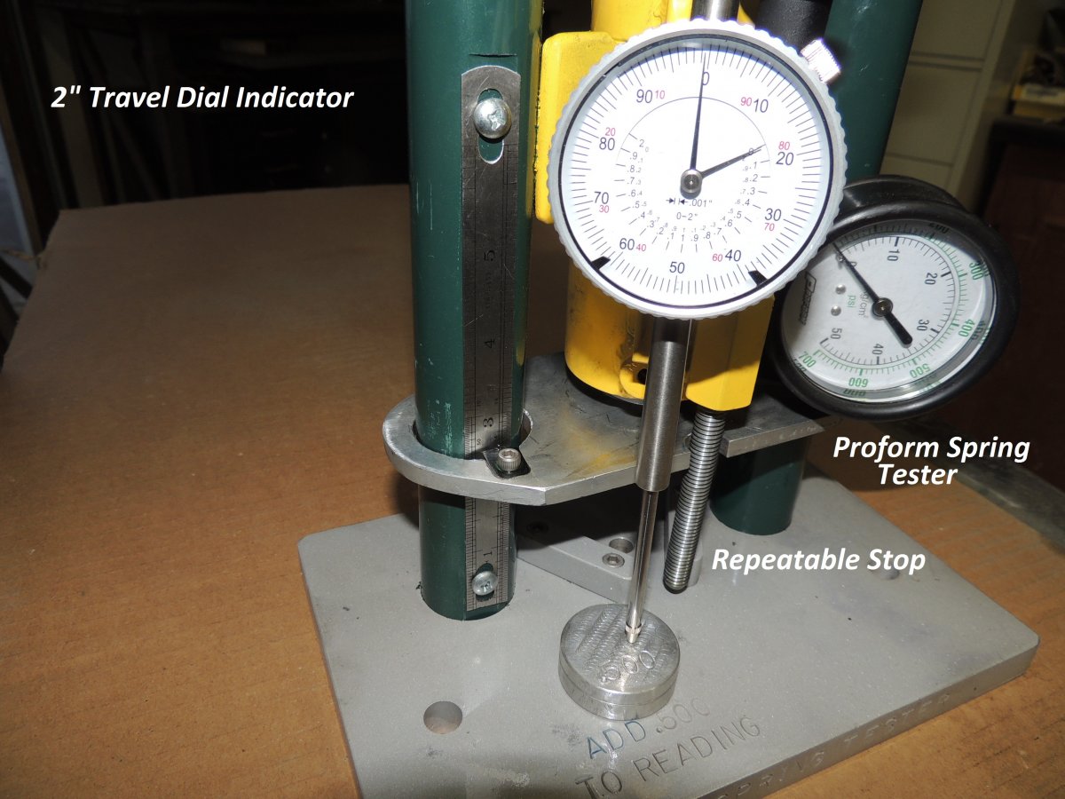

    Thought I would post my newest addition to my tool inventory. I wanted to be able to check some valve springs but I didn't like the idea of using a tester in a vice. Seemed pretty ineffective and clumsy.......the clumsy part being "me".
    The good testers ran from pretty expensive to really expensive. With only about $125 and about a little:)):D) time,I came up with this concoction. It gives me repeatable control and verification very easily. I bought the Proform Spring Tester for about $80. The 2" travel dial indicator was $25 from Amazon. A $10 1.750 Socket and a $4 knurled knob from Ebay. Forgot what I gave for the ruler, but it came in a pack of 2 and was cheap. The main component, the crank handle with the acme thread was from my junk pile along with the tubing and aluminum base. Oh, the original crank handle was too small, so I had to buy a larger one for $15 and a few dollars for some acme thread nuts. So I spent a little more than originally planned, but I think its actually better than some of the expensive testers. But then I'm probably a little biased. I think one thing that works well is the 2" dial indicator. Most any spring I will be dealing with will be in the neighborhood of 2" long. Since coil bind in springs of this size usually occurs at .900+, by using a .500 riser as the starting point for the indicator, I should have plenty of travel to check coil bind and any point above that. The 2" indicator came about after I had the ruler installed, and it gives me good accuracy...I hope.

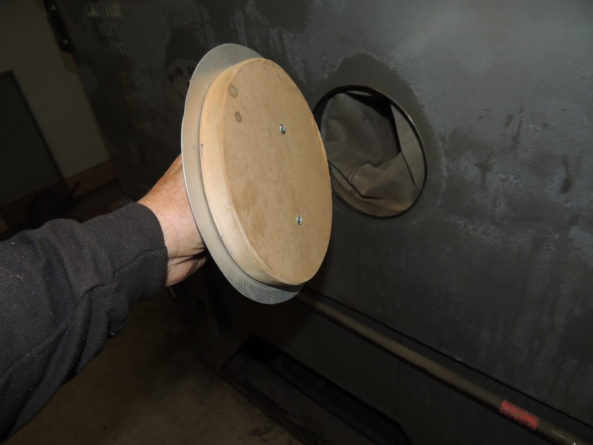

    While I'm on a roll, here are some covers I made a long time ago for my sandblaster. They slip in place and keep critters from crawling inside the gloves. I always wondered if a spider or something might be in the gloves when I hadn't used the blaster for a while.

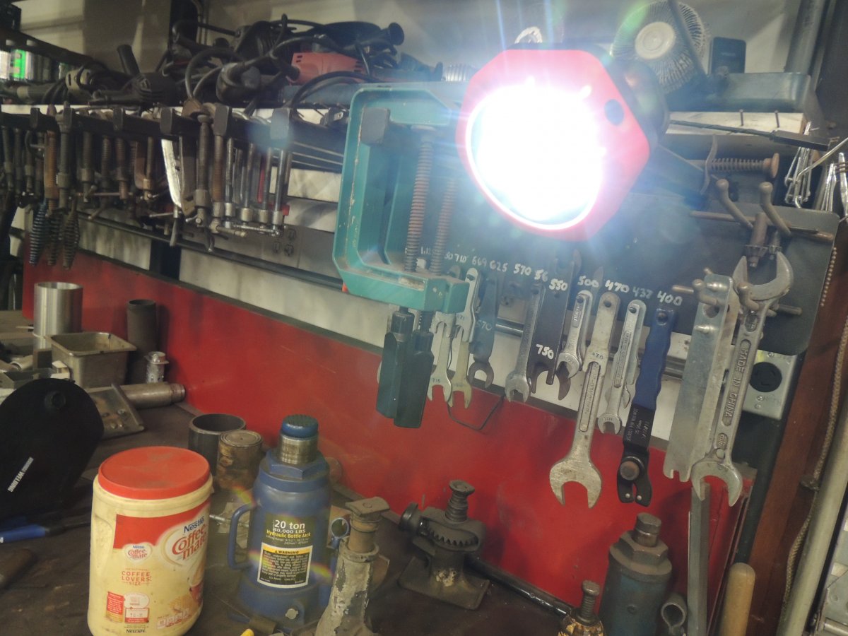

    Last of all, not something I made, but a handy dandy Harbor Freight LED Light. Bout 4" in size and great for providing additional welding light or up under the dashboard etc. It has a magnet in the base. Bout $7 I think.

    What is the pressure gauge used for on a spring tester?

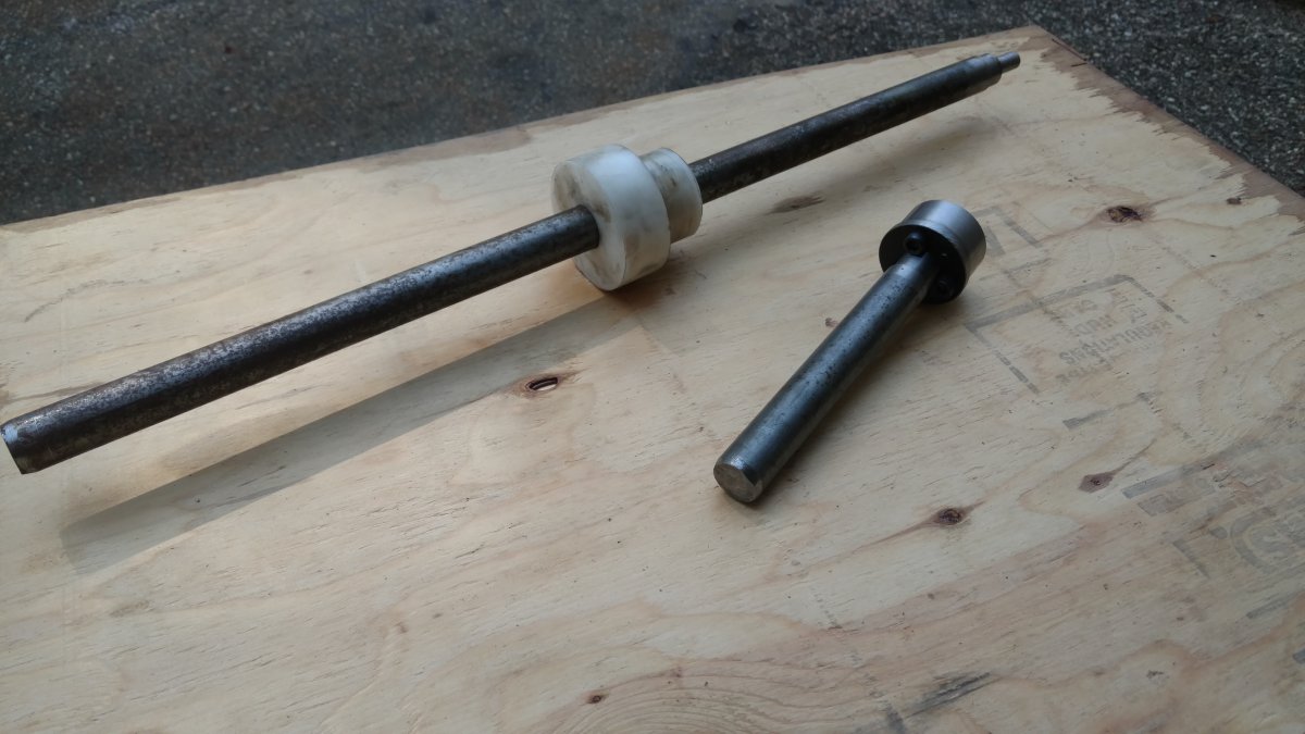

    I made a cam bearing remover/installer for my big block chevy. Cut the nose off the old cam and made a plate out of some scrap 1/4" plate I had that I drilled to fit the cam dowel and bolt holes. Mounted it on the cam nose and turned it down to just under the diameter of the bearing journal in the block. Then took a piece of 1" rod and made a short and long drive rod for it. Then made a centering piece out of some nylon to keep the rod centered in the journals. Worked like a charm driving out the old bearings, and I'm hoping it will work just as well driving in the new ones.

    Thats what tells you the strength of the spring at open and closed valve lengths.

    Cylinder has a 1 sq. in. bore. 300 pounds on the cylinder reads 300 pounds on the gauge.

    "I always wondered if a spider or something might be in the gloves when I hadn't used the blaster for a while".
    I like the way you think. o_O

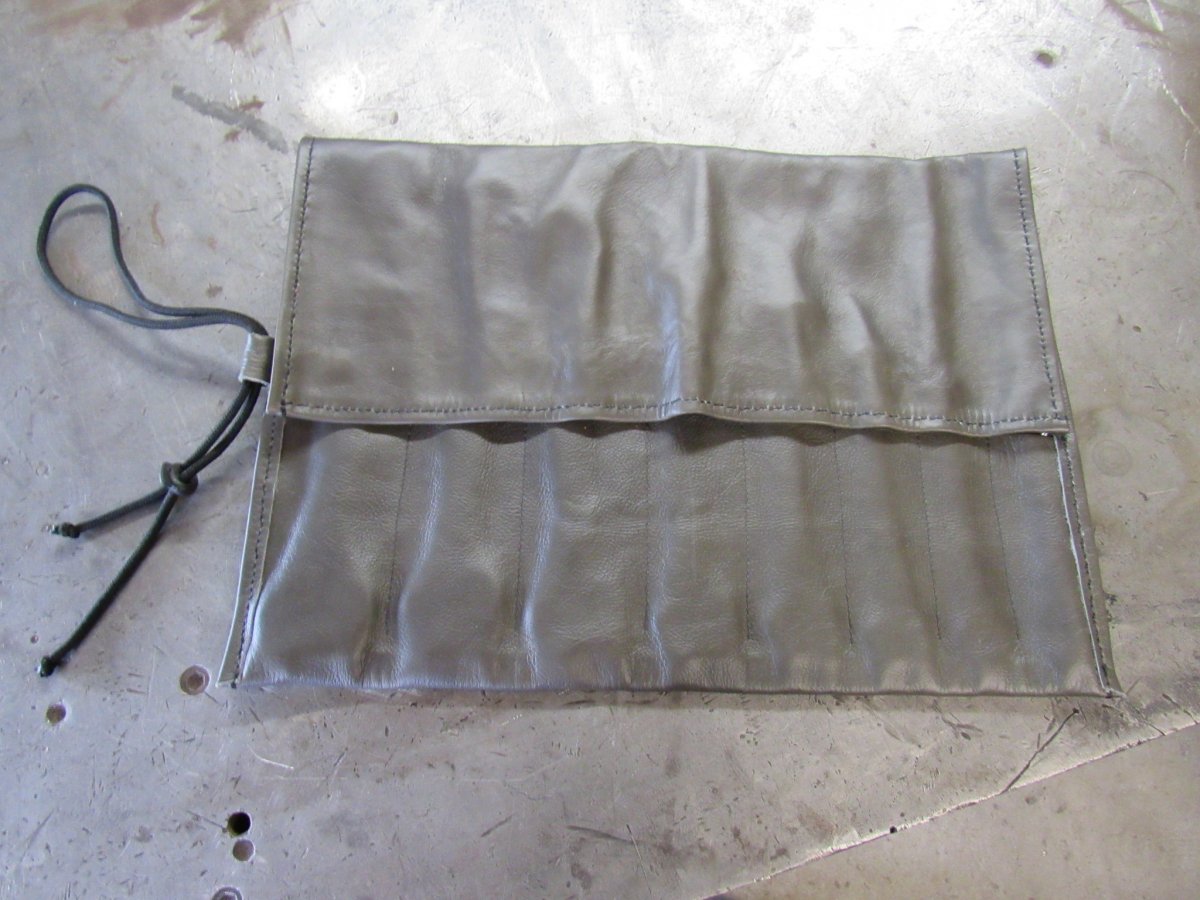

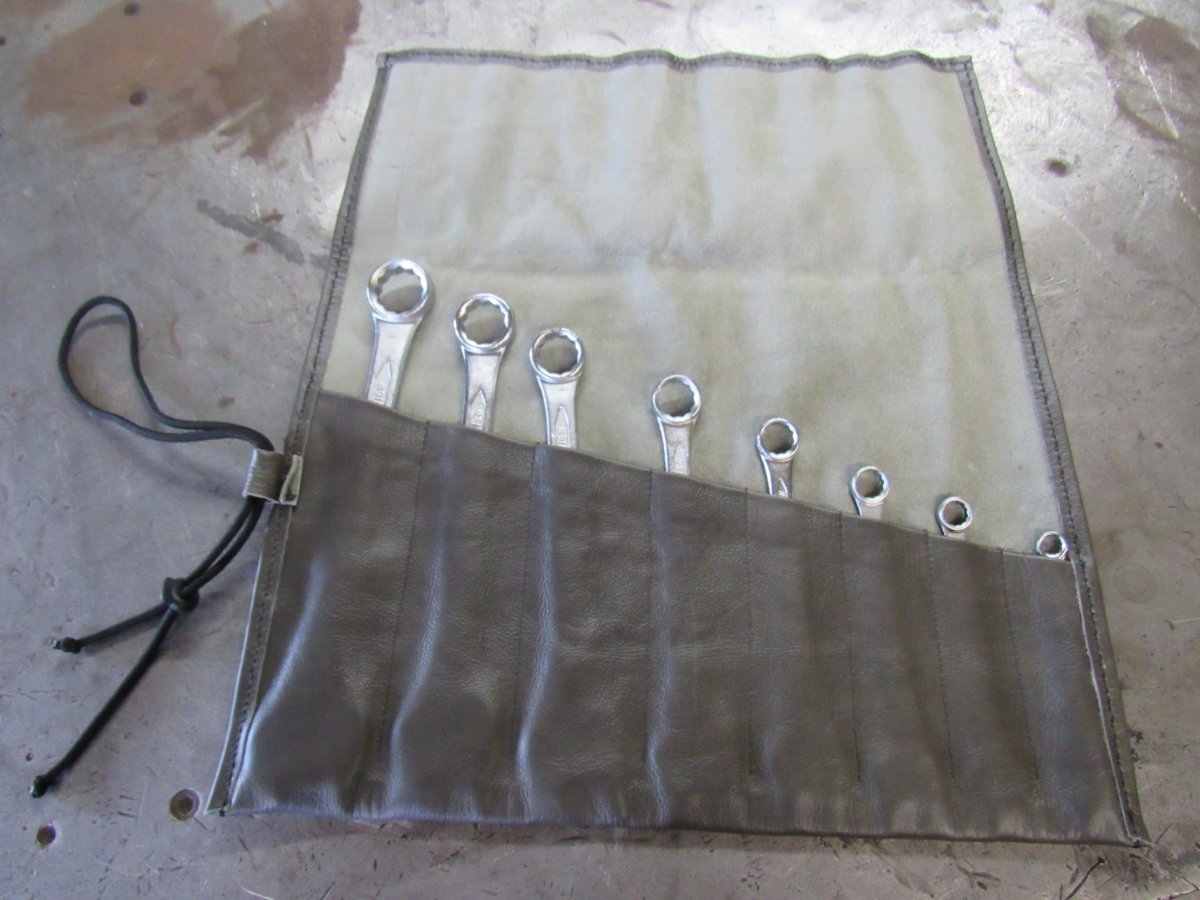

  12. not a home made tool, but a home made tool holder. my wife made me this wrench roll to hold my Witworth wrenches. she made it from scrap leather she had. it is a fine furniture grade. she did a great job. IMG_0071.JPG IMG_0072.JPG IMG_0073.JPG

    So, tb, do you have a Trumpet or Beezer you carry these on?

    Awesome! I love wrench folds! A great way to carry tools on the road, and determine if you have all of them when you are done with a road project!!! Your wife did an excellent job!

  15. 1 sq inch area come from 1-1/8” bore hydraulic cylinder (.99402 sq inches).
    it’s pretty handy little coincidence for measuring all kinds of crap when the gauge PSI reading converts straight to weight.
    With some cheap wheel cylinders and gauges you can make scales to weigh cars, axle weights, with 4 you can weigh way bias, make real time adjustments, see how moving a 50 lb battery around changes all 4 corners, pre load sway bars.
    You can actually order the correct coil over springs :D:p the first time!! Maybe even figure out the spring rate of the transverse springs that plague so many. Easily calculate un sprung weight to sprung weight ratios
