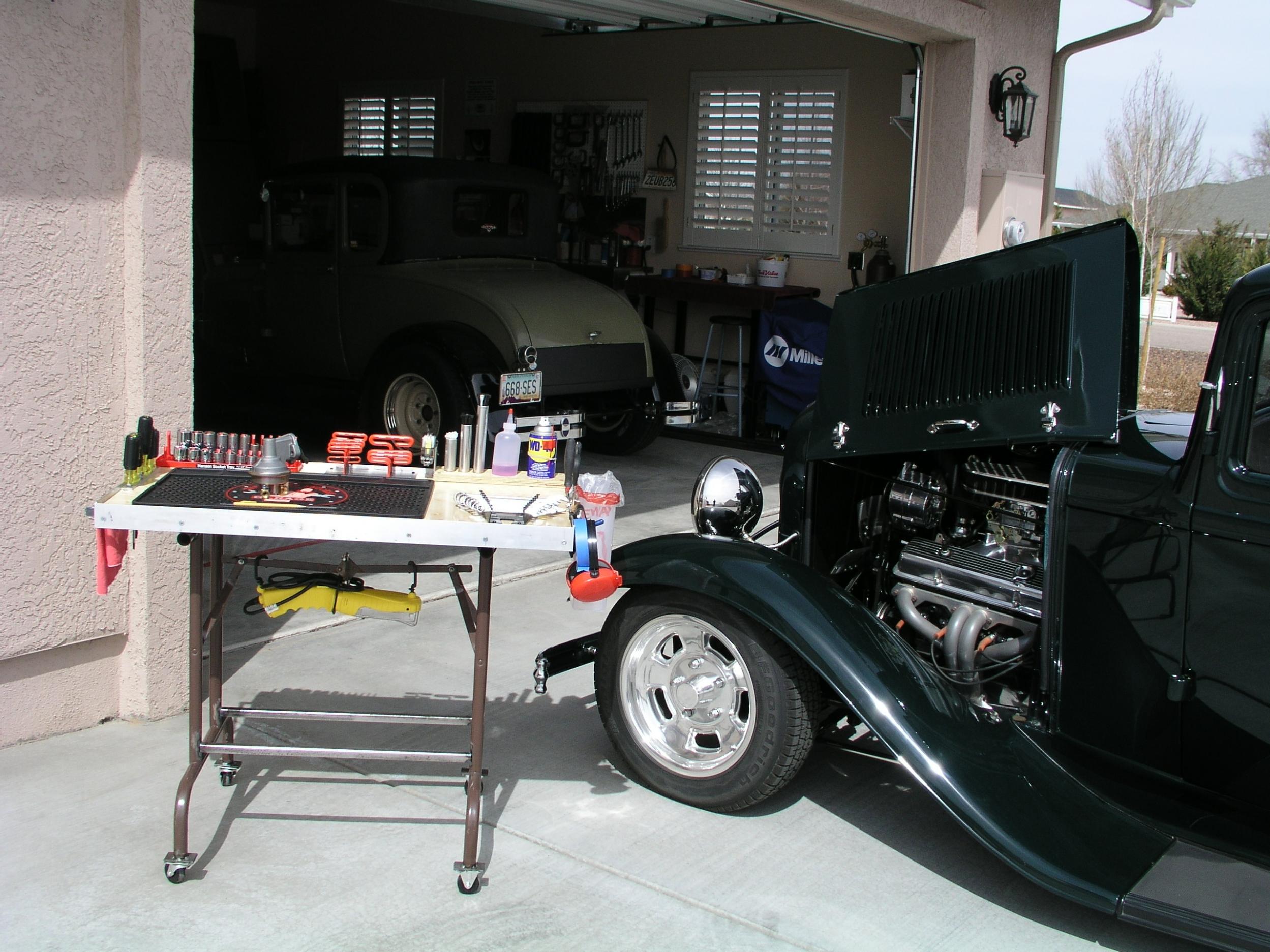

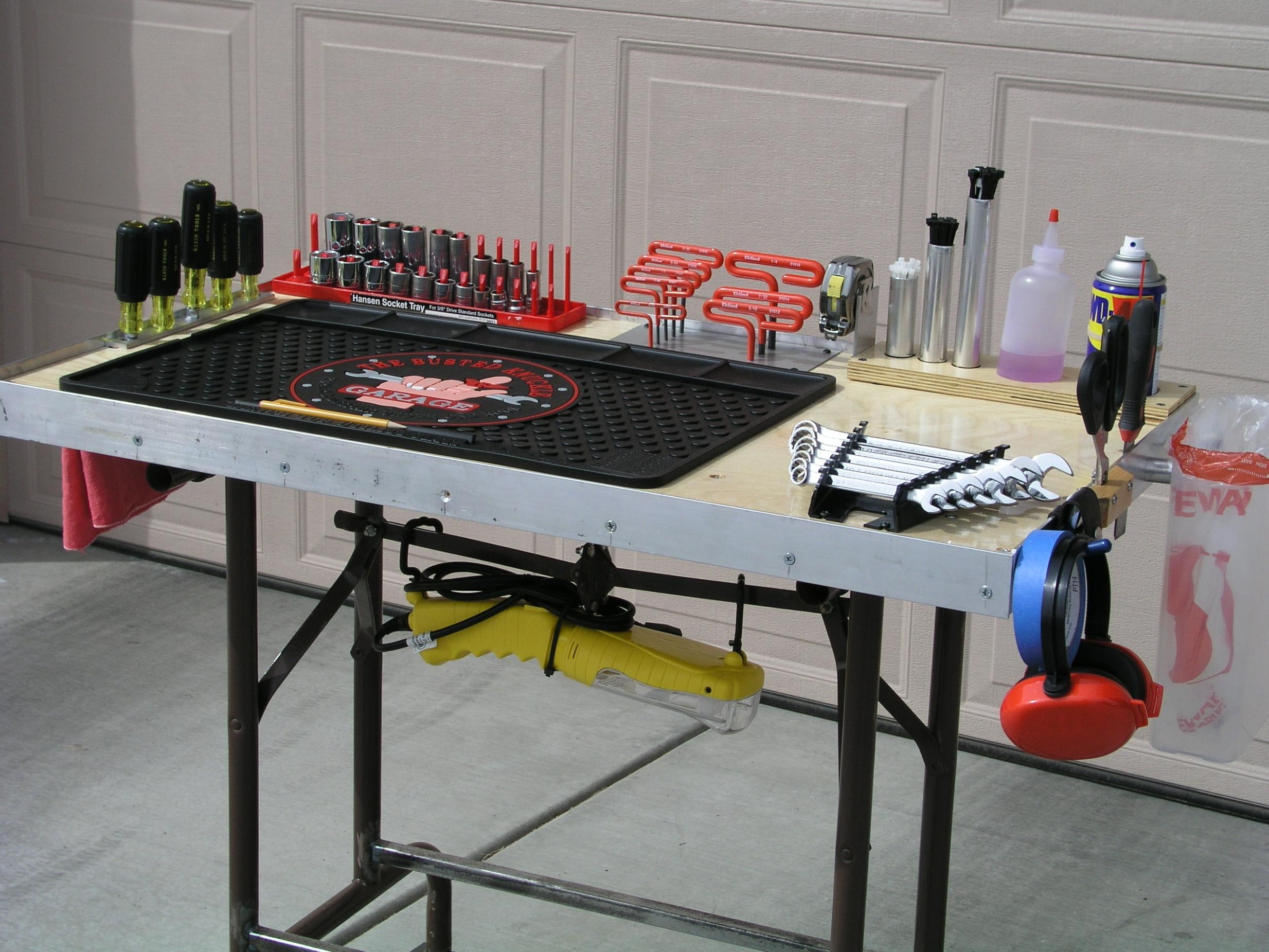

    Not excactly home made, but home modified. A guy threw this in at the last minute on a tool deal and it's one of my favorites for a garage with limited space.
    Very low profile, with 5 wheels. The 5th wheel is attached to the foot levered cam that raises two of the other wheels off the ground.
    Lift it up, wheel it out of it's storage space, and lower it back down to use whatever's mounted on it.
    I adapted it and mounted two low use tools. A band saw and a sander. Now that it's so accessible, I use both tools all the time.

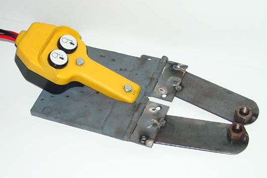

    My modified HF bead roller. Works great, no complaints! and it was cheap!
    Used $49 winch with hand control modified into a foot control. Has hanger rack for foot control that nests into the frame for storing.

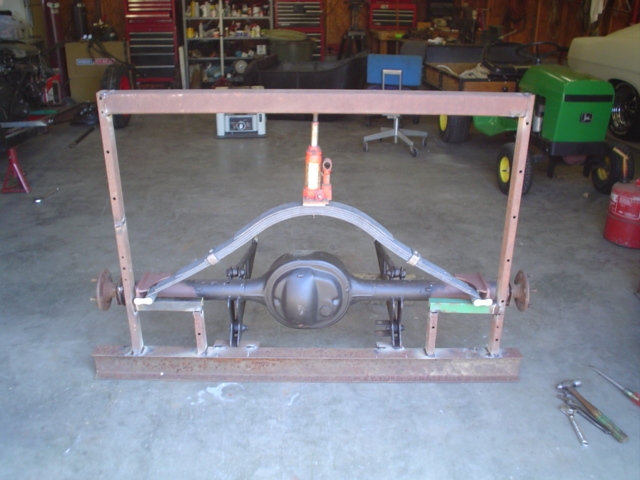

    the tool I made looks like pre-school. Anyway, I made this spring
    spreader for my Roadster. I had to notch the center for the
    9-inch hump. It seems to do the job. Couldn't imagine installing
    the rear spring (5-inch spread) without it.

    Yea, I think this old tool I made would work on reversed eye springs.
    It's kinda bulky, but it worked for my purpose. The bottle jack pressed
    down the spring, and it would slide the ends out. Gotta be careful with
    it. I used it with rear-ends that were mounted to the car, just have to
    set the frame on some wood blocks to get the right elevation.

    That should work quite well on reversed spring eyes. Just set it up so that when the eye slides over , it is on the correct level for the shackle to hook up.

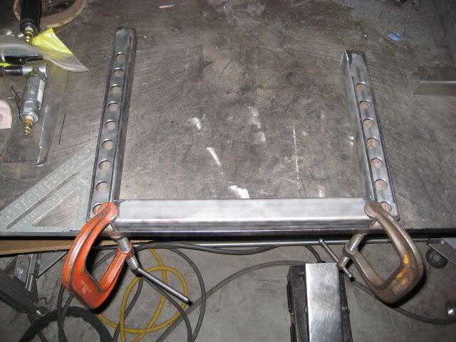

    I recently bought a used Miller plasma cutter of Craigslist. I needed a cart for the unit so I built this out of scrap I got from work:
    The top tray for the plasma unit
    The legs; I drilled the holes for just for looks
    The legs laid out and clamped for tacking
    The legs after tacking
    Clamping the legs and top tray for tacking
    Here are three pic's of the finished unit. I added some scrap tubing to the rear for the power cord and side for the torch. Four casters on the bottom and a coat of paint and this is what the finished product looks like:
    rytang and slack like this.

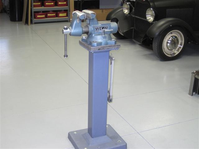

    Here is a item that I came up with... I move the vise from the bench to a free standing pedestal which allows 360 degree access. Then I made a flat work station which is easly removable as needed. I cut a piece of 1" thich material, 6" x 12", trued the edges, then drilled a 3/8" hole in the center. This allows a removable hold down clamp. Very handy work center.

    I have made a set of detailed buildup instructions for this bead roller if you are interested, complete with part numbers and where to purchase these parts.
    The winch came from HF (horrible freight)

    This winch and control are on sale right now at Harbor Freight for 39$. How did you set up the chain drive drum for the winch ?

    What do you have on the bottom of the stand so it doesn't gnarf up the floor?
  24. Donut Dave
    Joined: Jul 9, 2007
    Posts: 370
    Donut Dave
    The pedestal sets on a 3/8" thick rubber then it was bolted to the floor with (4) 1/2 bolts, very stable.
