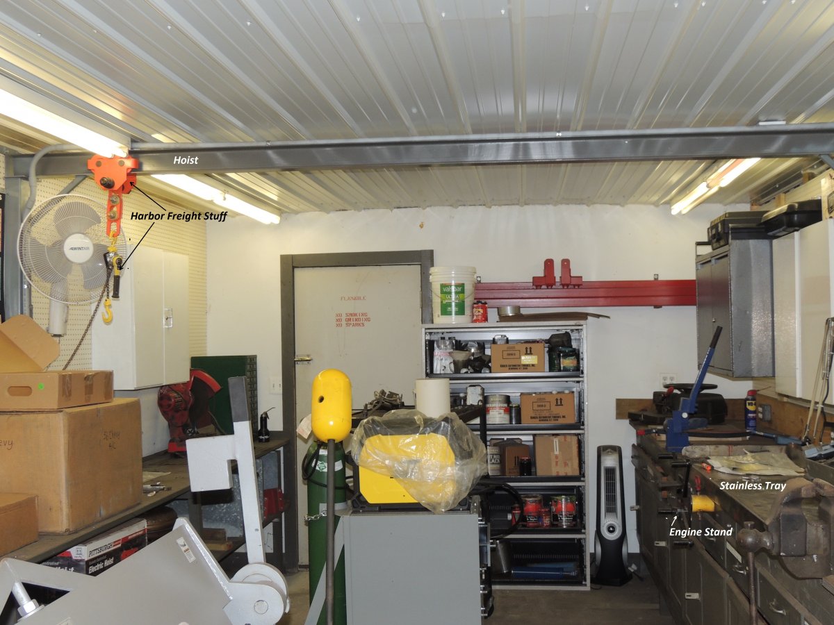

    Now I'll show you the overhead cranes. They are the handiest things for a shop. Even one simple straight beam can do a lot for a shop. The first cranes are in my pole barn. Crane 1.JPG DSCN0817.JPG

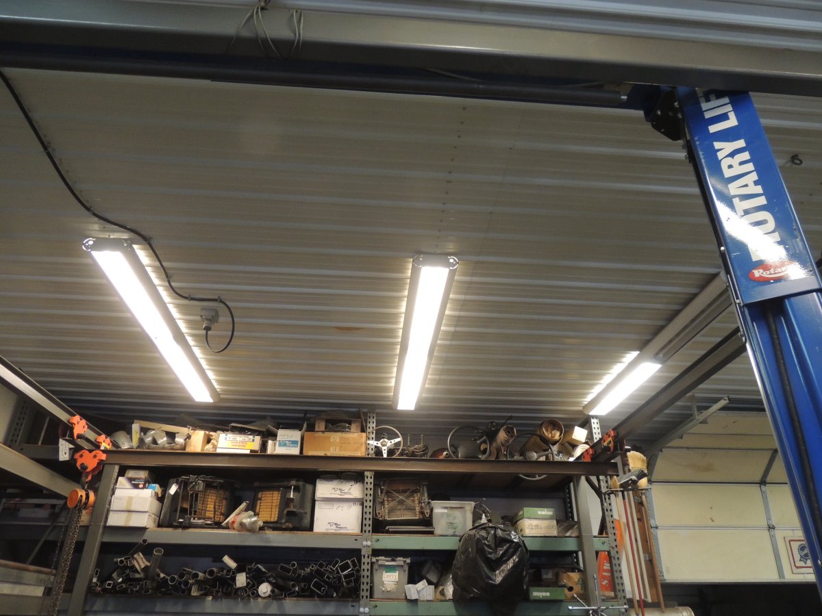

    To try to avoid confusion I'm keeping the pictures on different posts My other crane is smaller and made from 4" I beams. Its set up to work with the two post lift, but not attached to it. On this one, the supports are outside the lift so I needed 2 crossbeams. One is in front of the lift and the other is behind it. Because of the pallet racking and some other existing shop items I did it this way. When we build the one in my sons pole barn we will use his lift as the main support and mount the I beams inside the lift posts. Then only one cross trolley will be needed. Its hard to get a good picture of these lifts that shows them well. DSCN0815.JPG DSCN0815.JPG DSCN0814.JPG

    Matts Crane 1.JPG DSCN0912.JPG DSCN0913.JPG Matts Crane 4.JPG DSCN0914.JPG Here are the beams we are currently installing in my sons outer building. We are trying to get them installed so he can get the floor concreted. We built supports for rafters and then hoisted the beams up. Lotta work making the supports and only a few minutes to hoist them up. We felt it was too dangerous to try and lift them with the tractor. Last picture is some poles from industrial security fencing which the company I worked for cut down. Heavy duty and great for our crane.

    This is the building where we are going to put up a smaller cranes with 4" I beams and use the lift as the center support for the crane. I have made some brackets which will bolt to the lift and support the center of the long beams. Either the pallet rack at the rear, or maybe a braced pallet rack will support one end. Where they protrude toward the front of the building we will make a traditional 2 post support with a cross beam and fasten it to the floor. DSCN0847.JPG

    DSCN0831.JPG DSCN0946.JPG Here is a small little crane I made when I had some heavy stuff on the workbench on the left. I made the wooden workbench on the right about 40 years ago. I placed a stainless top from a school auction on top of it for working on messy jobs. Later I modified it with an engine stand attachment. The support for the engine stand goes all the way to the back of the workbench to provide enough support. It can be removed and stored when not needed. The little crane beam lets me lift the engines in place or set heavy things on carts.

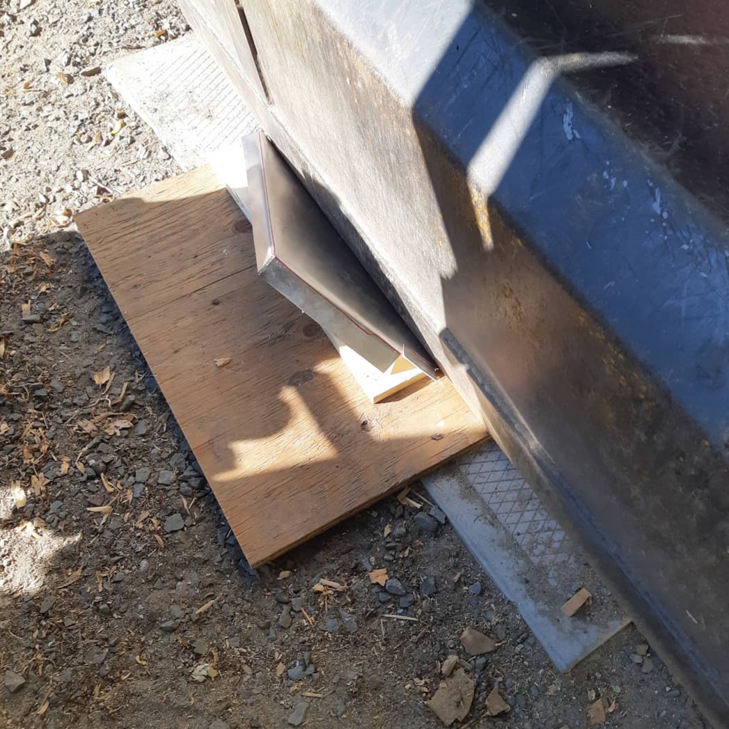

  18. I found this tool in a pile of stuff at the recycle center. some one took some time making it. I hope I never need it. IMG_5580.JPG IMG_5581.JPG

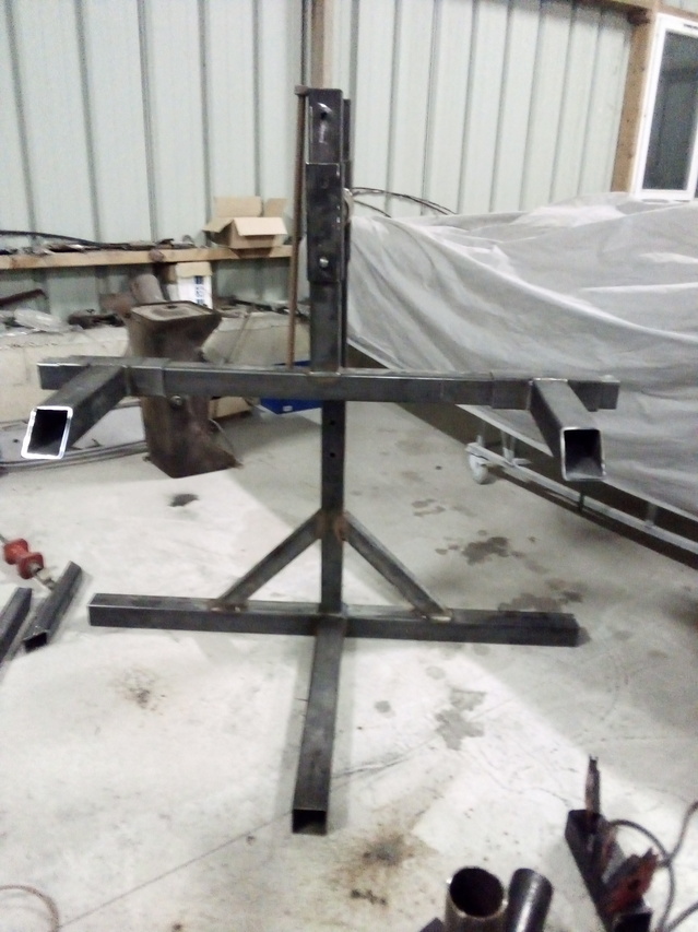

    I'm finally getting around to building my rotisserie, I first got the ACME thread and pipes almost 15 years ago lol. But until now I was able to use somebody else's, I still am but I also need to put a 69 charger on the rotisserie so I have the need for a second one. So I bought 80mm (3") and 70mm (2-3/4) both 4mm wall square tubing.
    Instead of pressure screws I use pins which don't crush the tubes, the way I drilled 2 set of holes allows me to have about 2" of increments.
    For the lifting I'm thinking of using hi lift jacks instead of hydraulic ones because I want to be able to pick a car from about a foot of the ground. I know they can be dangerous to use, but since they will be permanently in place and the locking will be the pins I will eliminate 2 of the danger related to those jacks. Only downside I see is it might be hard to have the jack locked and my adjustment holes to match. I might consider using an ACME threaded rod instead of the hi lift jack, what do you guys think?

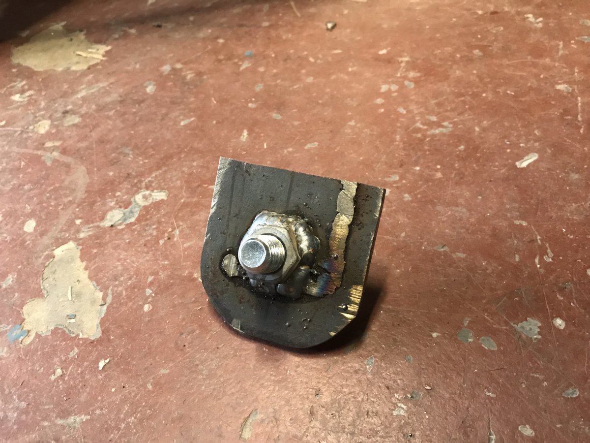

    Not as fancy as some of the other tools posted but to me if you have a Falcon/Comet/Meteor/Fairlane/Mustang essential for avoiding serious injury when taking apart the front suspension.
