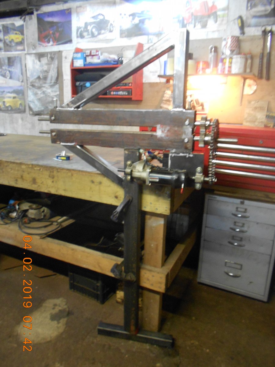

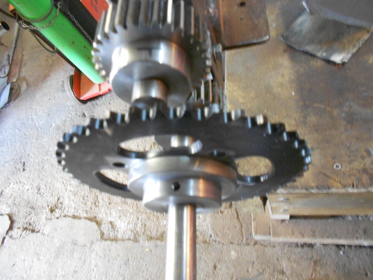

    Wanted to share a few shots of my bead roller project. Its funny. After looking on here and getting some great design ideas, I thought I'd take the plunge and started on it back in early November. I thought, "meh, take two or three weekends and it'll be finished..". Now its Spring and I'm still building it!! Should have the external 3/16" keyways cut in the shafts for the sprockets and die bosses by the end of the week.
    I used a mobility scooter motor and all the wiring and switch/ESC gubbins, and a cheap 42T mini-moto sprocket to get some extra gear reduction. Good thing about using a mobility scooter is you can reverse it too. Plan is to make it compatible with the TIG welder foot pedal I already, so I can just swap it over.
    Here's a few recent shots. Still plenty more to do, remember, it isn't finished yet!

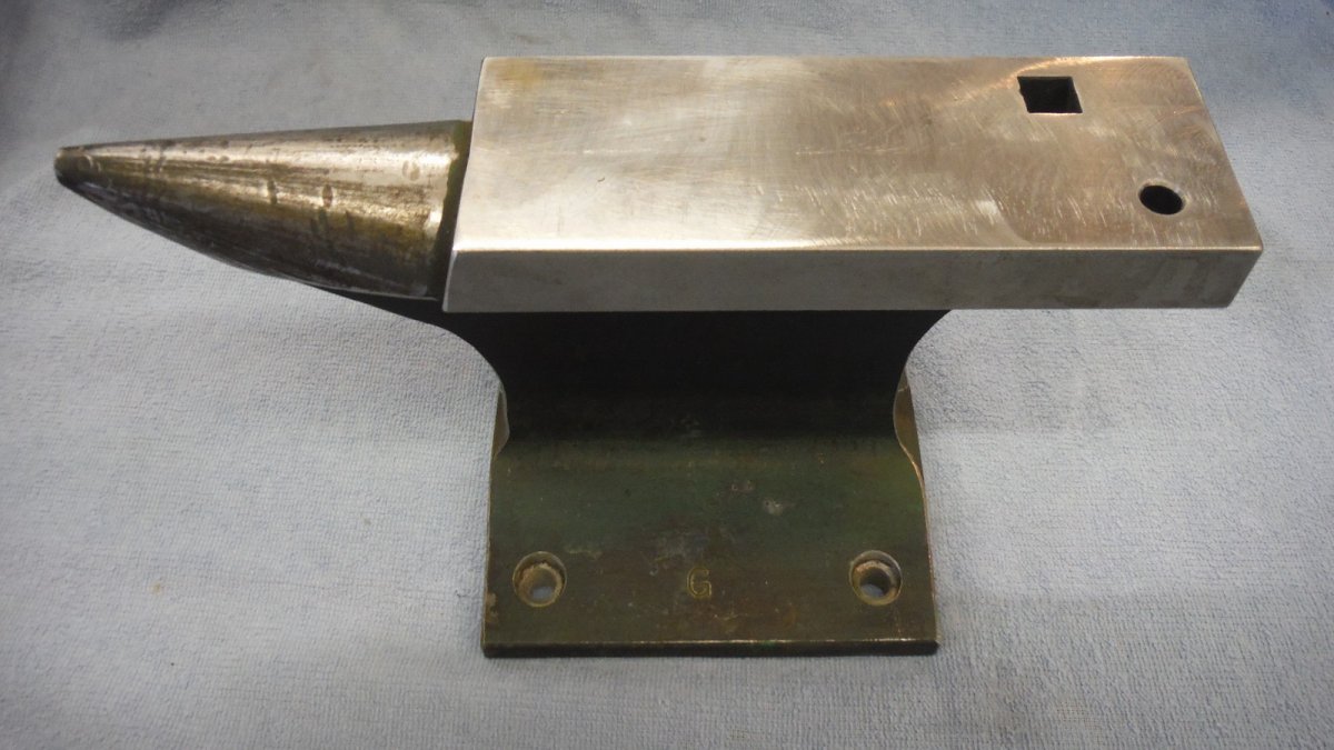

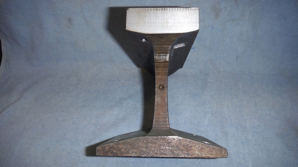

    I made this anvil around 1972. The college had a bunch of surplus rail from somewhere and was free.
    Couldn't pass that up.
    The horn was turned as a taper in a lathe with a center in the tip of it (later ground off) and a center in the back end where the red line is.
    The "hardy hole" was drilled, then a 1/2" square tool-bit gradually forced into it shearing it out to size

  9. I would like to see how you chucked that up in a lathe.

    It was turned between centers, not "chucked" on a big ol' American lathe.
    I just kinda guessed where the center shown by the red line would be.
    There was a dead center in the headstock, might've used a couple of MT adapters to get far enough out for the part to clear a face plate.
    A bolt was fastened to the spindle-mounted faceplate to act as a driver.
    A big live center was in the tail-stock where the small end would be, and with a lot of pressure holding the part.
    It definitely clunked and chunked, so I took light cuts.

    Did you cut it using the compound? Or is it possible to offset that far between centers?
  13. gatz
    Joined: Jun 2, 2011
    Posts: 1,685
    gatz
    Used the compound

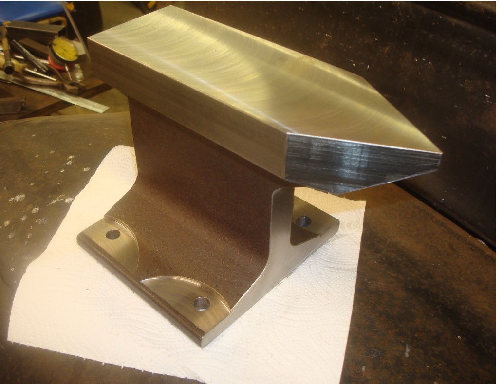

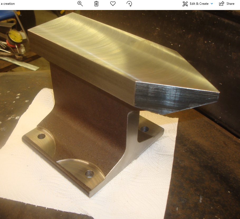

    Inspired by the anvil posted above, I had a go at making my take on the concept of an anvil. I used my trusty 4x6 bandsaw to do the bulk of the work. I just posted up a video on YouTube. Let me know what you think. It's a bit simpler than the one above, but was a learning curve for me. I sort of made it up as I went along.
    I haven't posted up the milling video(s) yet, I have to do a bit of editing.
  24. Nice work.
    I have a 5 ft piece of rail, but I don't have a metal cutting band saw to do the cutting to make an anvil. I use the bottom side of the rail to do all my pounding. I am tempted to make one, but I have too many projects on the go, and can't afford the time right now.

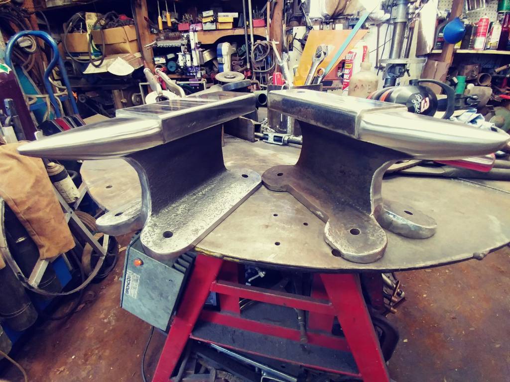

    They look great, rtp, can I ask what are the lengths of the body and horn for each one? (roughly if need be).

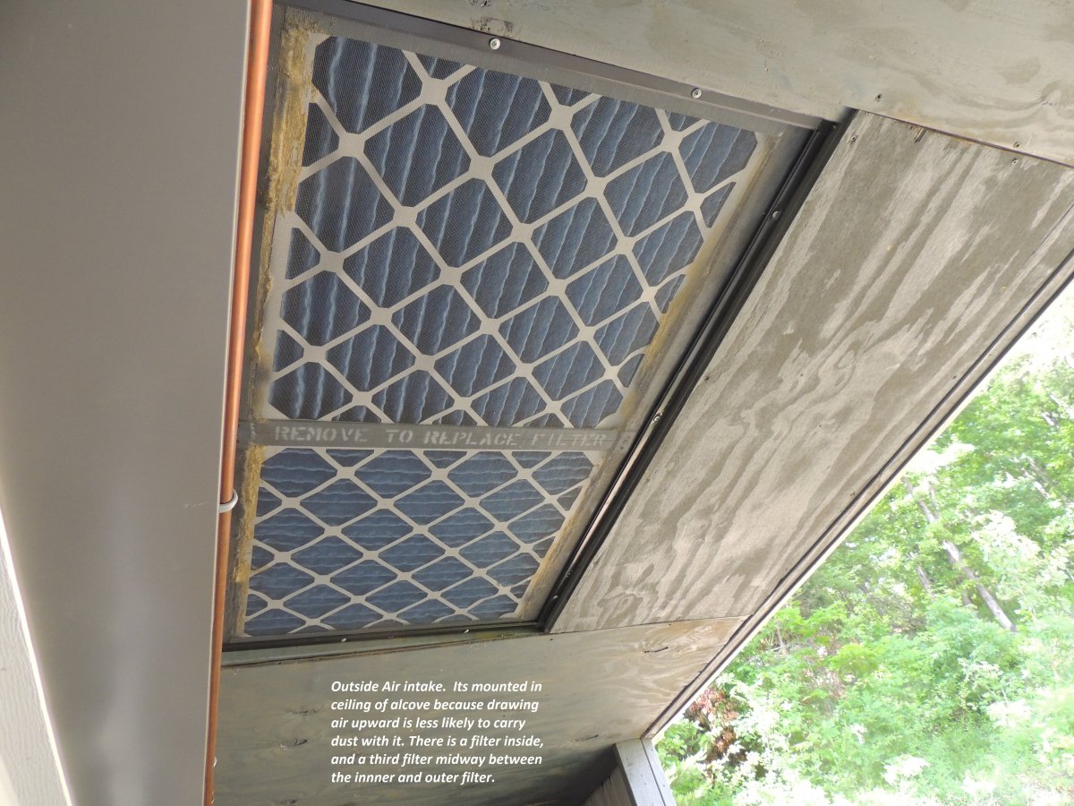

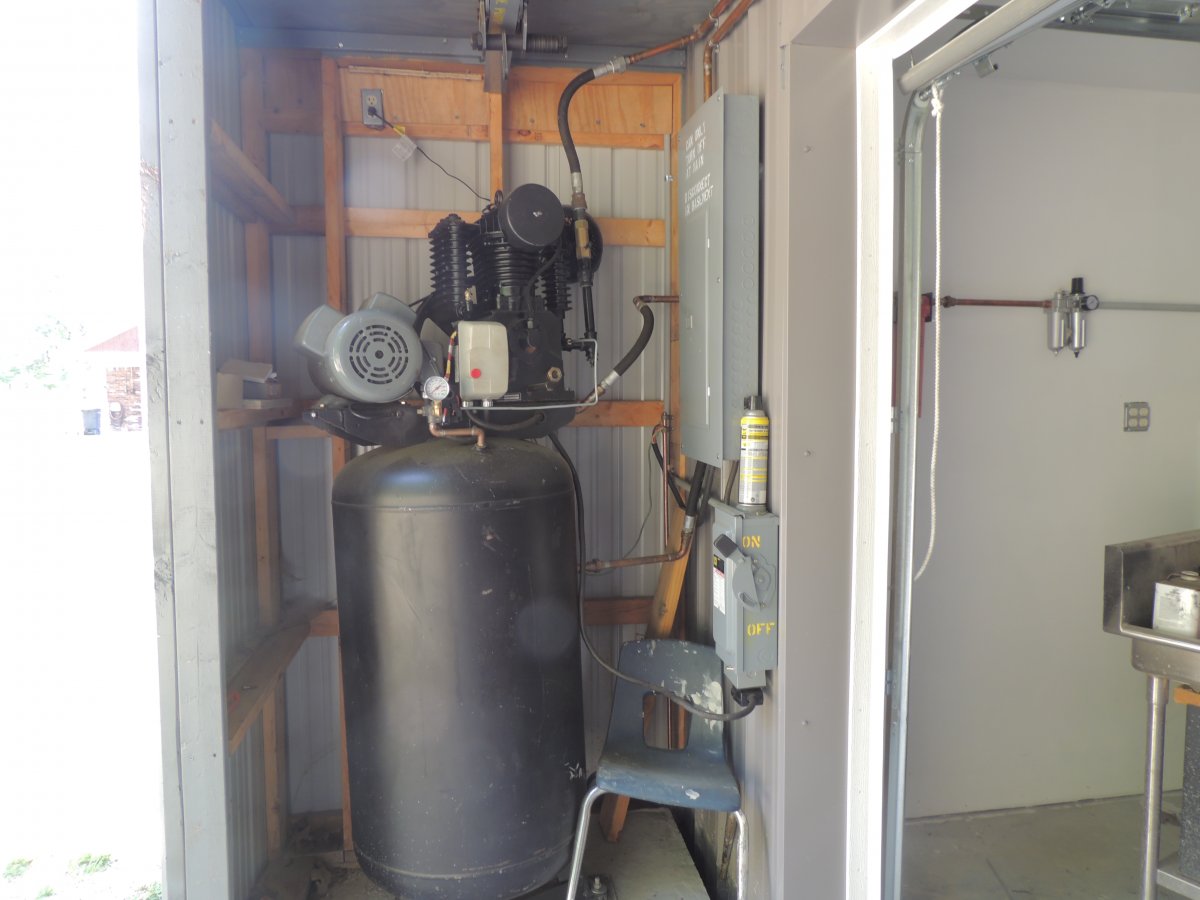

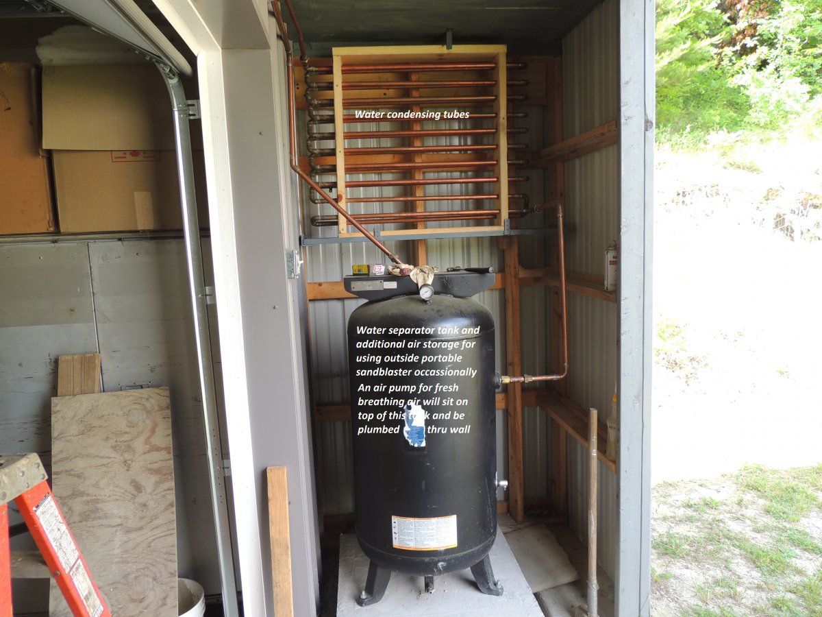

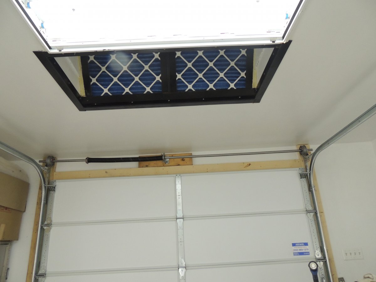

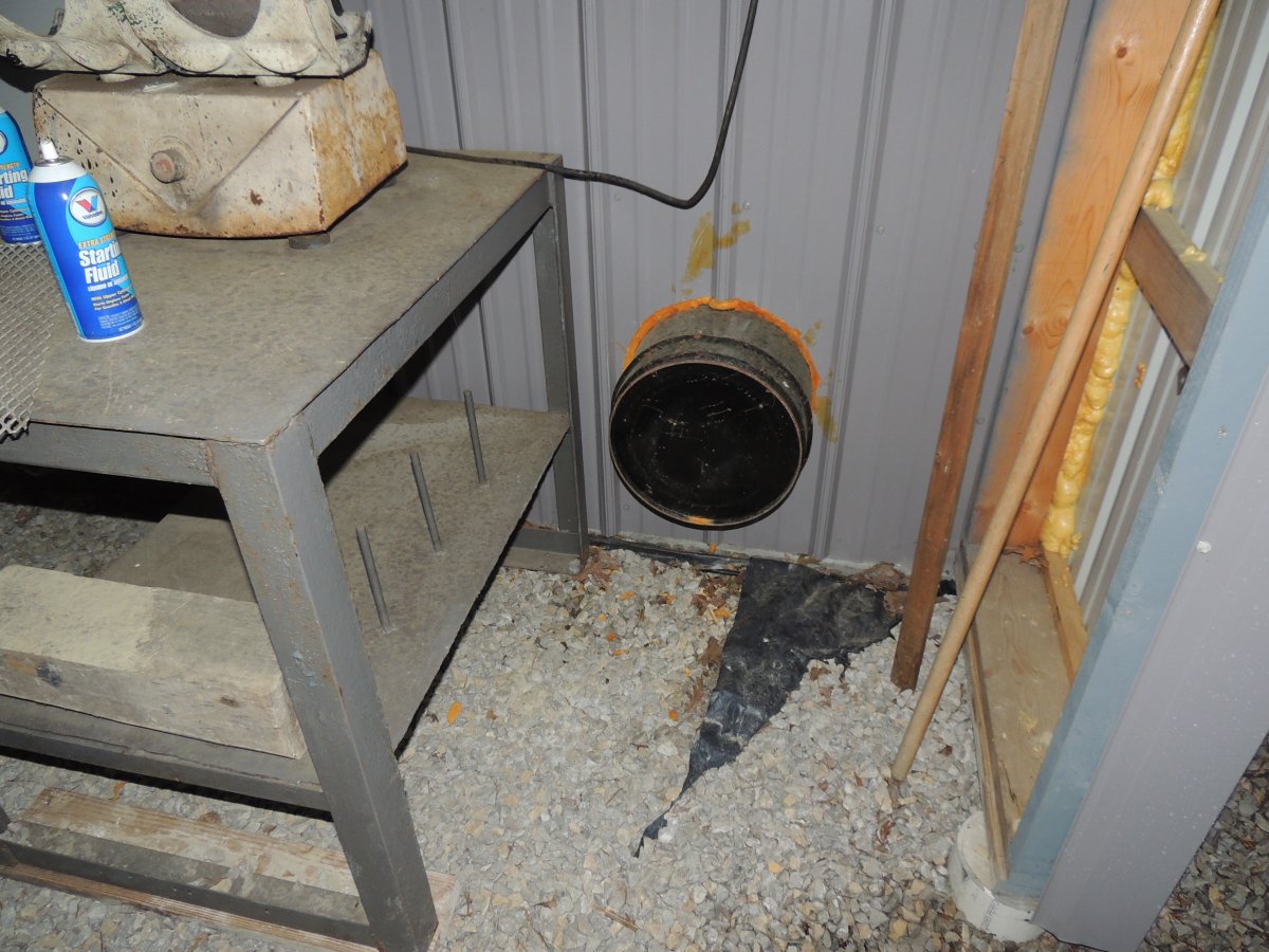

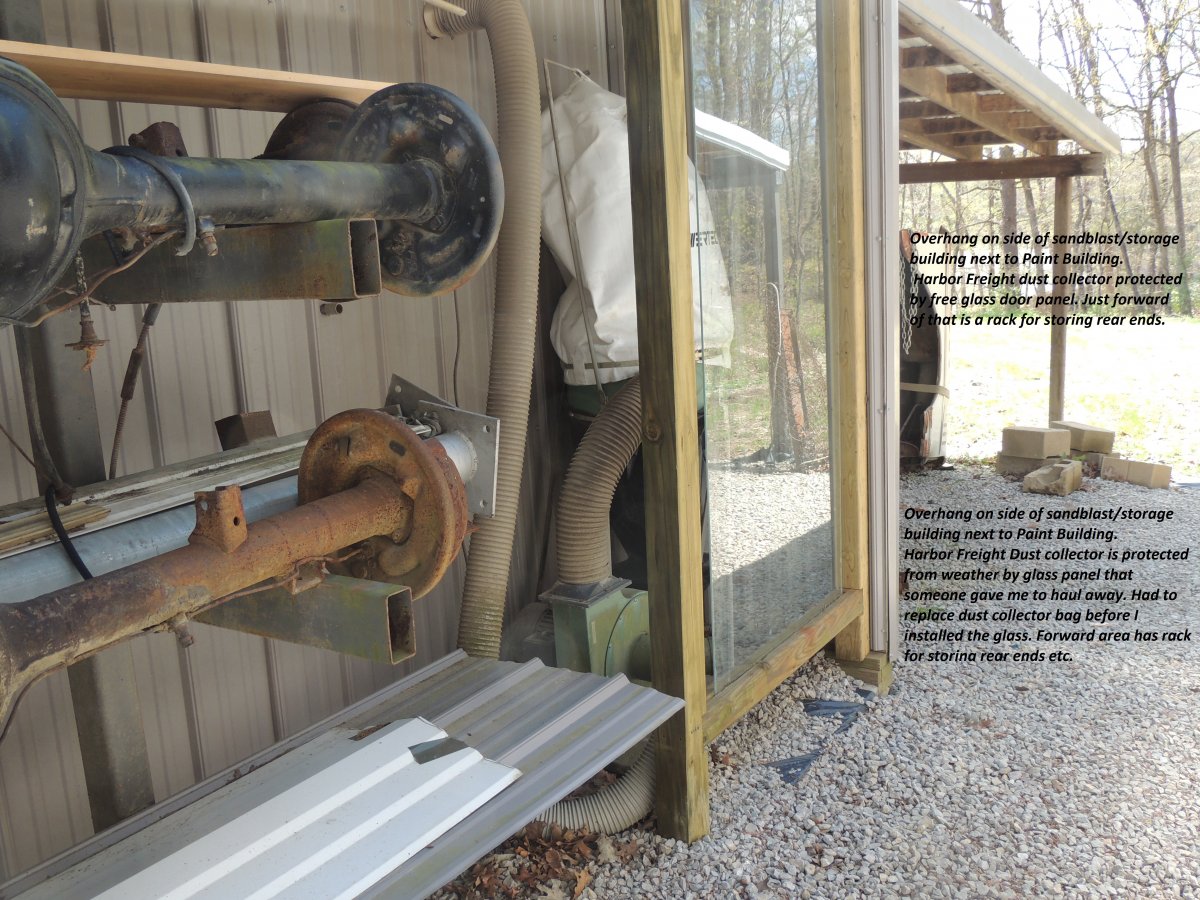

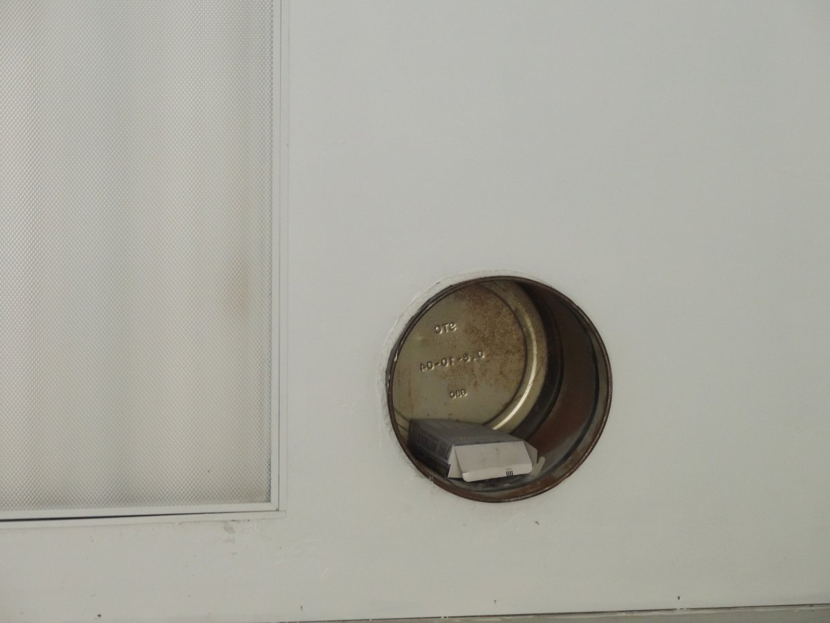

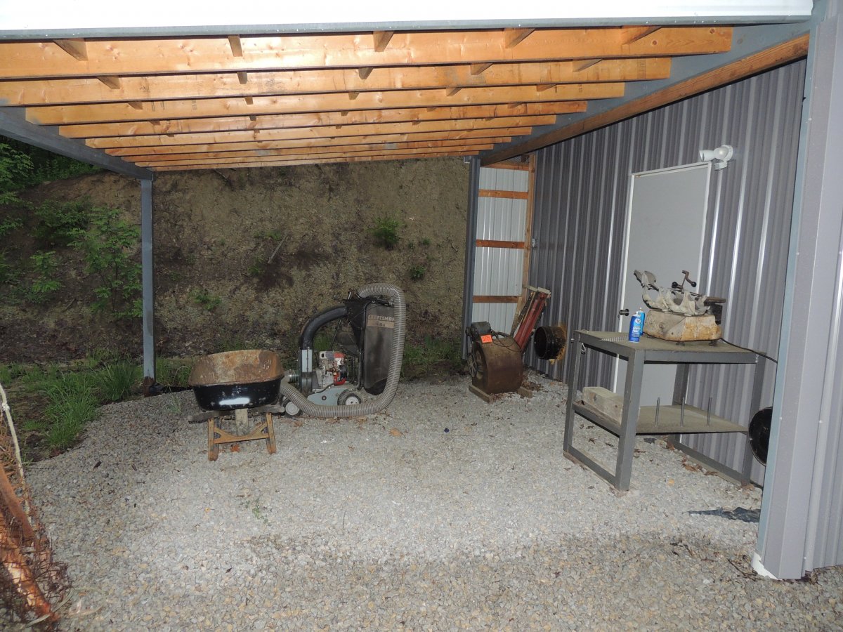

    Paint 9 Outside.JPG Sandblast 1.JPG I've seen a lot of nice ideas on here and I have some homemade and modified tools that I want to share too. I think the idea of having a shop that suits your needs is where "toolarizing" should begin. Its hard to know just what you will need, or to "see the future". The thing is, if someone thinks things thru, they can set up a shop that really works for their needs. The initial expense of a shop often forces people to cut corners, but if you watch for the things you need, and actively search for them, you can build a better shop. In my shop I have two overhead cranes. It took a lot of time and effort to build them, but next to my welder I would not trade them for any other tool I have. I use them constantly, and the enable me to do so many many things. Sometimes you can find good deals at auctions but you have to have a way to remove them. Mine were cobbled from stuff I bought at auctions and Craigs list, so it can be done...even on a piecemeal basis. A simple overhead beam will enable you to do a lot. Two overhead beams help even more. I can Pick up a truck cab and set it on a dolley by myself in a few minutes. A complete truck fram can move from floor to welding table in a few minutes. My son just bought a small farm and it has a couple of nice buildings on it. We are in the process of erecting some 6x6 H beams in one of them. I'll include the pics as its a project underway.
    Also, in his other building we are going to erect an overhead crane in there too. The building came with a concrete floor and a two post lift already in place. We are going to use the posts for the lift to support some brackets that will hold the middle of his 4" I Beams. At one end we will attach the beams to some pallet racking. Haven't decided if we
    will need to brace it or not. The other end of the I beams will have a traditional crossbeam with a post on each side bolted to the floor. Started accumulating some of the materials but haven't started building it yet. One of the cranes I have in my shop is mounted in conjunction with a two post lift but I did not use the lift as part of its support because at the time I had some other steel supports available. I actually moved that one from my attached garage to my pole
    barn one I finished erecting the pole barn.The point here is that you can have a good shop and some very useful tools if you work at it instead of dream about it. Most everything you see, including the pole barn its housed in are the result of effort, not hiring it done.You can do it if you make up your mind to do it.
    The first thing I'll show you is my almost finished Storage/Paint Booth combo. Everyone hates overspray. I decided to build a small 16x32 metal building and set it for painting too. I will only store things that are easy to roll outside, maybe even a project car. The point is that I built the building and planned ahead to use it for painting too. It has plenty of light, pretty airtight, and a compressor assembled from parts and placed in an alcove on the front of the building. I installed a filtered intake vent in the ceiling to downdraft. I used to small drums mounted at the rear of the building down near the floor and run thru the rear wall. I can place the drum lids on the exhausts when not in use to keep the building sealed. Outside on the back of the building I put a leanto. I have a paint shaker sitting on a table out there. I will take two squirrel cage blowers and adapt them to the outside of the drums to pull exhaust air out. I'm using ones where the air flows thru the blower without passing around the electric motor. Hope that prevents any explosions..... Paint 5 Outside.JPG Paint 6 Compressor.JPG Paint 7 Separator.JPG Paint 1.JPG DSCN0905.JPG DSCN0841.JPG DSCN0906.JPG Paint 3 Outside intake.JPG Paint 2 Vent.JPG

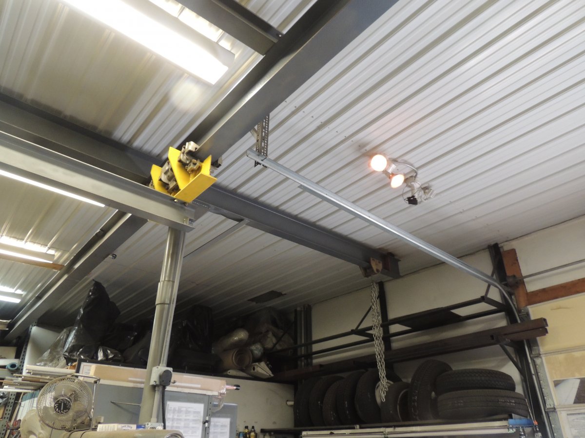

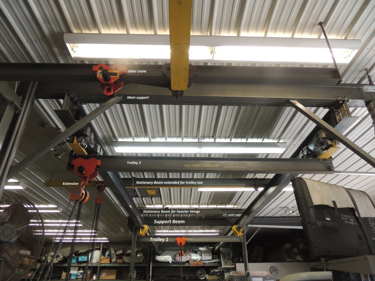

    Now I'll show you the overhead cranes. They are the handiest things for a shop. Even one simple straight beam can do a lot for a shop. The first cranes are in my pole barn. Crane 1.JPG DSCN0817.JPG
