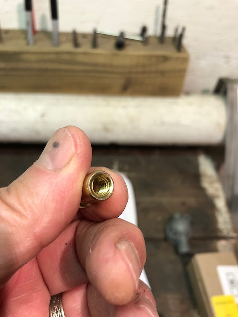

    This is a rivet nut.
    It is essentially a pop rivet that is threaded inside 1/4-20. It is used to place a nut into thin material that you can't get at from behind, among other uses. Very handy item. This particular rivet nut requires a 3/8" hole to mount it. However, rivet nut setting tools are VERY expensive. So I modified an extra pop rivet tool I had laying around to put a long 1/4-20 bolt through the business end and made a cheap and effective rivet nut setting tool. Below see tool and how I used it to repair the A-pillar on my "A" where the visor mounts. The original flange nuts (or whatever you call them) that were spot welded inside the A-pillar were no longer there. Now, we have a new attachment point for the visor. I also used rivet nuts for the sub frame rails to attach floor boards to where the original D-nuts were rotted, frozen or missing.

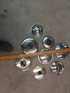

    Made my own shrinking disc. Worked okay but I bought a real one and it worked a little better. I hit the local flea markets and bought a bunch of pot lids. Them I drilled one that seemed about right. It worked well enough that I ordered one and finished the job. lidoptions10.jpg winnerpotlid10.jpg

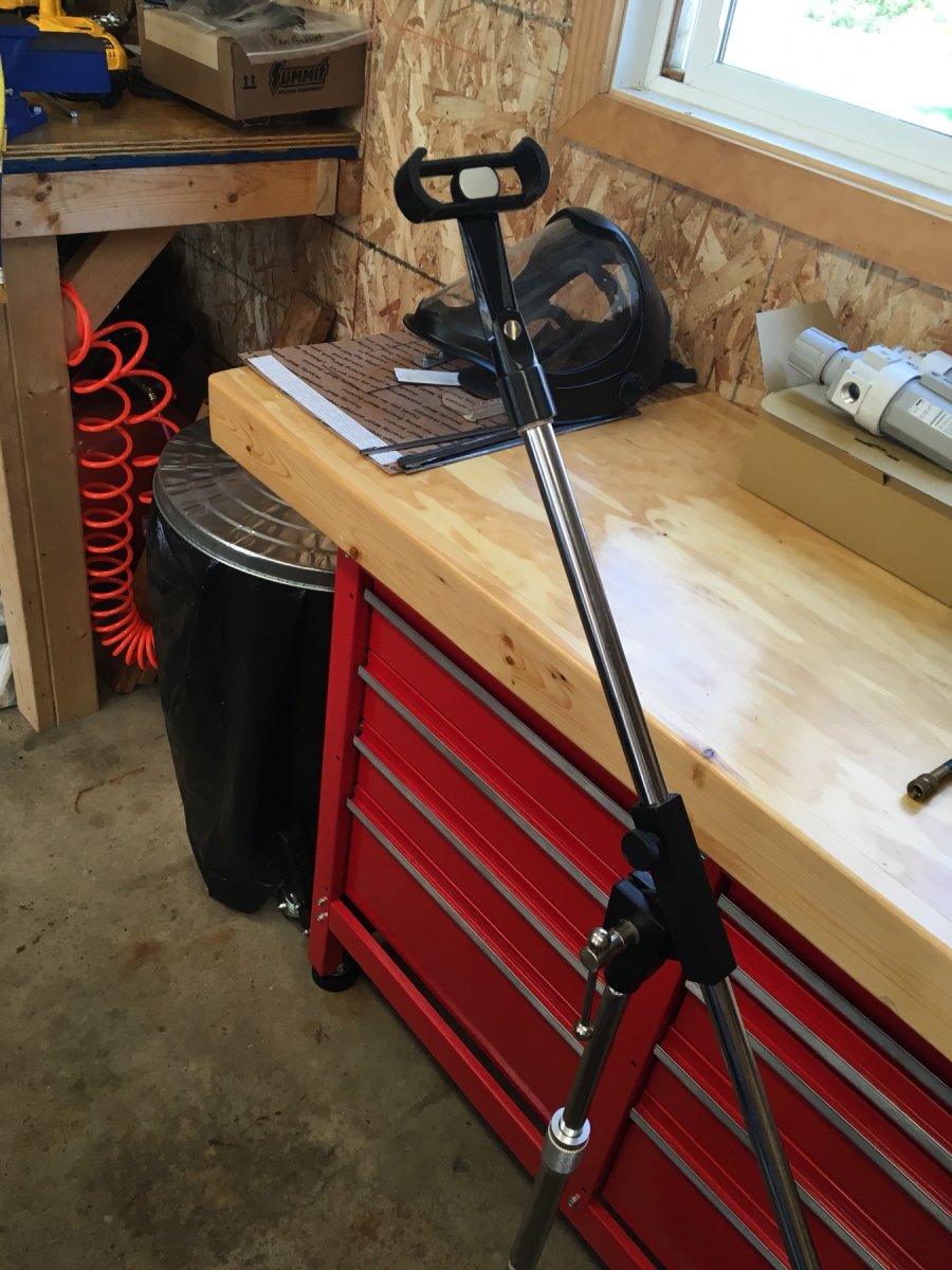

    A friend moved out of town and gifted me a couple of microphone stands.
    I work mostly alone, so I’m often looking for ways to extend what I can see or do. Being able to see something that is otherwise out of sight is helpful. I found a cheap cel phone holder on the sale rack at Menards, and adapted it to the mic stand.
    This opens up two options. First, record video and look at later. Recently used that to diagnose a non starting problem on my DD. I put a spark tester in line with plug #1, but couldn’t see it while turning the key to crank the engine. The video showed what I needed to see - only randomly firing spark. New coil, truck starts fine again.
    The other is remote view, using the phone with Face Time to my iPad. Useful for things like one man brake bleeding. I have a check valve bleeder, but it helps to be able to see the fluid coming out, which is hard to do while in the car pumping the brake pedal.

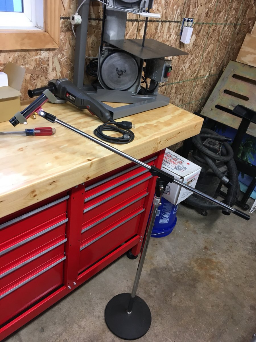

    Here’s another attachment. I need more welding practice, and had some scrap and an idea. I don’t have somebody I can hand a flashlight to and say “hold this, point it there”. So:
    A piece of 1/8” x 1/2” left over from something else as the base. A chunk of thicker steel bar I found in the street one day was cut, drilled, and ground slightly thinner to fit the mic stand, then welded to the base. I threaded a couple pieces of 1/4” rod, then drilled the base and welded them in. Some “beer seal” foam, a couple pieces of Velcro, and acorn nuts complete it.
    Still need more welding practice, but I’m getting better.

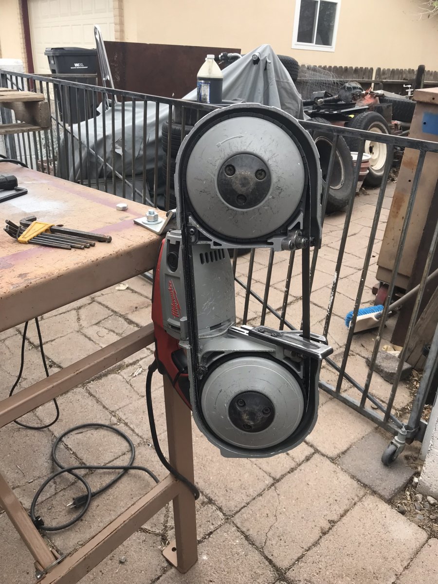

    Did you fabricate that base for your porta-band? I've been tossing around putting one of those together as right now I have mine bolted to the side of a table....lol

    Yes, I built that last year. First project after getting the welder. Works really well. Got a cheap PortaBand from Craigslist, rebuilt it, got a new band, then used it to cut the tubing for the stand.

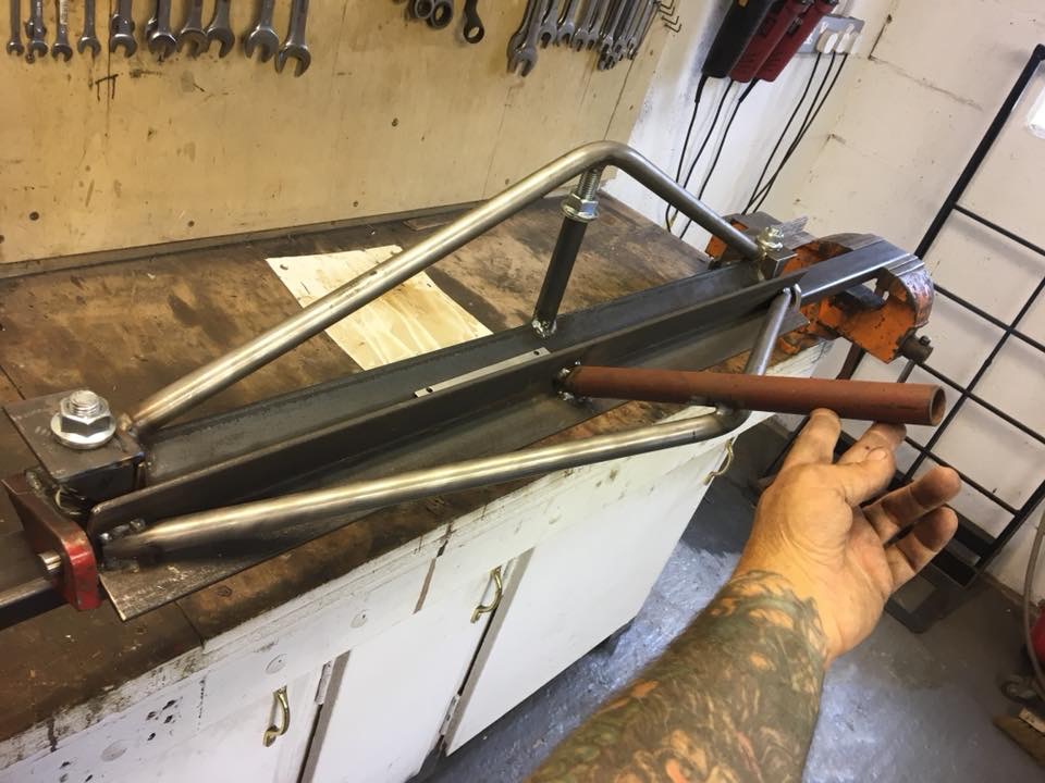

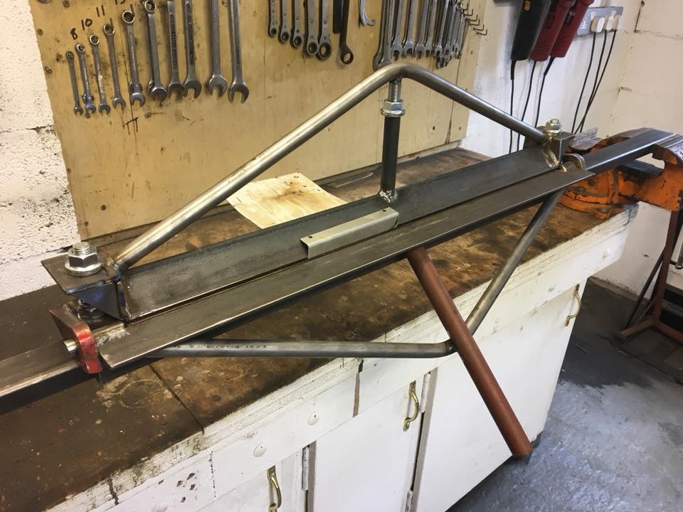

    Built myself a small sheet metal bender, out of odds and ends laying around the shop. Bends 16 gauge steel okay, radius is a bit big but that is caused by the raw and round edge on the angle bar top clamp, needs cleaning up to give a sharper corner I think.

    Is that held up with a vise on either end? That sure beats trying to hold the bender to the benchtop with a pair of "C" clamps like I have been!

    Morris man, a neat trick is to place old valve springs around the threaded rods at each end. When you back off the hold down nuts, the valve springs lift the top plate so you can get the metal back out with killing your back trying to lift it one handed.

    Yes, I toyed with ideas how to fasten to the bench, make a stand etc, then this idea popped into my head. It is welded to a length of spare 1 x 2 tube. :cool:
    There are indeed some small springs in there, but a bit short, so packed up with washers. It does make it easier to use.

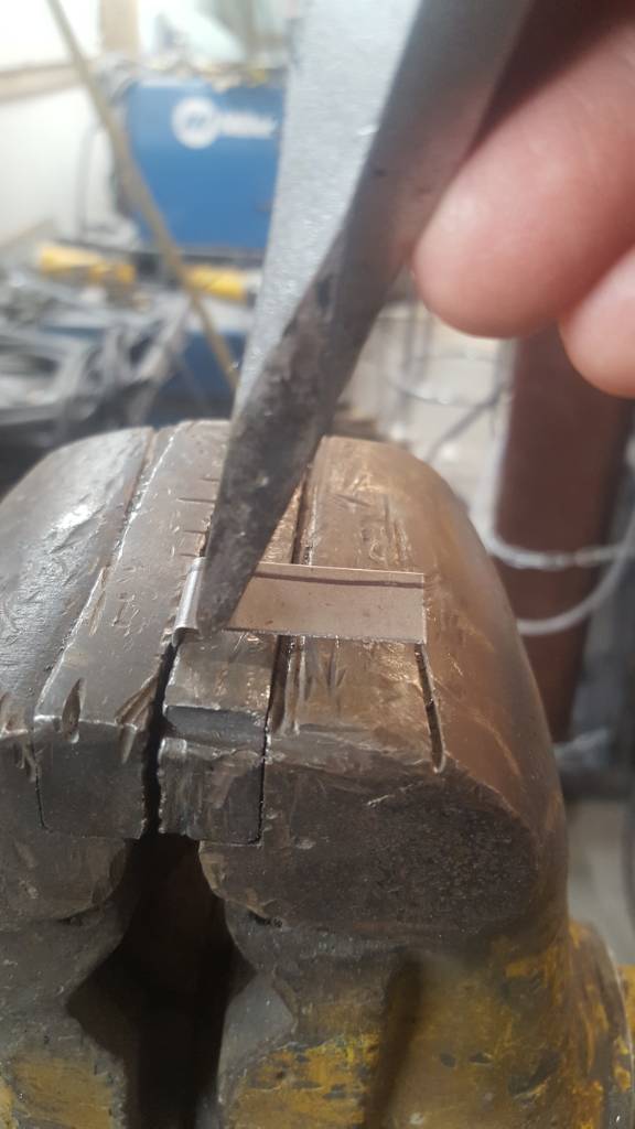

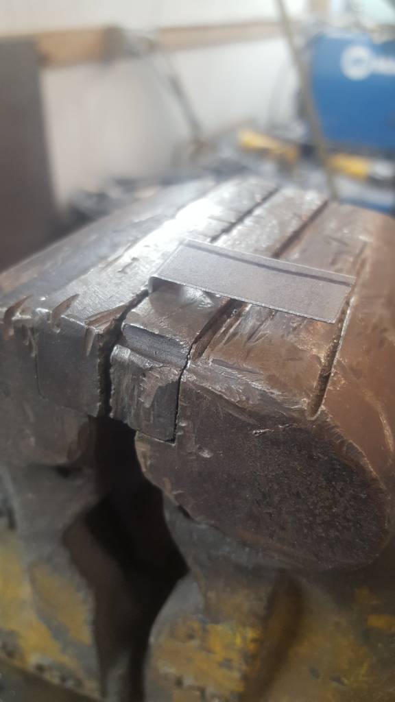

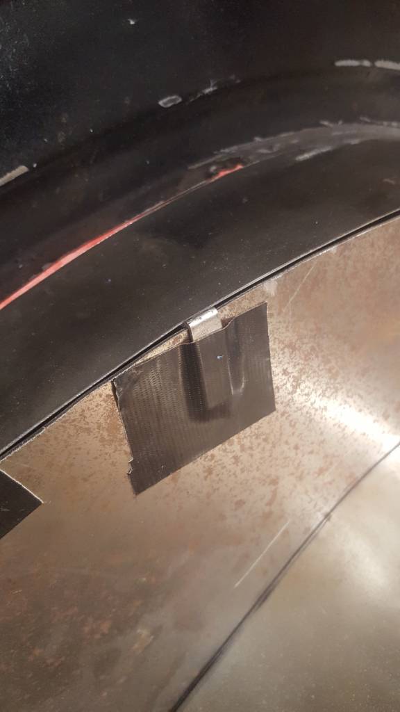

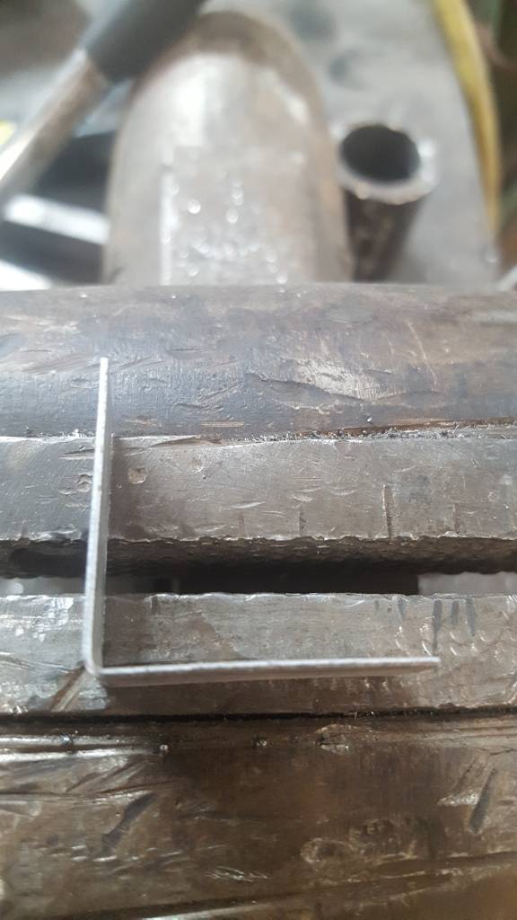

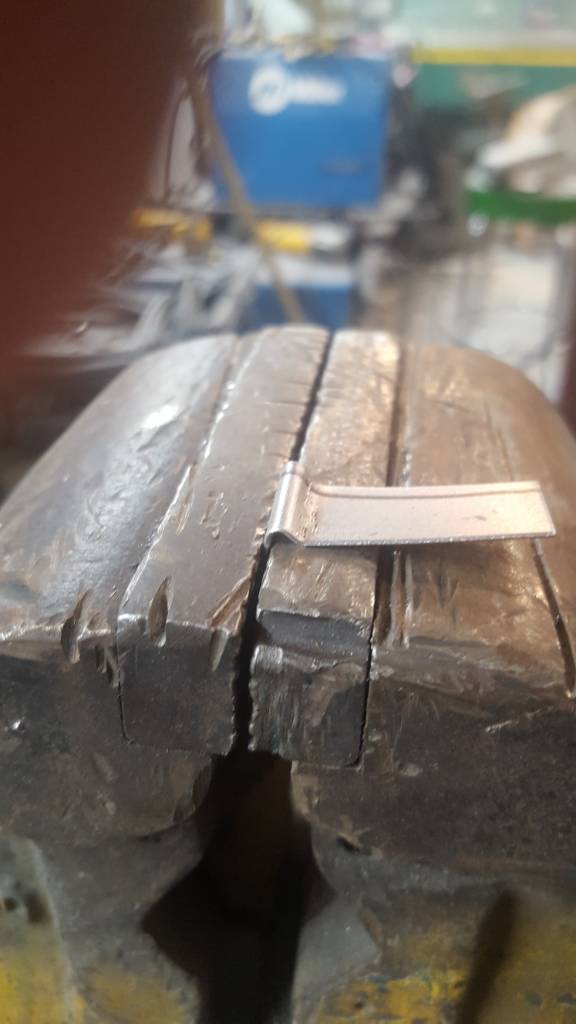

    Was asked to share this over here. Needed something to help support a 90 degree butt joint. Came up with this. 20180918_073212.jpeg 20180918_073242.jpeg 20180918_073253.jpeg 20180918_073318.jpeg 20180918_073436.jpeg

    That vise, while it has many years of good life left in it, has been rode hard and put away wet MANY times in its past.
    Oh, yeah, good job on temporary support of the 90* butt weld.
    saltflats likes this.
