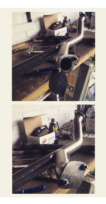

  2. Is this what you are looking to do?
    This would not be to trick.

    Yep that's the sort of thing, it's just 1 3/4" pipe

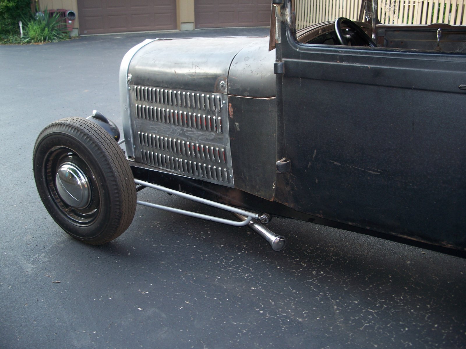

    1929 retake 008.JPG Here some I made for the coupe.. A gas fill bung and gas cap.. Easy off and on.. Been on 4 years now... Click the pic for larger image...

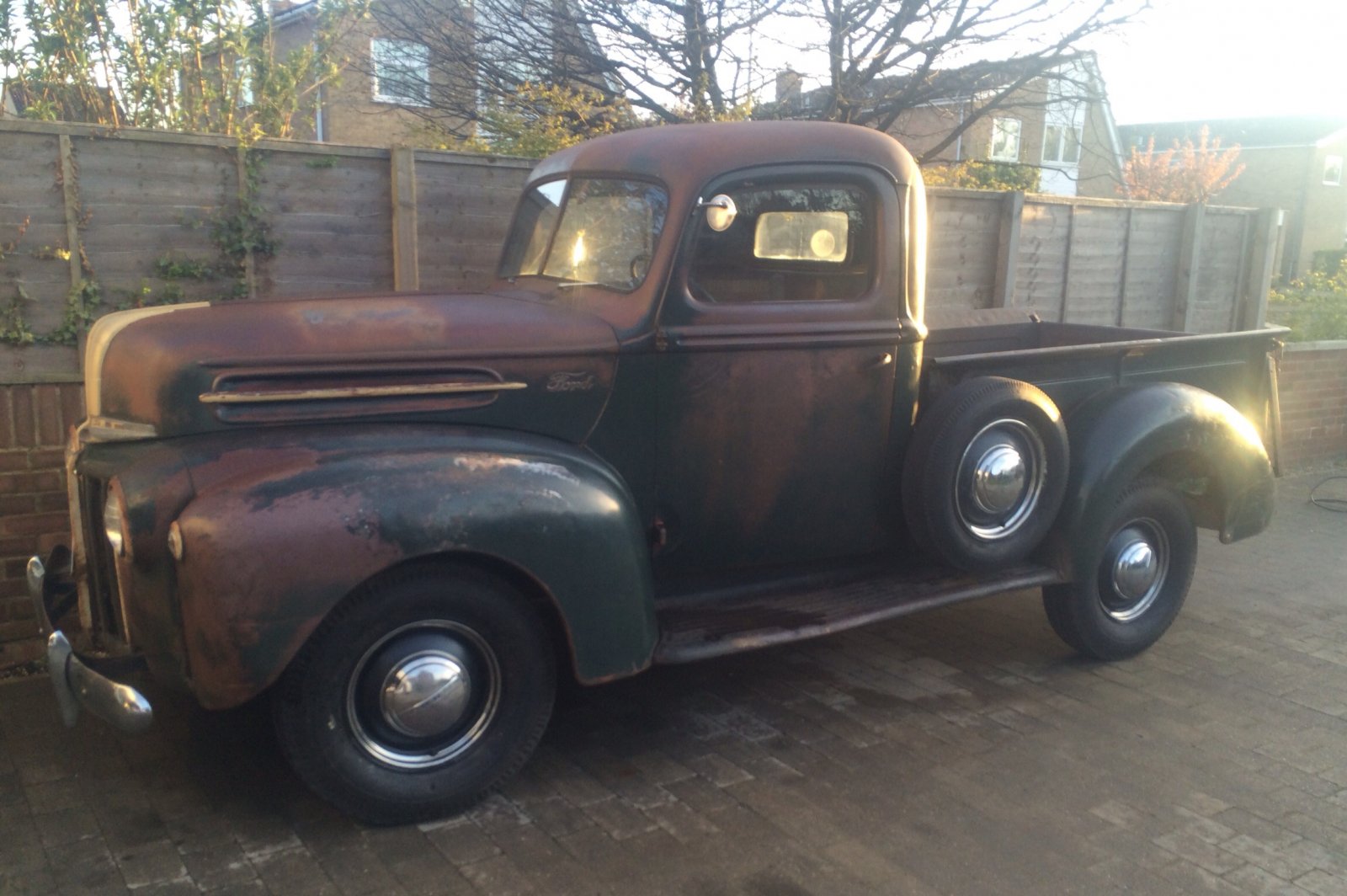

    Better keep my head down then as my truck is a bit ratty to look at!
  15. NashRodMan
    Joined: Jul 8, 2004
    Posts: 1,577
    NashRodMan
    No it doesn't. That's a perfect survivor look and great patina! RR is when people do things that can be unsafe or just to get attention like spider webs on the grill and stuff like that.

    I'm keeping that look, might have some lettering on the doors for my electrical business. Am lowering it all round, brakes and suspension all standard but reconditioned, has nice period recovered seat. Just fancy a nice old school dual system.

  17. Nothing at all wrong with that truck.

    So how do the tax laws in the UK work. Can you write off the cost of the truck as advertising for your business? So many of the door lettered trucks are fake for "the look", it will be nice to see a lettered up truck for an actual business.
    Good looking truck, well used, well preserved.

  25. Yep, they only ran gate valves for cut-outs on rat rods like this one in the late 40's...
    Jivin' Jer's recreation of Jesse Lopez' rat rod...
