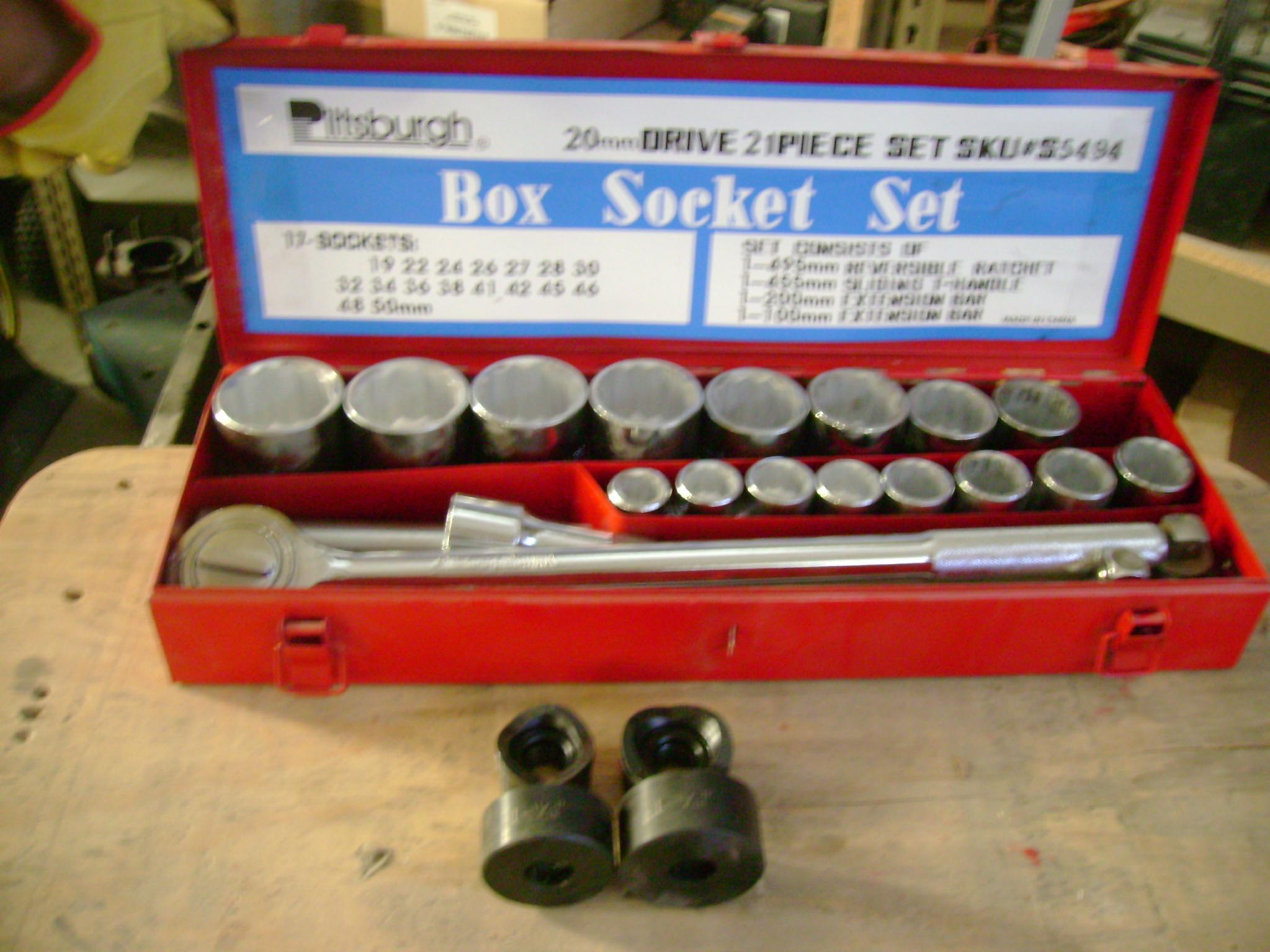

    I used a large 3/4-inch-drive socket from a set I got from Harbor Freight as the male die. Here's the HF 3/4" socket set. $60 on sale, but $48 with the 20% off coupon found in the newspaper and car magazines.
    I used the female die from a set of metal knockout hole punches used by electricians. I had both the hydraulic set ($80 on sale from Harbor Freight) as well at the manual set, pictured in a post, below. The hydraulic set is quick and easy if you want to do a lot of them, but a manual punch is fine for just a few.

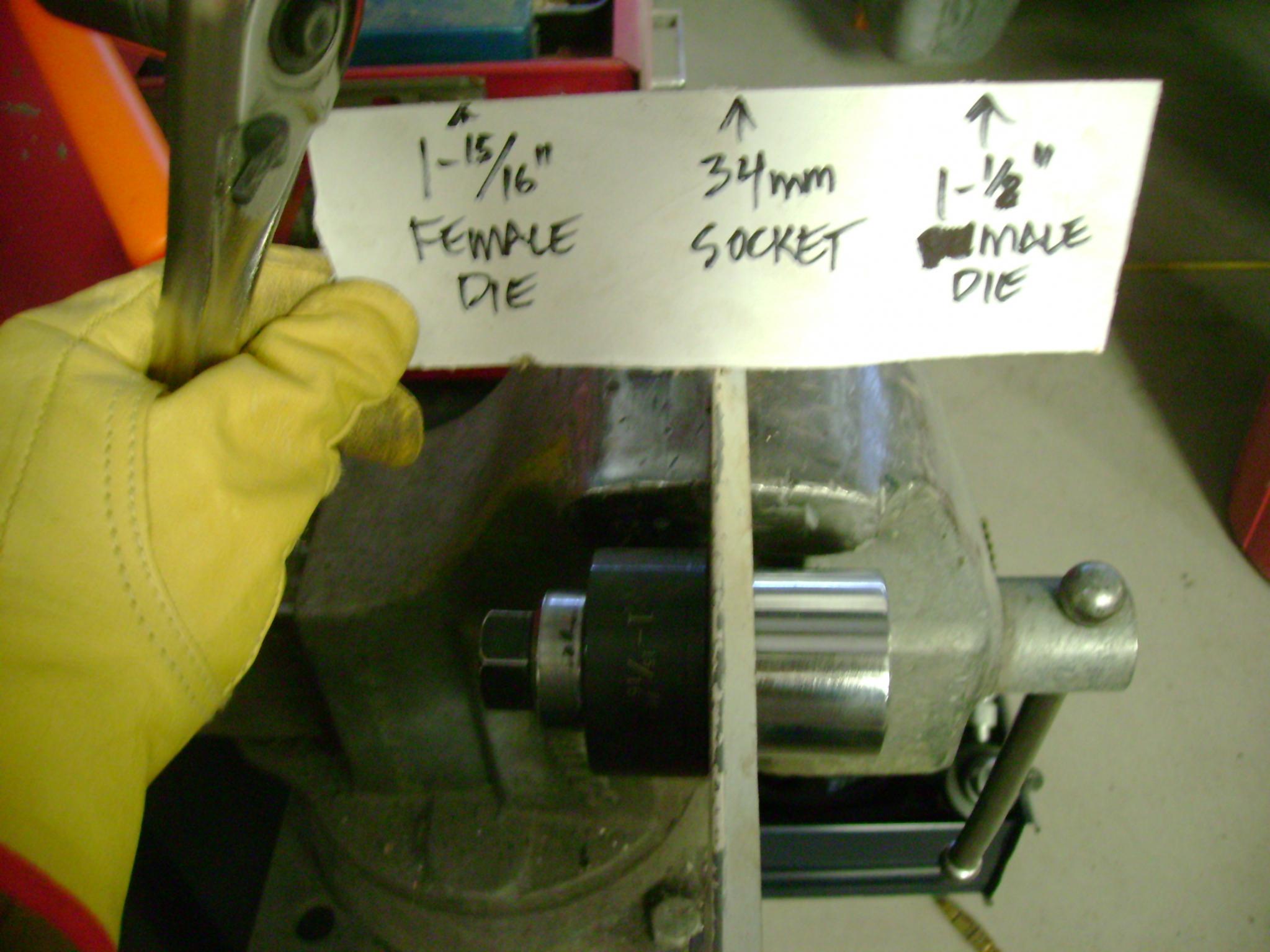

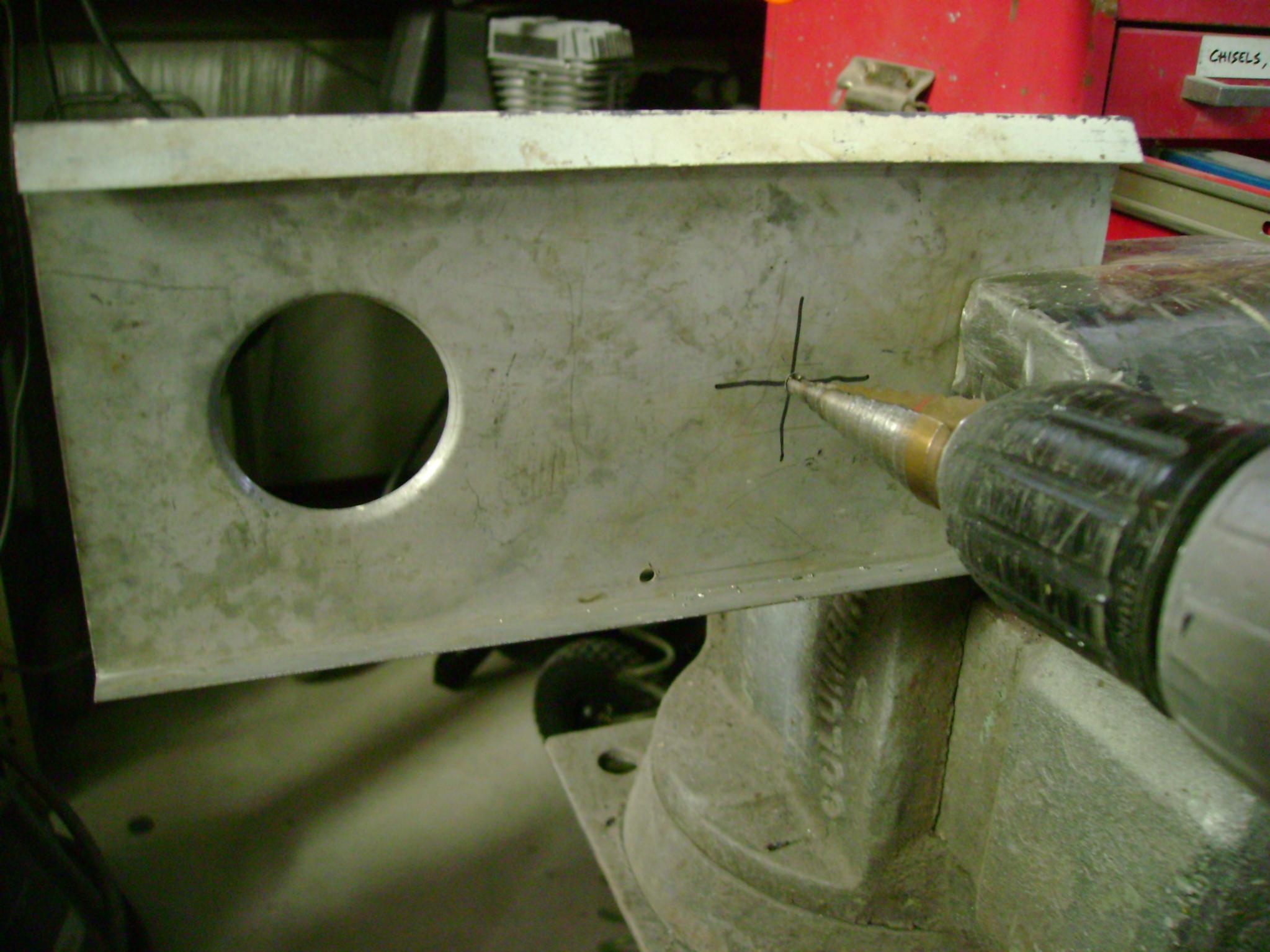

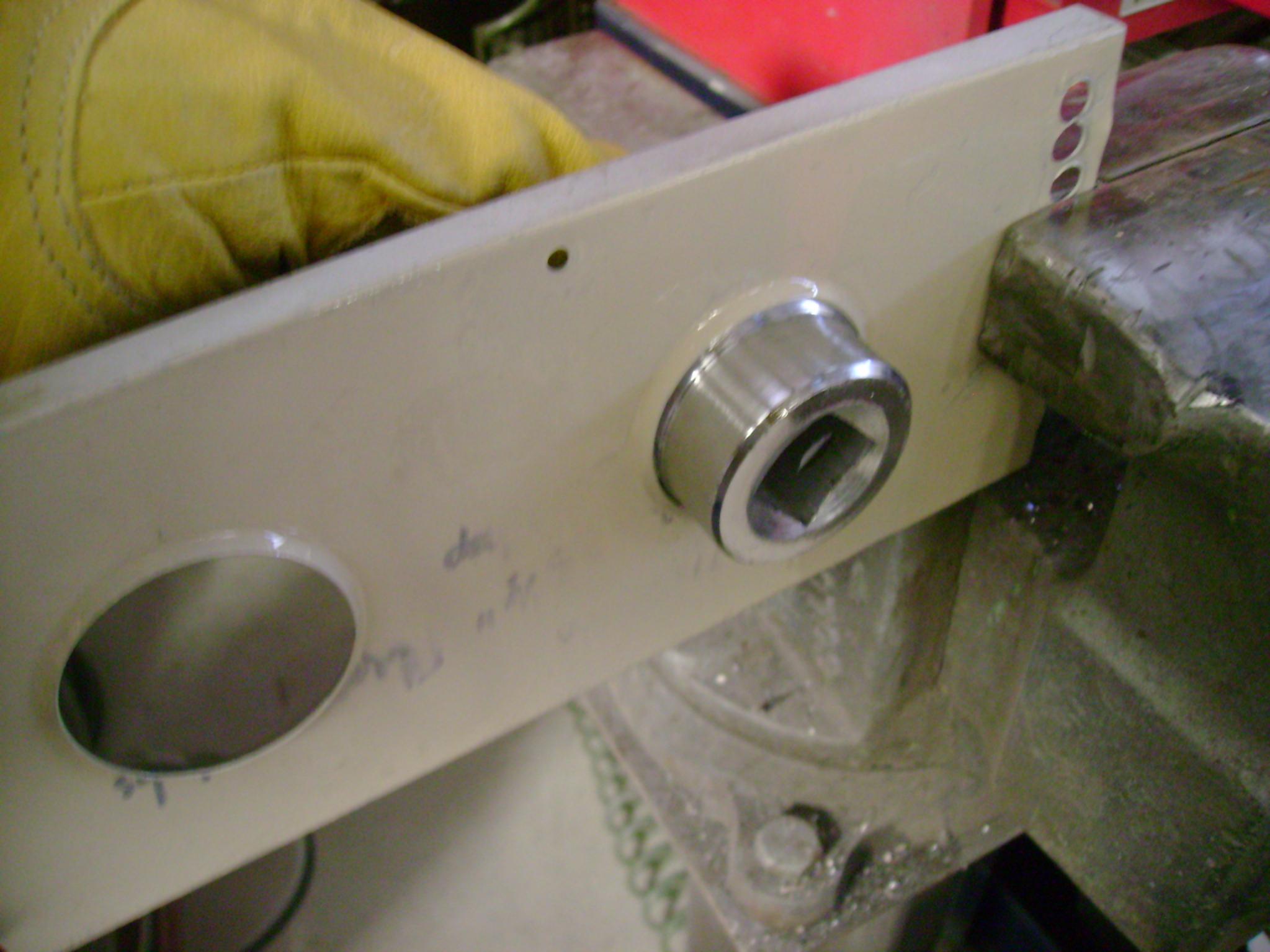

    Here is the method I used to do easy dimples in sheet metal. The hole to the left in the second picture is the first test hole that I made just to make sure it worked.

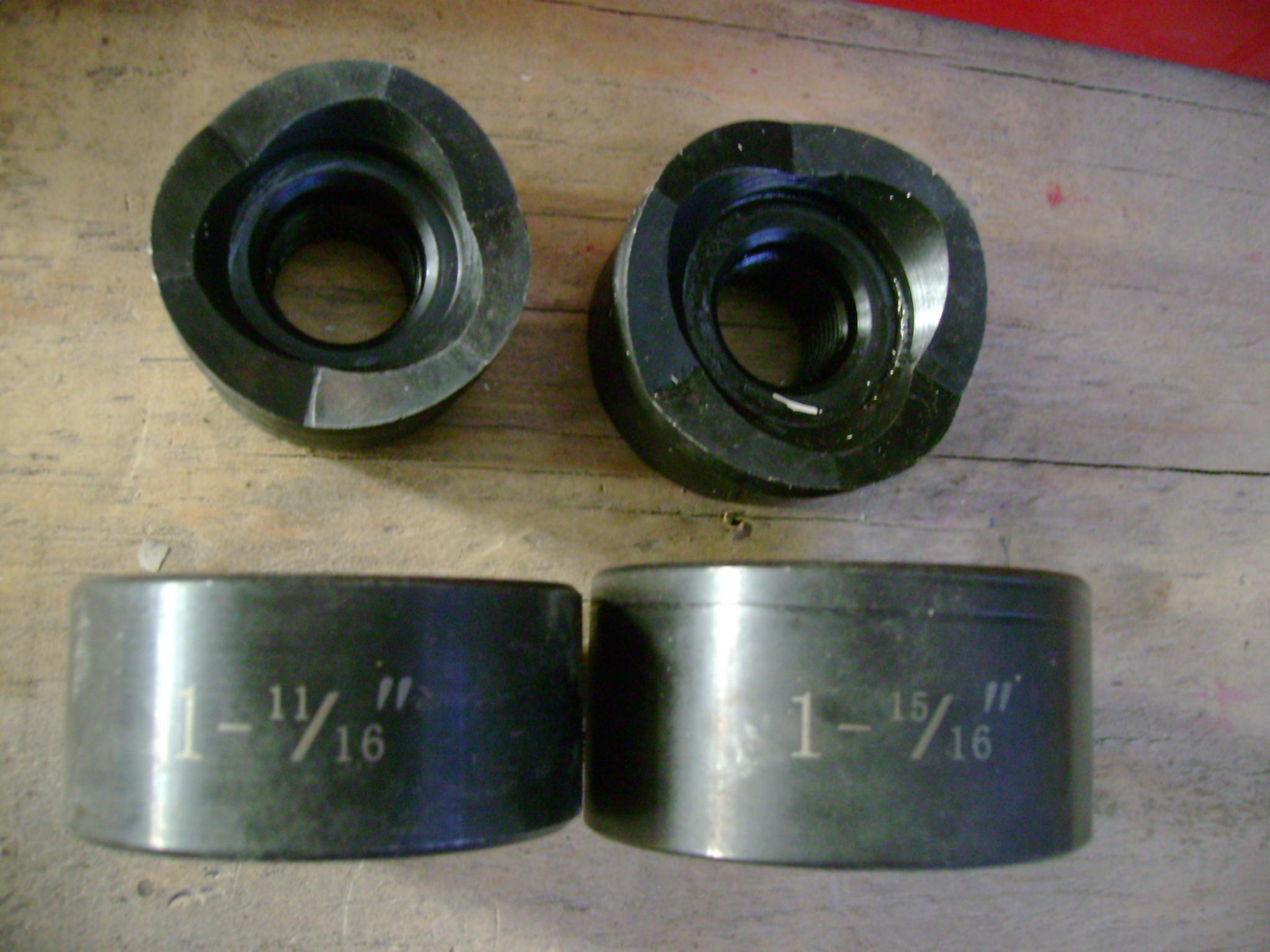

    Here is the size of the punches I used. The small die is for cutting the hole, and the larger die is for the dimple. I used a step drill for the bolt or shank that holds the male and female dies. To punch a hole, if you are not familiar with these punches, go by the directions in the set you have.

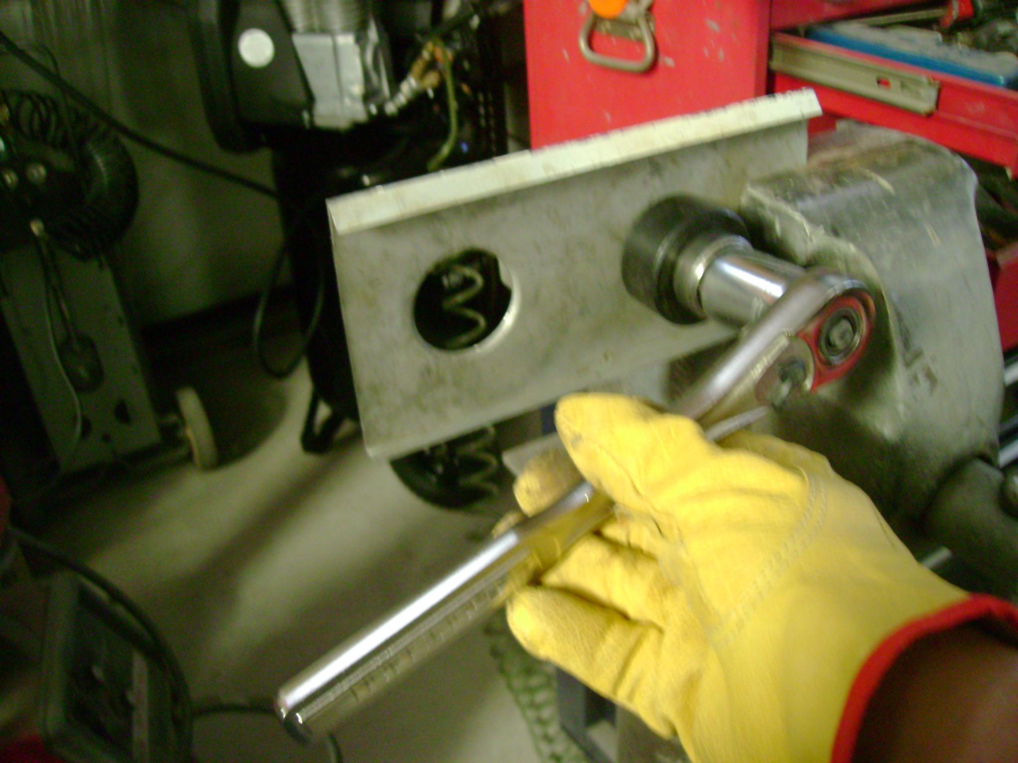

    I inserted the bolt through the hole in the sheet metal and assembled the two dies, one on each side. Then I cranked down the bolt until the hole was punched.

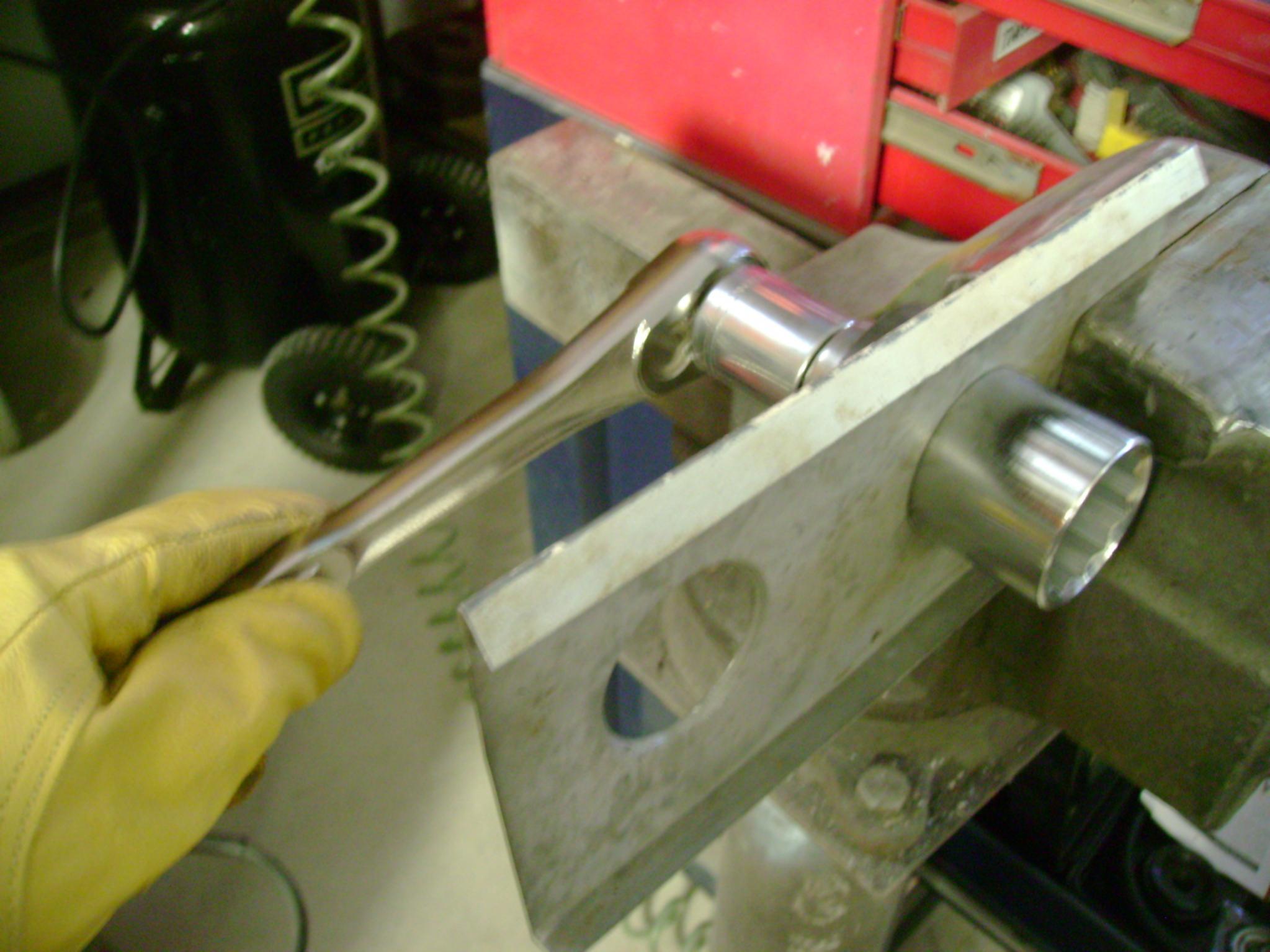

    Here you can see the manner in which I assembled the punch die set to make the dimple. I used a large socket as the male die.
    For the dimple, I used the a slightly larger female die than the die that I used to cut the hole and I used a socket with a shoulder that just fit inside the larger female die, but too large to fit through the hole in the sheet metal.
    To hold the assembly together, I used a small male die that fit into the large socket since it is threaded and fit the threads in the punch shank. You can't see the small male die because it is inside of the socket, threaded on the bolt/shank.
    The last picture shows how the socket's angled shoulder fit the dimple.
    For other sized holes, there are several more combinations of dies and sockets that will work. All you have to do is experiment.
    Hope this helps someone. Thanks to all who post their ideas for all of the great inspiration that you have given me.

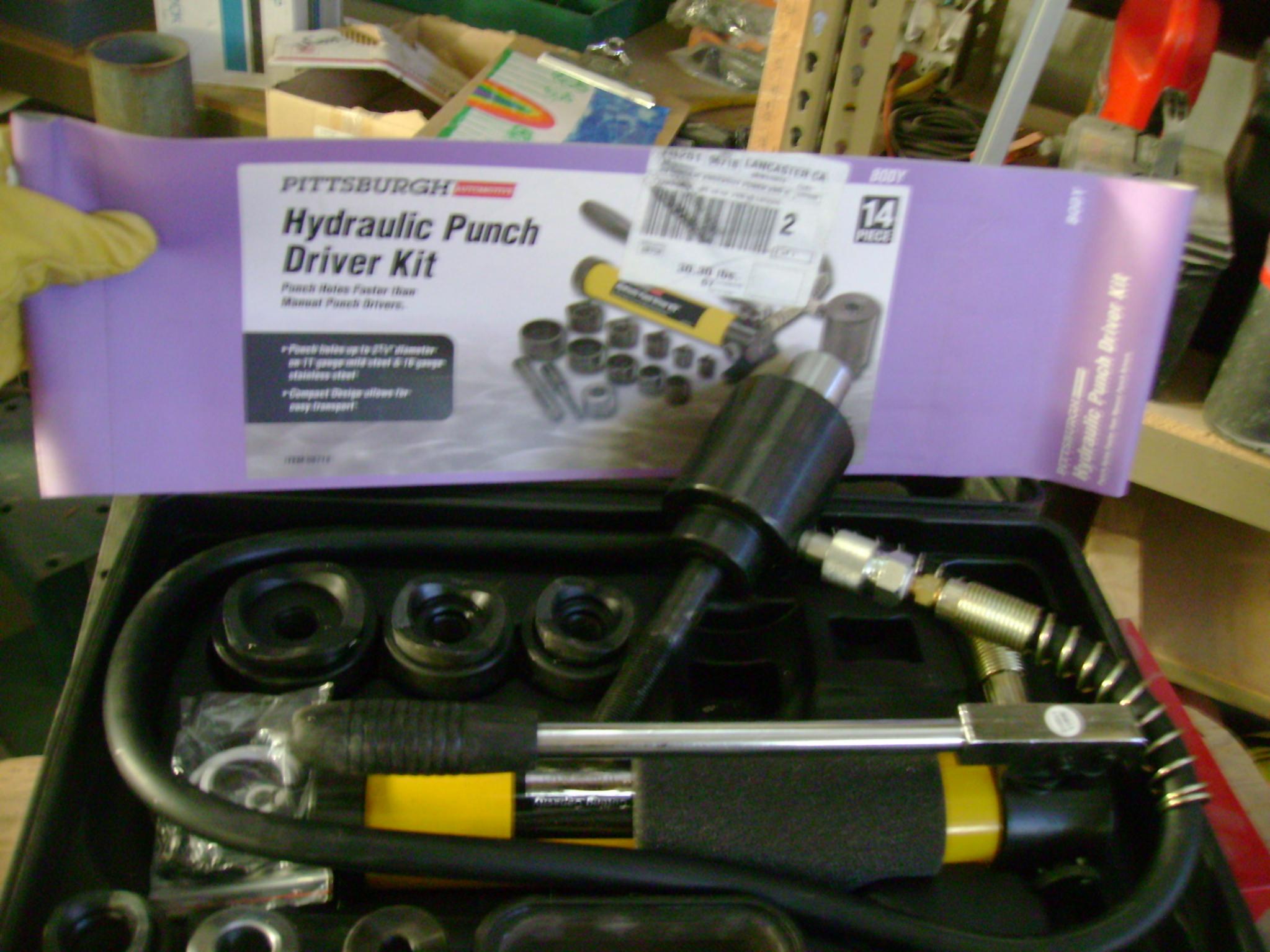

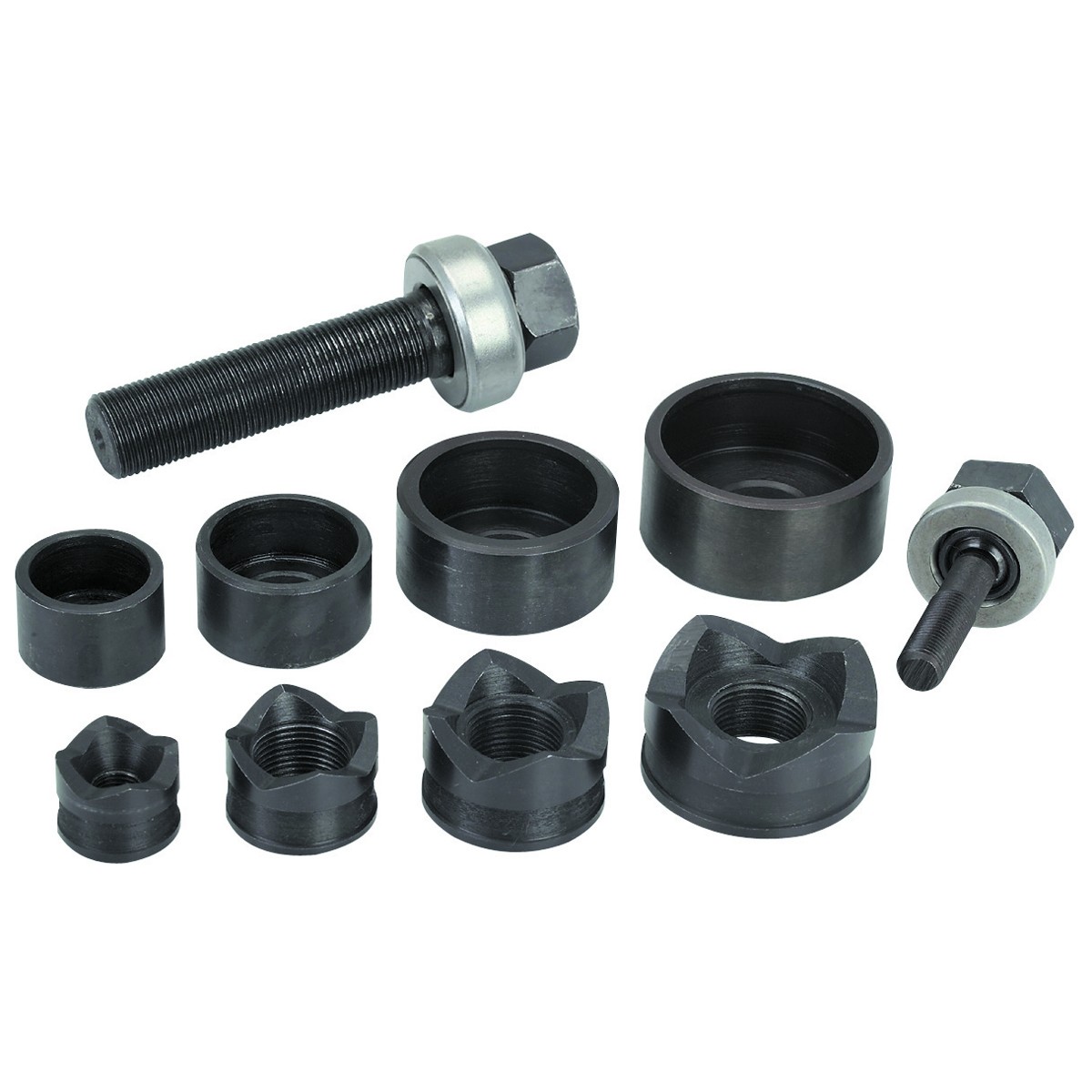

    Here is a picture of the Harbor Freight knockout punches. $25 on sale, but less with a coupon.
