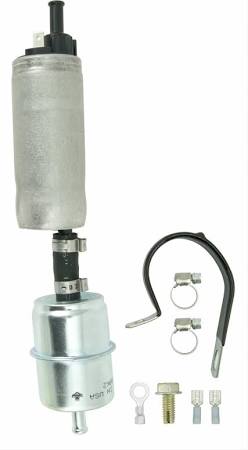

    I run a Carter P6054 Electric Pump on my 455 Olds with two Carter 500's and have no problems. The pump is very quiet and so far going on three years and over 12,000 miles no problems. Have no pressure regulator or gauge. Joe shopping.jpg
