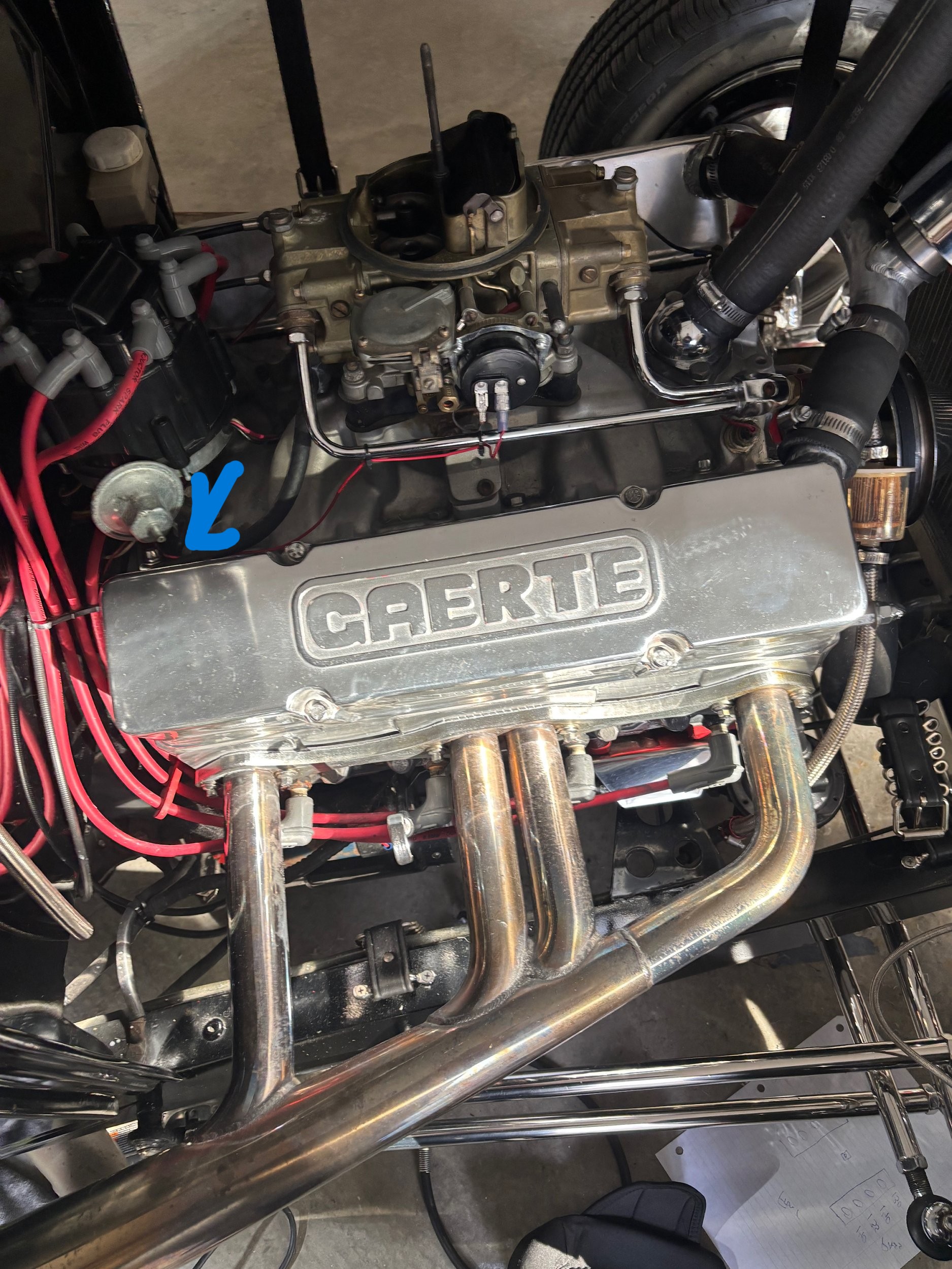

    So I'm just digging into the car I purchased last yr wich is a 32 roadster don't know much about the engine at all person I bought it from has no idea anything about it wheel and deal type thing trades but anyways my ? Is I have a Holley carb on it now wich I've been told need to be rebuilt and was told to maybe switch to edelbrock for how much I drive the car and less up keep what's everyone thoughts I believe it's a 750 Holley now can anyone confirm I'm gonna attach a pick of the numbers I have found wish I knew more on the engine but I don't and I'm a newbie at this so learning as I go IMG_6796.jpeg

    alumslot
    3310 is a 780 cfm should be a good carb for the street and cruising around. Why would you think it need to be rebuilt if the car runs ok.

    So for the engine I'm not sure of what has been done same with the engine all I know is I was told that carb had to be rebuilt or to get a edelbrock do to set and forget less messing with it honestly I thought it had a 600 cfm on it but now but what you guys have said it is a 780 to me seems like I should be getting better throttle response and better power than what I have been in the look for somone that is good in upstate ny meaning Saratoga area I have only pics to go by right now withought taking apart to find out exactly what I have and even then would need some help I know it has a turbo 350 trans with Brodix heads not sure if valve covers where just thrown on or if it more than that IMG_6802.jpeg IMG_6801.jpeg IMG_6800.jpeg

    Runs rough in my opinion a little and just seems off also that is what I was told when I did bring it to someone to give it a Quick Look over when I first got it
  12. Given that it has Brodix heads, my guess is that the rest of the engine is probably setup for some higher horsepower and hence the pretty-big carb. I have an 830 Holley on my 383 SBC - makes 520 HP with a hydraulic roller cam.
    It probably idles rough because it has a performance cam in it. If somebody is putting those types of heads on a SBC, I'm sure they also put money into a high-performance cam.
    What you really need to do is take it to somebody who really knows performance SBC engines - and not just think a magical "new carb" is going to do something for you. There may be nothing wrong with your setup . . . no way to tell. If it was mine, I'd try to find a performance shop that knows carbs and has a chassis dyno to do some real tuning with it. My guess is that you have a few $$$ in the car - might as well get it to run as it can.
    How well does it run when you take it on the road?

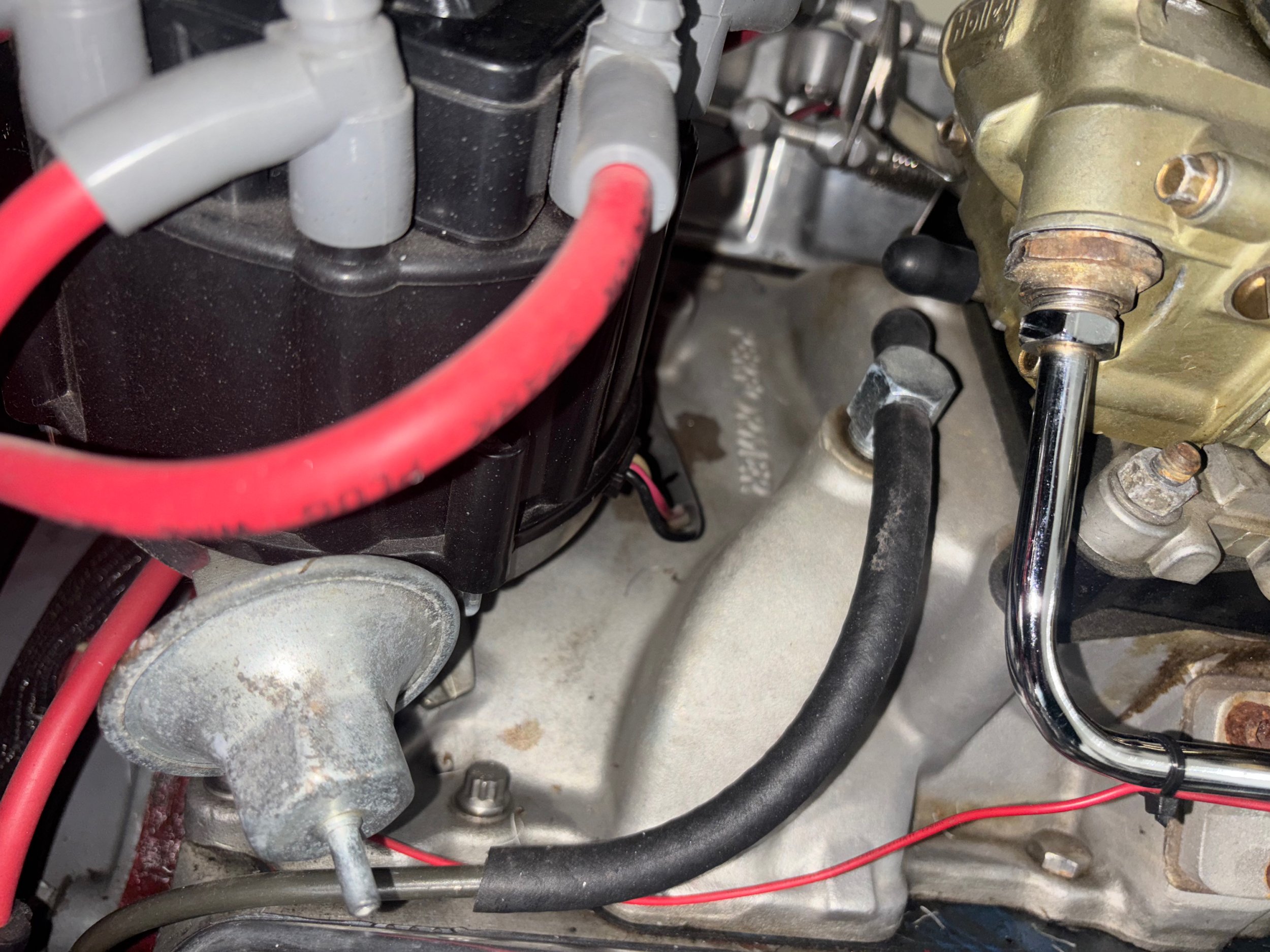

  13. Also, it looks like the vacuum line is disconnected from the distributor - is it just lying there and sucking air or plugged off or what? Normally you would want vacuum advance (assuming the timing is setup correctly).

    Ya it is not connected I don't see anything laying anywhere that's my thoughts I gotta find somewhere local that does that kind of stuff near me

    what is this vac hose laying there? it should probably be going to the vac advance. it looks like it came from strait manifold vacuum. that will make it hesitate and run rough unhooked like that vacadv.jpeg

    what about the unhooked vac hose?
    Deuces and Sharpone like this.
  23. Nicholas minor
    Joined: Feb 25, 2025
    Posts: 15
    Nicholas minor
    the hose that is hooked up goes down to the transmission looks like the other ports are blocked off

    With the car running, spray some carb cleaner around the base of the carb. Might be a vacuum leak caused by a spreadbore intake manifold and squarebore carb mismatch.

    Clean up ( bowls jets carb cleaner etc) on Holley is pretty simple. Lot of tune up issues could be leading to running rough.
    Timing and vacuum advance not hooked up would be good places to start.

    So guys, tell him which port he should hook an advance vacuum hose up to. This might be a $3 fix.

    It depends on if he needs ported vacuum or manifold vacuum. If he wants ported vacuum then hook it to the plugged fitting on the side of the carb just ahead of the choke assy. Or if he wants manifold vacuum there should be a fitting coming out of the base plate at the front closer to the passenger side that is coming out at an angle. he can try it both ways to see what works better. couldn't hurt to check the ign timing also

    that is why I said he should try both to see what works better on his car. it is literally 1 minutes worth of work to try it
