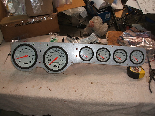

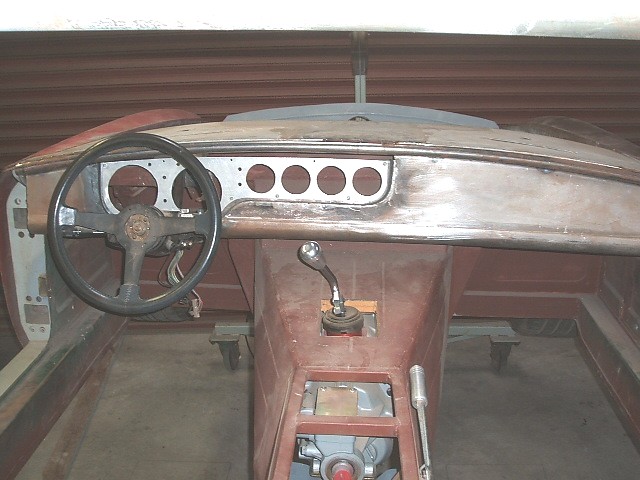

    Joined: Oct 31, 2008
    Posts: 178
    Jim Stabe
    I have 2 5/8" (2 5/8" hole) and 5" (4 5/8" hole) Autometer gauges. I layed it out using cardboard cutouts of the faces taped to the panel until I had everything where I wanted it then centerpunched the centerpoints through the cardboard through the compass point hole and marked the O.D. with a Sharpie. I had a 2 1/2" hole saw that I cut out all the locations including the large ones. I filed the small ones to fit and used a saber saw to cut out the large ones then finished with a file. Perfect fit for all the gauges and it took less than an hour.

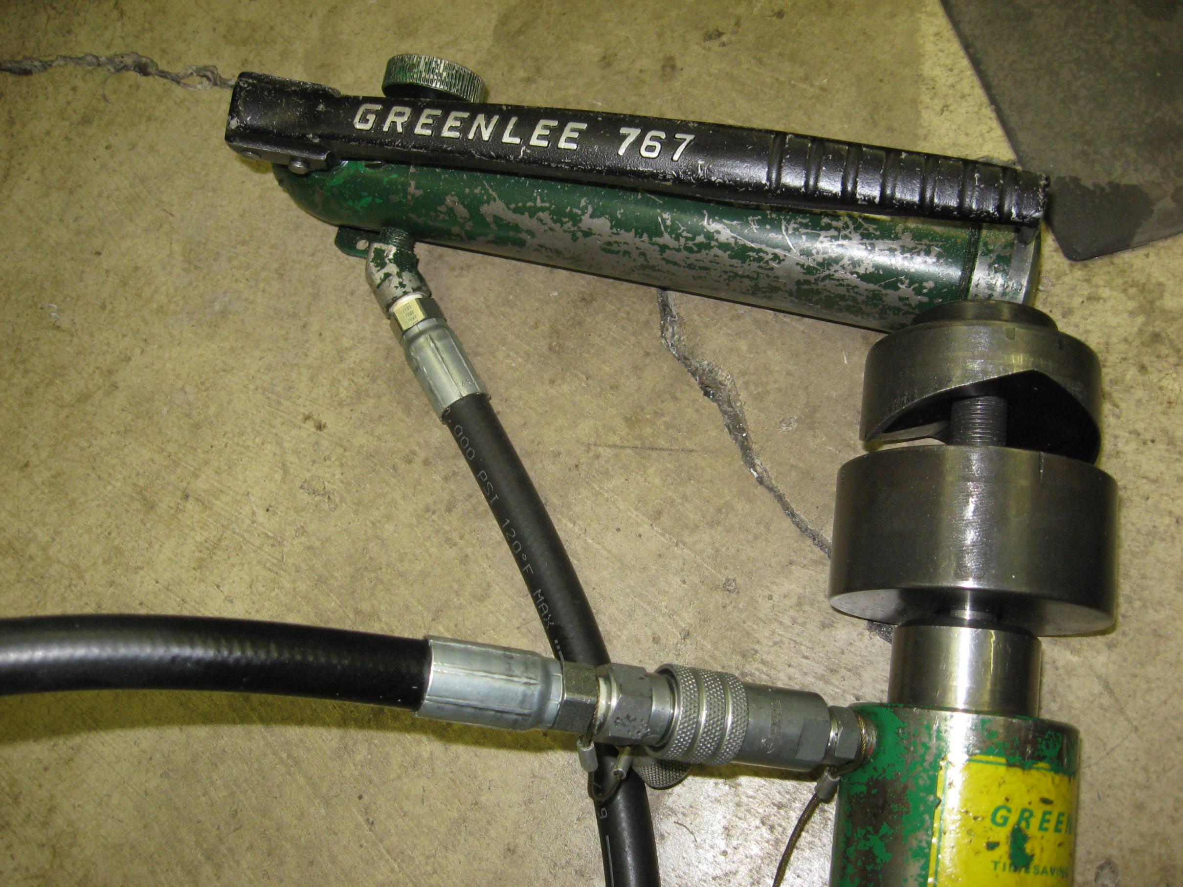

  28. Marty Strode
    Joined: Apr 28, 2011
    Posts: 8,889
    Marty Strode
    This is the "Greenlee" punch I use, it has a 3.125" punch set installed here. The hydraulic pump, makes punching holes pretty easy.
