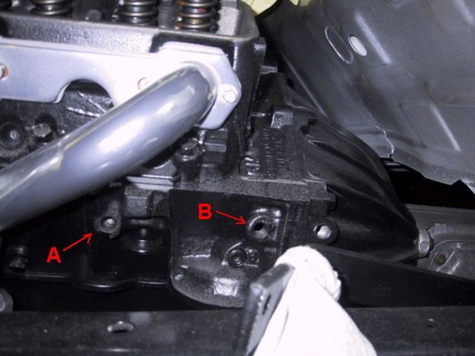

    I bought a Chevy crate engine and I noticed there is a threaded hole just above the oil filter. What is this for?

    i believe clutch linkage

    Could be for oil sender. Maybe show us a picture.

    Oil sender, oil with come out if you fire it.

    A pic would help. Many blocks had one or two locations for the clutch pivot ball, one of which is above the oil filter boss. A clutch pivot ball hole would be a SAE course thread and an oil hole would typically be 1/8" NPT, so pretty easy to tell them apart.

    If the hole is threaded 7/16-14 it's for a clutch linkage ball, but if you are referring to a hole centered in line with the oil filter that should have a 1/4' NPT plug in it. That horizontal hole gets oil from the filter and feeds the main bearings and the top end of the engine.

    and what the oil hole is for, depends on what you're installing the engine in. In some Chevys, it's for an oil pressure switch or sending unit. In others, it's to be plugged.

    I am thinking that they are in every small block (except early engines that had bypass filters) and that that was the access point to drill the cross gallery between the gallery from the oil pump and the oil filter. SBC oil gallary.jpg

    Thanks for the help. It seems it is for the clutch mechanism, which I didn't realize because I'm using an auto. It's "B" in this photo.

  10. Yep, looks like the hole for the Z-bar stud. There is a matching hole in your pic, on the bell housing itself to be used for different applications.

    Pretty sure "B" is also oil pressure.

    If it is for the clutch ball stud, It should go all the way through into the housing. Should be able to see the torque converter through it. Don't think I have seen one with a blind hole. D

    i intend to use that hole and the one in the bellhousing to mount a bracket for a hydraulic slave cylinder to push on the fork
