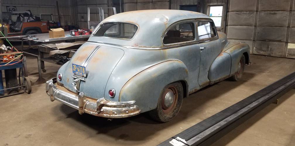

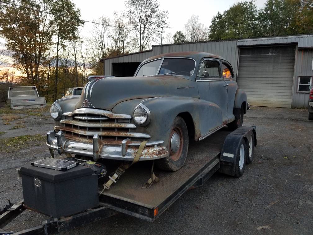

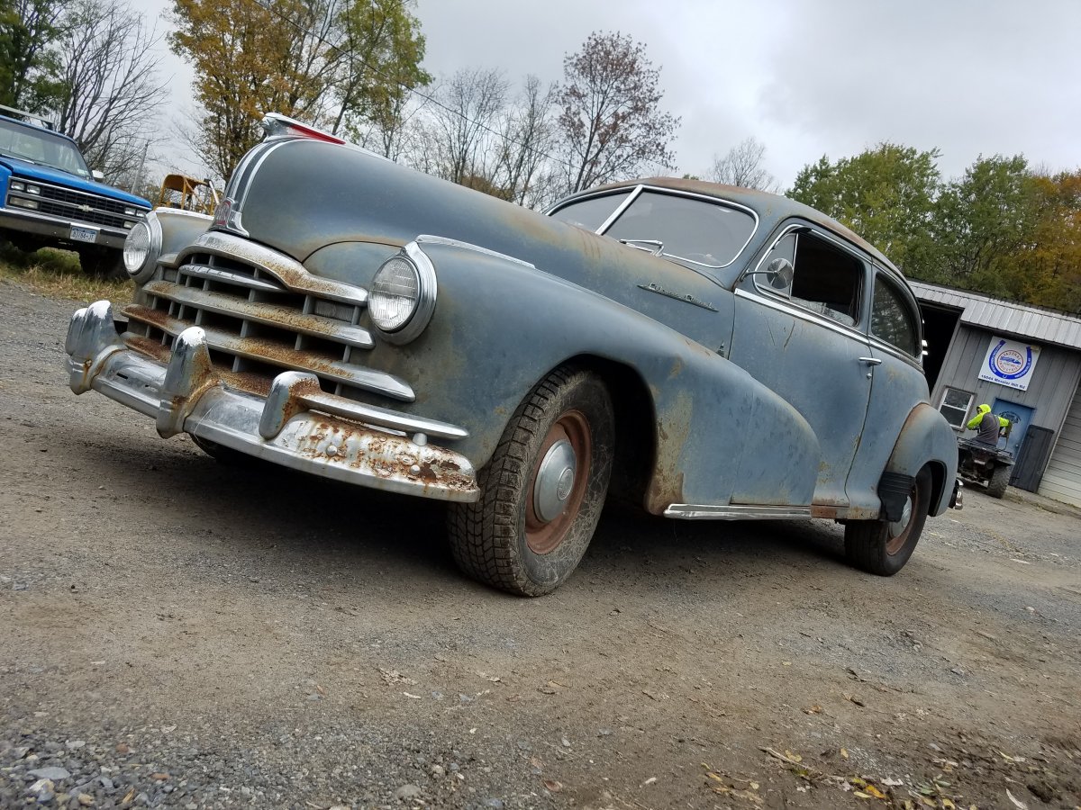

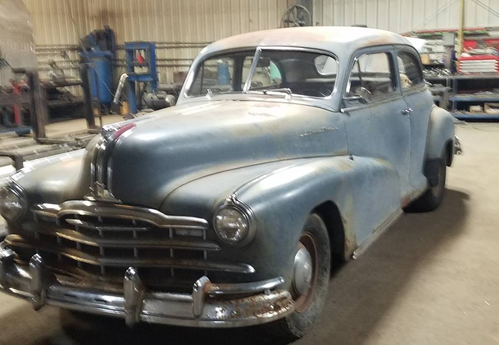

    Hi everyone. It's been about 5 years since I've been active here on the HAMB. I got out of the car culture for a bit. I just got burnt out. A few months ago the itch came back and the hunt for a new project was on.
    I brought this gal home today. Last tagged in 1966. I drove 2 hours to get it. After she was all loaded up the dude hands me an envelope full of papers. Inside was the registration from 1966, plus a copy of the original bill of sale. Looking at it i realized the car was bought from and spent its days two towns from mine! How it ended up two hours in the opposite direction i have no clue.
    I am not sure where this build will go. It WILL get a static drop and wide whites. Before i got the car i was thinking Carson top, but now that ive seen the car in person i don't think i can bring myself to cut it up...
    The flat head six turns. I'll get it running for now, but eventually I'd want a 50s V8. 20181016_181128.jpeg 20181016_181143.jpeg 20181016_181232.jpeg 20181016_181440.jpeg 20181016_185057.jpeg 20181016_181452.jpeg 20181016_185107.jpeg

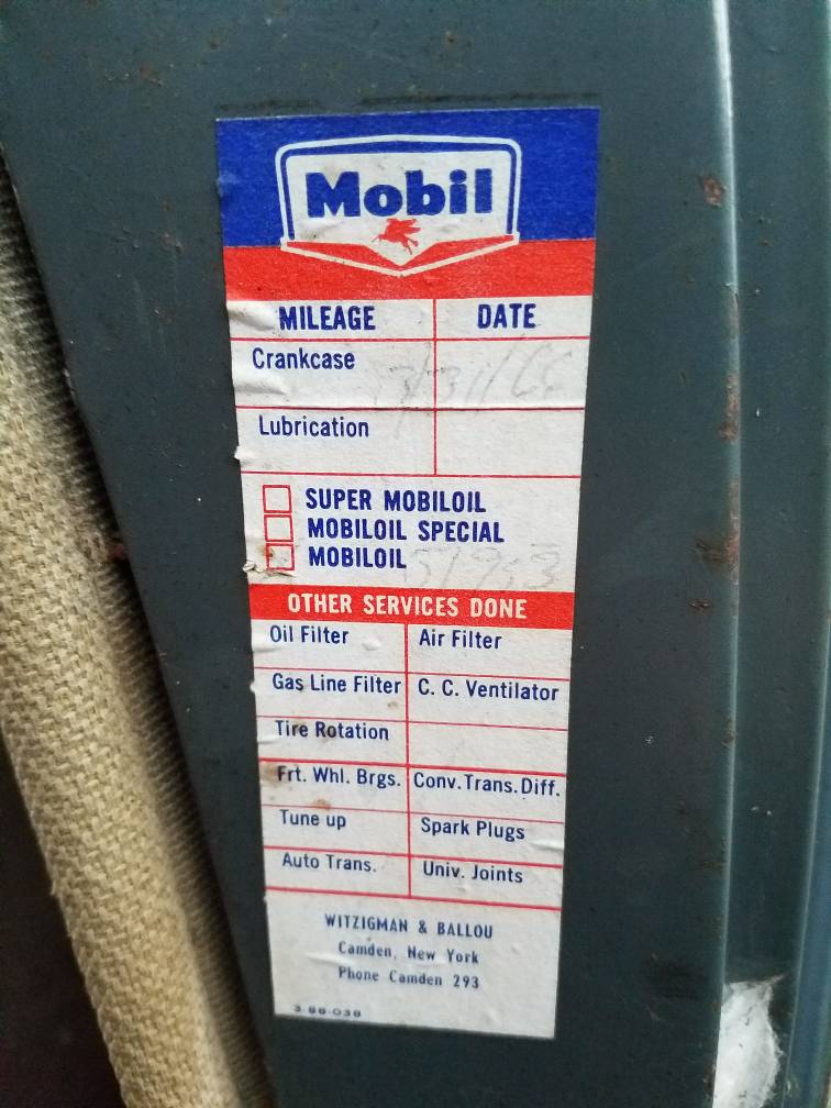

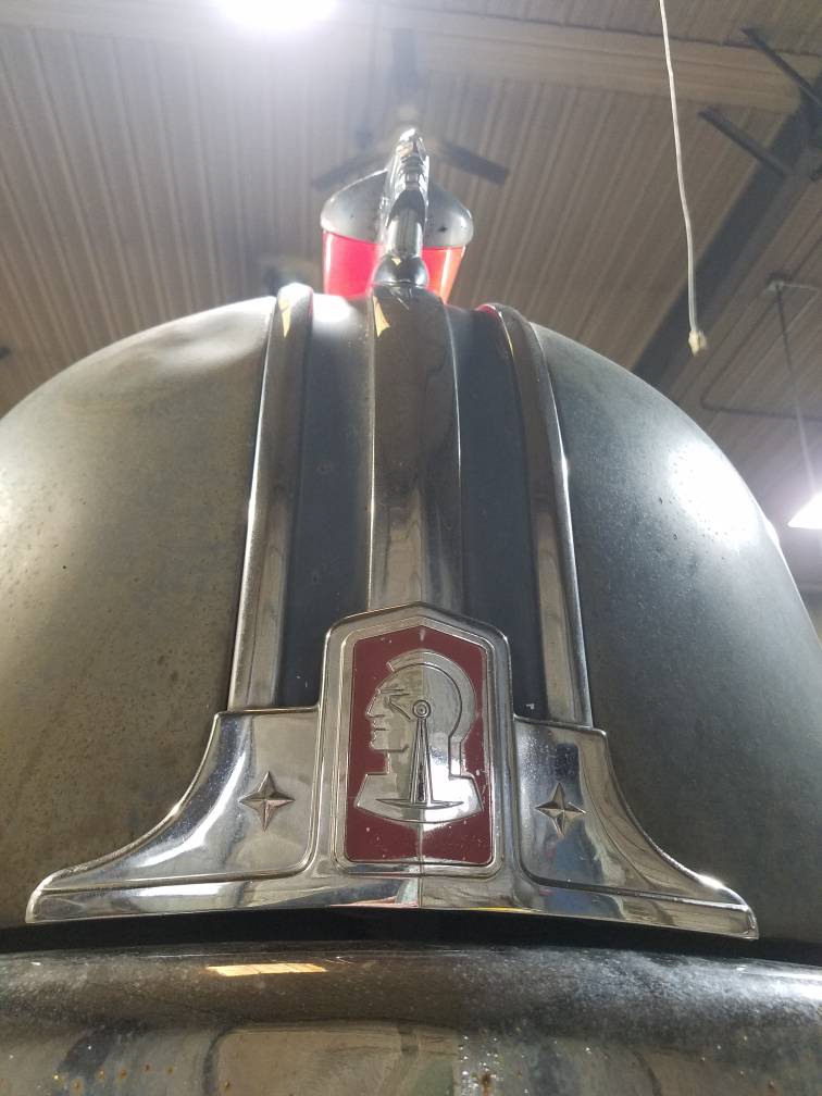

    I still haven't been all over this car yet. I keep finding cool shit 20181017_110232.jpeg 20181017_110259.jpeg 20181017_103839.jpeg 20181017_092754.jpeg 20181017_092731.jpeg 20181017_092714.jpeg

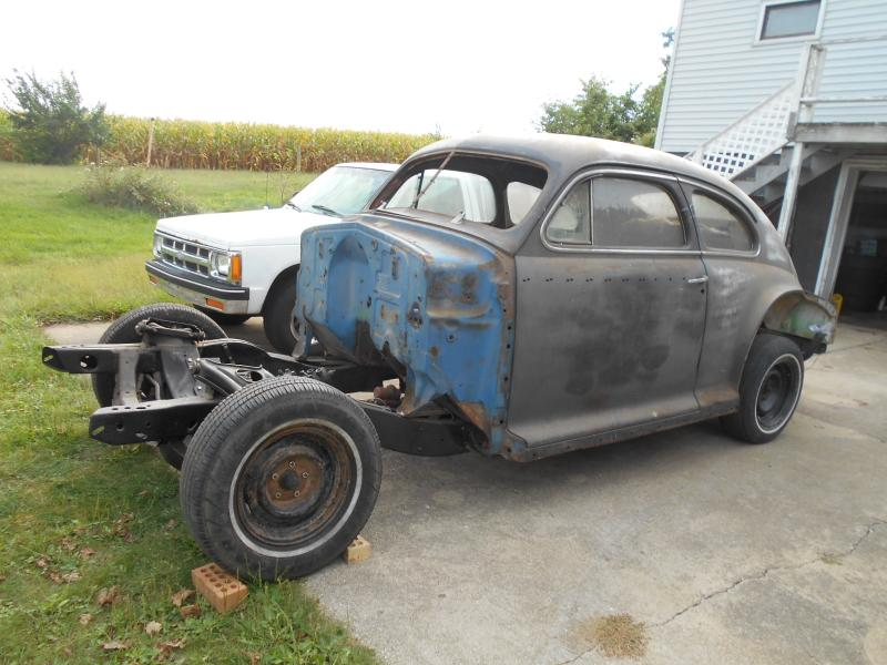

    I bought a really solid 41 Streamliner, a couple of years ago. Since the engine was already missing, I'm thinking 302 GMC.

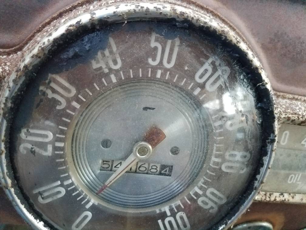

    I was looking through the paper work today and saw the original owners birthdate. It was something like 7/12/89. At first it didnt make sense to me until it dawned on me that the guy was born in 1889!
    Some quick math works out to original owner being 59 years old in 1948 when he purchased this car. The car was last licensed in 1966. The car drove 54k miles in 18 years, which works out to 3000 miles per year!

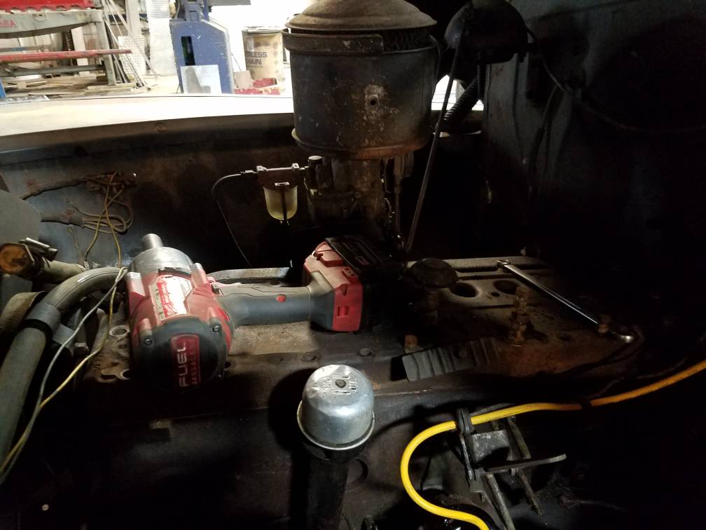

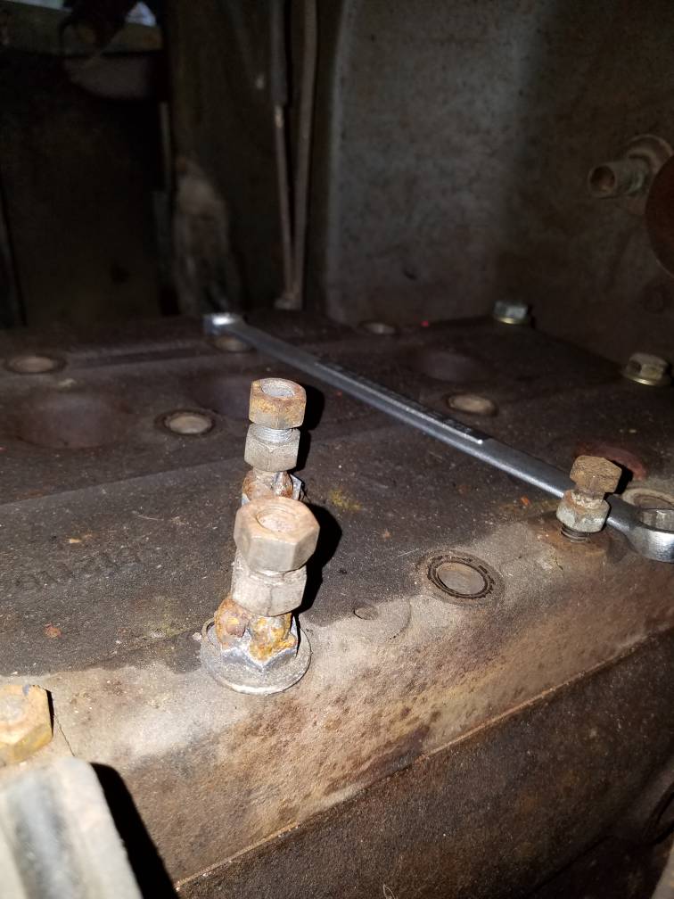

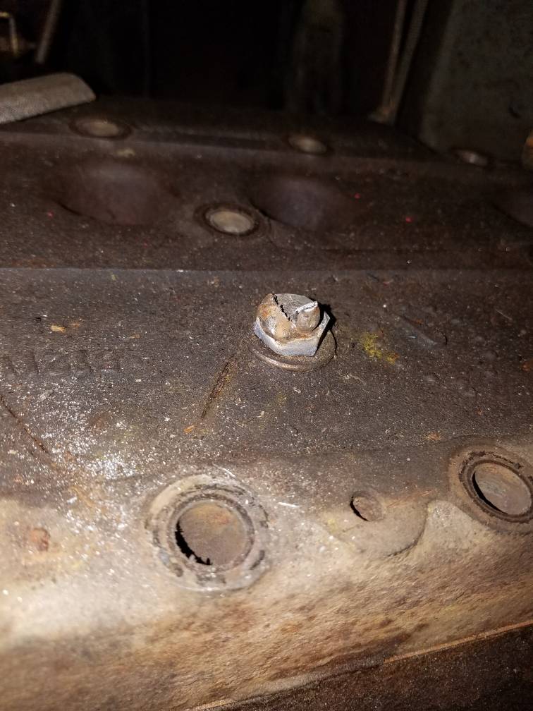

    No compression in cylinder #1. So off pops the head. Wait a minute... there all grade 8 bolts? Then comes the bastard homemade double bolts MADE ON THE ENGINE!
    Took 45 minutes to get the head off. I suspected a stuck valve, but everything moves?

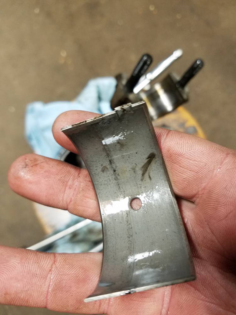

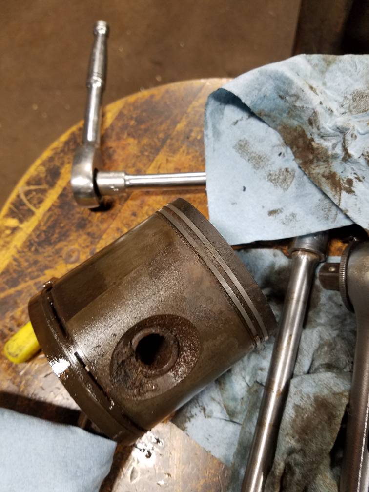

    Here is what i found in cylinder #1. Rings rusted solid to the piston. Cylinder wall is in really good shape, but has a ridge on top. Bearings and crank look good as well.
    Oil looked like it was put in yesterday. There is alot of grit inside the block though... 20181023_163119.jpeg 20181023_163139.jpeg 20181023_163147.jpeg

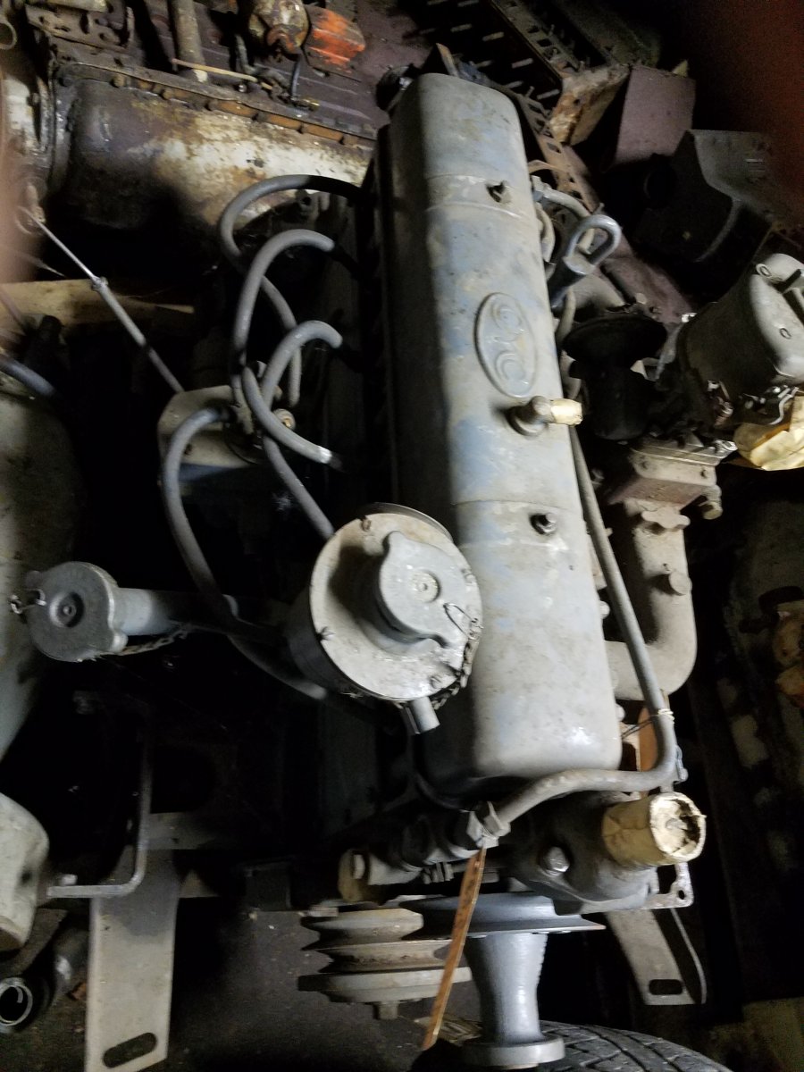

    In other news we got to talking about other engine options and i told him about the 326 mill. He goes on to tell me that its not enough motor for this car.
    Then i say what i'd really like to find is a GMC 302. "Come take a walk with me" he says. Go out to the warehouse and walk up on a totally rebuilt 302 inline six. Yes, i said totally rebuilt ready to run.
    Make me an offer he says. I told him i didnt want to insult him. Honestly i do not know what reasonable price would be, and i've seen these go for big bucks as runners not totally rebuilt engines.
