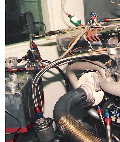

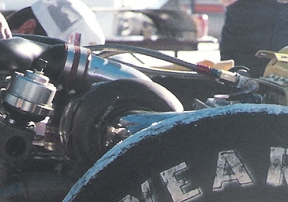

    I have some but they were all different. Some used a #5 valve & also a S & E return too. Does the one you're look at have an "A" valve with the boost return "brain"? Call Hilborn, they have the drawings & will fax you a copy.
    Added: the first picture is from Jerry Kugels 258" twin turbo on my dyno back in the early '90's you can see several valves with the boost pressure bypass on the very left of the shot.
    The next picture was of Glenn Deeds big block (also in the early 90's) with the pressure bypass to the far right of the shot.
    Both of these engines set records at Bonneville that still stand today.
