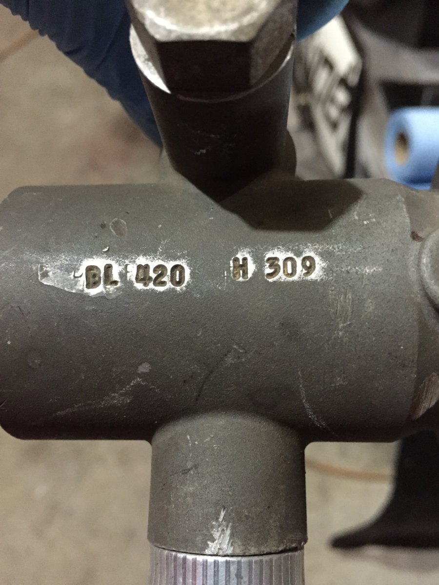

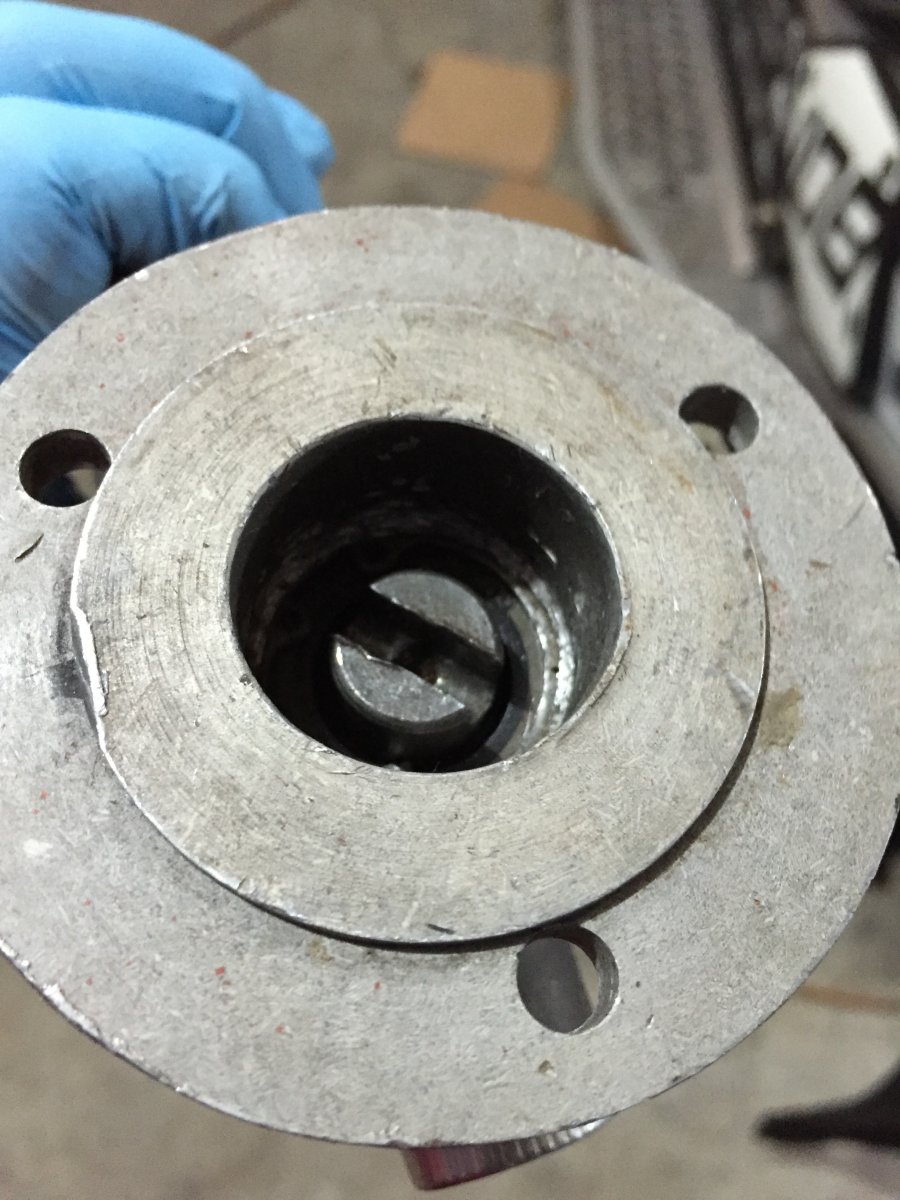

    Hello,
    Is anyone familiar with a Hilborn BL420 pump drive? I have a 420 and the drive on the pump is slotted but all the pumps I see are hex and so is my cam drive. It seems as if I'm missing a hollow shaft with a pin thru it that turns to hex?
    Any help is greatly appreciated.
    Thanks
    Kurt

    I don't think you will find a modern pump with that drive. All you need is a spud to bolt on to the timing gear with a hex drive. Really no problem. Get it fron Hilborn.

    Back in the day those were bolted to the blower covers (hence the 3 bolt cover to the side of the drive) and the matching spade drive was bolted to the rotor gear,so you might start looking into old blowers for the drives. When the need for more fuel and extentions to clear the blower drives , the hex was needed to hold and support the shaft at both ends

    I used an old BL pump on my '32 Plymouth banger. All I did was take a piece of hex stock and mill a blade on the end. I made it the right length so that bolting the pump to the drive held it in place. Any BL pump is really old and they were subject to wear from the start. I would send it out to have it flowed before I got to involved with it.

    I was worried about it not staying centered in the pump groove.
    Did your adapter end up being 1"-2" long then?

    I have the pump already in the pictures above

    As I remember, mine was around 3/4 or 1 inch long. Are you wanting to run this off the cam? On a belt drive. I think that if you run it off the cam snout it will be turning backwards. Maybe not. As you can see I ran mine off the oil pump. But it was the same as the belt drive Hilborn mount that was designed from a '48 Ford generator mount.

    If I were to use this pump (based on it being able to reverse it) I would make a spacer with a bearing for support of the drive spud to eliminate any wobble. The drive spud would be of matching dia of the pump drive for a full contact spade and the male hex on the oppisite end for cam engagement and would use external snap rings to hold the spud to the bearing. Heat treating would also be needed for wear resistance.

    On the Plymouth with a Barns pump, the adapter spud is no longer than the Hilborn hex on a PG pump. There is no room or reason for any support or snap rings. I ran mine at El Mirage and Bonneville for years with out any reason to think I needed extra support.

    I think if I wanted to make this more complicated than necessary, I would make a sleeve that was a slip fit over the slotted shaft in the pump. Then I would silver solder it over the blade end of the adapter. So the blade would have to stay centered in the shaft. But I also think that if you actually do this instead of thinking about it, you will see that you don't need anything but the adapter.
