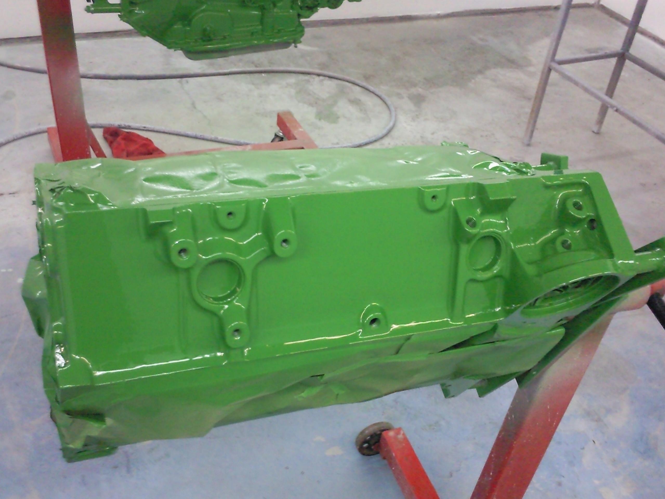

    No filler in this, lots of grinding and sanding, some 2pak primer and 2pak top coat. I'm running a good sized radiator and an engine oil cooler as I know it will run a little hotter.

    I like the colour Mgtstumpy, we had several gallons of that from a mis- batch years ago. We are painting the Essex engine and suspension the same. I even made sure to put some on my 60 chevy, just for nostalgia's sake
  13. Never seen a green transmission..........

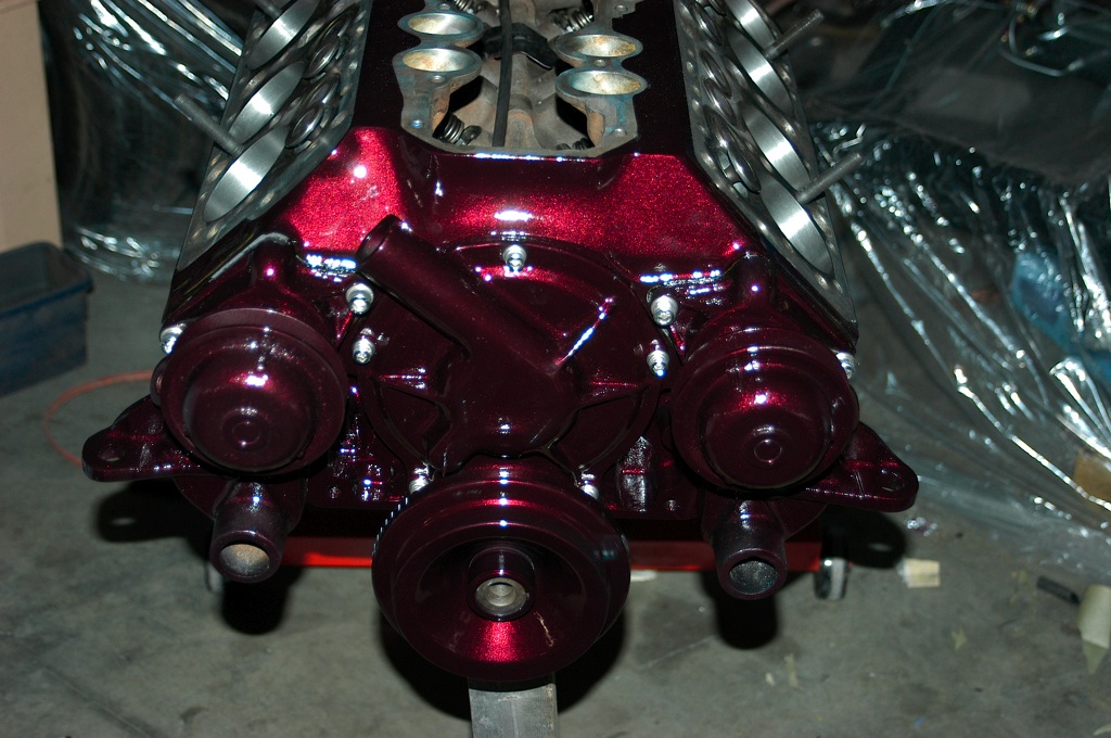

    Is there an "Engine Candy" thread on the go? Don't want to start another, but a search for Beautiful engines isn't turning any thread up. I have spotted some georgous motors, that members are running. But no thread just on motors..... like this caddy motor....
    http://www.jalopyjournal.com/forum/showthread.php?t=504828

  18. whid
    Joined: Jun 20, 2008
    Posts: 452
    whid
    man thats nice.....whid
