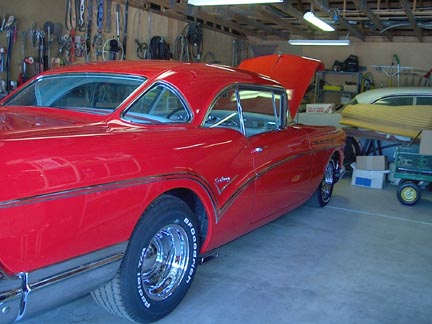

  1. The end of a three year build.
    Just re-licensed.
    Muffs way too loud to drive, way loud, really loud.
    New ones next week.

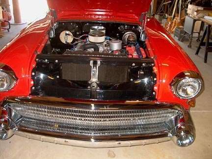

  2. The front view.

  9. The piece de la resistance' or as the French would say, "The Good Stuff."
    425" of good running Nailhead.
    Stuffed with a fairly big cam.
    Ford 9" rear running 4.11 gears - and you thought it was a custom....
    Dual Carters, think they are 625's.
    Front disc brakes - bitch if you want, but these old Buicks didn't stop worth a damn. I owned a 57 Roadmaster and it was a brake fader par supremo.
    The Buick brakes work great on a lightweight Ford, but on the Buicks, not so hot.
    Corvette M/C.
    57 Buick auto trans, super turbine or whatever Buick called em. Beefed a touch.
    It took three 425 blocks to come up with a good one for the build.
    This is one strong running nailhead and bad sounding mofo.
    The car is a new build of a high school Buick Century belonging to a couple of brothers we call the "Buick Brothers."
    More HP than back in the day, but this car is a good example of some customs that ran the street in the late 50's.
    You would look at them and figure, nice, but slow and then find yourself watching a rapidly disappearing set of taillights.
    More than a few Nailheads found their way under the hood of a few 40's & 50's era Fords.
    They were tough to beat when the Nailhead was in stock form.
    A little breathing upon and it was all over.
    I estimate it will run the quarter in the high 13's on soft compound street rubber and crank off about 101-102 mph.
    Back to the future they say.
    Or is it, forward to the past?

    Nice looking under the hood as well!

    Here's a closer view of the engine.
    Next time I see the car I'll try to get some more detailed shots, but if you're familiar with the stock Buick method of gen mounting then you'll know what I mean.
