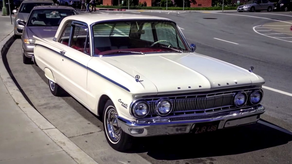

  11. The 260 is a V8 so I would thing the car has 5 lug wheels.
    In the wheel department the original equipment chrome rim hup cap offered on the 64 Cyclones would look great. HRP

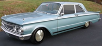

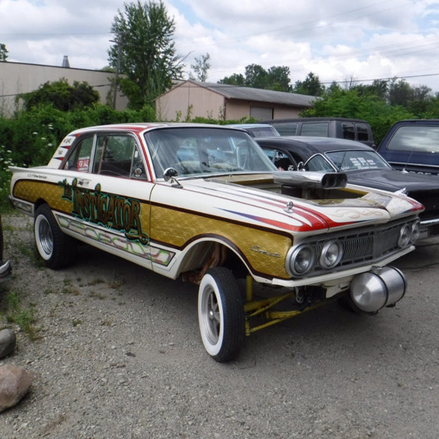

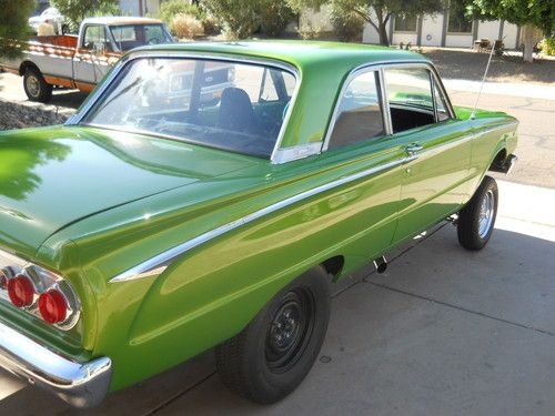

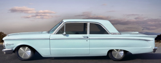

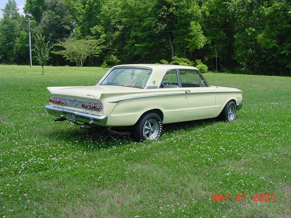

  19. anthony myrick
    Joined: Sep 4, 2009
    Posts: 5,691
    anthony myrick

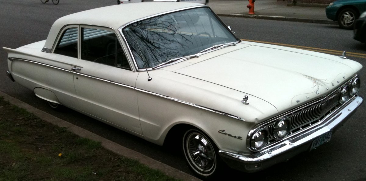

    the last one would be the simplest, maybe ad some chrome bellflower tips

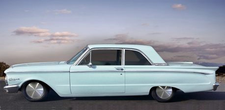

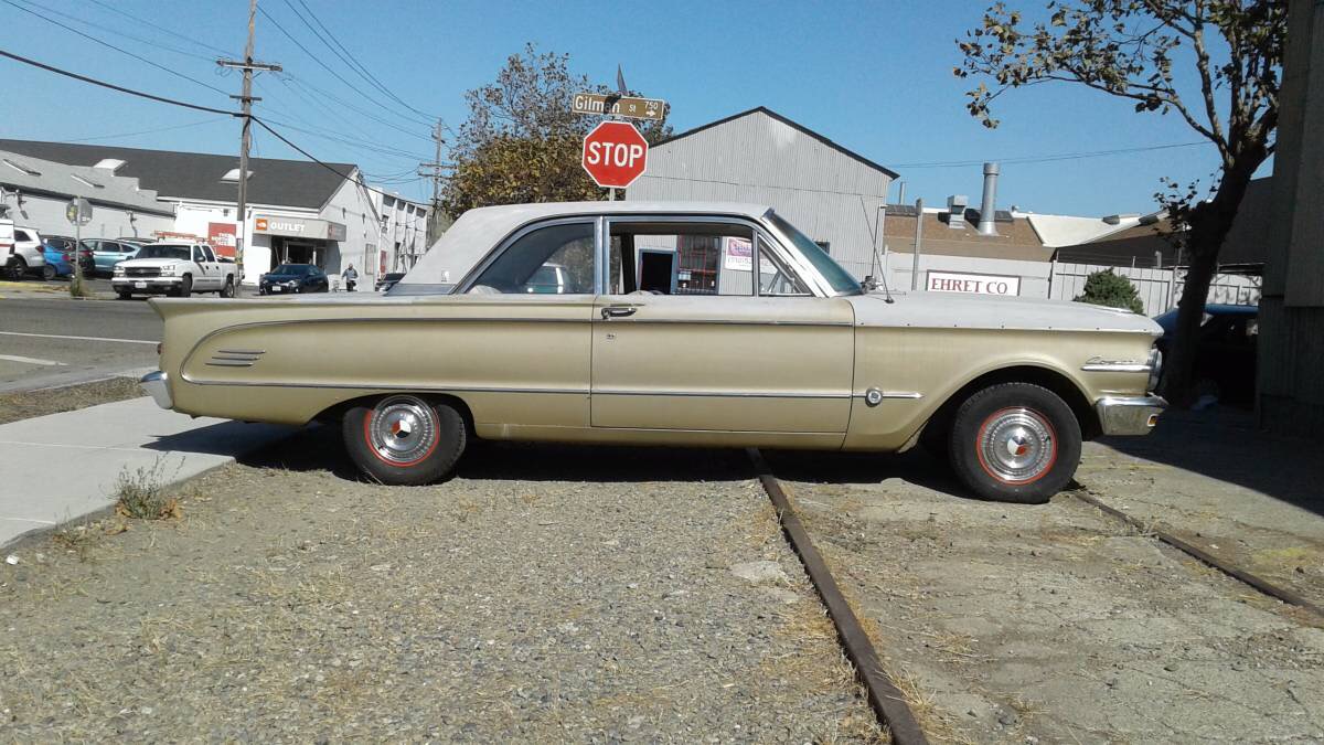

  20. anthony myrick
    Joined: Sep 4, 2009
    Posts: 5,691
    anthony myrick

    Hi-Jacker decal on window, girlfriends scarf & ring on rearview mirror will complete the look!
    loudbang and anthony myrick like this.

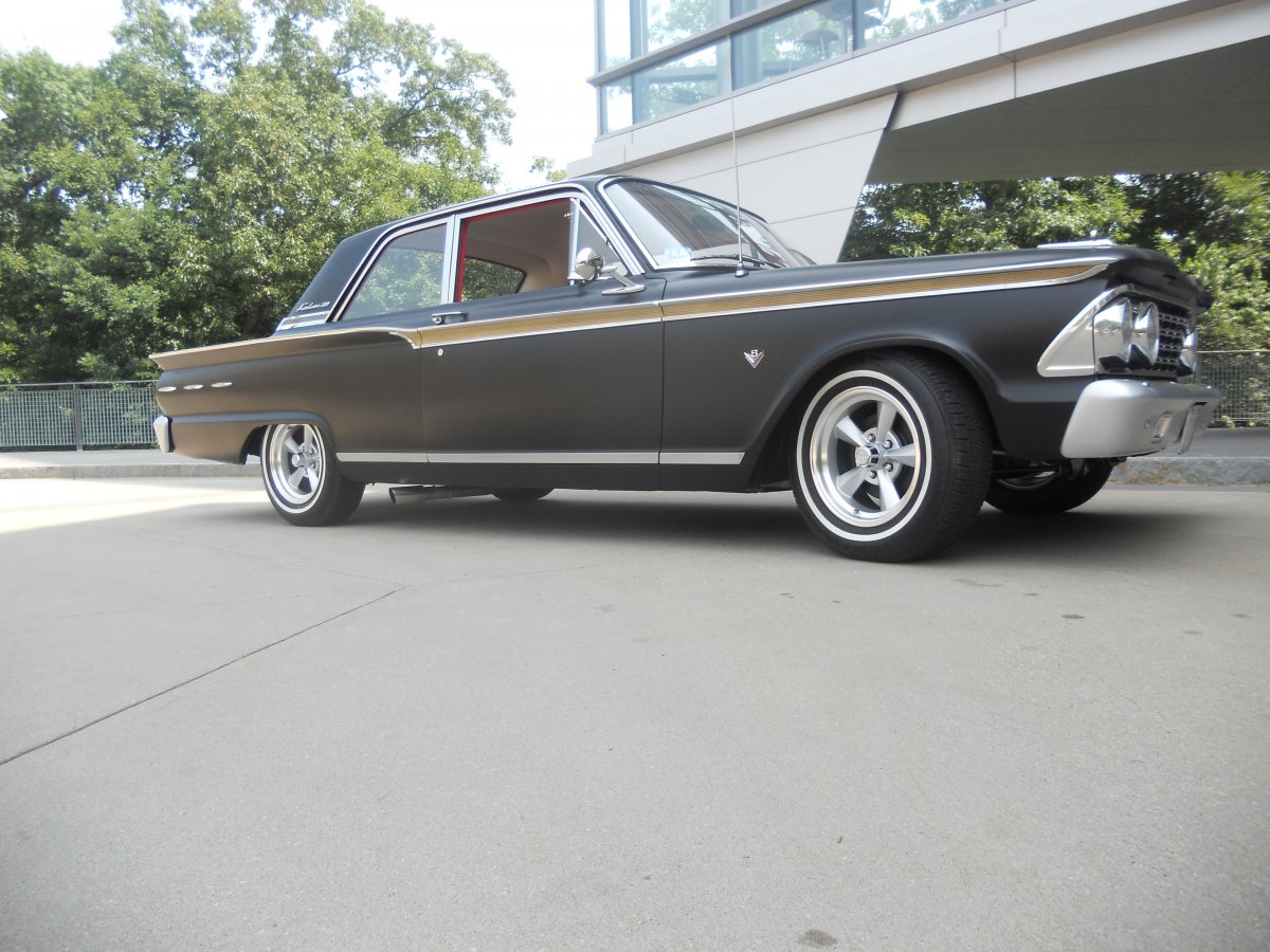

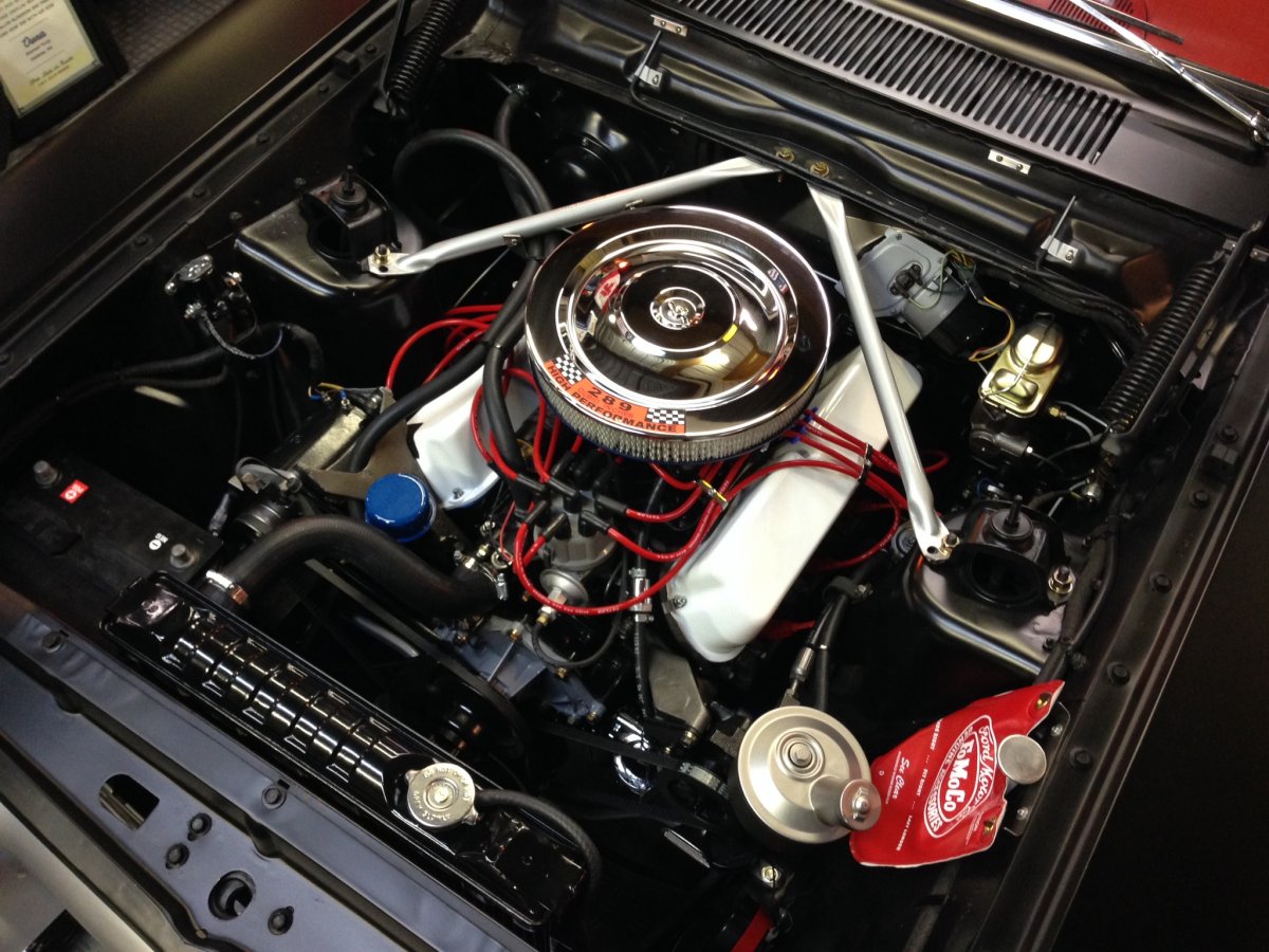

  24. FrankenRodz
    Joined: Dec 20, 2007
    Posts: 891
    FrankenRodz
    That car is the BALLS!
    Here's what I did to my '62 Fairlane a few years ago.
    -Satin Black
    - '63 289
    - Straight Dual Exhaust
    - Ridler 675s
    I have plenty of leftover NEW parts, and all the research, if you need any assistance.

  27. HRS
    Joined: Nov 7, 2008
    Posts: 361
    HRS
    @FrankenRodz Man that things looks great! What type and size of tires are those?

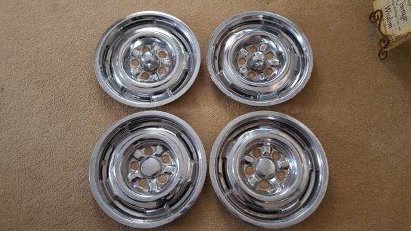

  28. @AndersF is actually correct for '64 on the heated springs. No it is not the correct way or best way to lower a car but it was commonly done in the '60s. I can still remember clear up into the later '60s young men taking two torches and two packs of Lucky Strikes sitting under the bumper of the old heap and heating the springs on either side of the car until it settled on the lucky packs.
    We have better options now or smarter options but heated springs were common back in the '60s. Another option if you had a little cash and a coil sprung car was rewound station wagon springs. I donot know the process but the spring shop would either do it or send them out for ya and when they rewound them they came back shorter. Also a little stiffer it seems I am guessing from lack of travel that they would have once had.
    The chrome wheel covers that were posted by @HOTRODPRIMER would have been a common mod in the early '60s they were cheap enough from JC Whittney. If you lived in the San Francisco Bay area then Wheels by Paulsen where an option, a little more pricey than wheel covers.
