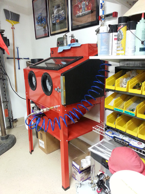

    Thank you thank you for the replies!!! I do have a dust collector to the left of the cabinet and it helps. I'll snap a pic of it soon.
