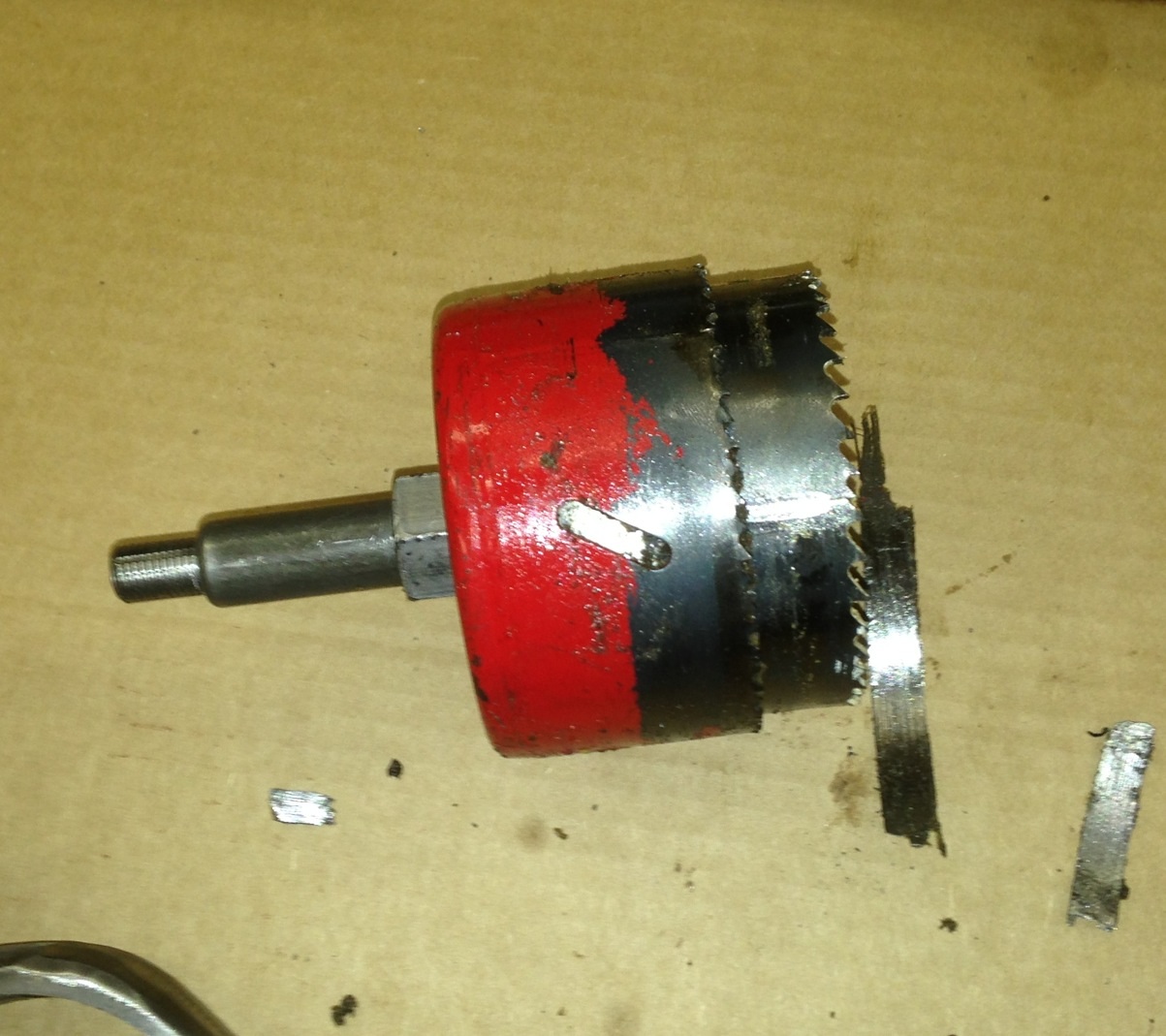

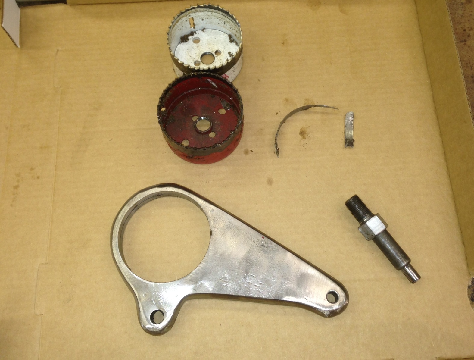

  1. So there's a few on here, but I haven't seen this particular one yet to enlarge a hole that's in the right spot.
    Here's what you need, a hole that needs to be bigger.
    A hole saw that's the size of the current hole
    A hole saw that's the size of the hole you want
    A shock stud, same thread as the hole saws.
    Thread the shock stud into the larger of the hole saws first, then thread the smaller one on, this is the pilot. Chuck it up in the drill of choice and have at it.
    Works like a champ.
    The plywood outer pilot trick wasnt cutting the mustard on this one.

    another way to do it is to cut a hole in a piece of scrap using the size hole you want your new hole to be, position that piecer over the hole you want to enlarge then drill.
    the scrap piece will hold the position of your hole saw over your new hole. This is particulary useful if you new hole will not be concentric with the old hole.

    Great idea, will remember it for future use. Another tip when using a hole saw on a hand drill, drill pilot hole and then replace the bit with some smooth bar stock the same diameter.

  19. It'll slide in further than the video shows. The OG tip is a good one, but in over 50 years of tinkering and saving almost everything, I doubt that I have a shock mount stud in any of my coffee cans:(

  26. One thing to keep in mind is there's two different hole saw arbor sizes; one size up to 1.125" (maybe 1.25), then a larger one above that. So depending what size you have and what size you need, some monkey-motion may be needed....
