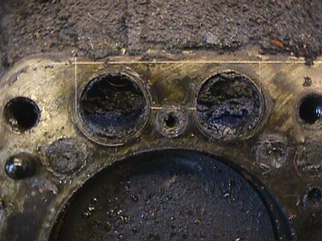

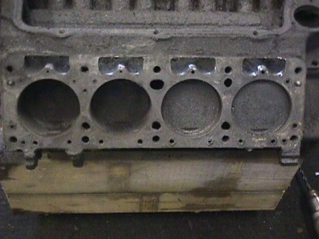

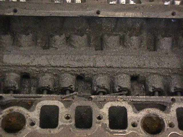

    Some 2.5 years ago I bought my first 392 Hemi.
    I made a 250 mile roundtrip in the '62 wagon to pick up the expensive lump of greasy steel.
    I knew the engine was a runner before it spun a bearing so I had some hopes of bringing it back to life rather easy.
    Upon arrival I started disassembly and found more and more stuff I didn't want to see.
    The entire inside of the engine and parts was totally covered with a rubberlike greasy coating.
    Not the kind that would dissolve with some degreaser, thinner, ovencleaner or brakecleaner. Tried them all, to no avail. No, this was the good stuff allright.
    I had to get the engine block lyed to get most of the gunk out. After the cleaning I had the block bored .020" and bought a set of cast pistons and rings from Egge.
    The crankshaft turned out to be another expensive item because one journal had to welded up and ground again. All the journals were taken to .010" undersize and the crank was nitrided again.
    Also made a nice little shoppinglist at PAW and bought a Weiand dual quad intake along with a set of ceramic coated shorty headers from eBay.
    I choose a camshaft that was one step above stock, the '11361', which has the following specs:
    Duration @ 0.050 Lift: Int. 218° /Exh. 218°
    Advertised Duration: Int. 270° /Exh. 270°
    Gross Valve Lift: .440"/.440"
    Will be continued...
    ValveCover:
    Hemi in wagon:
    Rubbercoated rod and piston:
    Greasy stuff and spun rod:
    Ovencleaner:
    Lyed:
    Boring:
    .020" Pistons by Egge:

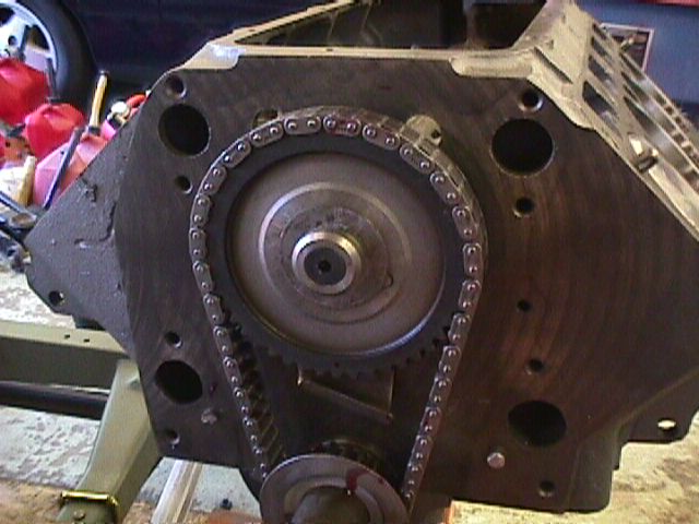

  9. My DeSoto block/heads were so bad that it took a hot tank, a bake, another hot tank, and steel shot blasting to get all the crap out...then a final jet wash. The thing that got me was that all the plugs showed a beautiful tan color, and you couldn' even hear it idle...with a badly cracked piston!
    Since it's going to be a Blown/Roller cammed engine, I had to open up the Factory lifter bore access holes to get the rollers to "drop" in (last and first picture). Engine machine work is done, and I will be picking up all my pieces/parts today. Will Post "after" pictures, then.
    Work done includes, right off the bat, Magnafluxing the heads/block/crank...all checked perfect. Block was squared/surfaced, align honed, bored for cast rings, brass freeze plugged , oil galleries reamed. Heads surfaced, intake mounting surface surfaced for fit with the intake, ports cleaned up, chambers polished, clean up ported (exhaust side concentrated on) valves done, spring seats cut for Comp Cams #901 springs, springs shimmed as necessary. Each cylinder was finish bored for it's own piston (.030 egge pistons, 7.5:1), and rings were fitted for Blower use. Roller cam/crank checked for straight, and the timing gear end of the cam finished so that the '55 cam gear set up could be used with the snout cut off the cam. Rods resized, and rotating assembly balanced. Machine work by Jim Thomas...$948.62, including tax. The man is a MASTER, and his attention to detail is phenominal...
